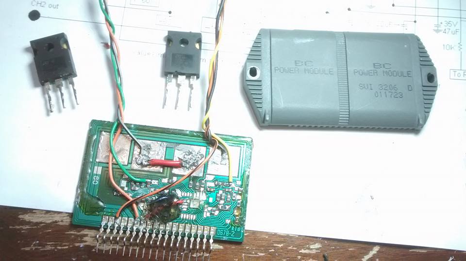

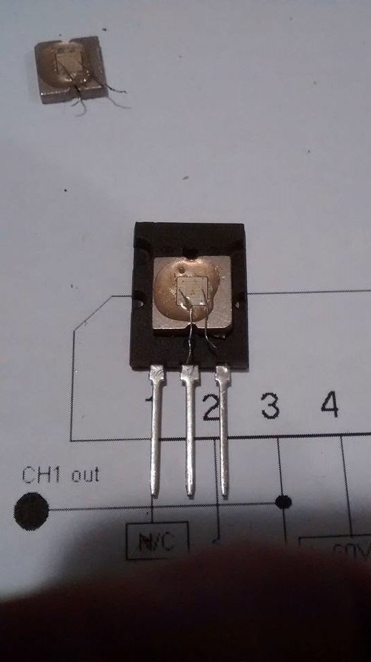

SVI3206D Hybrid IC ( BC POWER MODULE BY SANYO)
  • Jeff Pepin
    replied
    Re: SVI3206D Hybrid IC ( BC POWER MODULE BY SANYO)
    Originally posted by stj View Post
    transistor voltage ratings are only maximum, they will work just fine on lower voltages.
    magiemagnifimerveilleux
    in french it represent
    magique
    magnifique
    merveilleux
    (les 3 en meme temps)
    Last edited by Jeff Pepin; 06-21-2015, 11:56 AM.
    Leave a comment:
    replied
    Re: SVI3206D Hybrid IC ( BC POWER MODULE BY SANYO)
    transistor voltage ratings are only maximum, they will work just fine on lower voltages.
    Leave a comment:
  • Jeff Pepin
    replied
    Re: SVI3206D Hybrid IC ( BC POWER MODULE BY SANYO)
    Originally posted by stj View Post
    they are not run in parallel, that's a stereo amp.
    you need one NPN and one PNP for each channel.
    oups okay ,yeah i think i know what you mean , need mores wires in this case lol , did you think i can use setup of any matched pairs like 2X 2sd2439 / 2sb1588 i know these are Overrated , 160V , if i run it to 60V insead of 160V, what is chance that is work anything ? a transistor of 160V rating can be run at half Supply ? did it work like that? , using an overrated transistor in a less power supply , it will reduce Heat ? , and risk to Blowing transistor? , or it will simply destroy the power suply by taking too much current ? , sorry i have somes noobs question that pass in my head . but plz dont forget that presently i study hard in experiencing anything that look legit , thanks a lot for your time
    Last edited by Jeff Pepin; 06-21-2015, 10:48 AM.
    Leave a comment:
    replied
    Re: SVI3206D Hybrid IC ( BC POWER MODULE BY SANYO)
    they are not run in parallel, that's a stereo amp.
    you need one NPN and one PNP for each channel.
    Leave a comment:
  • Jeff Pepin
    replied
    Re: SVI3206D Hybrid IC ( BC POWER MODULE BY SANYO)
    EATING KRAZY GLUE IS BAD FOR HEALTH
    Leave a comment:
  • Jeff Pepin
    replied
    Re: SVI3206D Hybrid IC ( BC POWER MODULE BY SANYO)
    so this circuit have 2Xnpn in darlington configuration , and 2 pnp too , i will try to replace that only by 1 pair 1 1/2 X Rated, like tip35C and tip36C and bypas the ''darlington setup and see what it will happen , maybe the amp will be not loud as should maybe it will Explode , but this amp is not destined to be drived at max , and not destined to survive at base it should deliver the tip35/36C capabilities at minimum that is not so bad
    Experiencing time , COTTON SMOOKE
    i have already worked on blowed Su-g70 and su -g90 Amp with same defect ( overheated power module ) after Reflowed Hbrid ic ( to replace slided transistors ,, the amp was able to get audio but not loud as should ( Probably because one of 2 pair of transistor was blowed and amplifier lost his half punch ) ,
    Last edited by Jeff Pepin; 06-21-2015, 10:20 AM.
    Leave a comment:
    replied
    Re: SVI3206D Hybrid IC ( BC POWER MODULE BY SANYO)
    the original module was 130w, a tip3055 is only about 75w afaik.
    even the 2n3055 in a metal can is only 115w
    Leave a comment:
  • Jeff Pepin
    replied
    Re: SVI3206D Hybrid IC ( BC POWER MODULE BY SANYO)
    hahahaha what if ?? i want a transistor , ok wich package ? , i dont want it in a package , just the transistor pleaze XD ahah
    Last edited by Jeff Pepin; 06-21-2015, 01:24 AM.
    Leave a comment:
  • Jeff Pepin
    replied
    Re: SVI3206D Hybrid IC ( BC POWER MODULE BY SANYO)
    this look pretty sweet , but absolutly not sure because i know nothing in audio : i juste fuin love this wathever it is
    2N3055/MJ2955 NPN/PNP Matched Pair Transistors
    Leave a comment:
  • Jeff Pepin
    replied
    Re: SVI3206D Hybrid IC ( BC POWER MODULE BY SANYO)
    Originally posted by stj View Post
    something is not right.
    the transistors should all match,
    you should not be seeing bipolar(regular) transistors and J-Fets.
    maybe the readings are wrong or one of the parts is damaged.
    yep affirmative pnp devices are exploded this amp is an heat victim , pnp devices sliding trip
    Leave a comment:
  • Jeff Pepin
    replied
    Re: SVI3206D Hybrid IC ( BC POWER MODULE BY SANYO)
    Originally posted by stj View Post
    if this guy was capable ! i will be capable too , it not need much more to get it work , in the worst case , un capaciteur dans loeuil un peu de fumée , une histoire a raconter ahahah desoler si mon anglais fais dur je m'force beaucoup!
    Last edited by Jeff Pepin; 06-20-2015, 11:31 PM.
    Leave a comment:
  • Jeff Pepin
    replied
    Re: SVI3206D Hybrid IC ( BC POWER MODULE BY SANYO)
    So far I cannot tell if the output devices are just plain NPN/PNP or MOSFET, cannot find the spec of the module to verify, they do not look like MOSFET.
    You also have some ICs in that module too.
    yeah ! and these parts have nothing writted on it , its probably under the solder
    npn pair is still intact
    but pnp pair is destroyed , i was able to test only one ant its one that returned a JETTE FETTE
    Leave a comment:
    replied
    Re: SVI3206D Hybrid IC ( BC POWER MODULE BY SANYO)
    chase this guy!
    http://www.oocities.org/technicshifi/IC.html
    Leave a comment:
  • Jeff Pepin
    replied
    Re: SVI3206D Hybrid IC ( BC POWER MODULE BY SANYO)
    its probably because one of the PNP ( fake j-fet?) device that not completly blowed , other one is burned , , the 2 other one ( npn look just fine )
    Leave a comment:
    replied
    Re: SVI3206D Hybrid IC ( BC POWER MODULE BY SANYO)
    So far I cannot tell if the output devices are just plain NPN/PNP or MOSFET, cannot find the spec of the module to verify, they do not look like MOSFET.
    You also have some ICs in that module too.
    Last edited by budm; 06-20-2015, 10:45 PM.
    Leave a comment:
    replied
    Re: SVI3206D Hybrid IC ( BC POWER MODULE BY SANYO)
    something is not right.
    the transistors should all match,
    you should not be seeing bipolar(regular) transistors and J-Fets.
    maybe the readings are wrong or one of the parts is damaged.
    Leave a comment:
  • Jeff Pepin
    replied
    Re: SVI3206D Hybrid IC ( BC POWER MODULE BY SANYO)
    thanks a lot !! so now , just need to find somes candidats the PnP device returned P-jfet , with 64Volt look like legit info ,
    the orange home made box is nothing more than a simple atmega168 electronic device tester found on ebay for 17$ i love it
    Leave a comment:
  • Jeff Pepin
    replied
    Re: SVI3206D Hybrid IC ( BC POWER MODULE BY SANYO)
    Technics Su-G50
    Leave a comment:
    replied
    Re: SVI3206D Hybrid IC ( BC POWER MODULE BY SANYO)
    '1' are NPN (Collectors of both Transistor '1' are connected to +VCC pin 4)
    '4' are PNP (Collectors of both transistors are connected -VCC pin 5)
    BTW, what is the model of this amplifier?
    Last edited by budm; 06-20-2015, 08:32 PM.
    Leave a comment:
  • Jeff Pepin
    replied
    Re: SVI3206D Hybrid IC ( BC POWER MODULE BY SANYO)
    according to diagram of SVI ,
    pin3=ch1 out
    Pin4 = +60V
    Pin5 = -60V
    pin6 =ch2 out
    so on my ''mspaint artwork''
    both yellow 1'S marks Are +60V
    Both Red 4's marks Are -60V
    Both Orange 3's marks Are channel 1 Output
    And
    Both Green 2's Marks Are Channel 2 Output
    it leave 4 Connection that is for the signal
    SVI
    Leave a comment:
