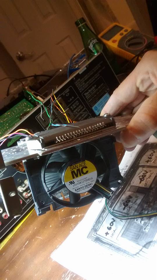

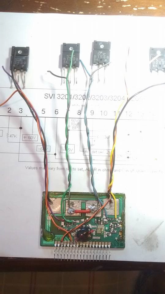

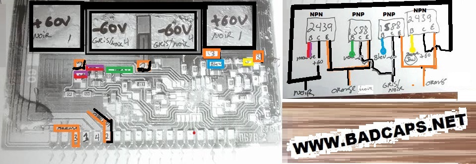

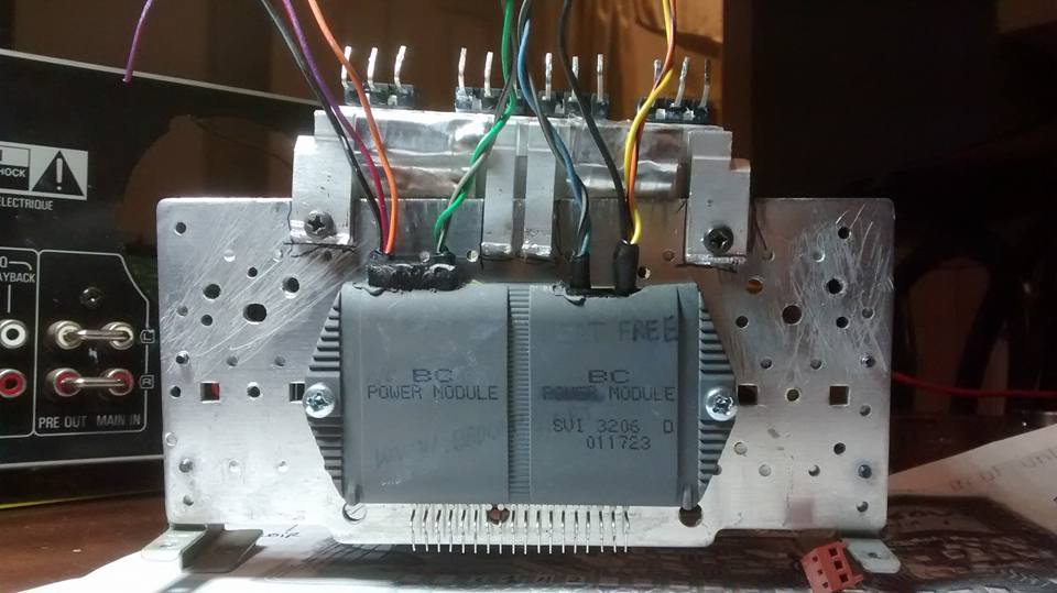

Re: SVI3206D Hybrid IC ( BC POWER MODULE BY SANYO)
The transistors base drive circuits may be damaged when the power transistors went out, they are direct couple circuits. You should plug the unit into the AC socket that will put the 120V lamp in series with the unit you are working on. you can use 60~75W lamp, the lamp will stay on bright if the circuit draws too much current constantly, it saves me many output transistors.
http://s807.photobucket.com/user/bud...?sort=3&page=1
SVI3206D Hybrid IC ( BC POWER MODULE BY SANYO)
Re: SVI3206D Hybrid IC ( BC POWER MODULE BY SANYO)
Then the fuse blowed ,
i will remove the 4 transistors then try again without load ,
theses pnp/npn come from a non working amplifier , so i asssume they leak level 100
no smokeit will work , , i'm persistent
Leave a comment:
Re: SVI3206D Hybrid IC ( BC POWER MODULE BY SANYO)
wear eye protection - resin from power transistors travels a long wayLeave a comment:
Re: SVI3206D Hybrid IC ( BC POWER MODULE BY SANYO)
i wait this moment since 2 days now , then now i fear to plug it . ajaha okay i test that , it work or it blow , what can i do for check before putting AC on it? any hints ? ohh noo no question to plug this amp without recording that ! , phone need to be charg'DLast edited by Jeff Pepin; 06-22-2015, 12:25 AM.Leave a comment:
Re: SVI3206D Hybrid IC ( BC POWER MODULE BY SANYO)
That is such a great web site that have so much information. If you have to read them you will learn so much.Leave a comment:
Re: SVI3206D Hybrid IC ( BC POWER MODULE BY SANYO)
how we delete a comment ? lolLeave a comment:
Re: SVI3206D Hybrid IC ( BC POWER MODULE BY SANYO)
"For the pnp transistor connection is
Collector = Power Rail negative
Base =Stage output (audio out)
Emitter = Signal input (audio signal) "
Emitter is the output. Emitter of the NPN and the Emitter of the PNP are electrically connected together to form output pin for driving the speaker.
See figure 4 for basic push-pull output.
http://sound.westhost.com/articles/amp-classes.htm
That is a great site for learning.i think i know a new book now and i fkin love that
Leave a comment:
Re: SVI3206D Hybrid IC ( BC POWER MODULE BY SANYO)
"For the pnp transistor connection is
Collector = Power Rail negative
Base =Stage output (audio out)
Emitter = Signal input (audio signal) "
Emitter is the output. Emitter of the NPN and the Emitter of the PNP are electrically connected together to form output pin for driving the speaker.
See figure 4 for basic push-pull output.
http://sound.westhost.com/articles/amp-classes.htm
That is a great site for learning.Last edited by budm; 06-21-2015, 09:24 PM.Leave a comment:
Re: SVI3206D Hybrid IC ( BC POWER MODULE BY SANYO)
dont forget to insulate the transistors from the heatsink so you dont short all the tabs together.Leave a comment:
Re: SVI3206D Hybrid IC ( BC POWER MODULE BY SANYO)
final schematic , comments? anywone see a FATAL ERROR ? otherwise its time to assembly the whole thing and put 115Von itLast edited by Jeff Pepin; 06-21-2015, 06:59 PM.Leave a comment:
Re: SVI3206D Hybrid IC ( BC POWER MODULE BY SANYO)
BTW, as far as the Wattage rating, the Transistor will dissipate the most power when the load is at half power.Leave a comment:
Re: SVI3206D Hybrid IC ( BC POWER MODULE BY SANYO)
he said, 120 or higher.
so at 160 your fine.Leave a comment:
Re: SVI3206D Hybrid IC ( BC POWER MODULE BY SANYO)
Transistor should be rated at x 2 of what the Voltage it will be exposed to. So you should get the transistor that is rated at >120V.Leave a comment:
Re: SVI3206D Hybrid IC ( BC POWER MODULE BY SANYO)
just to be clear ?
for the npn transistor
Collector = power rail positive
Base = Signal input ( audio signal)
Emitter = Stage output ( audio out)
For the pnp transistor connection is
Collector = Power Rail negative
Base =Stage output (audio out)
Emitter = Signal input (audio signal)
nothing wrong ?Last edited by Jeff Pepin; 06-21-2015, 01:14 PM.Leave a comment:
Vizio e601i-A3 - Has Sound and Display, But No Backlight - Bad Power Supply Board or Bad LED Bulbs ?by Tynan DillI was given this TV from my great uncle. He said it just wouldn't turn on one day out of nowhere, replaced the TV, and gave it to me to possibly fix and use for myself.
Assuming...7 Photos -
This specification for the HP EliteBook x360 1030 G2 + USB-C Notebook Power Bank Hybrid (2-in-1) can be useful for upgrading or repairing a laptop that is not working. As a community we are working through our specifications to add valuable data like the 1030 G2 + USB-C Notebook Power Bank boardview and 1030 G2 + USB-C Notebook Power Bank schematic. Our users have donated over 1 million documents which are being added to the site. This page will be updated soon with additional information. Alternatively you can request additional help from our users directly on the relevant badcaps forum. Please...09-06-2024, 06:21 AM
by GLISITHi all,
A few weeks ago I was using the laptop (on battery power) for a Zoom meeting. The battery was running very low (long meeting) but I wasn't worried about... -
by sam_sam_samI want to know if I could hook up a solar panels to this boost converter would I have any issues doing and I would have issues what would they be
Adjustable Boost Power Supply DC-DC Constant Voltage Current Charging Module
https://www.ebay.com/itm/116497313155?var=416785404161
Here are some of the description from the eBay seller
The main parameters:
1. Product name: High-power non-isolated DC boost module power supply.
2. Product model: 100A2000W.
3. Input voltage: DC12V-60V.
4. Input current: 100A (maximum).... -
by sam_sam_samI have seen some board on eBay and Aliexpress but I have not seen any for SMPS switching power board modules I would like to build one if I can not find one that is already made
Dose anymore known if there is such a module and where would I find some
While searching this topic on google I found this
https://www.badcaps.net/forum/troubl...anything/page3
I have read through this I have some switching... - Loading...
- No more items.
Leave a comment:
