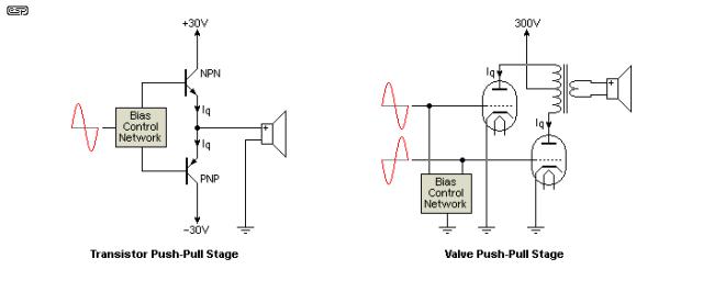

    Re: SVI3206D Hybrid IC ( BC POWER MODULE BY SANYO)
    Originally posted by budm
    "For the pnp transistor connection is
    Collector = Power Rail negative
    Base =Stage output (audio out)
    Emitter = Signal input (audio signal) "
    Emitter is the output. Emitter of the NPN and the Emitter of the PNP are electrically connected together to form output pin for driving the speaker.
    See figure 4 for basic push-pull output.
    http://sound.westhost.com/articles/amp-classes.htm
    That is a great site for learning.
    yeah thanks i have just take conscioence of that , PNP^push on speaker , NPN pull on it , at itle Both center the speaker to 0 in function of the bias setup , i think i know a new book now and i fkin love that

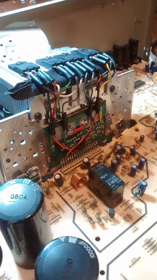

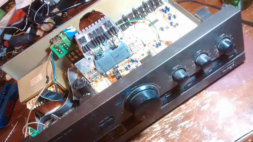

              i wait this moment since 2 days now , then now i fear to plug it . ajaha okay i test that , it work or it blow , what can i do for check before putting AC on it? any hints ? ohh noo no question to plug this amp without recording that ! , phone need to be charg'D

                  #48
                  Then the fuse blowed ,
                  i will remove the 4 transistors then try again without load ,
                  theses pnp/npn come from a non working amplifier , so i asssume they leak level 100
                  no smoke it will work , , i'm persistent
                    #49
                    The transistors base drive circuits may be damaged when the power transistors went out, they are direct couple circuits. You should plug the unit into the AC socket that will put the 120V lamp in series with the unit you are working on. you can use 60~75W lamp, the lamp will stay on bright if the circuit draws too much current constantly, it saves me many output transistors.

                        #51
                        First REsult : Channel 2 Shorted out Collecter/Emmiter on both devices , channel one look good
                        no smoke
                        115V bulb trick ready
                        1,5 Amp fuse rather 5A
                        Myself AMPlifier
                          #52
                          More likely you have more damaged parts in that module when the power transistors went out the first time.

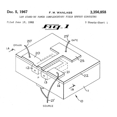

                                    #57
                                    I HAVE JUST FOUD!!!
                                    Theses stranges Transistors on Svi's look like
                                    Nmos transistor
                                    Pmos transistor

                                      #58
                                      here we go !! , so svi's are mosfet based ??
                                      need to sleep
                                        #59
                                        If it is they would have put the word MOSFET on the module to advertise it.
