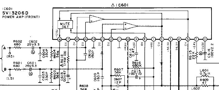

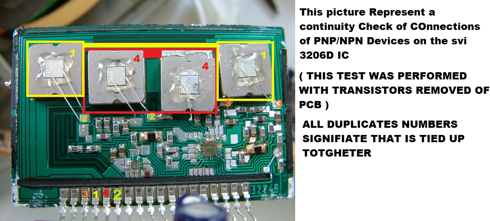

                    Re: SVI3206D Hybrid IC ( BC POWER MODULE BY SANYO)
                    according to diagram of SVI ,
                    pin3=ch1 out
                    Pin4 = +60V
                    Pin5 = -60V
                    pin6 =ch2 out
                    so on my ''mspaint artwork''
                    both yellow 1'S marks Are +60V
                    Both Red 4's marks Are -60V
                    Both Orange 3's marks Are channel 1 Output
                    And
                    Both Green 2's Marks Are Channel 2 Output
                    it leave 4 Connection that is for the signal
                    SVI
                      '1' are NPN (Collectors of both Transistor '1' are connected to +VCC pin 4)
                      '4' are PNP (Collectors of both transistors are connected -VCC pin 5)
                      BTW, what is the model of this amplifier?

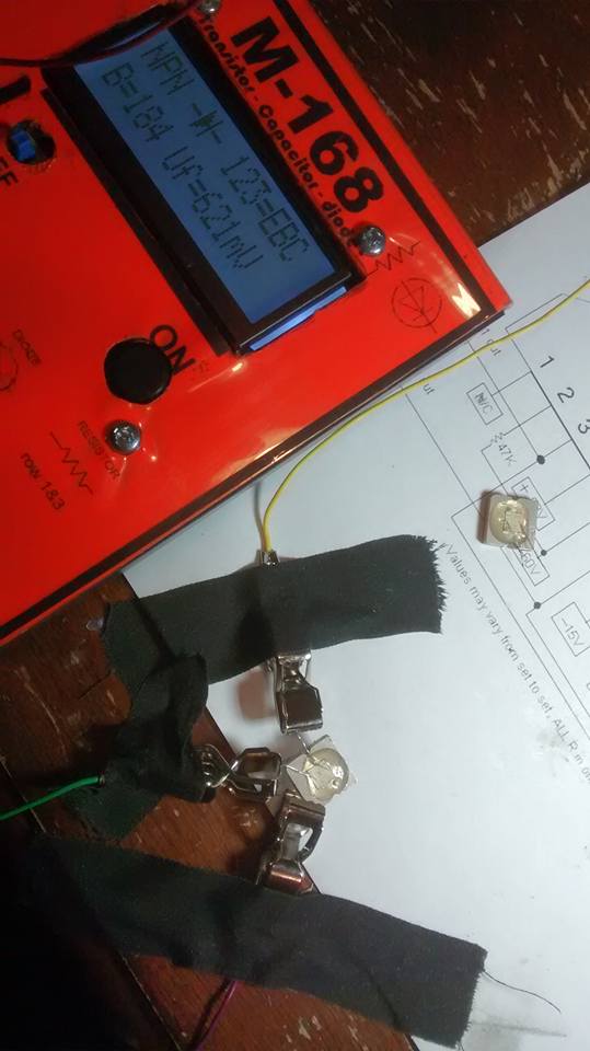

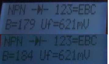

                          thanks a lot !! so now , just need to find somes candidats the PnP device returned P-jfet , with 64Volt look like legit info ,
                          the orange home made box is nothing more than a simple atmega168 electronic device tester found on ebay for 17$ i love it
                            • 31218
                            something is not right.
                            the transistors should all match,
                            you should not be seeing bipolar(regular) transistors and J-Fets.
                            maybe the readings are wrong or one of the parts is damaged.
                                    Originally posted by budm
                                    So far I cannot tell if the output devices are just plain NPN/PNP or MOSFET, cannot find the spec of the module to verify, they do not look like MOSFET.
                                    You also have some ICs in that module too.
                                    yeah ! and these parts have nothing writted on it , its probably under the solder
                                    npn pair is still intact
                                    but pnp pair is destroyed , i was able to test only one ant its one that returned a JETTE FETTE
