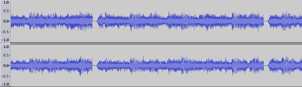

                  Ok, some further information. I managed to make a recording of the dropouts happening (can't post it here, as it won't let me attach an MP3). You can probably see the two gaps caused by the cassette player, and I assure you there is no gap in the music at that point on the tape. Looks to me like an amp problem - the sound abruptly cuts off, remains silent then quickly fades back in. Could it be the caps? Doesn't seem to be affected by moving the unit around or tapping it...
                  Also there are no mechanical switches to get dirty on this. All the switching is done electronically; pressing buttons to select radio, tape or CD. Even the volume control and tuning is digital.

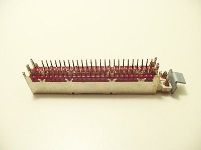

                      If the cassette deck is also a recorder the playback/record switch can become oxidized over time due to lack of use, cleaning it should help. its located inside and activated when the record button is pressed.
                      Its used to switch the head from record to playback.
                      It might look something like this one...
