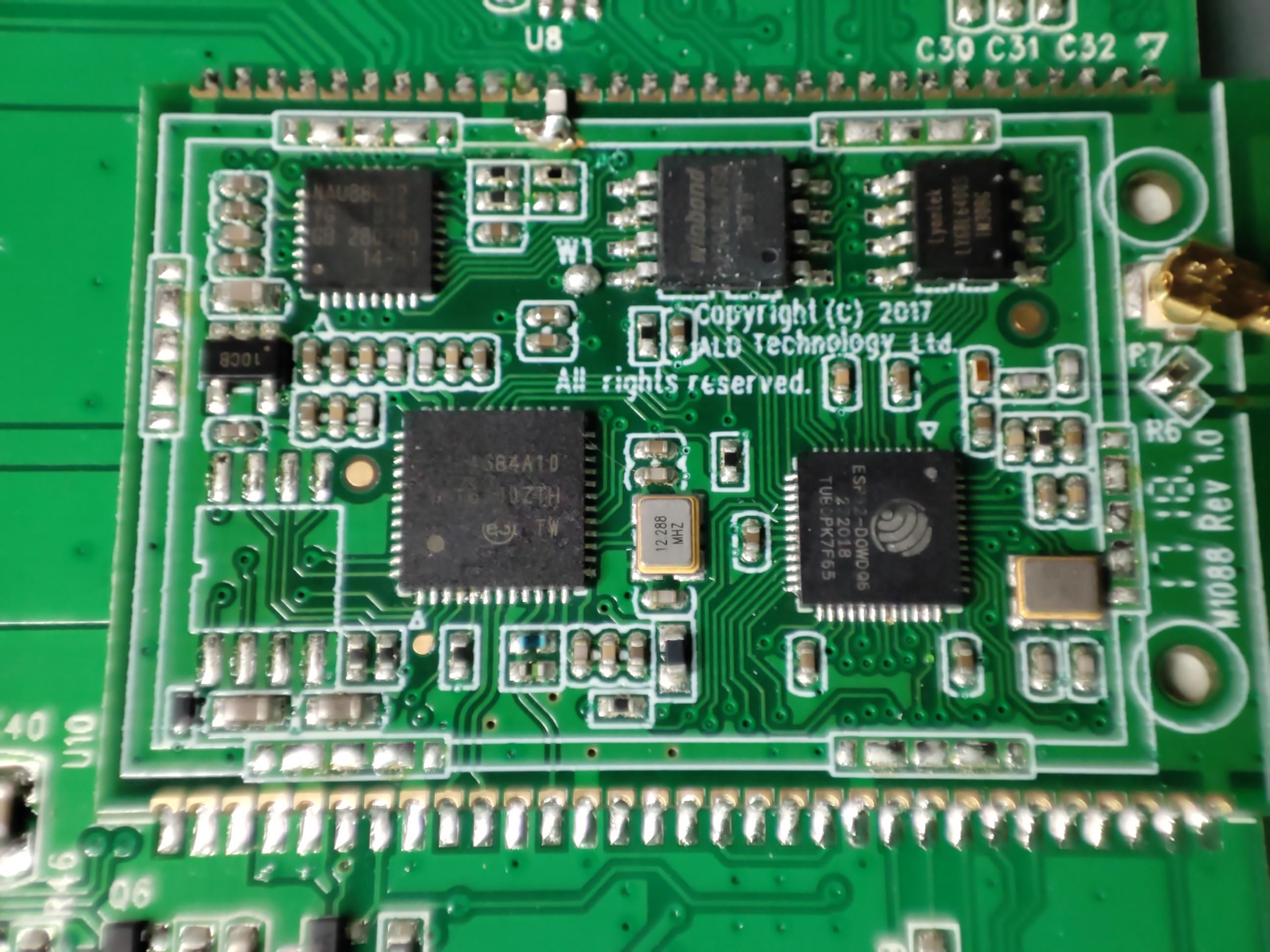

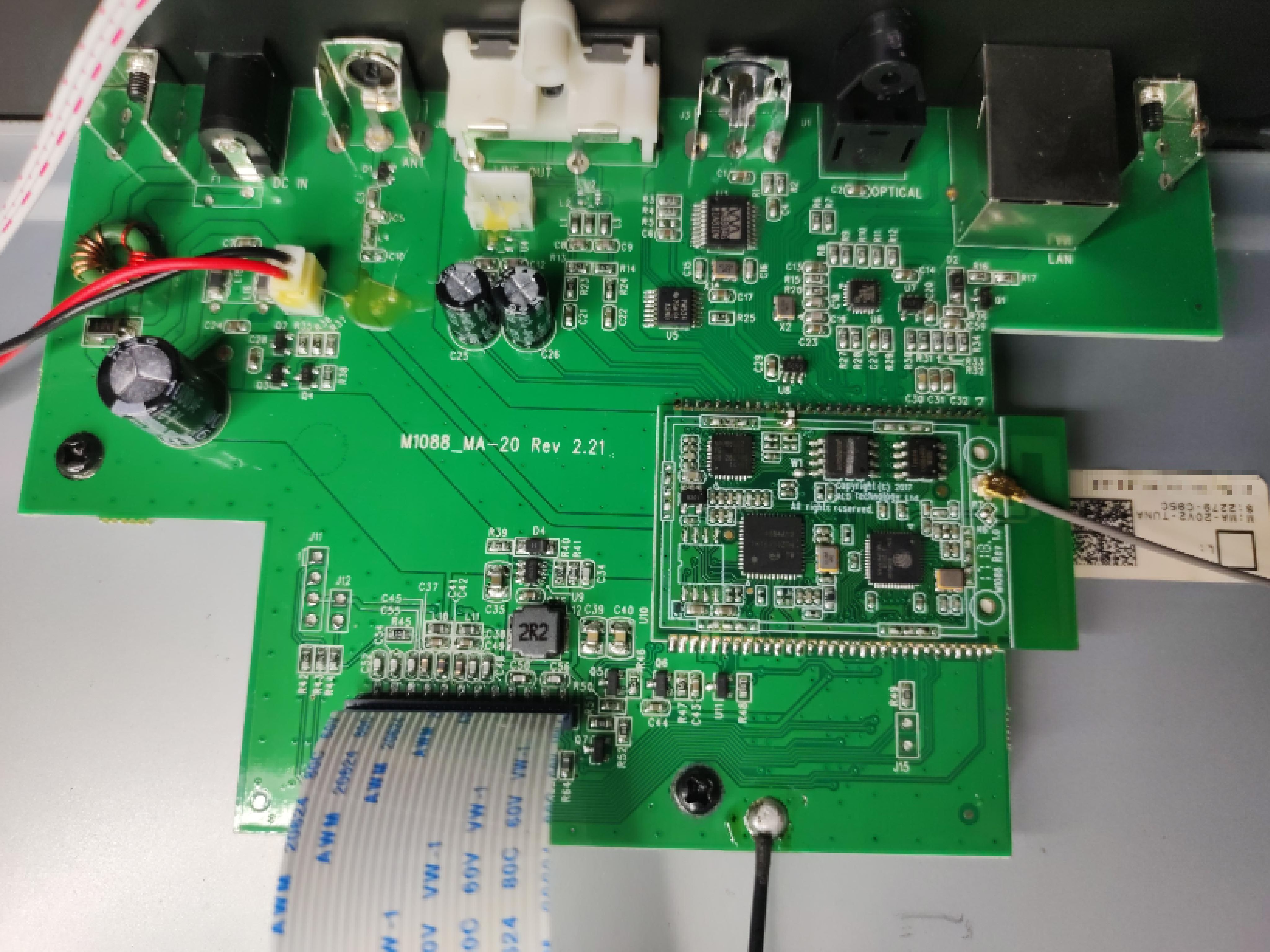

    I've got an Omnitronic TUNA-NET internet radio with an all in one module built around an esp32. The module must be a M1088 from ALD Ltd.
    The device shows only a white display screen pulsing every second. Seems to have some kind of boot issue. All voltages and the pcb thermal signatures look good.
    Any information about the M1088 module, schematics or firmware would be helpful.

    Hooked up a FTDI interface to RJ11 connector and got some unreadable output every second. Looks like boot looping to me.
    Perhaps not easy to solve without a working firmware file...
      Looping output when correct baud rate ist selected:
      Code:
      rst:0x10 (RTCWDT_RTC_RESET),boot:0x33 (SPI_FAST_FLASH_BOOT)
      flash read err, 1000
      ets_main.c 371

        Do you have power on the winbond eeprom (pins 4 and 8)?
        p.s. according to the module brochure, it runs FreeRTOS, so you might want to check it out.

          Power on eeprom pins is fine.
          I tried to in-circuit read the eeprom content with a cheap CH431a reader but got no connection. Doesn't have to mean anything, because CH431 is known for its unreliable results with this eeprom.
          Next step would be to unsolder the eeprom and test. But without a working software doesn't make much sense.
          If I don't get it wrong the bare FreeRTOS image could work on the module but wouldn't bring me to a working tuner device?

            I managed to read the eeprom content after I desoldered the chip from the pcb.
              • 31289
              that dump feels bad,
              usually dab software has text strings visible in it.

                Meanwhile I could get my hands on a supposedly working pcb with a different revision. When I connect this pcb to the display front I only get a white screen, too. But the network "backend" is working and I can get a detailed console output.
                Everything except the display (backlight is fine) seems to work with this pcb. The display module should be some kind of 2.4 inch st7789 compatible screen (320x240?) with a 10 pin soldered connector.
