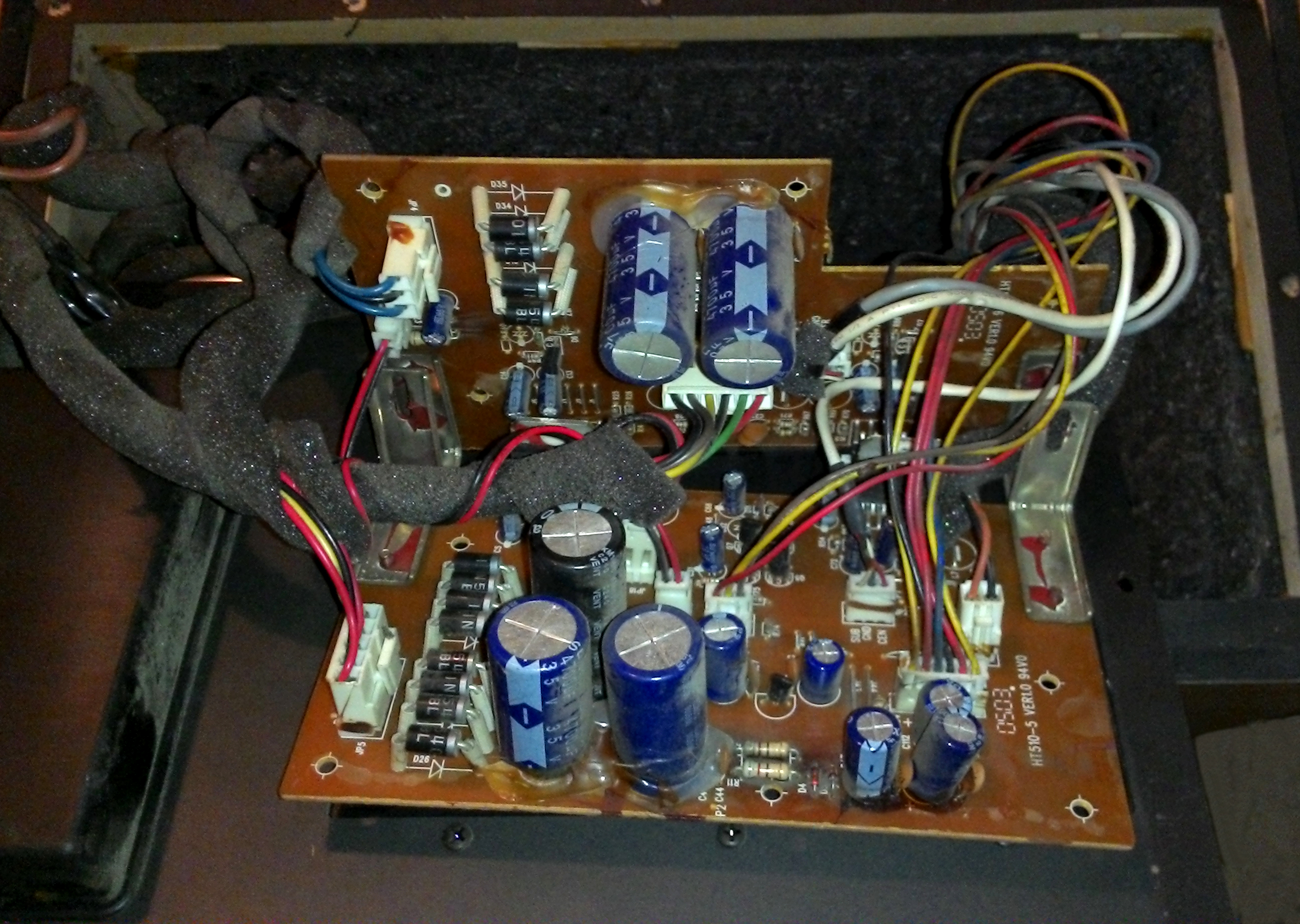

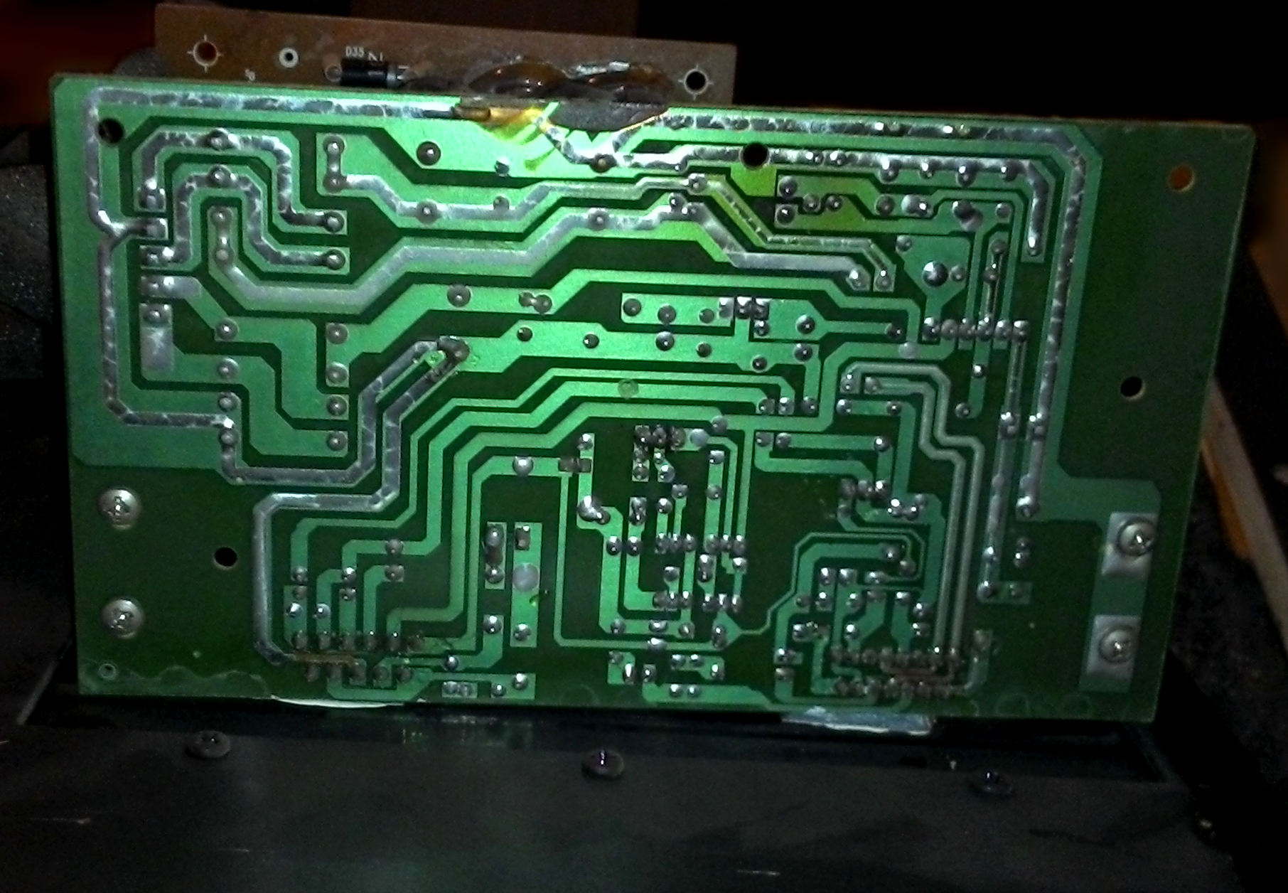

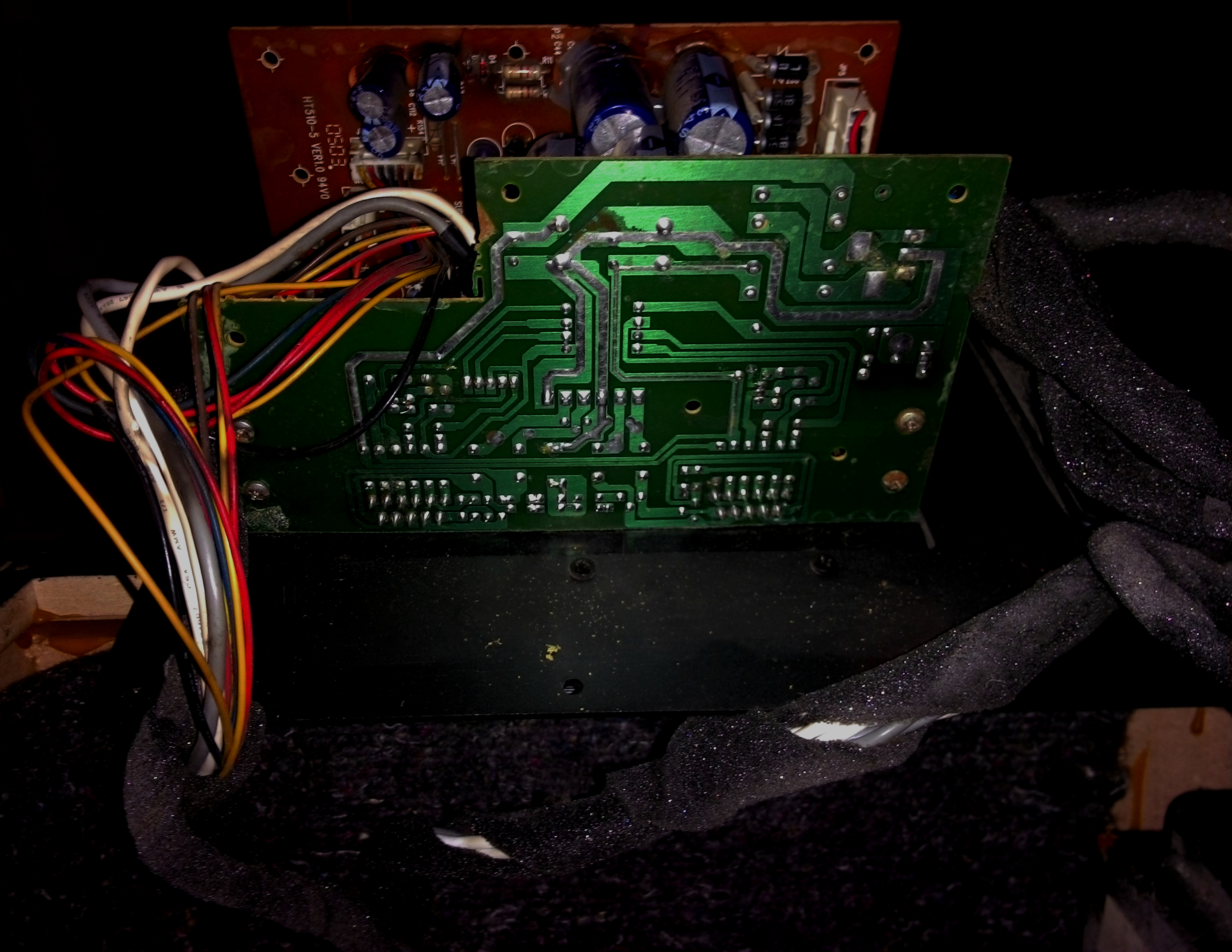

    On to the issue. As the title says, this subwoofer I'm dealing with is having a problem with being partly mute. Of five terminals where you can connect a speaker, only one output works (plus the core subwoofer speaker). Perhaps I'm doing something wrong, but I get sound output only when plugging an external speaker in the rightmost terminal (take a look at the first picture in the attachments), regardless of being in the AC-3 or 2-ch mode.
    I took a photo of the main PCBs in case there's something I've overseen, as well as the service manual (downloaded from here), to clarify at least some of the doubts you might have while reading this post.
    Once again, thanks for your time and any provided feedback!

        Yeah, sorry mate. Pictures truly turned out crappy. Guess setting everything to auto doesn't always do the justice .

          On the 3rd picture you posted, if you look at the top-center position of the picture, you will see a bit of discoloration. On the reverse side (4th picture, lower-center position), it looks like this corresponds to resistors R11 and the resistor next to it as well as diodes D4 and D5(?). If yes, check them with a multimeter. Color bands on R11 appear to be gray, brown, black, gold - which doesn't return a valid E12/E24 series resistor. So perhaps it's white, brown, black, gold? If so, that would be 91 Ohms. If not, then maybe it is gray, red, black, gold? That would correspond to 82 Ohms. Either way, try measuring the resistance with a multimeter and let us know what results you get. The diodes (D4 and D5(?)) should be checked with diode test function both ways.
          I am assuming you know how to use a multimeter. If not, let us know so we can point you to some articles/videos on how to use one.
          Finally, there seems to be burn marks close to another resistor. The resistors is located next to the connector next to connector JP4 (4th picture, upper-left corner of the board).
