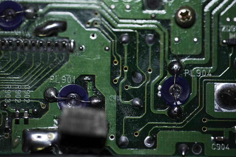

    The control panel of my car stereo has a couple of the LEDs burnt out and I would like to ask a couple of questions:
    • I checked the LEDs using "continuity" on my VOM - is this the best method to determine if they are burnt out? Two of them had no continuity.
    • To remove/replace them I was planning on just cutting the wire leads and pulling them out - then resolder new ones - is this the way to go?
    • How can I figure out where to get replacements? What voltage are they - will the LEDs have that info on them?
    Thanks Appreciate any help.

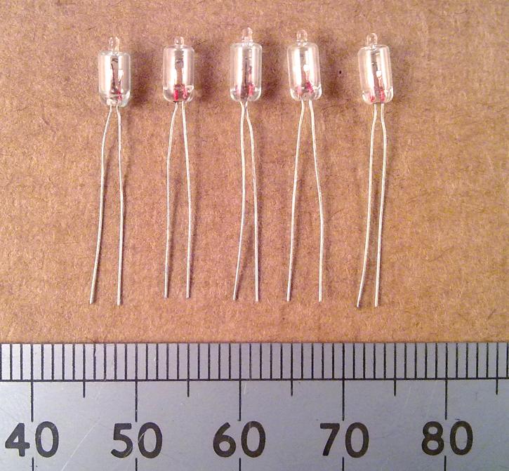

        Those are miniature incandescent lamps inside a sleeve, not LEDs.

          Re: Car Stereo LED's Burnt Out - Replace?
          Something like this?
          http://www.mcmelectronics.com/product/25-1370
