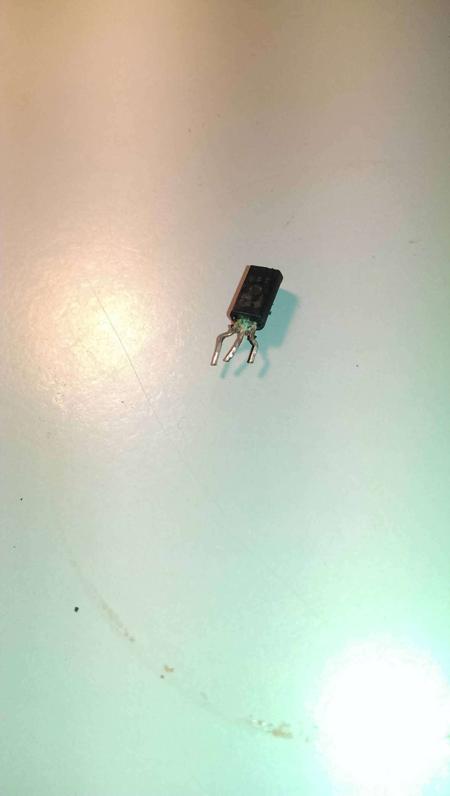

                                Q510 q511 both look like this, I'll post my readings when I get up. All main resistors test ok, going to go over them all again tonight with a list of the expected values for a more precise outcome, ive bought a d667 and a b647 and a c3228 and also an a1275 wait for delivery...., and another pair of output transistors, gunna power the board today and take some voltage readings too. do you think these 2 transistors have failed?

                                  Re: monitor active sub- instantly blows output transistors
                                  The picture will not load for me.
                                    strange, can you see this time?
                                      I think I see a piece blown out of the epoxy, so its likely to be blown open circuit.
                                      The green between the legs looks like corrosion caused by a liquid spill.
                                      Are there other signs of liquid spill?
                                        no its just Q510 and Q511, i cleaned this one up and the corrosion stripped it back to copper, maybe their toast, anyway ordered some new ones off ebay, how do i go about using a 75watt bulb in series with the power lead?
