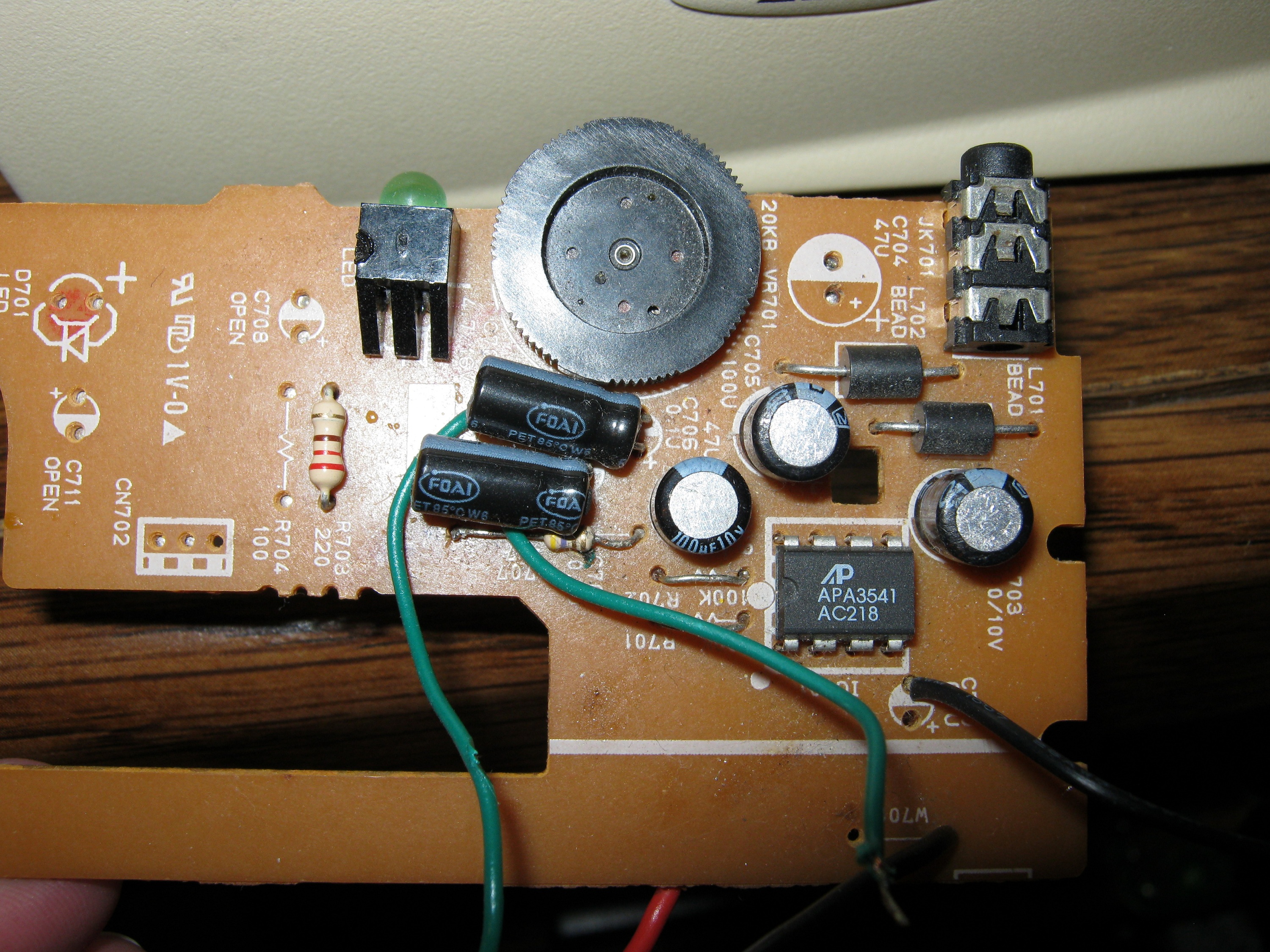

      Here is the APA3541 board in its current state. The green wires are the inputs and will go to the filter board.

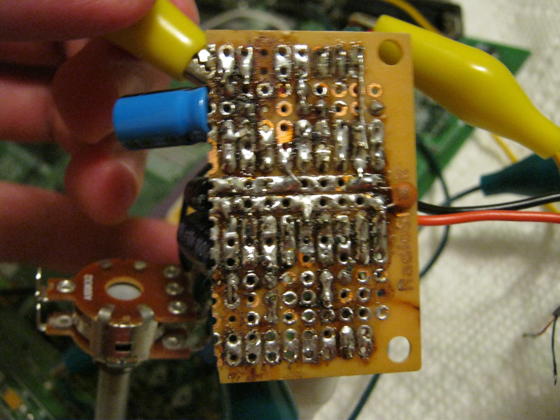

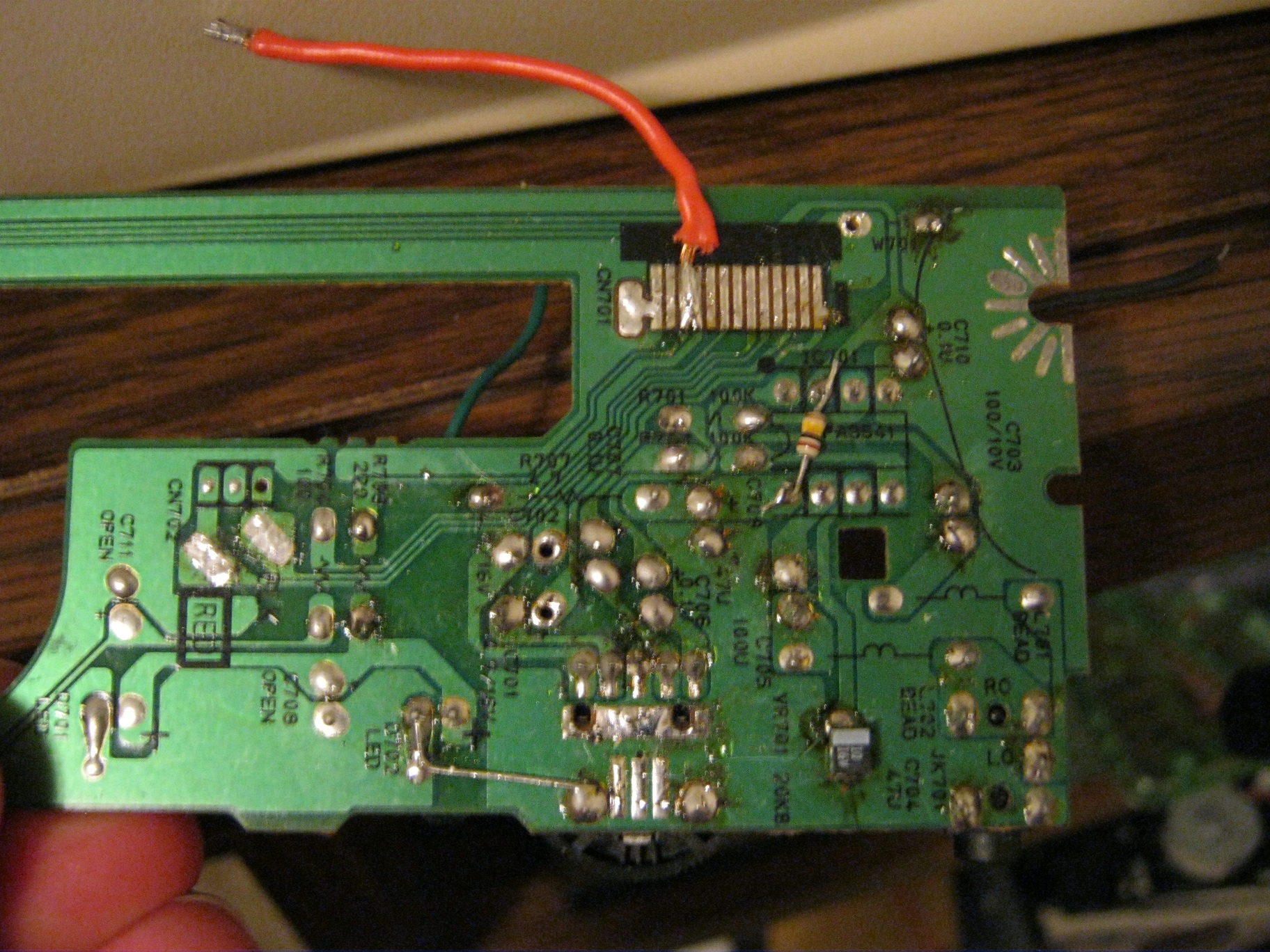

        Re: Headphone amp design
        I finally built the filter board. I didn't have any 0.01uF caps besides the good ones I was saving for breadboard use, but I had a ton of 0.047uF ceramic caps. I changed the resistor value to 1K ohm to get the same -3dB point. Unfortunately, that attenuated the treble too much. It sounds fine most of the time, but some songs sound horrible because there isn't enough treble.
        The output coupling caps are too small as well now that I have some 24 ohm impedance headphones. I don't know if either amp chip is powerful enough to give those headphones decent bass. They sound best on a TDA2822M with 470uF coupling caps and a 5V power supply (aside from the background noise), which is rated for slightly less power than the TDA1308 with a 32 ohm load and a 5V supply. That MS6308 will probably make a nice amp, but I will need a through-hole adapter (or build my circuit dead bug style) to use it.
        Also, for some reason, the resistor in series with the power LED (R703) is getting warm. That used to be the activity LED, but I connected it to the power input for the APA3541. It was nice of Samsung to put those pins next to each other in the ribbon cable.

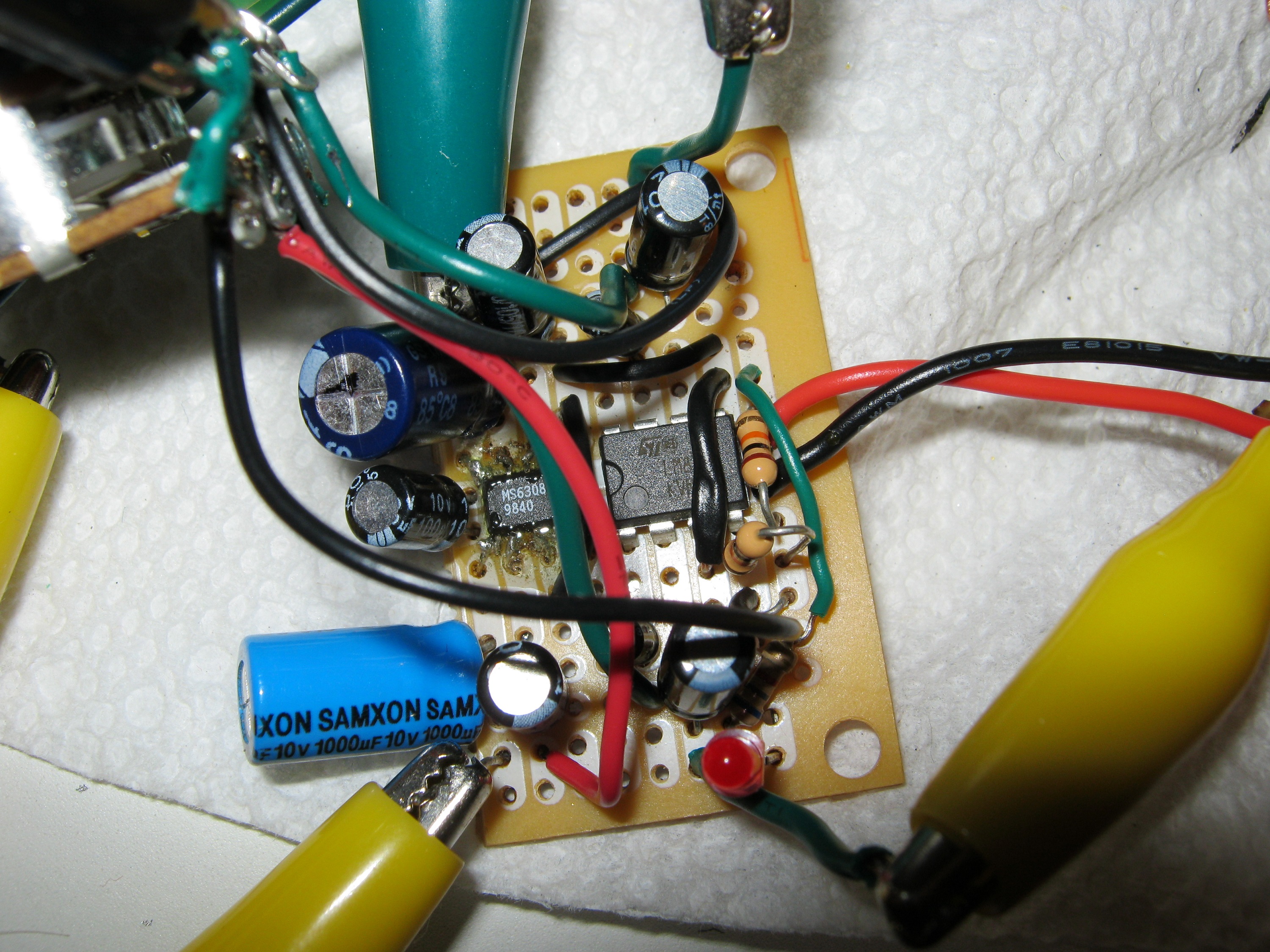

                        I got the MS6308 amp mostly working. The chip is still soldered in the board, but I disconnected the input and connected it to an inverting amplifier.
                        I currently have the circuit designed for a single supply with no gain on the MS6308 and an inverting amplifier with a gain of 2. I modified my old failed CMoy amp into the initial inverter/gain stage. So far, I can't really tell how it sounds since I haven't connected it to a decent audio source, but I can tell that the potentiometer I'm using is a piece of crap (the volume level in each channel channel is always different) and there is a loud hissing on the output when the volume is turned all the way down. Also, it sounds like the signal is still inverted.
                            I finished the MS6308 amp today. I just need to get some more audio jacks. I'm using a 78L05 with a diode in series with the ground pin to supply 5.6V to the amp. That isn't very good for battery power, but that was what I had. A 9V battery is nearly dead anyway when its output voltage gets low enough for the regulator to drop out.
                            I'm getting a ton of bass in those Philips headphones. I didn't know they could play such low frequencies. The sound is also a little strange. It's distorted in a lot of the audio range, like there is some noise mixed in with the audio signal or it is always clipping. That might be why the MS6308 had caps in parallel with the feedback resistors on the motherboard. I remember those caps doing something to reduce distortion in higher frequencies.
                              The cap is for limiting the high frequency bandwidth of the amplifier, as the frequency goes up the Xc goes down so you get more negative feedback as high frequency goes up so the gain is reduced. You should look at the output with scope to see if it has any high frequency Oscillation.

                                    From looking at the board, I cannot tell how you have the ground for the input signal and the Ground for the output connected, proper ground routing is very important.

                                      I don't have the input or output wires connected yet. When I get the input and output jacks, I'll get as close as I can to a star ground.
