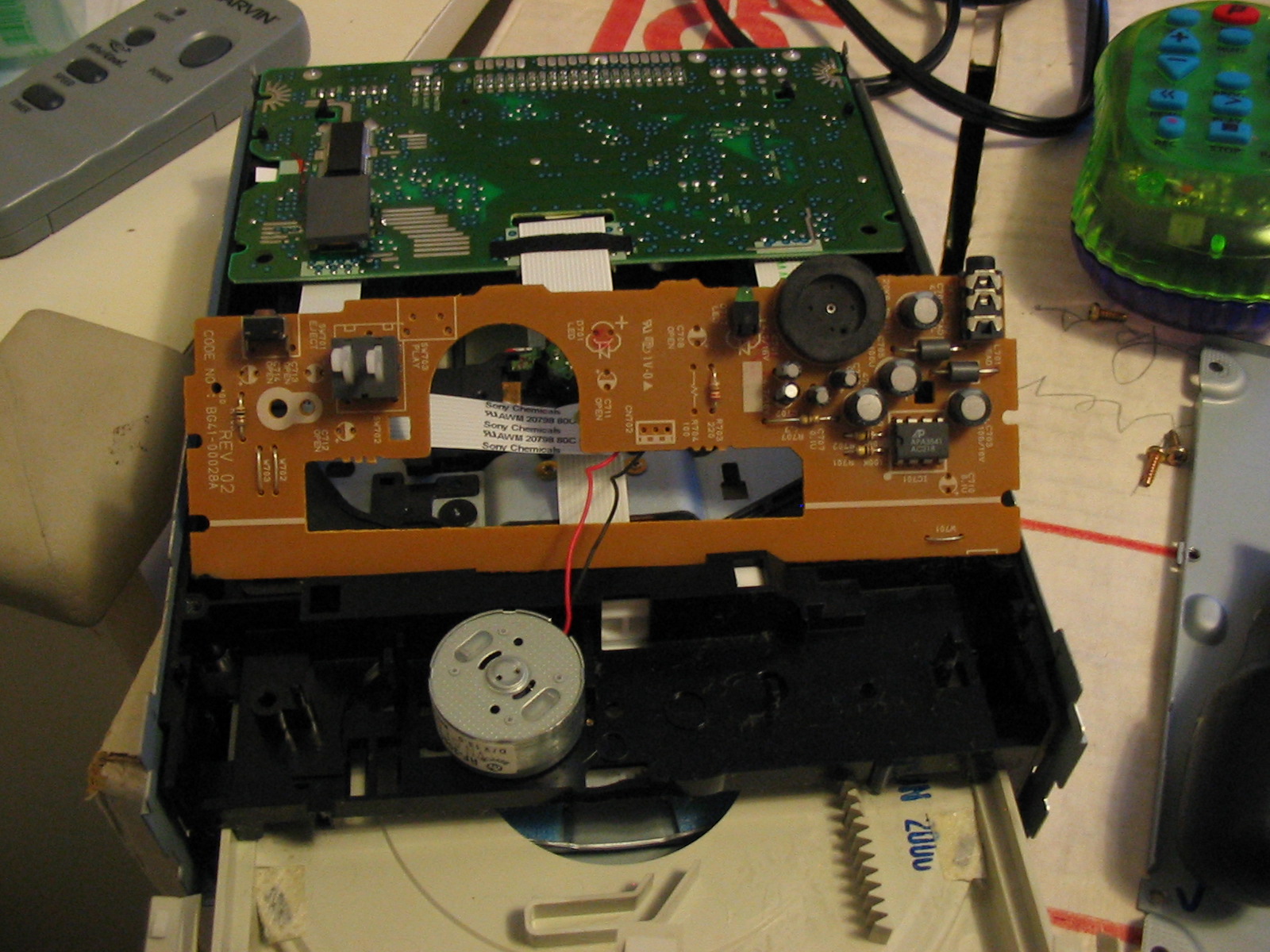

    I want to improve some headphone amplifiers that I have. One is based on an MS6308 (a TDA1308 clone), and the other uses an APA3541.
    I have two MS6308 chips. One is used as the headphone amp in my computer, and the other is on a motherboard that I have been taking parts from. In the computer, I just need to reduce the gain to match the output of the speaker amp. Replacing the 20K ohm feedback resistors with 15K ohm resistors should work.
    For the second chip, I might try to remove it and use it. I would like to know why all of the TDA1308 circuits I see use the inverting input and place resistors in series with the input. Is there a fault with the chip that makes the non-inverting input not work properly? In the computer, the inverting input was used, but the audio signal it receives is inverted by a TL064.
    The APA3541 sounds horrible. It is the worst excuse for an amplifier I have ever heard. I also have two of these chips, and they both sound the same. I am currently using the circuit board from a CD-ROM drive that had the chip already installed. I modified the circuit to match the application circuit, but with a 20K ohm potentiometer on the input and a ferrite bead on the output (it was already on the board). The high frequencies are extremely loud and distorted, but the rest of the audio range sounds normal. I think I need to add a low-pass filter. It sounds okay with a 0.22uF cap from the input to ground or a 47uF cap from the output to ground, but those aren't ideal filters.
    I would like to make the APA3541 usable (if it is possible) and use the non-inverting input of the TDA1308.

      If you're asking about the APA3541, I have no way to change the feedback. I have attached the datasheet for this chip and a picture of the board I am using. I have changed the component values to match the application circuit. There are no resistors in series with the output. The inductors at L701 and L702 on the board (marked "Bead") are in series with the output. I have also left the 4.7 ohm resistor in series with the 5V supply. Bypassing this resistor doesn't affect the sound.
      I have also uploaded the MS6308 datasheet. It is similar to the TDA1308 datasheet and has identical specs, but it has more application circuits. The manufacturer's website redirects to some kind of cartoon porn site. I don't know why anybody would want to look at crappy drawings of people ing.

        I made an acceptable low-pass filter for the APA3541. I am using a 4.7K ohm resistor in series with the input and a 0.01uF cap connected to ground. There is still some distortion (I have no idea where Anpec got 0.03% THD). Shorting the inductors might have had a slight effect, but I'm probably imagining it.

                The bias cap doesn't seem to have any effect on the sound quality. The circuit originally used 0.1uF caps on the input and a 47uF bias cap.
                I don't think the output power is the problem. The low frequency response is actually better than the TDA1308. The filter I added has a -3dB point above 3KHz.

                The APA3541 has no background noise. I never tried adding a snubber or checking the bias. The MS6308 inside my computer picks up some background noise (including some subsonic noise), but that was reduced significantly when I reduced the gain. I ended up using 10K ohm resistors, and the headphone output is still a little louder than the speakers. Unfortunately, the next lower value of surface mount resistors I have is 1K ohm.
                The LM386 makes a surprisingly good headphone amp. The LM386 chip I have sounds horrible with a load of less than 16 ohms. With headphones (32 ohm load), the sound quality is the same as a TDA2822M (the high frequencies are a little too loud), but there is very little background noise.

                        For the MS6308, I am powering it with a 78L05 regulator fed from the computer power supply's +12V rail. The APA3541 has been powered by many sources. I am using crappy $10 Philips headphones.

                        The headphone amp I usually use is the amplifier from some old computer speakers. It uses a TEA2025B and a tone control circuit. It is picky about what coupling caps are used between the tone control circuit and the final amplifier, but it works very well. I can just use cheap Philips headphones and it sounds as good as larger, more expensive headphones. If you look at the TEA2025 datasheet, you wouldn't think an amp based on that chip could ever sound good. Of course, it isn't very portable. I would need to find an enclosure for it and bring a ton of batteries, and I want to find replacement drivers for the speakers (one blew after the caps failed in the amp).
