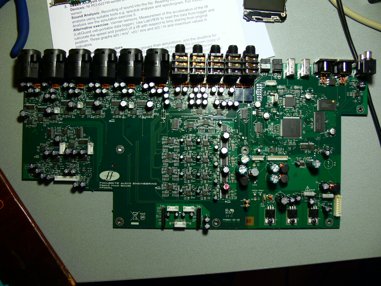

    I got this lovely and versatile audio interface a couple years back, for some multitrack recording with my (former) band, and as a "foundation" for my (future?) home-studio.
    A while back, i decided to "pop the hood" and check out the insides. The PSU made me cringe - C(r)apXon It puts out 5v for the digital/logic stuff, +/-15v for the analog stages, and 51v for the phantom-power. I haven't yet replaced the mains filter cap (since i figured it's not under THAT much strain, plus i don't have a suitably-sized one in stock... for now ).
    Re-cap stage one:
    - the 5v line received a 1200uF/10v Chemicon LXV before the inductor, and an 1800uF/6.3v KZJ after it. This is the rail where the feedback is taken from.
    - the +/-15v rails got a pair of 470uF/35v Panasonic FR each
    - i left the two 100uF/100v CapXon GS in place, since i didn't have such high-voltage caps (for now), and the phantom power isn't that power-hungry anyway
    While i had the psu out, i decided to upgrade the switching FET and the 5v rectifier. FQPF8N60C got replaced by a 2SK2761, and i slipped in an STPS2045CT instead of the MBR10100CT.
    Throughout the rest of the inside (ie. the main board), Jamicon SK (85c general purpose) as coupling and power filtering caps, and five Samxon GF 220u/50v on the 5v / 3.3v / +/-6.9v outputs. The +/-6.9v and the 48v phantom-power have LM317/337 voltage regulators on them, and they had SK's right at the output, then an inductor, and then the Samxons.
    The attached pic is a "before" shot of the mainboard

    Re-cap stage two:
    - analog input caps = 47uF/63v Panasonic M (i still have 24 of them to change, out of 32, 4 per input - two for the mic in, and two for the line in)
    - analog output caps = 220u/16v Rubycon YK (100u/25v originals), 20pcs
    - preamp gain control DC blocking caps = 1000uF/6.3v Rubycon YXG (470uF/16v originals), these are the 8mm dia. caps on the left half of the board
    - ADC input buffer coupling caps = 47uF/16v Chemicon SMG (10uF/16v originals), the 8 tiiiiiiiny caps in the middle of the board, each near an SOIC8 opamp
    - Filt+ filter caps for the codecs = 330uF/6.3v Sanyo ME-SWG (10uF/16v originals)
    - Vcom filter caps for the codecs = 510uF/4v Sanyo OsCon (470uF/16v originals)
    - headphone amp input caps = 22uF/50v Panasonic FC (10uF/16v originals), between the three white 5-pin headers in the middle-bottom of the board
    - heaphone amp +/-6.9v filter caps = 470uF/10v Chemicon SMG (47uF/63v originals)
    - 3.3v filter caps = 2x 2200uF/6.3v Rubycon MBZ (green Samxon originals, 220u/50v)
    - 5v "out" cap (post-inductor, near the 5-pin J22A) = 2200uF/6.3v Rubycon MBZ (ditto)
    - +/-6.9v post-inductor caps = 2x 1200uF/16v Rubycon ZL
    - 5v in filter cap = 1000uF/16v Panasonic FL (8mm cap in the bottom-right, near the white power-in header)
    - +/- 15v in = 2x 100uF/25v Chemicon KMF
    - +/-6.9v out (at the LM317/337 outputs) = 2x 470uF/10v Chemicon SMG
    Once i'm done with the remaining 24 input caps, i'll add an "after" snapshot as well

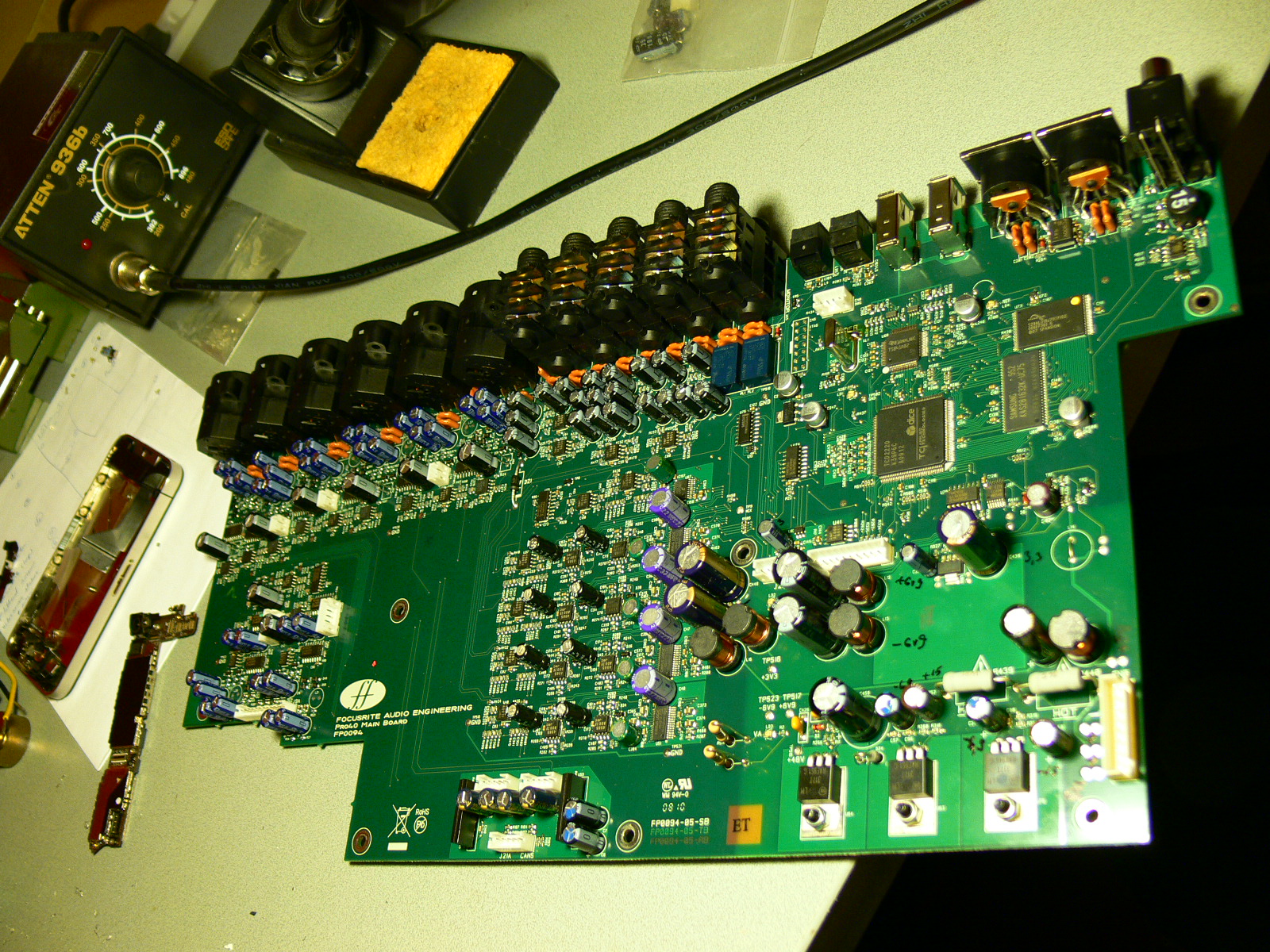

            Okaaaaay, re-cap 100% completed, at long last
            I've already got "phase two" in my sights: replacing all the op-amps with NJM2068's (lower noise, slightly higher GBW, open-loop gain and slew-rate).
            Anyway, as promised, here are a few "after" snapshots

                Well, getting those C(r)apXon's out of the power supply was at least for "peace of mind", because CapXons WILL fail, sooner rather than later.
                Regarding the rest... See the second post before yours
