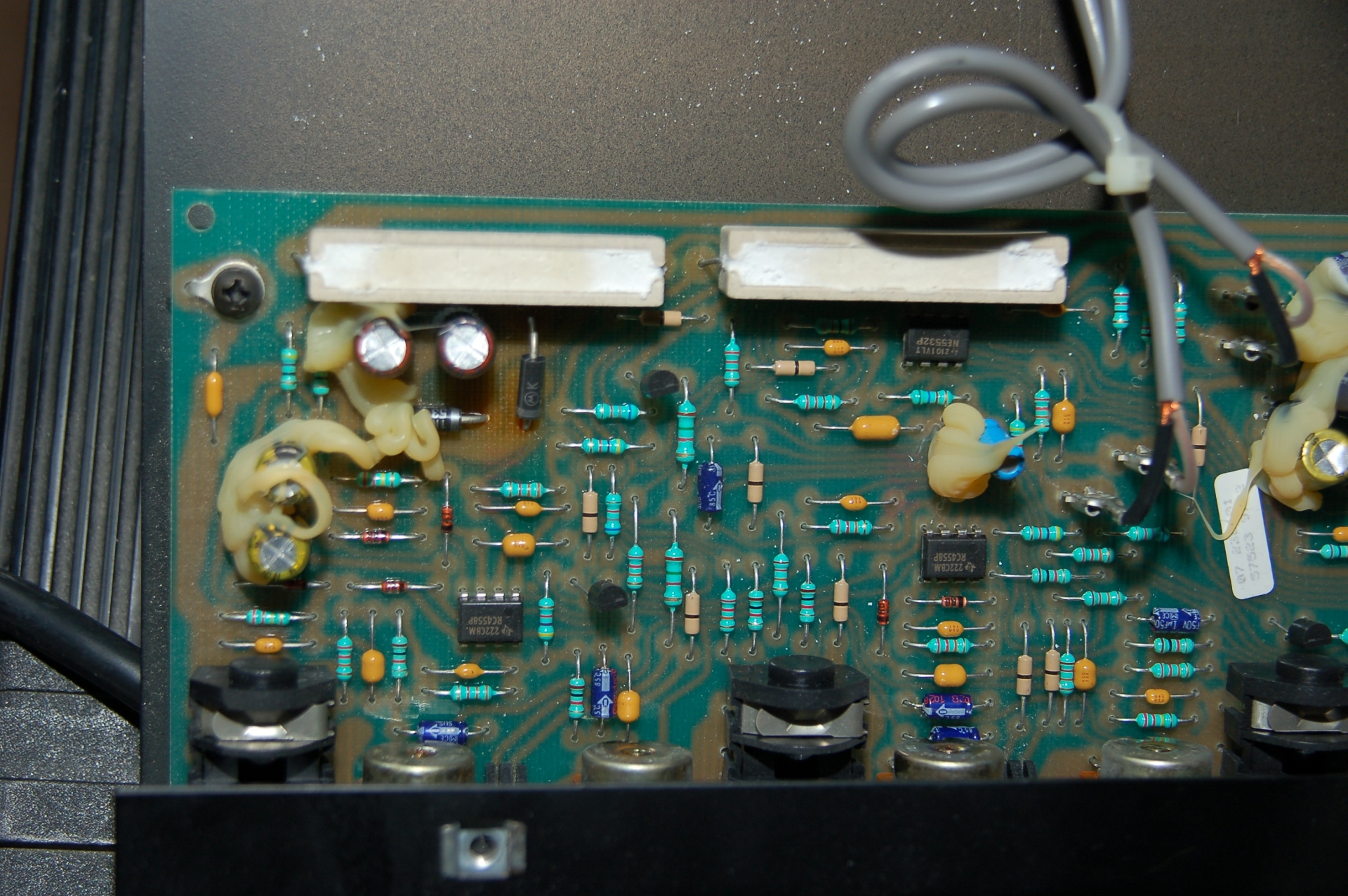

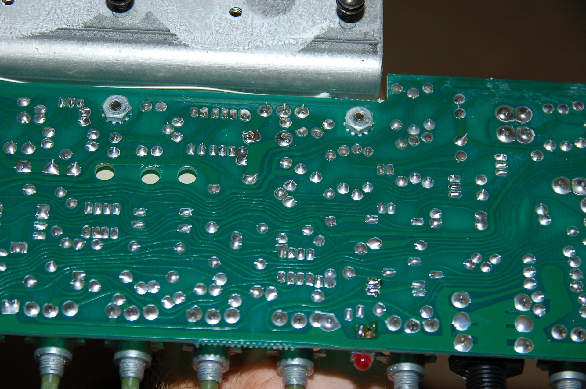

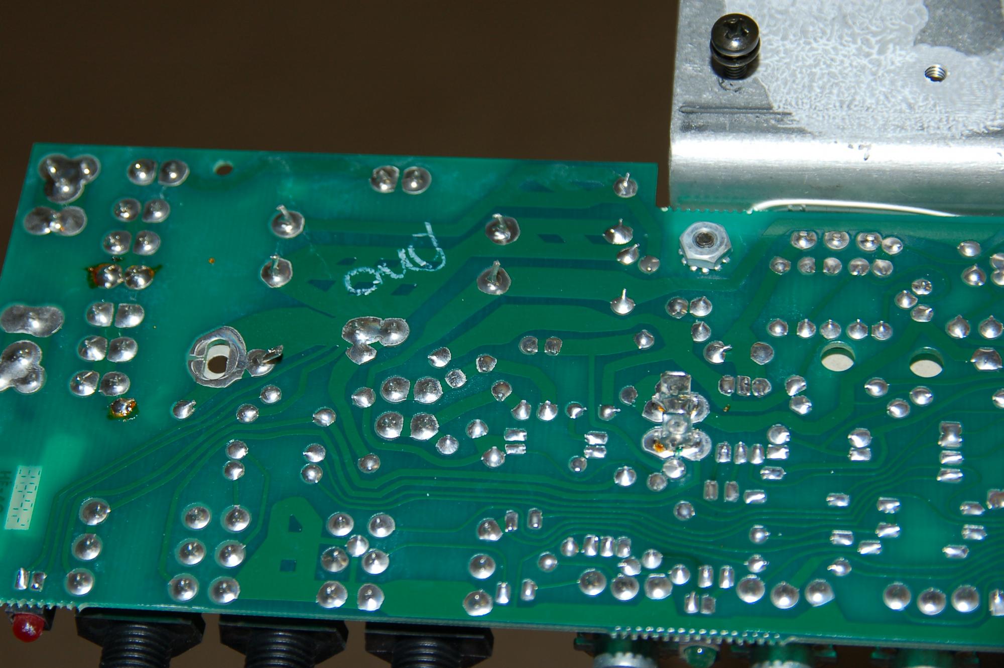

    Hello, I have a Crate keyboard amp that I use as a monitor that has been dying for a while, I think, and finally bit the dust. What happened this time is I turned the power switch on and immediately I saw a bright white/blue flash inside the case around the side of the cover, and all the LED's blinked and shut off immediately.
    Prior to this, when the power switch has been turned off, it clicks or pops, then a high pitched squeal that goes up in pitch for a second or so then it shuts off.
    But that has been going on for a long time.

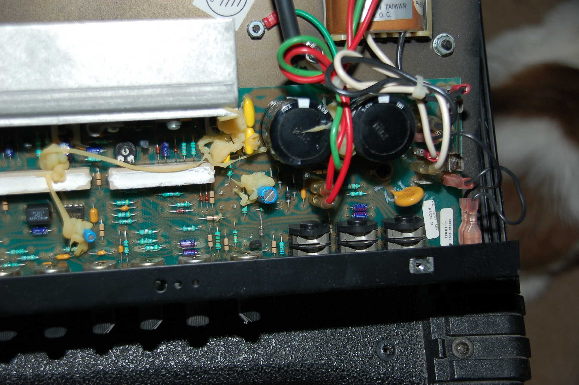

    So, i opened up the case, replaced the 2Amp 250V slow blow in line fuse, tried it again, immediately it blew.

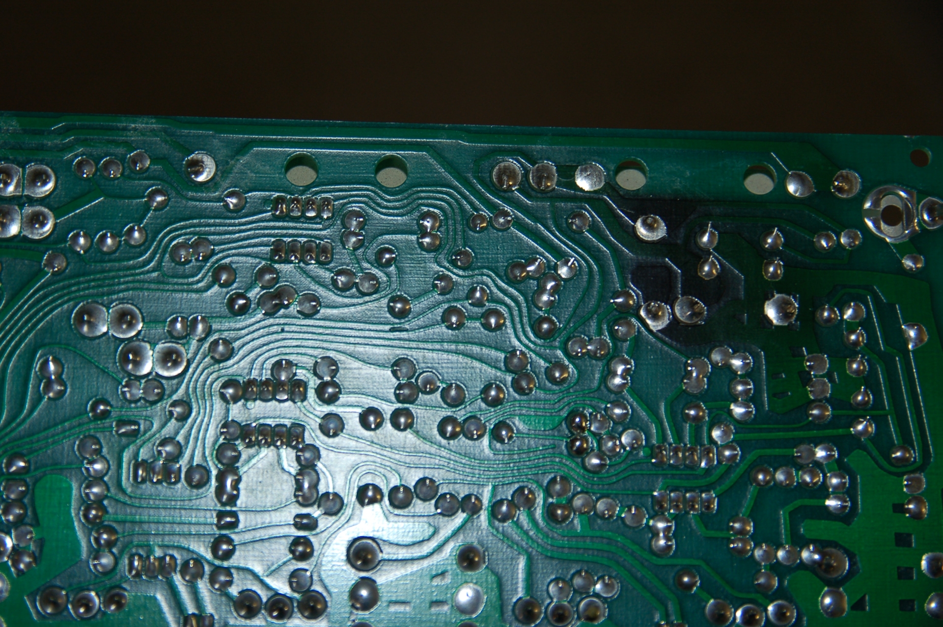

    I have pictures of both sides of the board, I did notice an area that looks like it is burned or was heated. Can anyone identify what the components are in this area? I know what capacitors look like, but its the black thingies that I don't know what are.
    Anything that would immediately come to mind would be appreciated also.
    thanks in advance, AJ

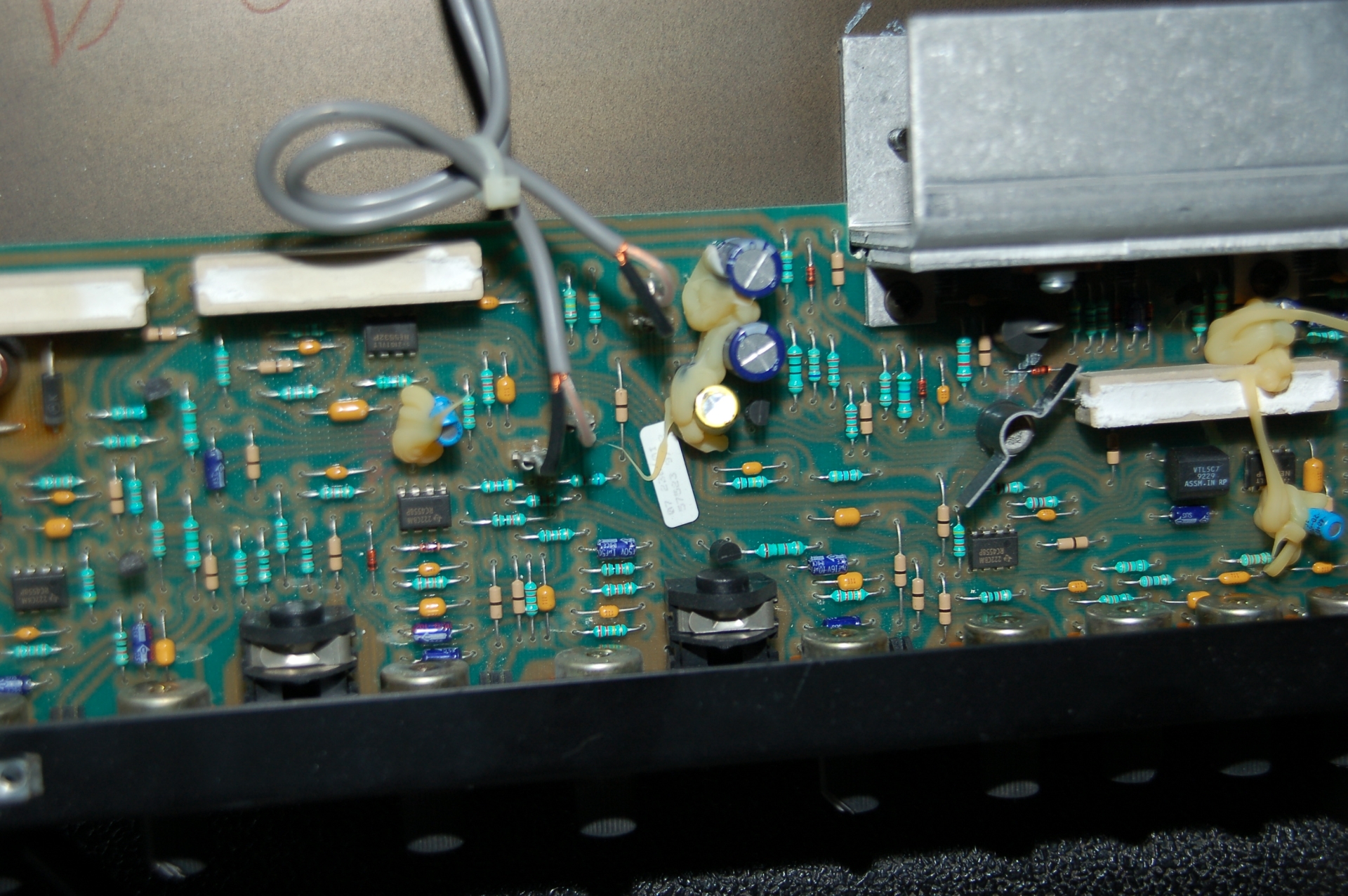

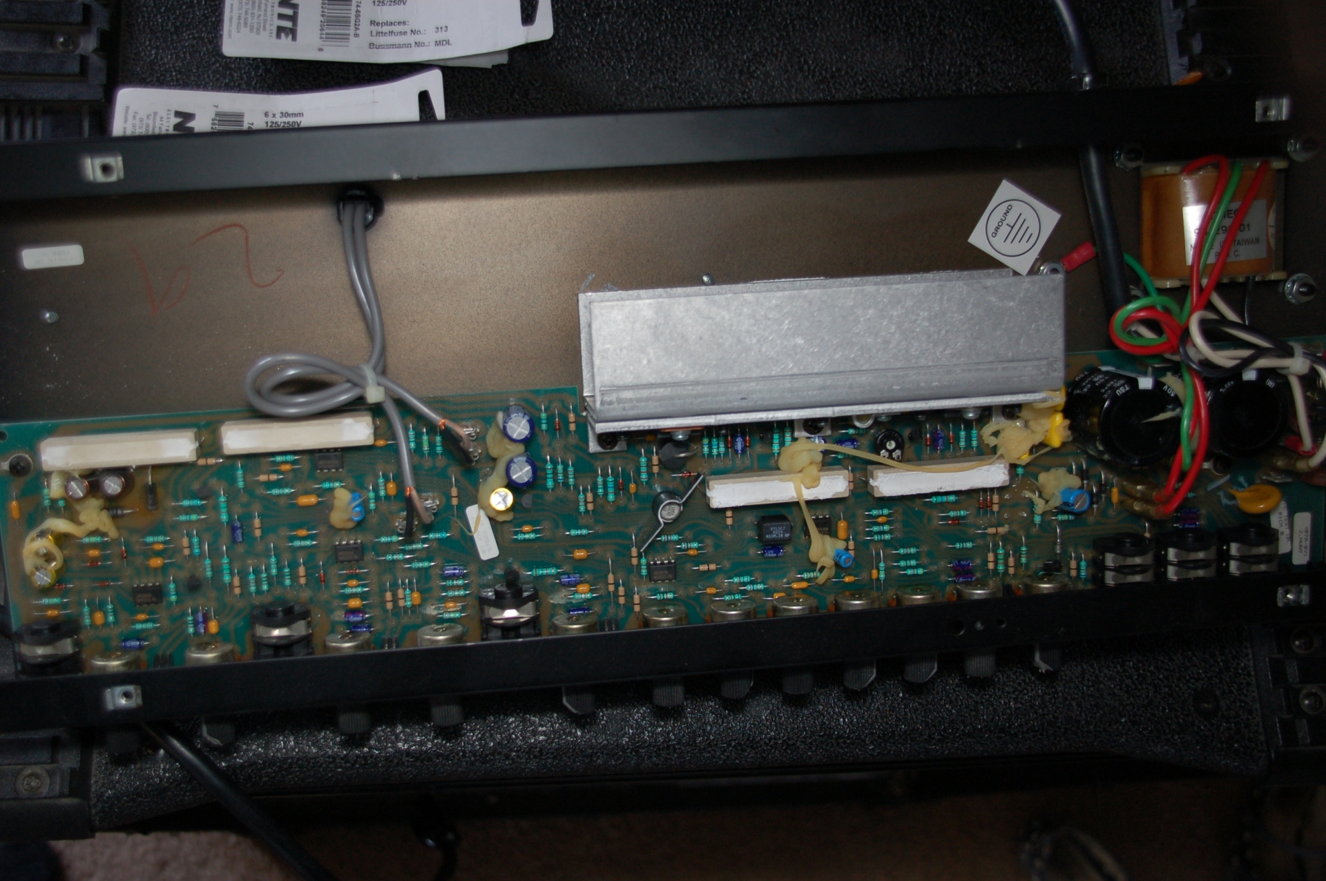

    photos...

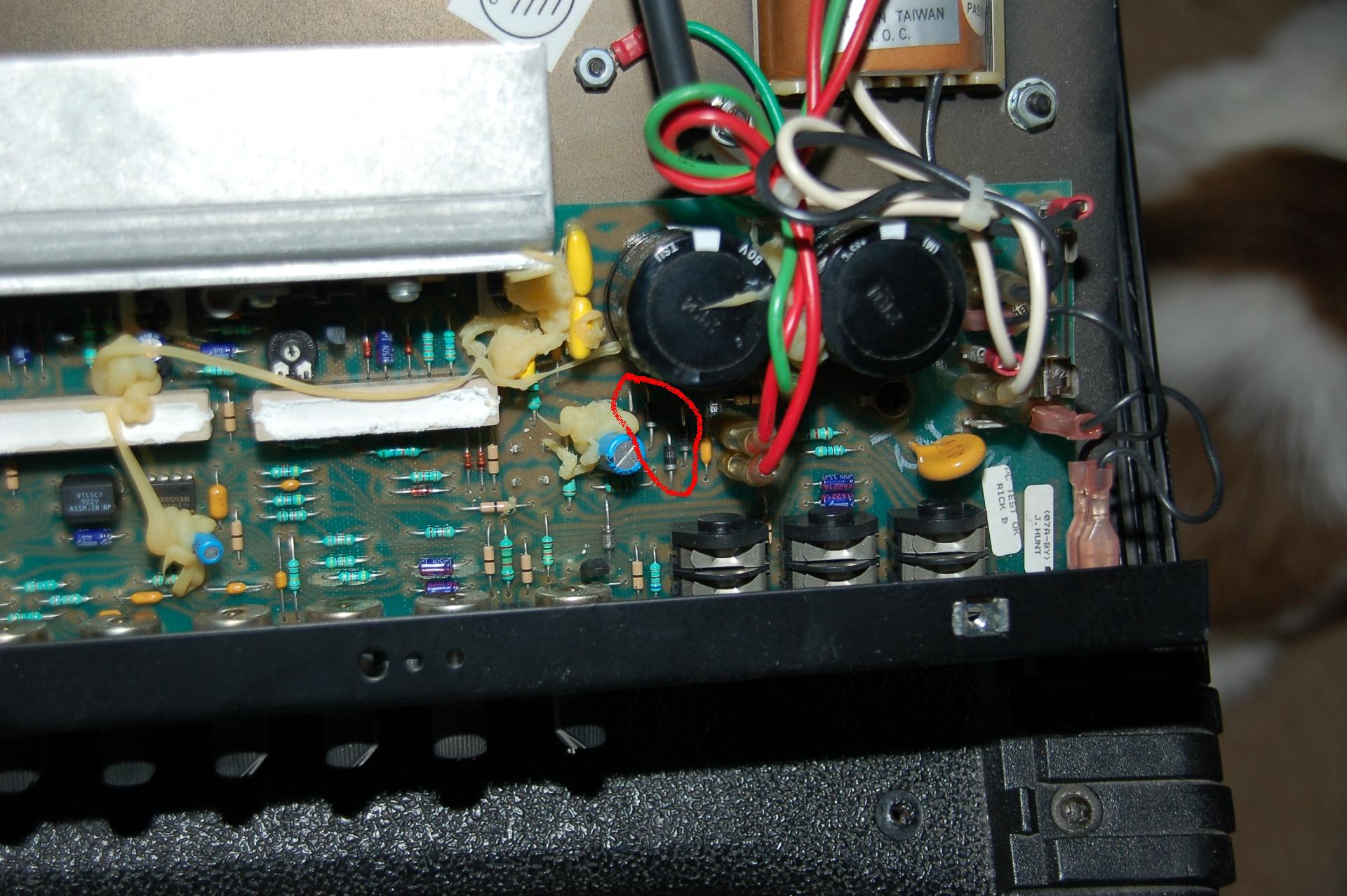

      1) Circled in red are four diodes that probably act as a bridge rectifier. If your fuse is blowing as soon as you apply power, one or more of these diodes could be shorted.
      2) Use your multimeter's diode test function to see if they are bad. Post your measurements. You should have 8 readings (2 per diode).

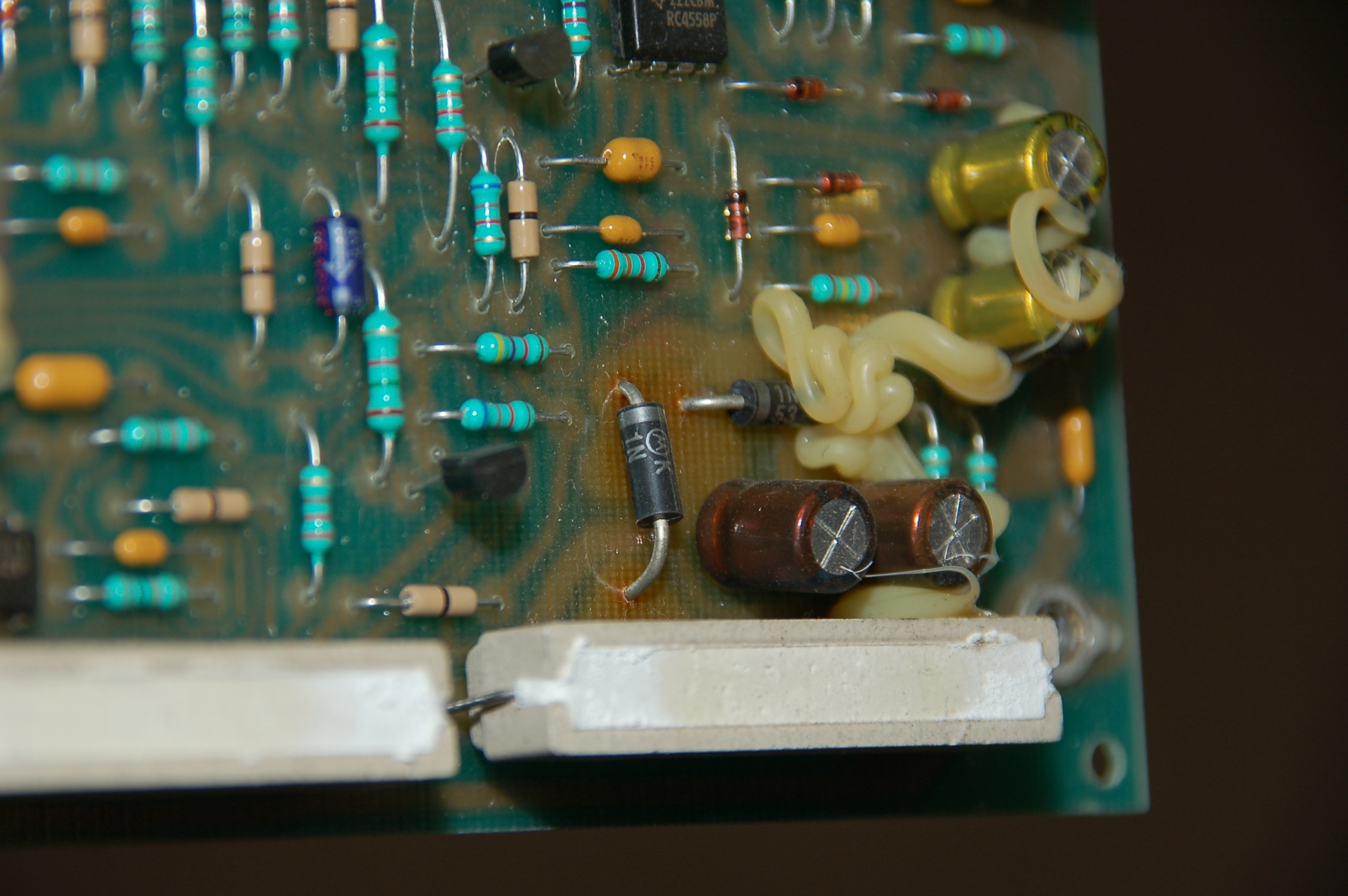

        The darkened area appears to have a couple diodes, but at least on one I see "1N 53..." which is usually a zener diode. Can you get the complete part # off both of those?
        Is this a single output channel amp, meaning it only drives the one or pair of integrated speakers? My first guess would be it blew one of the output transistors on the heatsink.

          those caps near the resistors are cooked.they should be yellow like the others.
          shorted diodes,shorted transistors on the heatsink are the top suspects.

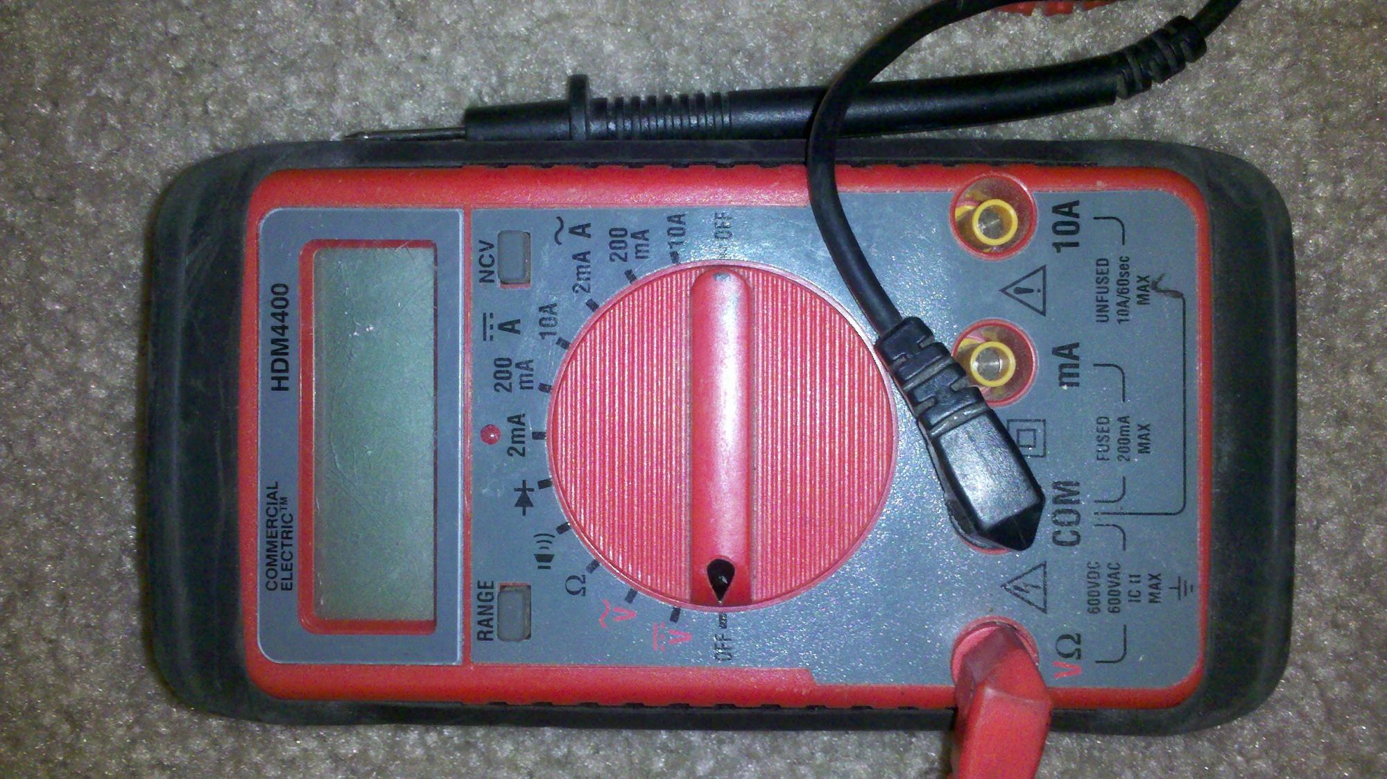

            Well, I haven't taken any readings yet, but I'm going for the RetiredCaps' bonus point!!!! My meter is a Commercial Electric HDM4400 from Home Depot, which I got for $20 because it was misshelved and I argued false advertising... LOL (It was supposed to be $50, but there were a LOT of them on the hangers with the other price. The associate had no problem giving it to me for that price...)
            My price range is at or less than $100 for a meter. I would ultimately like to be at around $40, but as much as I do this, it's time for me to get the right tools for the job. I would like an ESR meter, recommendations welcome. Does an ESR meter also check capacitance? (shows what I know) Also, I was looking at some, and can you use some meters to check components while still attached to the board? That would save some serious time there!!!

              OK, the diodes that 999999999 was asking about: There's an "M" in a circle, then a "K"
              next line, 1N
              next line, 53
              next line, 53B
              next line, (maybe) 229
              And KC8AdU, I can confirm that those are supposed to be the same yellow, the markings on them are the same. 100uf 35V Q192L
              And yes, its 1 channel, to a 15" speaker and a piezo tweeter or something like that.
              there are 2 transistors that I see on the heat sink, maybe a third tiny something or other w/ 3 leads, but I don't know what that is.
                One retiredcaps' bonus point awarded.

                      Keep in mind that while there is a darkened area, it may not be the fault that blew the fuse, might just have been a bit hot running the whole time, though certainly the caps that look like toast should be replaced.
                      Diodes are dirt cheap, you can just clip those off and put in new ones for a few cents cost. The transistors may or may not be easy to find and if not then you'll want to replace both with modern equivalents. Pretty sure the resistor isn't the heat source, the traces where its leads are soldered would be the darkest area instead of off to the side. One of the top down pics shows this fairly well,

                              Re: Crate KX-80 Keyboard Amp fuse pops immediately

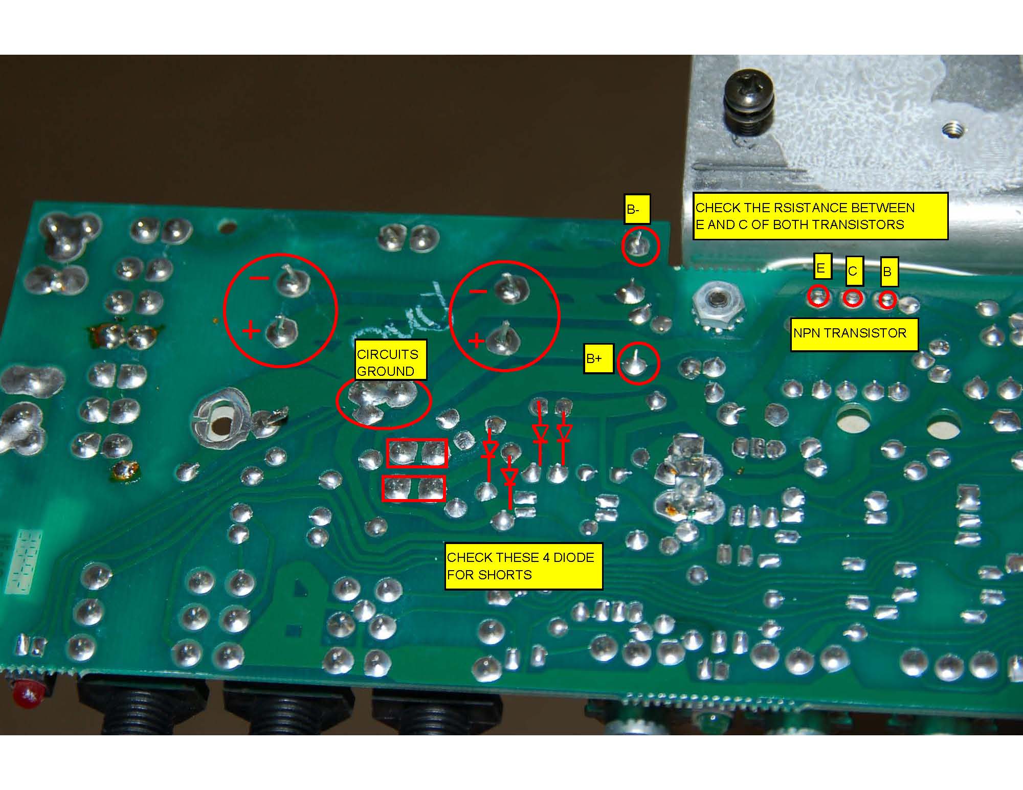

                              The two power transistors mounted on the heat sink with screws are the power output transistors, more likely to be complimentary pair (NPN/PNP) direct coupled output set up so it needs bi-polar power supply set up (Class A/B amplifier). The little transistor is part of the output transistor biasing circuit, it is also mounted on the heat sink so it can sense the temperature of the heat sink, as the heat sink gets hotter (the output transistors get hot), it will reduce the bias current of the output transistors to protect them from thermal runaway (the black small black trim pot close by is for Bias current adjust, it should be set so the output transistors will draw about 20~30 mA at idling). The small transistor with a small heat sink is the Phase splitter driver for the output transistors. The two large resistors by the heat sink are for the Emitter of the output transistors, the other by the other corner of the board are for voltage drop resistors for dropping the main supply voltages (around +/-35Vdc) down to abiut +/-12~15Vdc for the OP-Amps, there should be two Zener Diodes in that section.
                              I need better pictures of the bottom side of the board where the two output transistors are mounted so I can tell you which pins to check for shorts on the transistors (if they are shorted).
                              And just to be sure that we do not have shorted out power transformer, you should disconnect the two red quick connectors (they are the secondary winding of the transformer, there is another wire for the center tap of the transformer, it looks like the green wire) from the board and see if it still blow the fuse.
                              If it does not blow the fuse, then also measure the AC voltage on those two red connectors so we will know what DC voltage this thing is running at.
                                Here are the test points for you to check.

                                  Ok, all this testing was done w/ the diodes in circuit and transistors in circuit. I didn't desolder anything at this time. If that is bad, or would give wrong readings, shame on me and I'll redo my tests...
                                  Bottom line, 2 of the 4 diodes that are in the bridge rectifier that RetiredCaps' described are 0'd out. So, i'm assuming those are toast. The other 2 read .755V and .458V (one way then the other, they both read this same amount).
                                  The 2 by the burned section of the board, that 99999999 described as zener diodes read .785v/.523V and .487V/.522V respectively.
                                  For BudM the transistors, again in circuit, read 2.4K ohms between E and C that you described on your photo. The other one read 8.35K ohm on the same points if the E C and B are in the same place.
                                  Please let me know if I did this right, and if I need to remove them from circuit to get a correct(er) reading.
                                  My course of action for sure so far is to replace the 2 burned up capacitors, and probably the matching pair just for fun, and the 4 diodes that make up the bridge rectifier.
                                  I completely removed all wires and such and have the board completely isolated from the case, so at this time I can't check the voltage to the transformer, sorry BudM.
                                    OK, I would just lift one leg of the Diodes that are tested bad to verify (when you say 0'd, you mean ZERO Ohm, right?) and take the reading again. The output transistors are OK.
                                    The Zener should read like Diode (conduct one way only), but it does not mean it is good since the Zener Diode are use in reverse bias mode. At this point I would concentrate on the Bad Diodes, if one or two are bad, I would replace all 4 at the same time.
                                    By the way, what is the part number of the Zener?

                                      on Ohm setting, they are 0.2 ohms or 0.1. On the diode setting they are 0v. the others read voltage across them. ?
