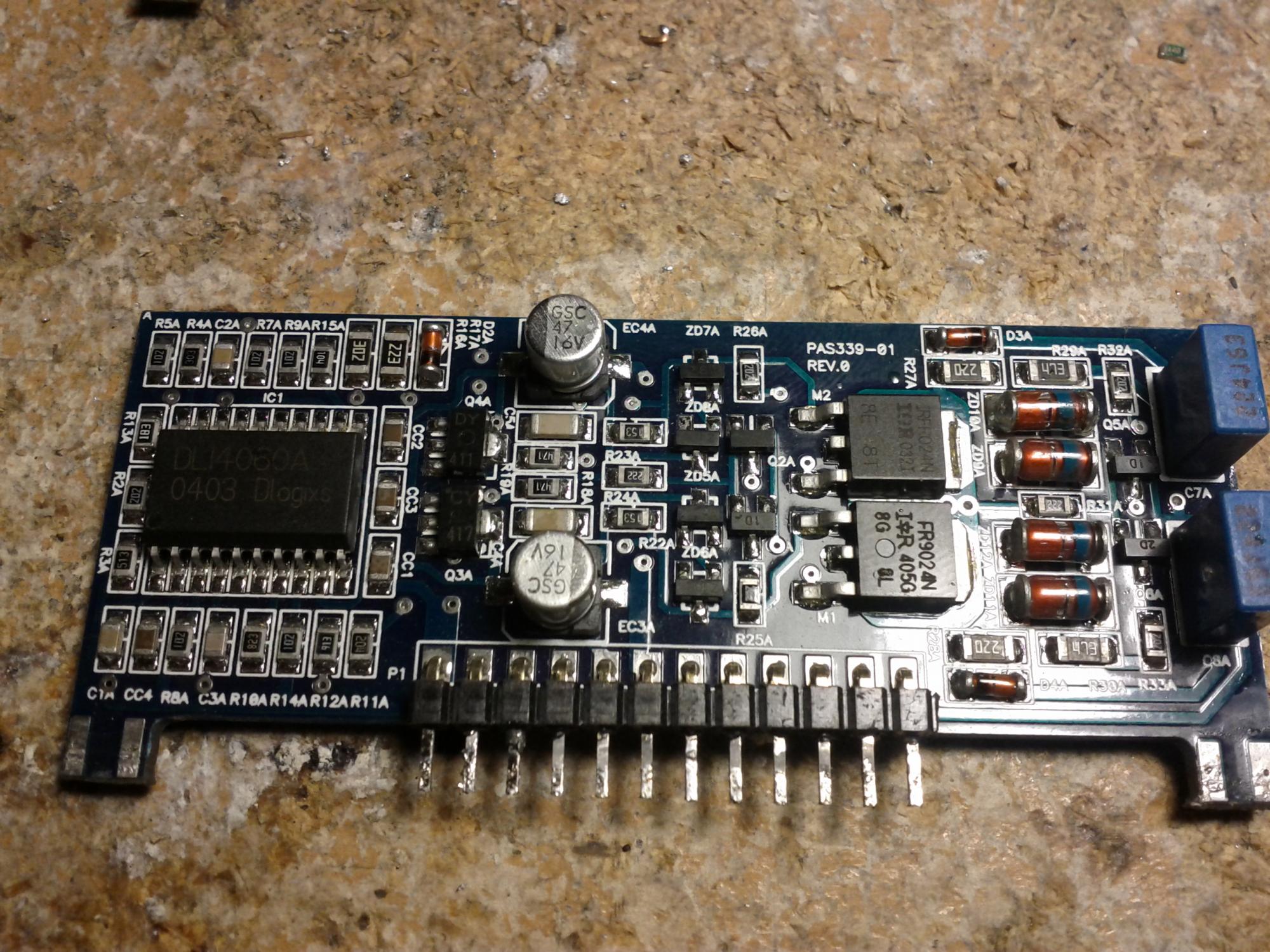

    so im working on a amp and i cant figure out what kinda zener diodes these are.the 4 big ones any help?
  • 999999999
    • Sep 2006
    • 774
    Re: identify a diode

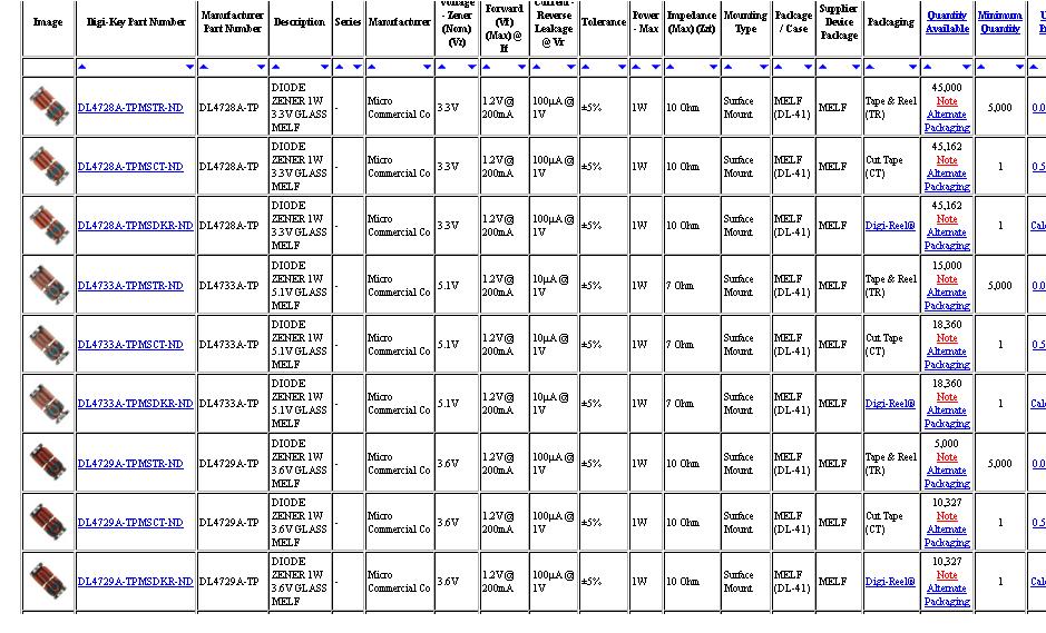

    MELF (metal electrode leadless face) form factor, you'll have to measure it to get the size, though from the pic I'm guessing it's 5mm long, 2.5mm diameter, SM1 - LL41 (DO-213), 500mW or 1W, of unknown voltage.
    Example, but something is screwy, it's also listed as through-hole http://www.mouser.com/ProductDetail/...%2f5cxbpMAc%3d
      Did you try taking any DC reading on them yet, or do they check out bad?

        • timwebb22
          • Jan 2011
          • 30
          • united states
          they all measure about .15 in diode check. they are all dead.
                "they all measure about .15 in diode check" reading is taken with diodes are off the board right?

                  • digitalscorpion
                    • Mar 2012
                    • 37
                    Maybe i missed it, but what is the make/model of this amp? Perhaps someone has a schematic/BOM...
                      Pretty sure they are zeners due to "ZD" silkscreen on the board. Not sure how voltage could be designated with only one color band, there are so (too) many different possible voltages...
                      The mosfets on the board are rated to 60V, you could use a variable voltage supply up to that voltage range, increasing supply voltage till you measure zener conduction to get a voltage value, or conclude they are blown if it supply reaches 55V without. They'd have to be off the board to test. Example (though a multimeter is fine, no analog panel meter need): http://www.instructables.com/id/Zene...cker/?ALLSTEPS

                          In general they ID them from the box they come in from the manufacturer. Some SMD parts simply have no useful markings for identification (diodes and some transistors), and SMD ceramic capacitors and inductors generally have nothing at all.
                          Some Zeners have colours to determine voltage, but it's only from some manufacturers, for example: http://www.marsport.org.uk/smd/sod80.htm
                          I think in this case however, the blue stripe is just saying "Zener" which is of course not helpful because we already know that.
                            It indicates two things , although I dont think all manufacturers stick to the codes!
                            In your link it says: The cathode end is indicated by a coloured band.
                            and for a Mini Delf a Zener is Blue - Id guess it will be the same for a DELF
                              I am still surprised that ALL of them shorted out, otherwise if one is good then it can easily be figure out the Zener voltage using power supply, resistor, and DMM.
