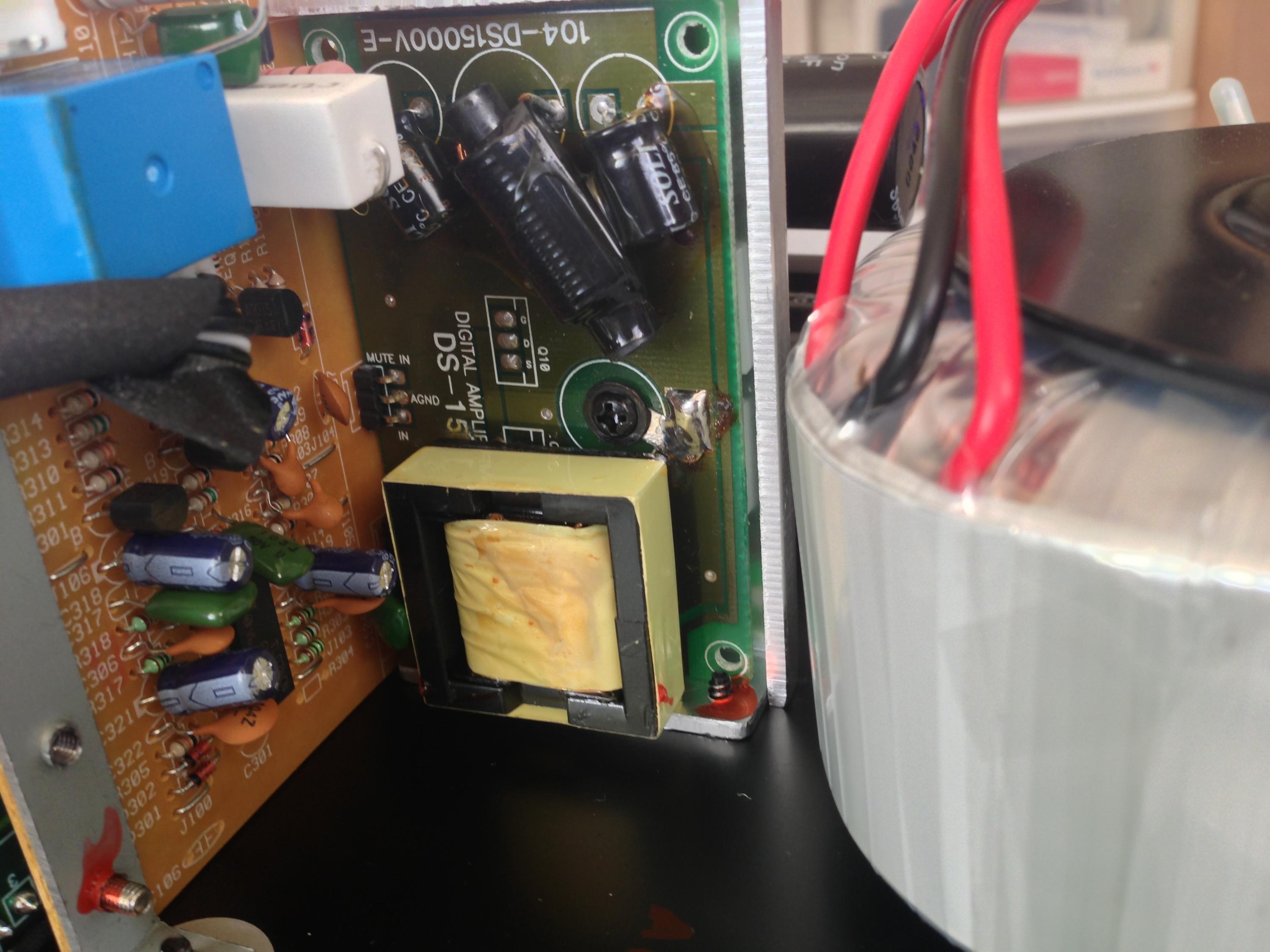

        Originally posted by Jdog420
        Found this cool site while looking for some answers on my sub. Started off intermittent, switching it on and after a minute of thumpage, going into standby. Now when I switch it on, it is trying to turn on but it cycles back into standby, continually. I took it apart and damage wise it looks to be this. Apparently it overheated and melted the coating, but am somewhat newbage and am unable to figure out what the specs are to this, resistor?
        I had the same problem and it seems we are in the same boat. C16 & C17, L1
        are all obsolete parts and I found some caps that are (non polar 10 uf 100v 20%), however I can't find a replacement for L1 (choke coil 35 uh ferrite core 25) I clean up the board and installed the caps left L1 in however It still doesn't work. If you are able to find some let me know! jmbjr10
          Re: Troubleshooting Harman Kardon TS-14 Subwoofer
          The caps (BI-POAR) and the Inductor are part of the output filter of the Class -D switching power amplifier. The Inductor is OK, the caps are the most common failure in these sub-woofer Class-D power amp.
          Here is the Cap: http://www.mouser.com/ProductDetail/...EETKeRgSqTI%3d
          Get extra.
            Bipolar electrolytics as Class-D output filtering? Really? I mean i know it's a subwoofer, but still... They'd be seeing huge-ish ripple voltages
            Is the amplifier in this supposed to have a transformer output or something? I can see *one* FET in TO-220 case in THIS photo, with its drain pin going to what looks a (flyback?) transformer, as can be seen HERE. Or wait, i think i spotted the silkscreen for a second one, right "under" the transformer...
            It'd be nice to get a shot of that board with the output filter(?), with the two crap(ped) caps removed.
              Output transformer? To poduce 35Hz at 200W, that will be big transformer.
              It is poor designed to use Electrolytic caps in the output filter (the LC filter is used for filtering out the switching frequency of that Class D amp uses). There is no output transformer in these Class D-sub woofer system. Copper and steel cost a lot of money, Class D- output MOSFET' s voltage will swing from B+ rail to B- rail with varying pulse width, since the output will swing both directions with reference to circuit ground that is why you need bi-polar caps. The power supply is bi-polar (b+ & b-). Look up on how Class D work, newer design use filter-less output filter. The power supply uses Toroidal transformer.
              Here is the service manual, see page 28 for the power amp section.
                Oh, wait, is that transformer-like-looking thing, on the power amp daughterboard, that 120uH output inductor?
                EDIT: Apparently it is... Part list says L1 has an EFD-30 core.
                Yes, i'm aware of the "anatomy" of class-D amps, i'm just... well... nearly appauled to see ELECTROLYTICS used as output filter caps
                              Get extra.
                              I have replaced the caps with the ones you suggested and reinstalled the choke coil 35 uh ferrite core 25 I had. However, it still not working. Is it possible that they were not installed properly? I thought that the caps were bi-polar and it didn't matter how they were installed. I had the same feeling with the coil.Was I wrong? How should I check to see if the coil is bad? I'm new at this and I need someone such as yourself to help me. Thanks for your time.
                                #35
                                They are non-polarized so it does not matter how you installed it, the choke has really large gauge wire and hard to damage it.
                                The purpose of the filter is to reduce the switching noise, it is more likely that the switching amplifier section is not working.
                                We need to do some voltage checking per diagram.
                                First, do you have sensing switch set to ON or Auto? If you have it set to auto, the amp will not turn on until it detects the audio input signals. I would set it to ON for now.
                                Do you see any indicator lights?

                                  Thanks for everything I got it to work! I was wondering if I could ask you you another question? I still would like to know what could be the cause of the speaker acting as if it is over driving? It's not clear as it should be. It producing the base sounds well but it has sound like the speaker is being over driven. Any ideas?
                                        I'm not sure what the rules are for reviving dead threads, and I apologize in advance for doing so.
                                        However, I have the same sub-woofer, but a different problem. One day it was fine, then the next day I went to turn it on, it made a low buzzing noise. I disconnected all wires to the sub and turned it on so only power, nothing else, and it still made the sound. After that I took the back cover off and looked over the board. Nothing was burnt nor did anything explode, according to the various pictures I saw in the forums regarding bad capacitors.
                                        I did however notice a brownish dried pool of I don't know near the 3 capacitors in the picture around the top. Also, is the yellow square at the bottom supposed to buzz when the sub is running? I think this may be causing the sound the speaker makes, but I can't say for sure.
                                          #40
                                          I would suspect bad output filter caps like the two as shown in post1 to be bad since that is the common failure for this unit, it can also be bad main power supply filter caps.
                                          Can you take good pictures of the boards and the top side of the two caps like the one on post1?
