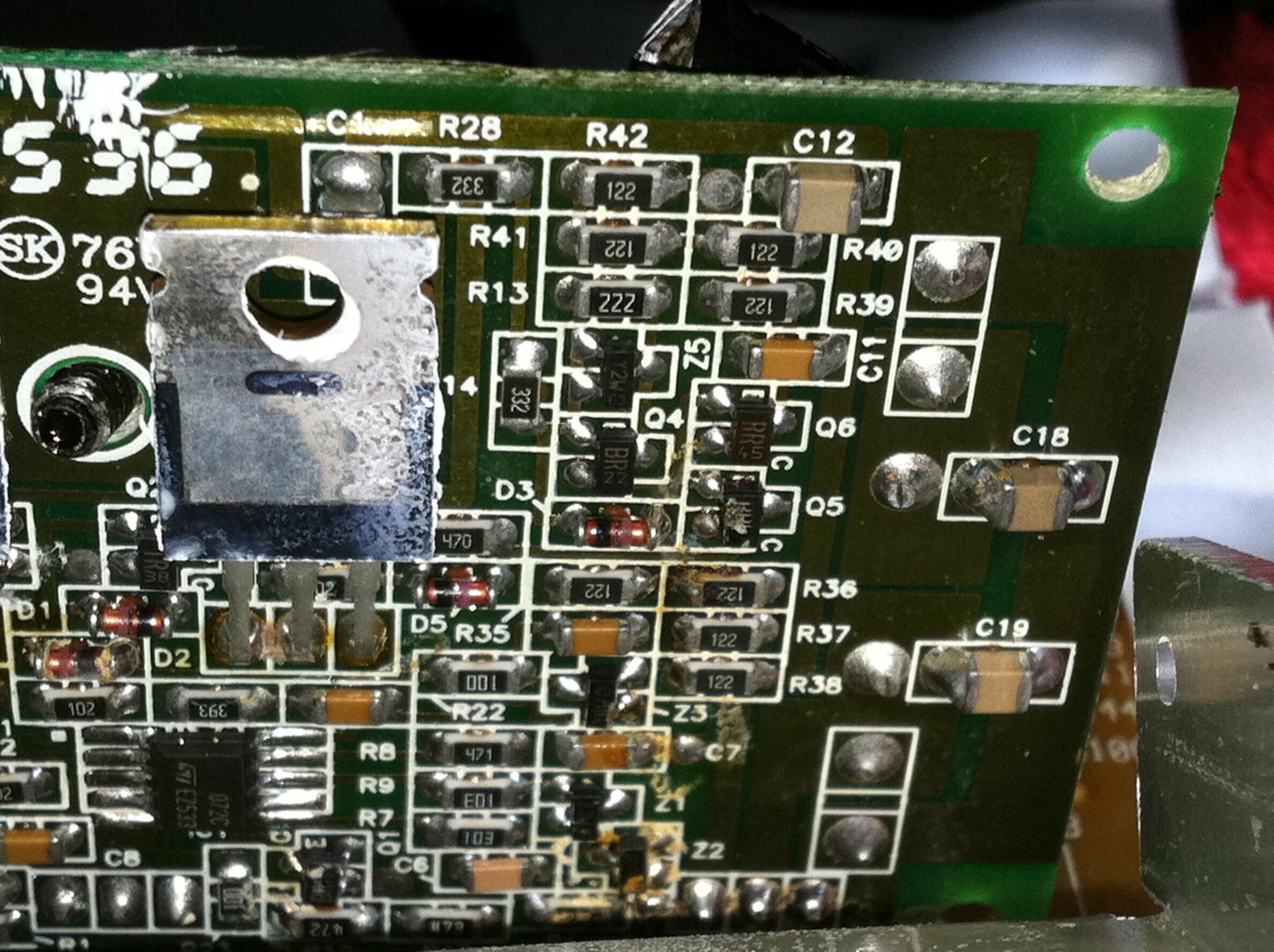

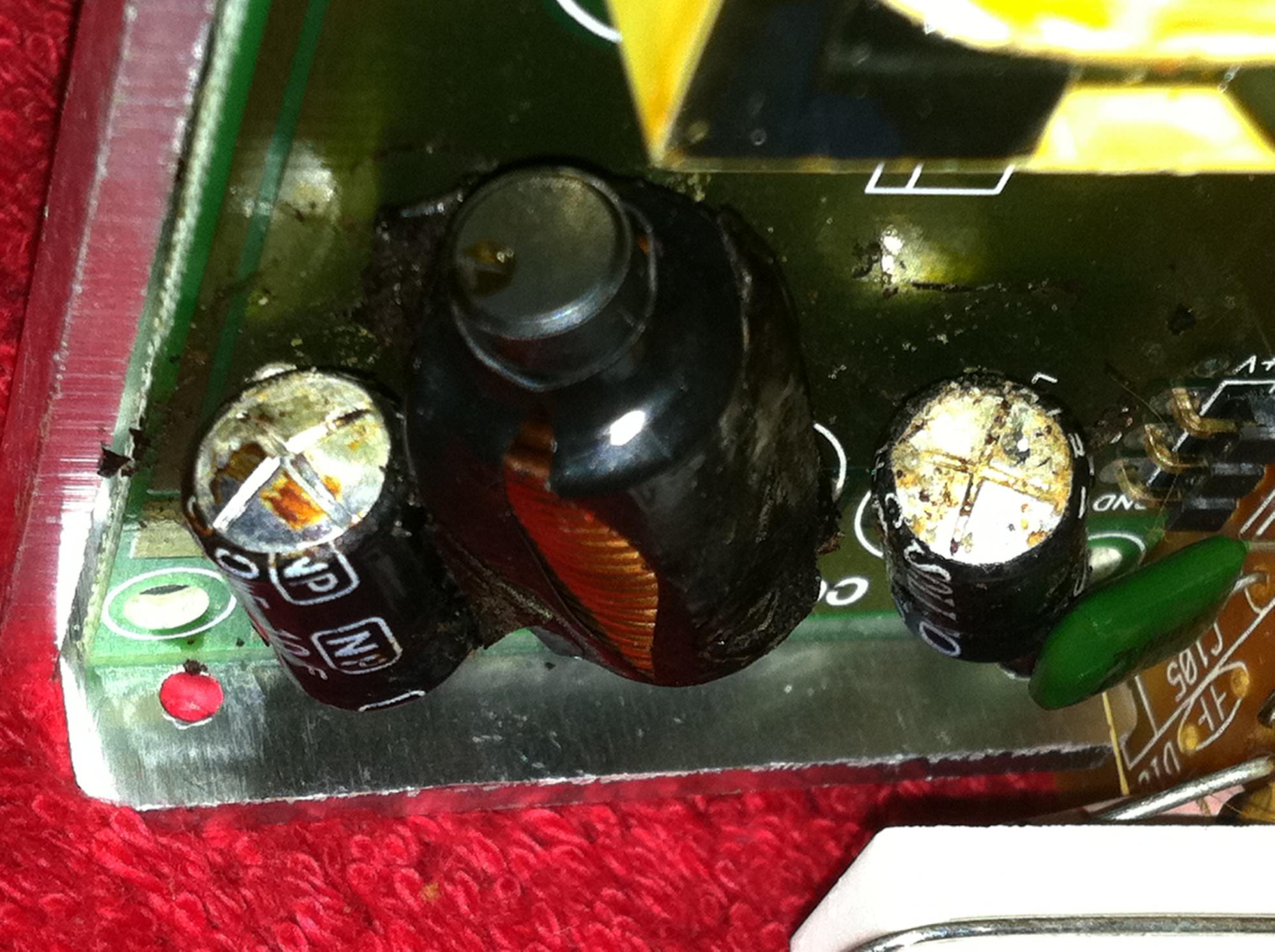

    Found this cool site while looking for some answers on my sub. Started off intermittent, switching it on and after a minute of thumpage, going into standby. Now when I switch it on, it is trying to turn on but it cycles back into standby, continually. I took it apart and damage wise it looks to be this. Apparently it overheated and melted the coating, but am somewhat newbage and am unable to figure out what the specs are to this, resistor?

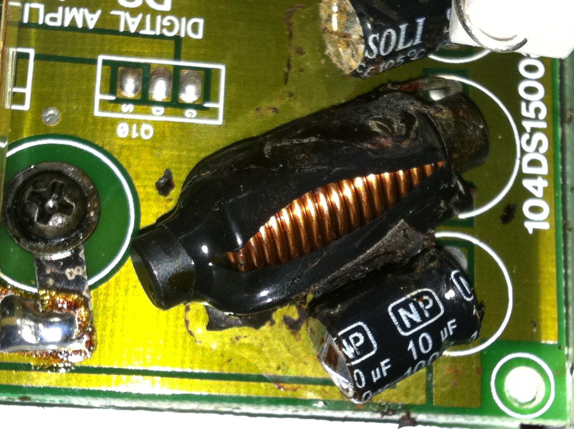

    From what I can make out (pics too small), It's an inductor. They rarely go bad and will work with the melted outer shell. What makes these hot is whenever there is too much current going thru them. I can't make it out but it looks to be a bad cap or two near it. These will need to be replaced but it would be nice to see larger pictures of the whole board to make a proper determination. Use "Manage Attatchments" just like you did but larger pictures. Not too large though.

      Cool, working on the bigger picture. I was disappointed myself when I clicked on it.

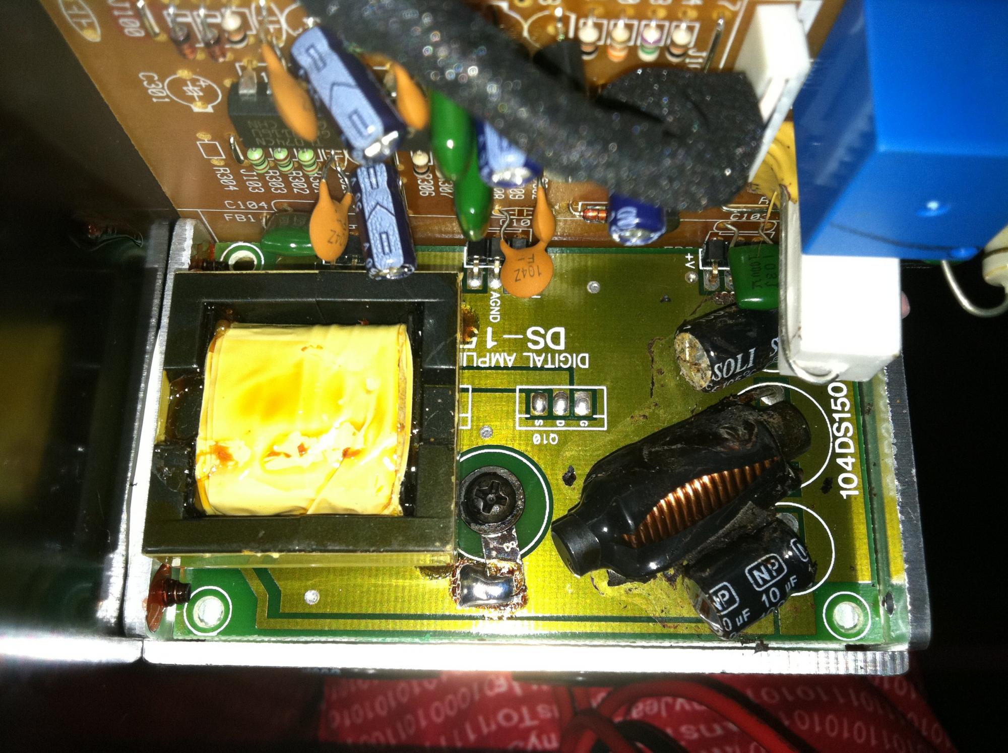

        Resized photos in.

          Yes there are two bad caps there.

            Re: Troubleshooting Harman Kardon TS-14 Subwoofer
            They leaked all over the board too. You will need to clean the residue off of the board.
            Harman Kardon likes to use crappy caps and place them in very warm locations. I found that out while repairing a set of Harman Kardon computer speakers.

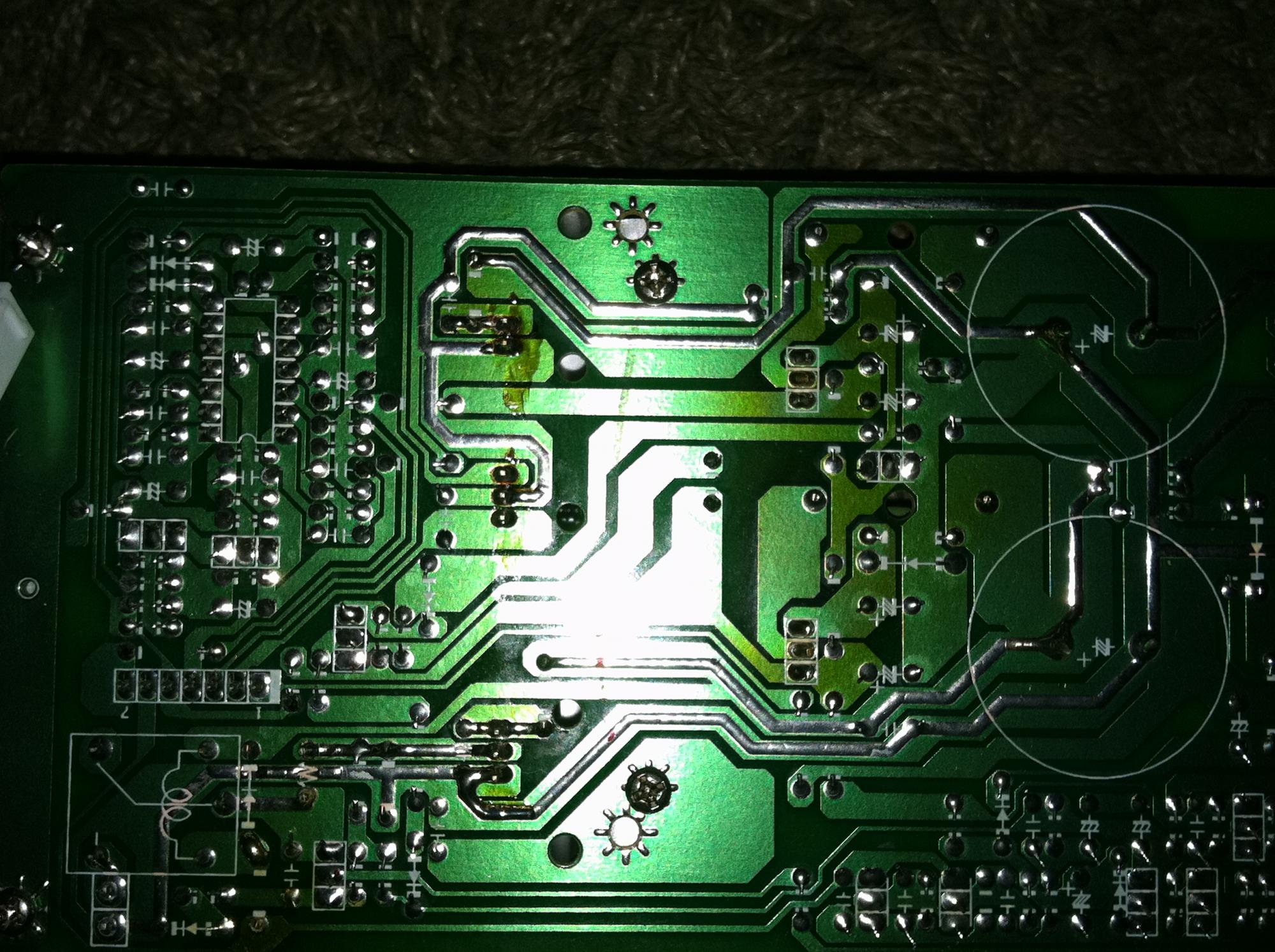

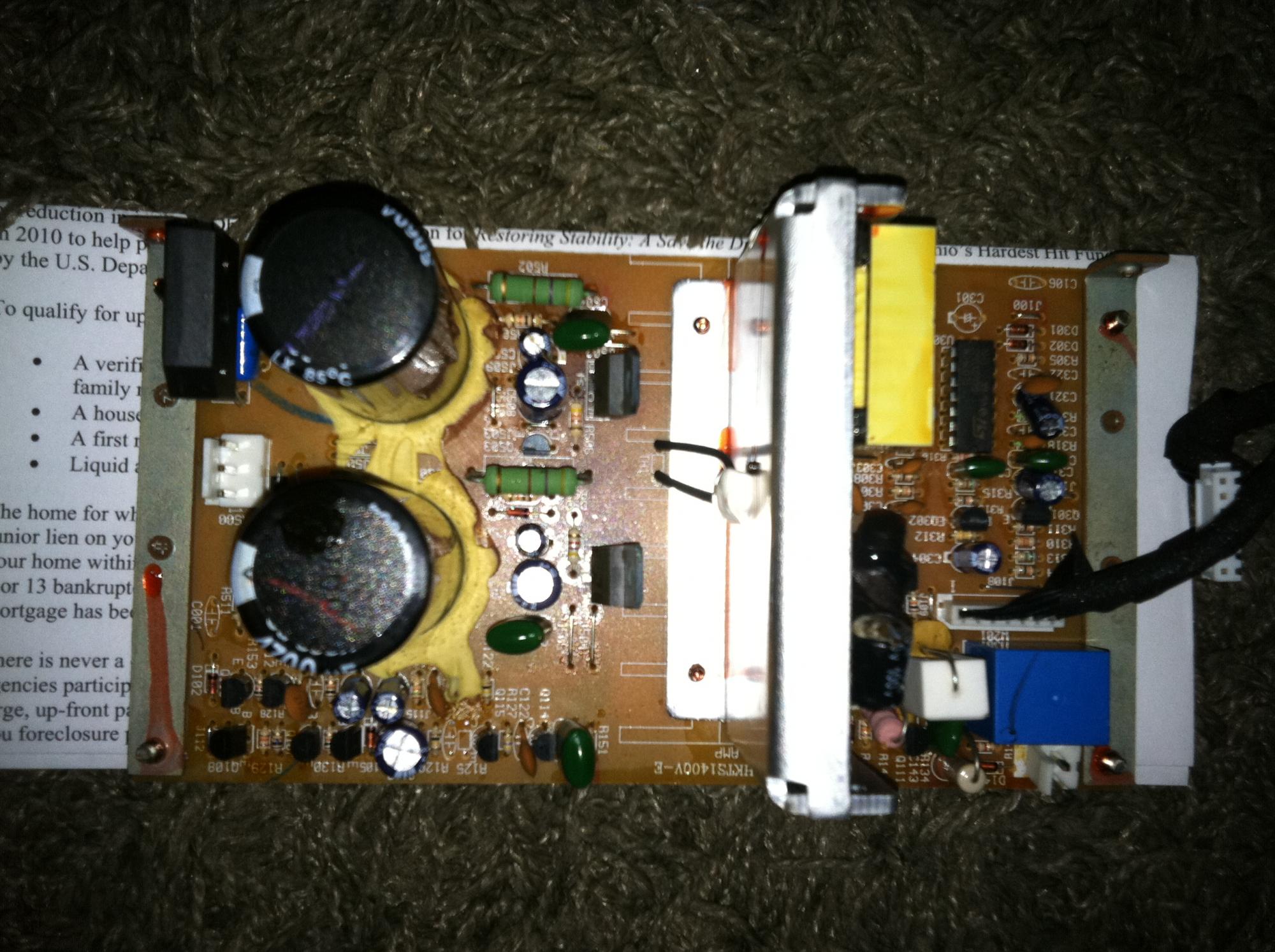

              I'd like to see any other boards that are part of the subwoofer also. The main focus at the moment is to remove the inductor and the 2 caps and start cleaning the pc board to remove the conductive electrolyte that spilled. Also look carefully at the bottom of the board where these parts are soldered, as the fluid might have done damage underneath as well.
              I'm wondering if the board we see in the photo is a power supply? The inductor is a high current high value (ferrite core) part, connected to a NP cap. Those parts might actually be part of the subwoofer's crossover/low pass filter for the audio. Let us know the results after cleaning and replacing the caps.

                I was gonna take it to the local electronics guy, but appears he isn't open anymore or moved. Looking at irons ( don't have any tools) and replacement caps right now. I'm gonna take the boards apart and post some more pics tomorrow.

                  This is something that YOU can fix! All you need is an old toothbrush, a soldering iron and some alcohol or lacquer thinner to clean the board. Caps can be ordered from Digikey, Mouser, Newark, etc for a few bucks. Here's your chance to be a hero!

                      Those boards don't look bad. That is typical Harman Kardon quality.
                      If the amp runs hot, a full recap might be needed. In the computer speakers I mentioned above, almost every cap was bad.

                        If we are talking subwoofers with internal amplifiers, it is absolutely certain that the electronics will run hot. The boards are mounted inside the cabinet along with lots of fiberglass insulation (for audio purposes). But that doesn't mean that every part is in immanent danger of failure. Jdog, get yourself a soldering iron and some solder wick and a few supplies. The knowledge and experience I've seen presented on this forum is far more than you'll ever get at the tech school. I'm very big on hands-on. Remember, if it is already broken, you can't do much worse trying to fix it!

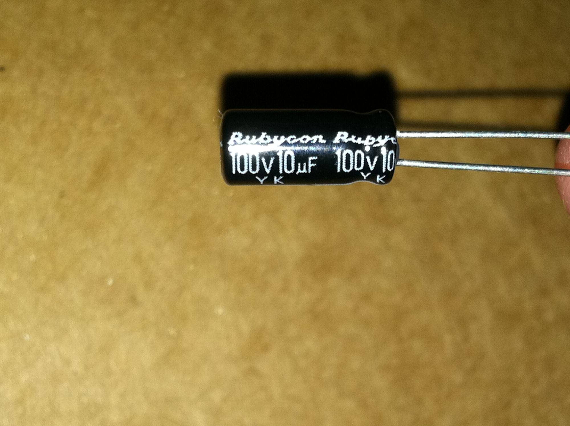

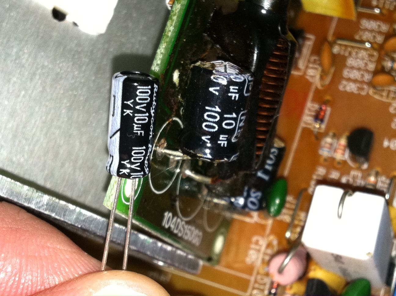

                                        So got some things to gear up for the attempted fix. Bought a Hakko FX-888 and well what are supposed to be rubycons (can any of you spot fakes?). However I think I had a fail in the caps department, the temp is only rated 85C while the OEM are 105C. Maybe not a big deal, but the OEM are noticeably larger.
