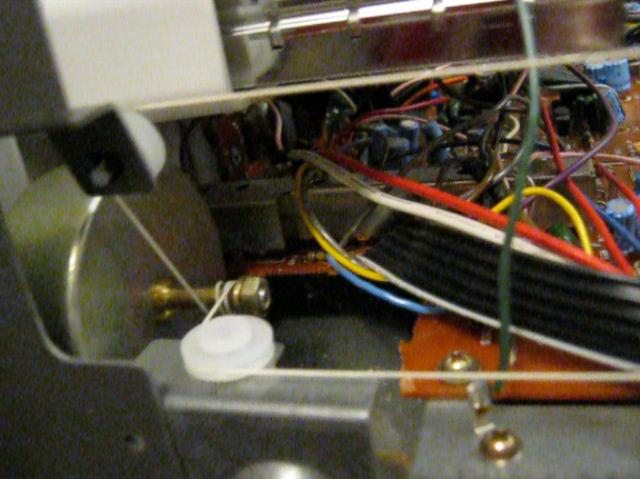

                    It might help if people know what they were exactly. Pull them out, or at least free of the front panel and post pictures and dimensions. There are things you can do to improve some switches. For example, taking apart a switch and wetting the contacts with silver solder will mean you no longer have brass oxidation. Silver oxidation still conducts. Naturally, gold plated switches would be best but good luck finding some when you can't find plain ones.
                    If you want to find a replacement switch anyway it won't hurt to tear open the old one since it is otherwise useless. I too have cleaned contacts in old switches many times, after I get it open I use brasso not just contact cleaner, or if they are really bad, an abrasive ink pen eraser (more grit in it than a pencil eraser so it works faster) then brasso to polish them. Depends on the switch though, what the best option is.

                      I can't figure out how to get the Fisher apart. I don't want to take the original switch apart because I don't want to completely destroy it. The switch works properly most of the time. I haven't tried to work on the Zenith yet. I have attached a crappy picture of the switch. The switch is soldered directly to the board and has six positions.
