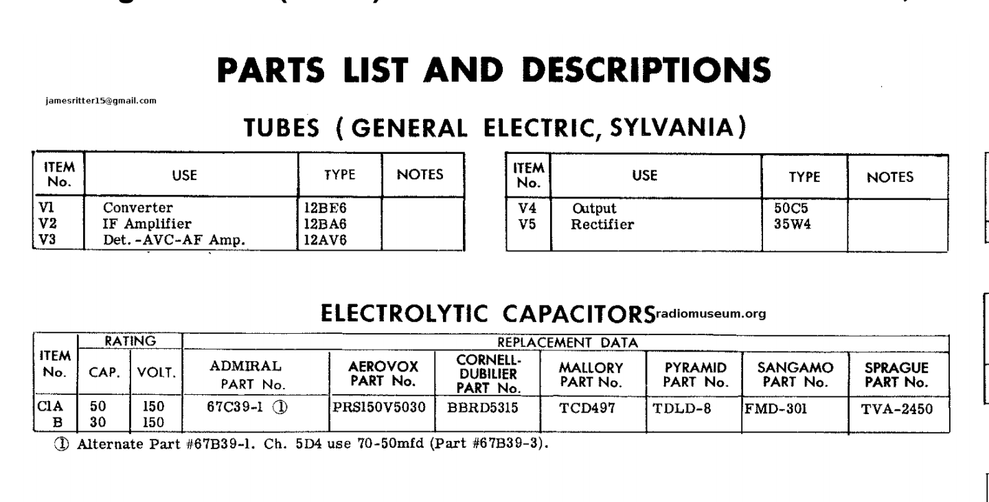

    I need to replace a 70uf+50uf 150v 75 C temp radial capacitor out of an 1958 Admiral 278-5D4.
    I am having a hard time finding that exact spec, does any one know what a good replacement would be from a modern manufacturer?
    This is my first restoration, so be gentle.
    Thanks in advance!

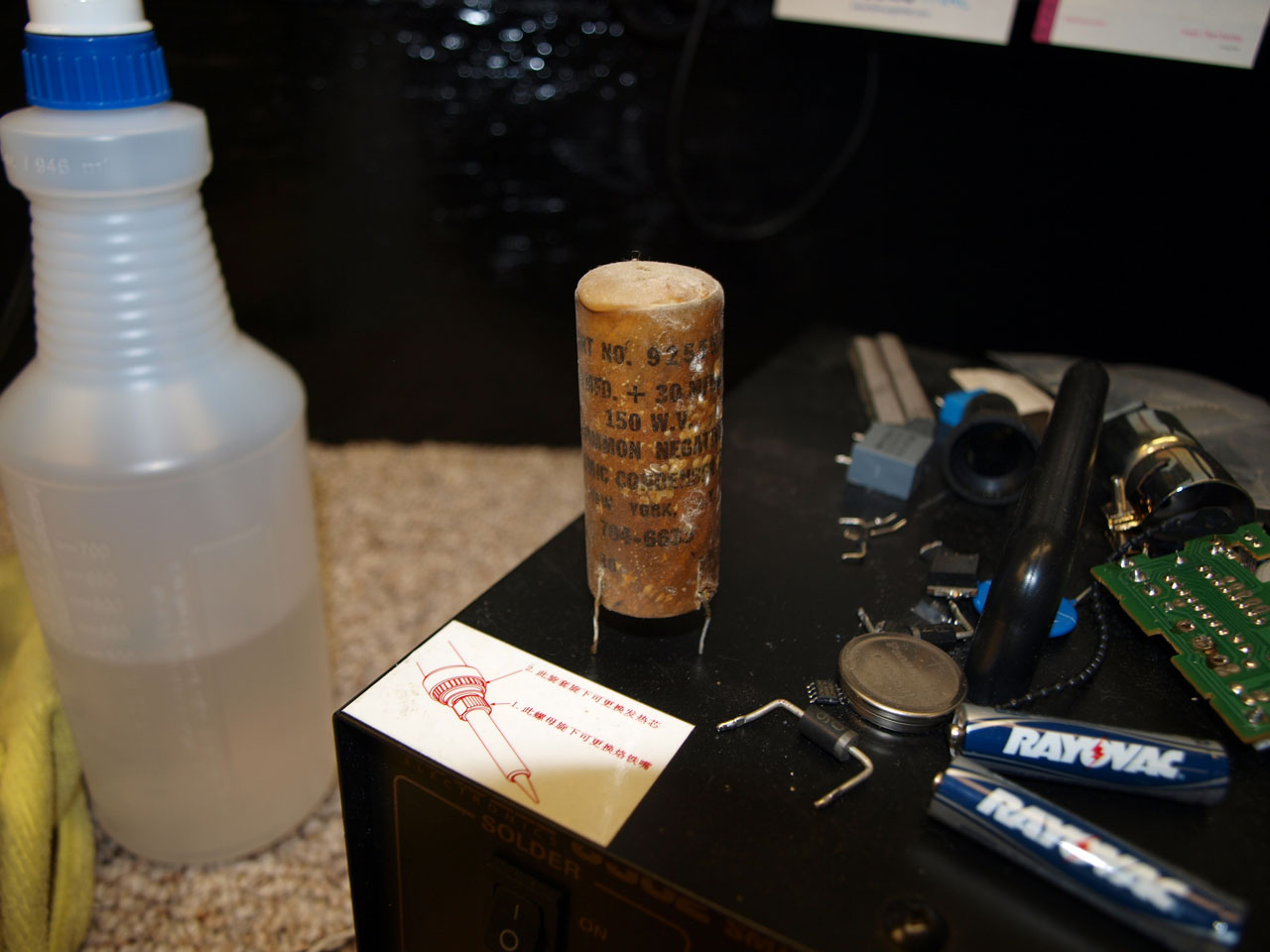

    You just need to find two single electrolytic capacitors, no need for low esr etc.
    33µf/160v
    47,56 or 68µf/160v
    values are not that critical
    You may be able to install them inside the old electrolytics paper cover (just for looks)

      lots of people gut the old one and put new ones inside .. failing that its disconnect the old one and put new ones underneath .

        This makes sense! I wasn't sure if there was any special use case for the 3 lead instead of 2 separate caps in the original design so I was looking for a exact match.
        I can easily find a 50uf and 70uf 150v cap and split them between the 3 leads. Thanks!
        Also I love the idea of placing them inside the old paper!

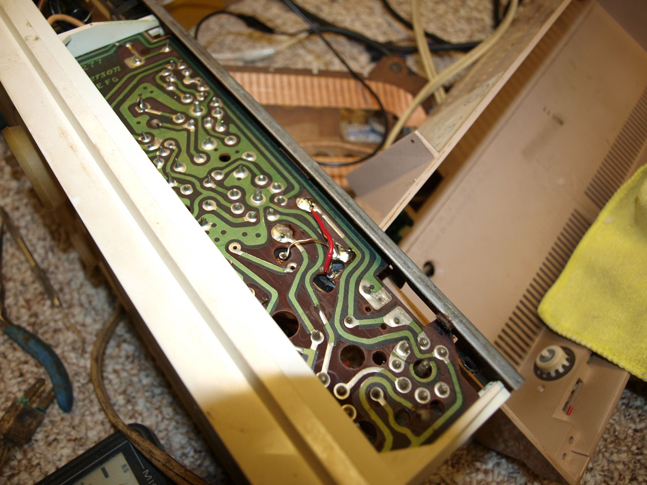

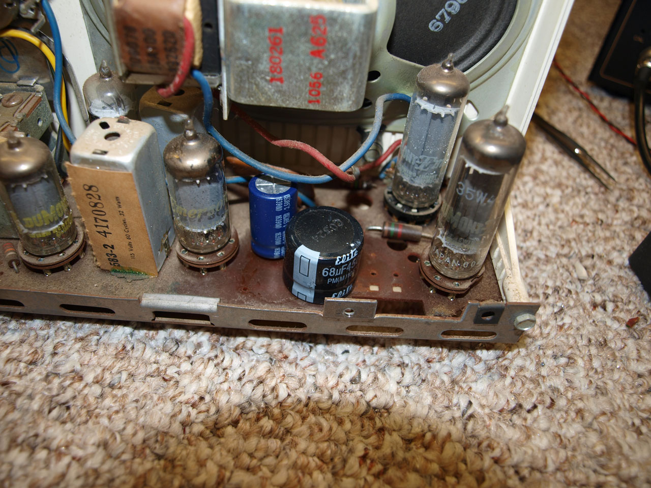

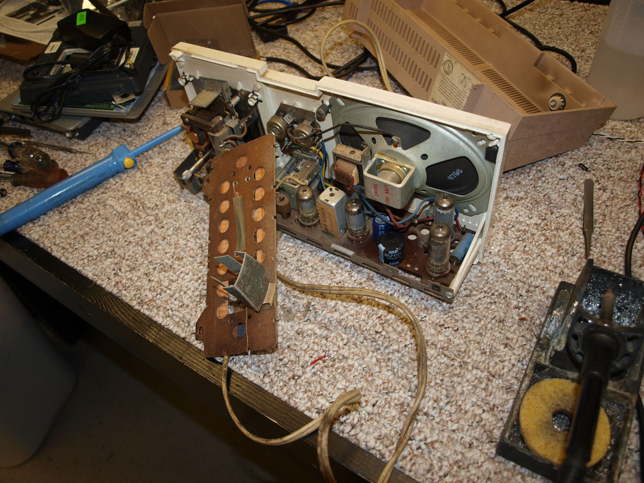

          I had to do this with an old radio someone gave me that for some reason I decided to repair....
          Yes, the clock worked....I think that's why I fixed it....
          Anyway, the culprit....
          Scavenged 2 caps from some old PSU's. I normally frown on that....but this was not for a customer or anything that required any degree of precision....so...yeah... I did check them on my Sencore, they were good.
          I did not do the 'install the new caps in the old cap body' thing....looks / authenticity wasn't the goal.
          I just used existing holes in the PCB and a few workaround jumpers to attach.
          I also cleaned out the vol & tone pots and a little teflon gun oil in the clock movement. Keeps perfect time and sounds as good as an old AM tube radio could. Not sure why I botehred with this one, maybe it was the pink body; Emerson 'Lifetimer' from 1963.
