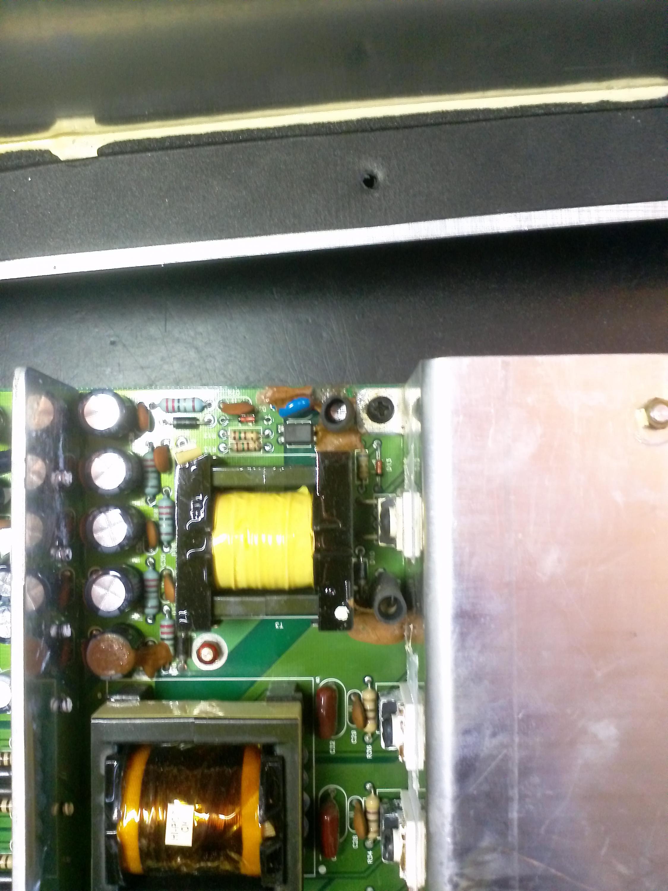

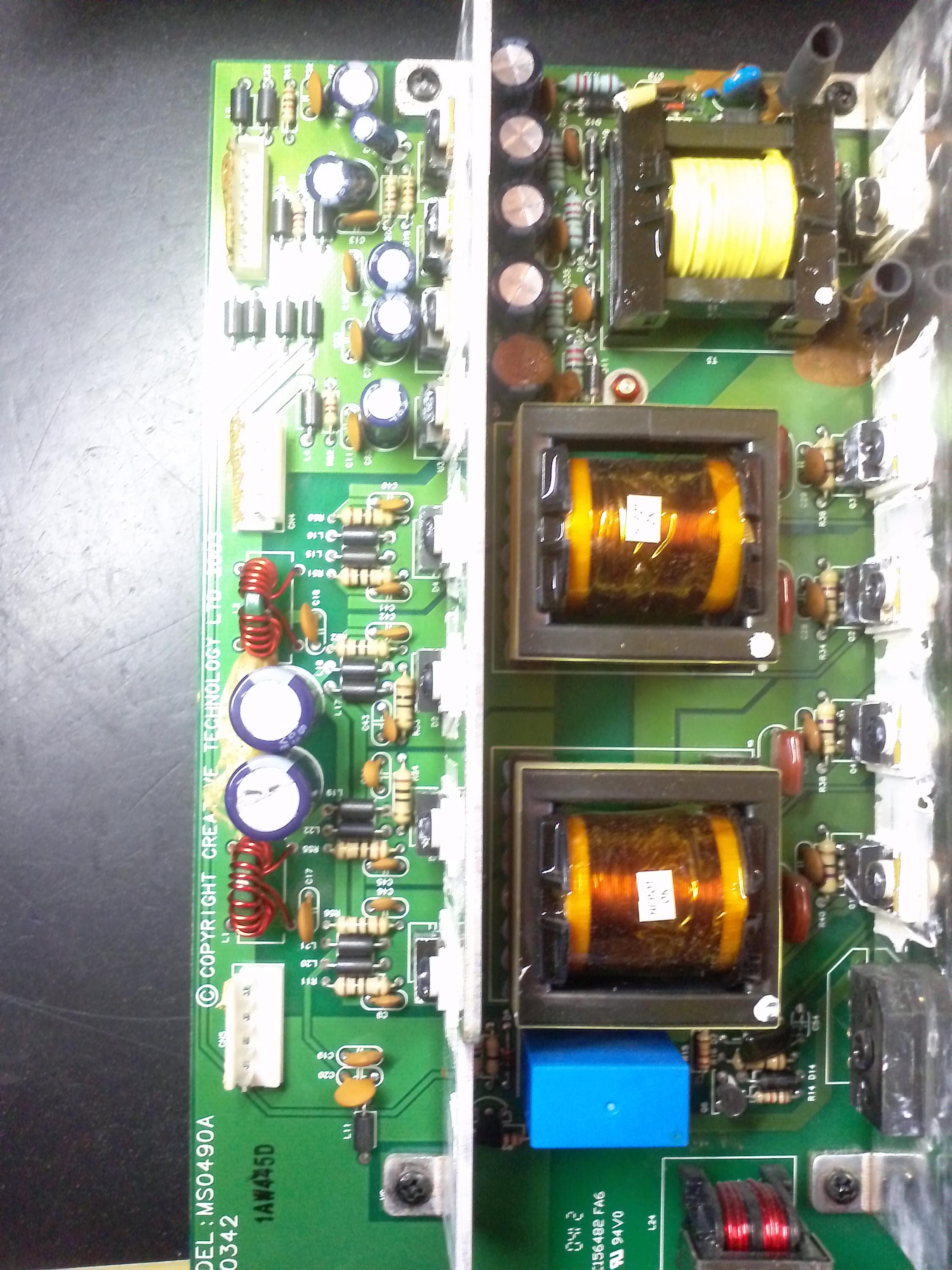

                Hi, apologies for digging up an old thread.
                My friend gave me a Creative S750.When I plug in the power cable and turn on the power, there's a loud popping noise. The control pod isn't working and the subwoofer doesn't have any power light.
                Its somewhat same like what TS has encountered but mine doesn't seem to have any blown caps/chips.
                There are white sparks coming from this area :

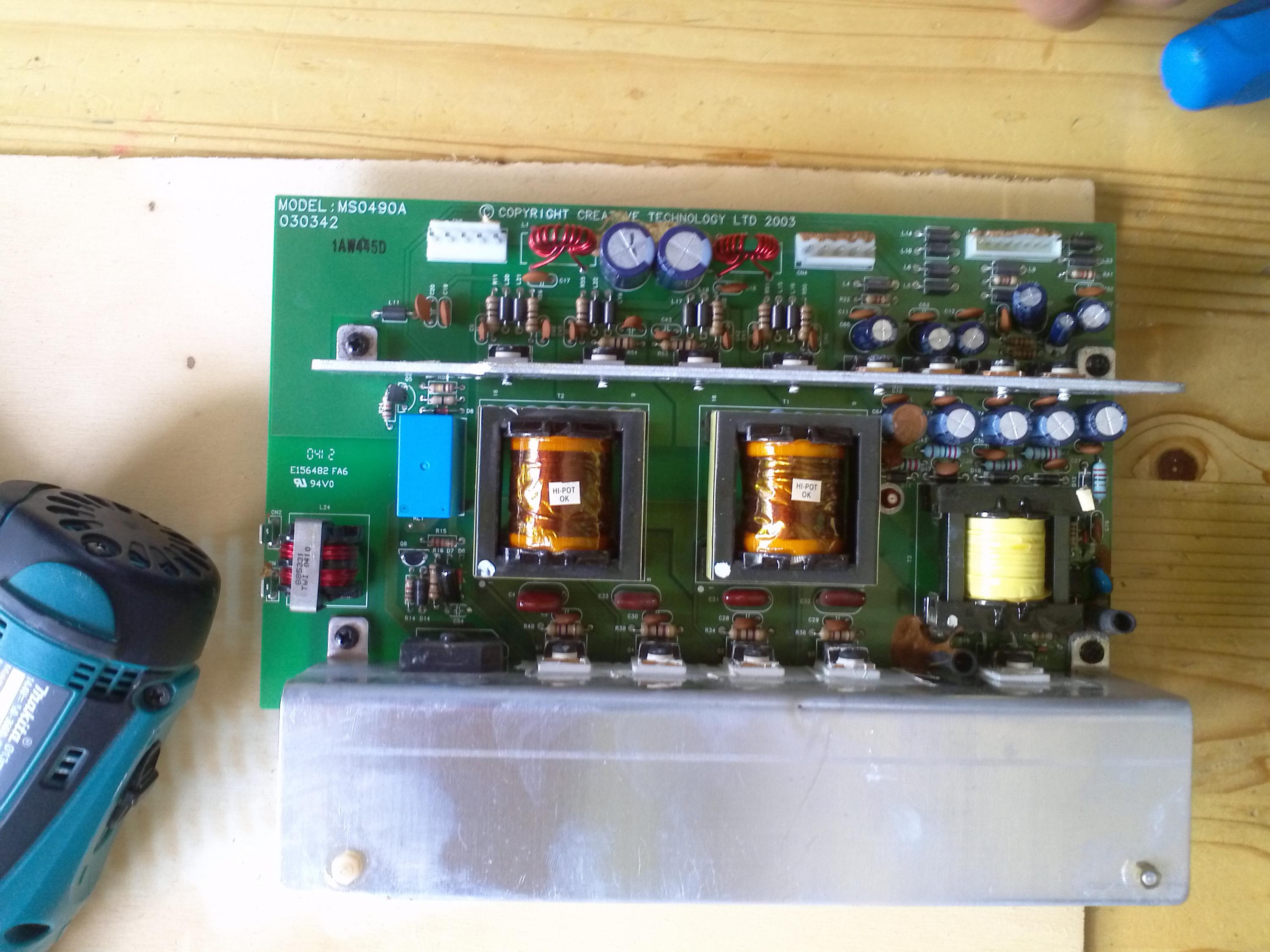

                I dismantled the power board and took some photos of it.
                http://s772.photobucket.com/user/markz39/library/S750
                Is there any way to revive this good old system?

                  Re: Creative Gigaworks S750

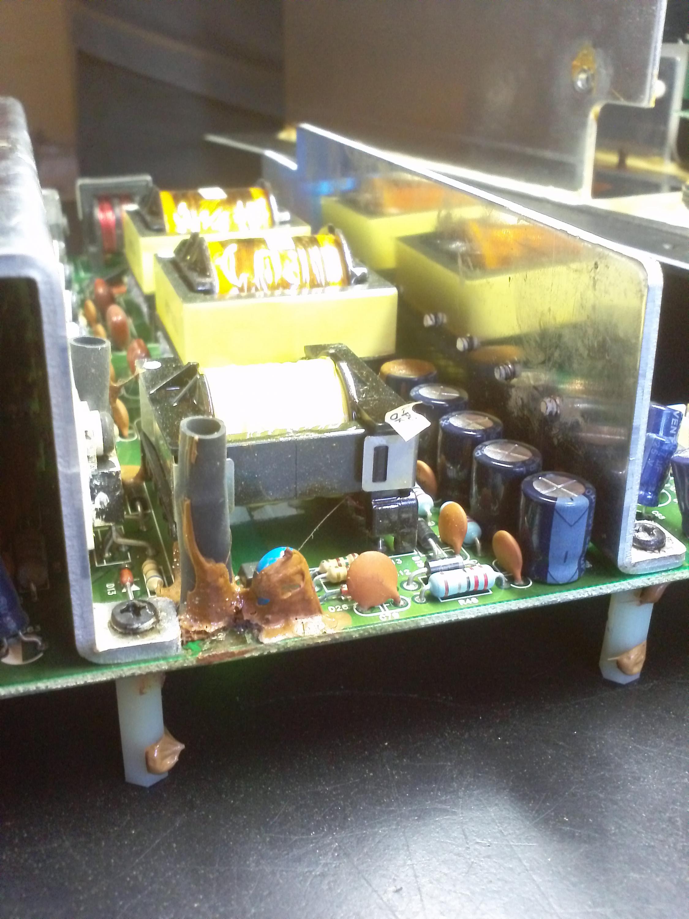

                  Could be that brown glue has turned conductive and is causing a problem
                  -David VanHorn
                    i'll try to scrape it off.

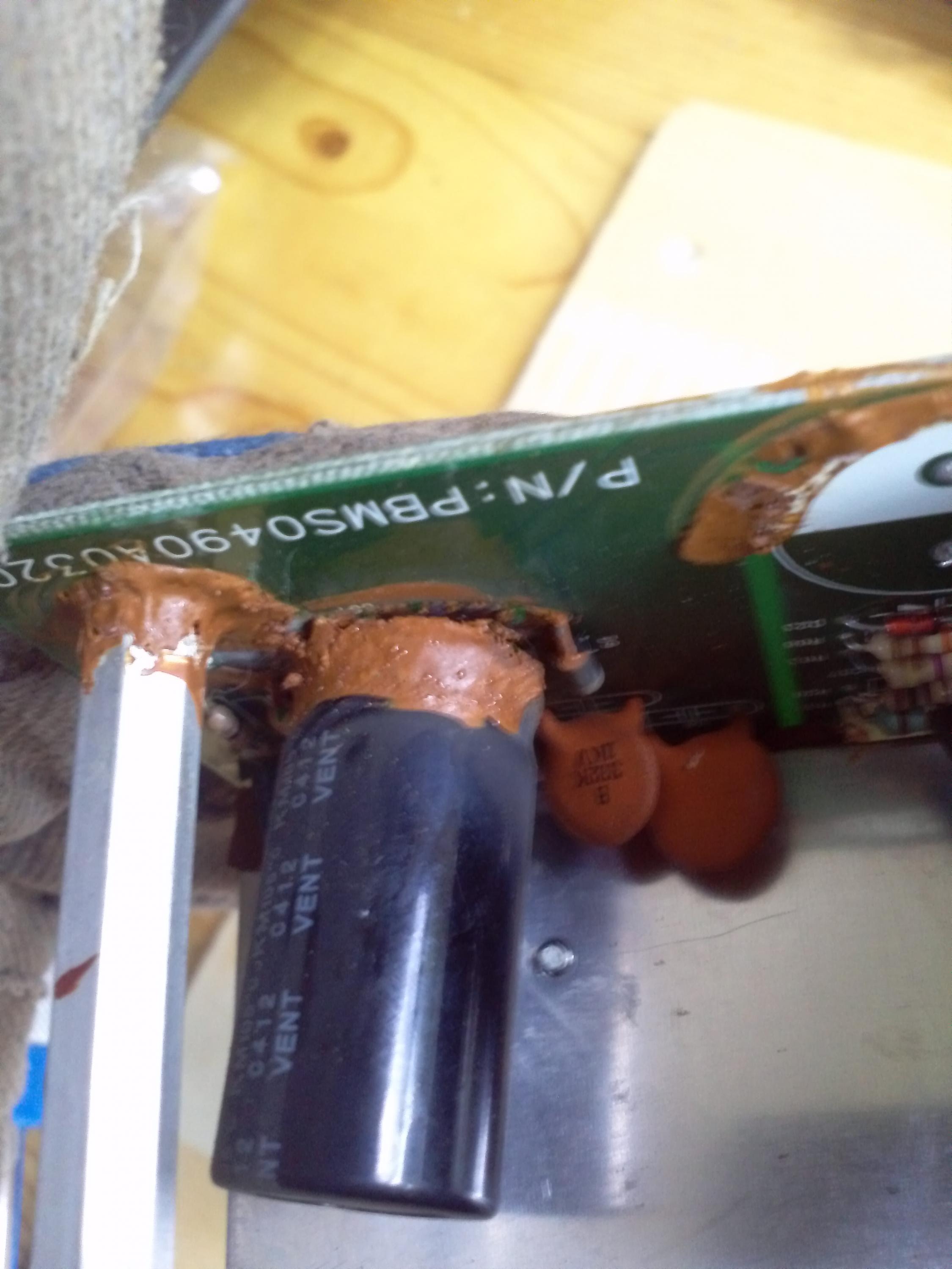

                    there is a capacitor near the blue resistor that is damn lose, is it normal?

                      #30
                      You mean, the solder connections are loose? If they are, yes that could be a problem.
                      It looks to me like whatever is shrink wrapped in that black plastic, near the sparking area, has burnt out. My guess is it could be a power resistor. Desolder it and see what else is behind it, and see if the soot comes from the bottom of it.

                        #31
                        No smoke/ nothing burnt around that area. I've tested with a multimeter that the capacitor connections are still intact. I guess there isn't any glue.
                        But I noticed that this cap only has 1 leg, Would there be anything amiss here?

                          #32
                          It means the other has burnt off. Replace it.

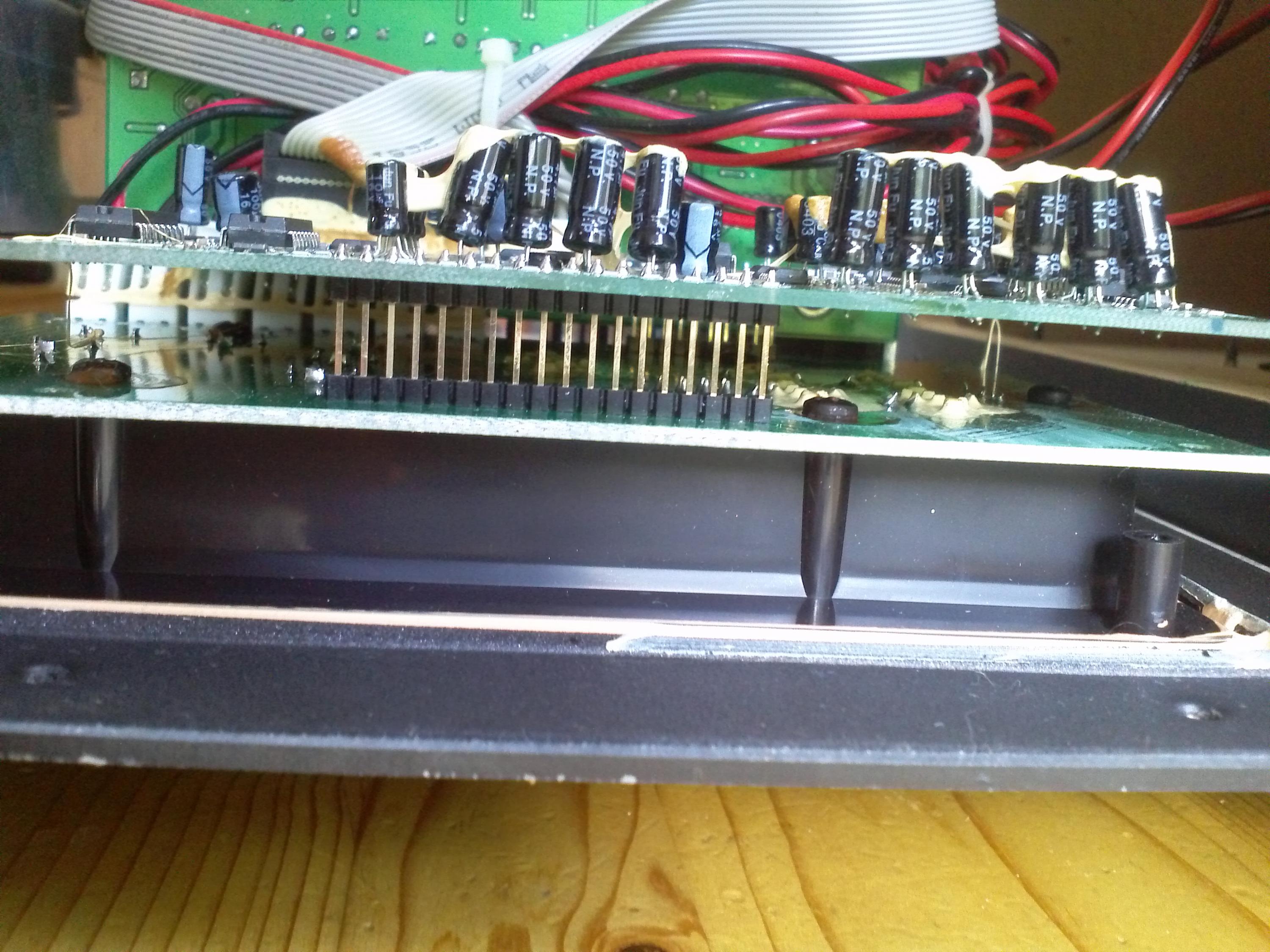

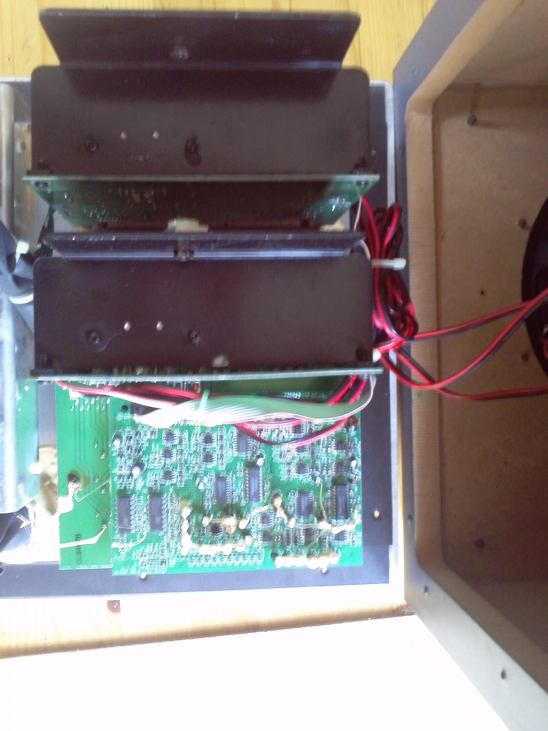

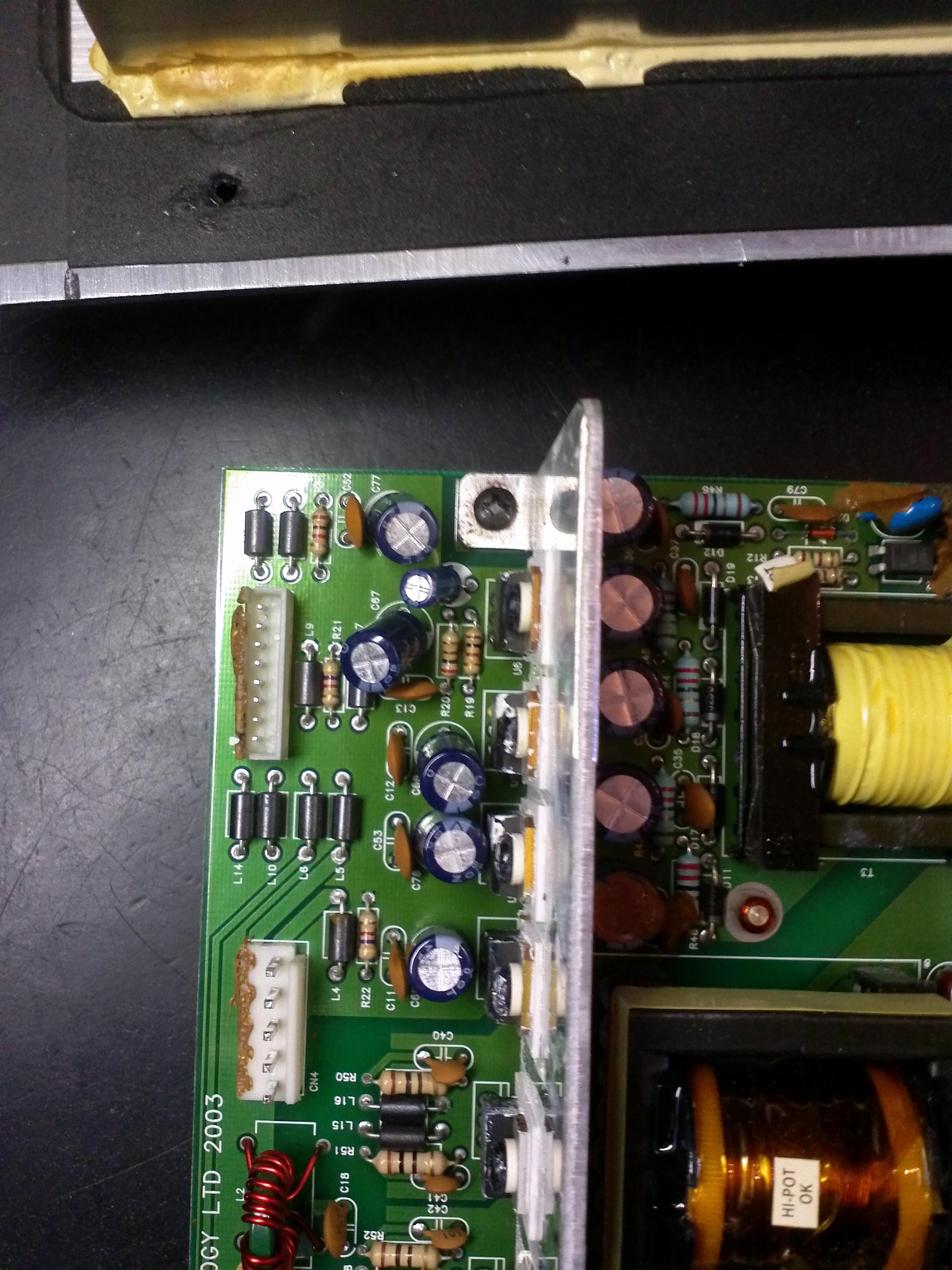

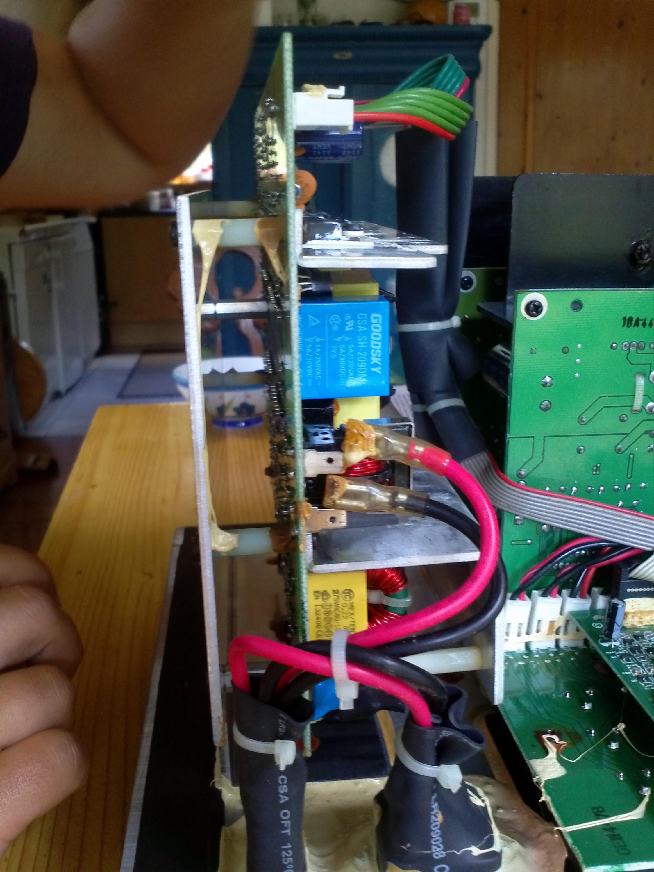

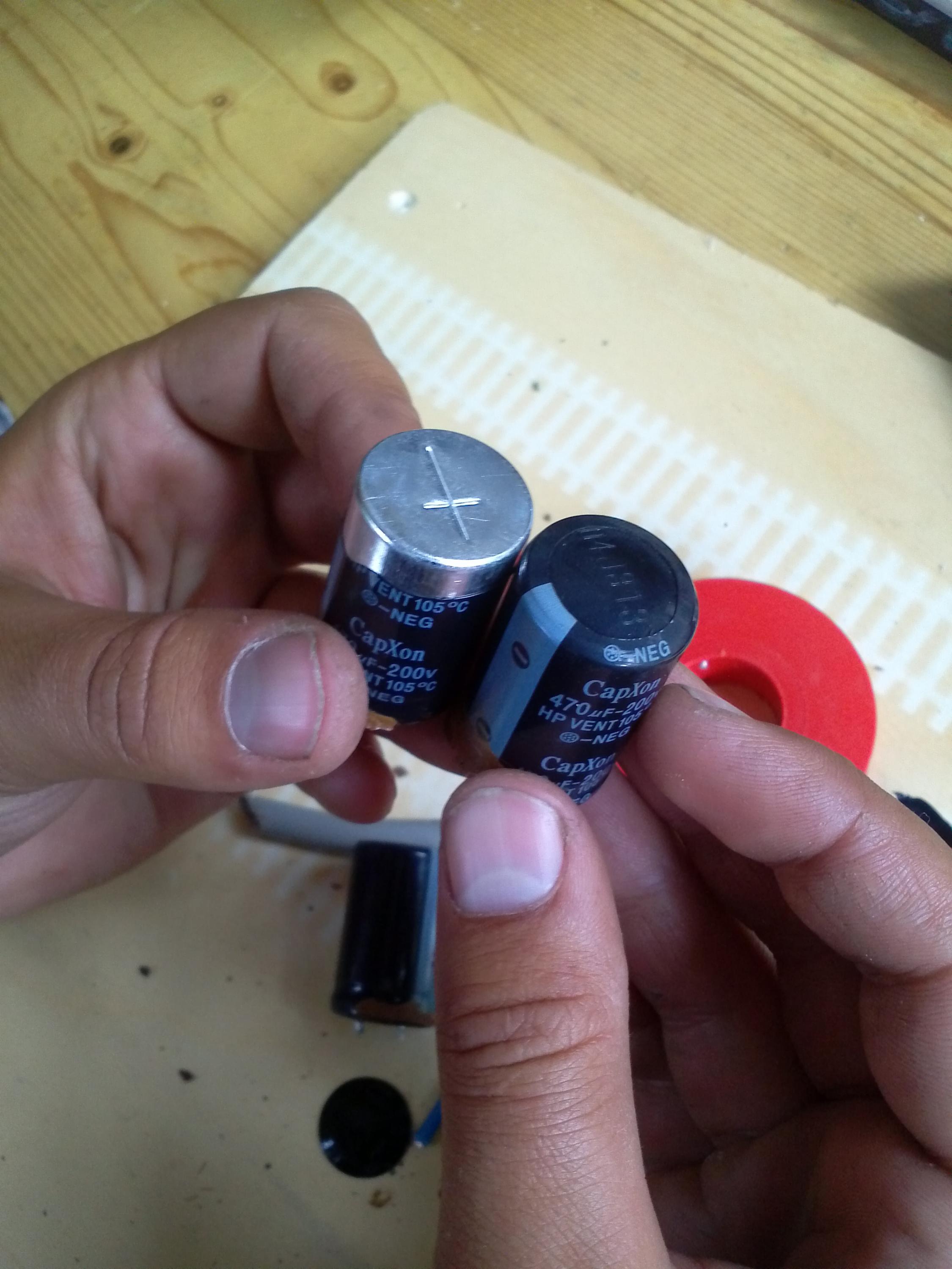

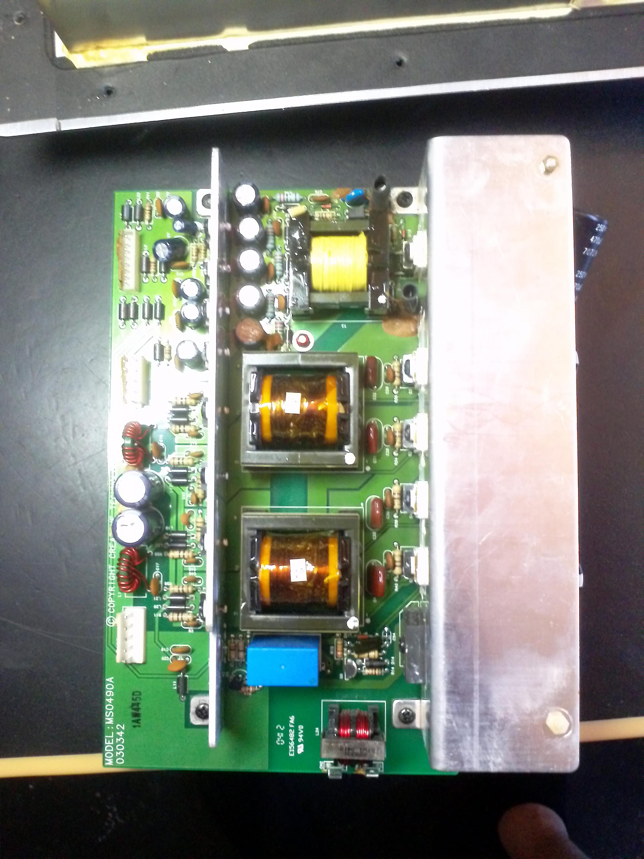

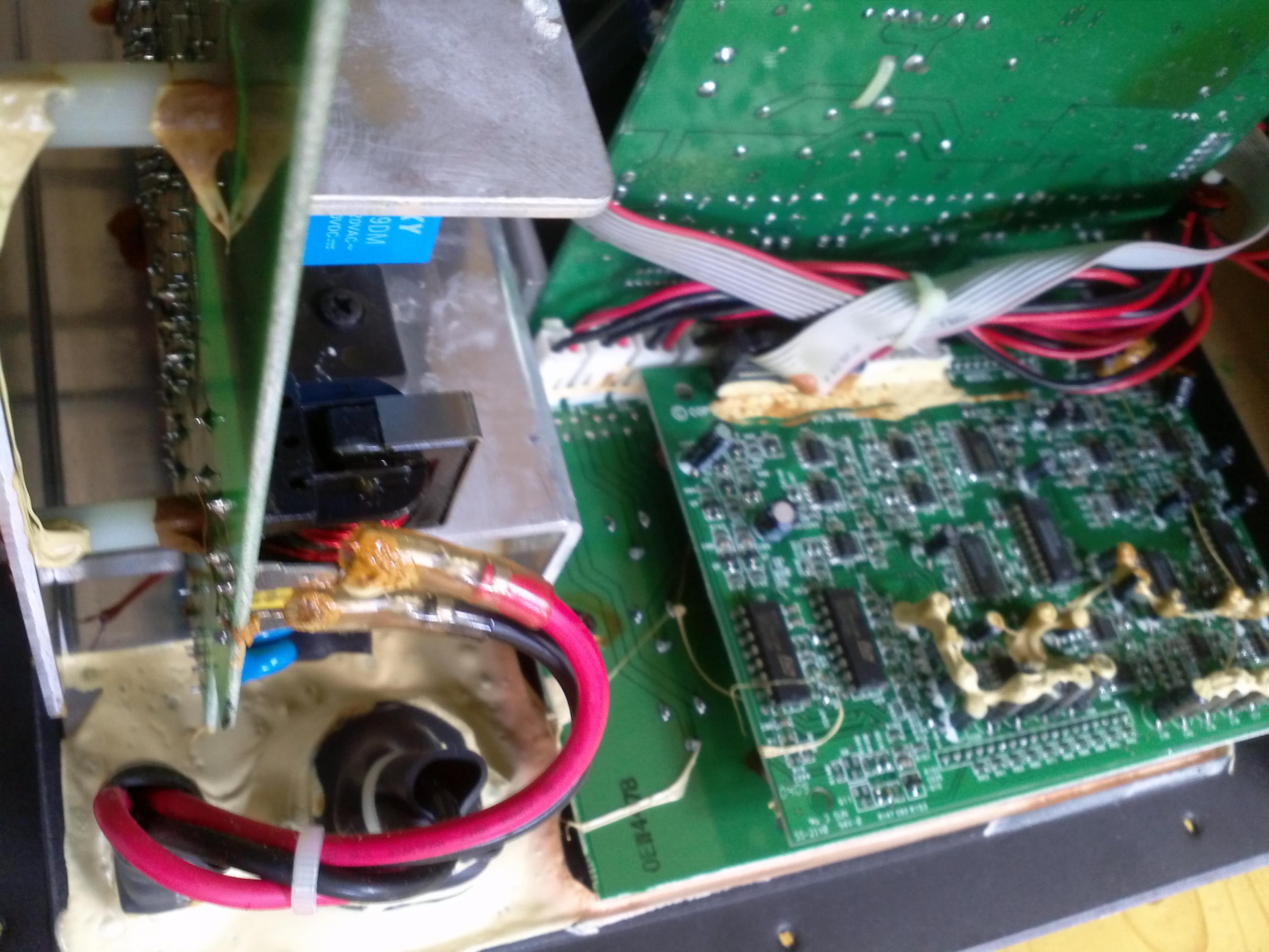

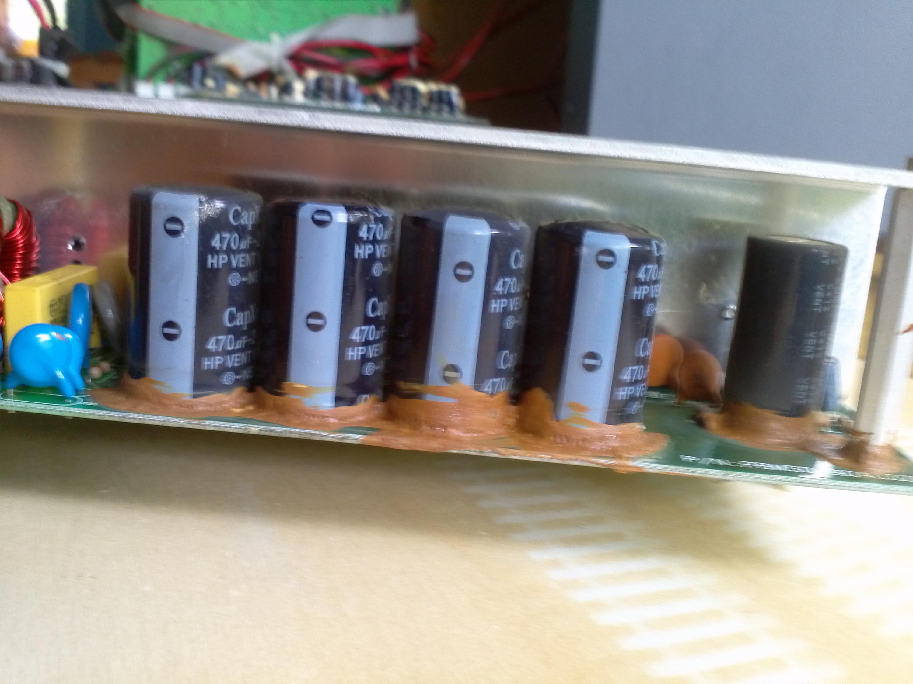

                              Hey BadCaps.net Forum. I'm suffering from the same sort of problem with the Creative Gigaworks S750. One morning when I woke up and wanted to listen to some jazz I noticed that my system wouldn't turn on. The power light on the back of the unit was blinking and the control pod didn't emit any light at all.
                              When I brought the subwoofer to some friends for advice on this problem, we plugged it in and flipped the power switch. We heard some popping noises and then the fuse was blown. We proceeded to carefully open up the unit and inspect the components. Now this is where Capxon apparently trolled us. Please take a look at CAM00178.jpg. We thought the third and fourth cap went bad because the top was convex. I ordered four replacement caps (470uF, 250 volts - instead of the original 200) and replacement fuses.
                              In preparation of their arrival I read the Recapping FAQ , which was very helpful for my first cap replacement.

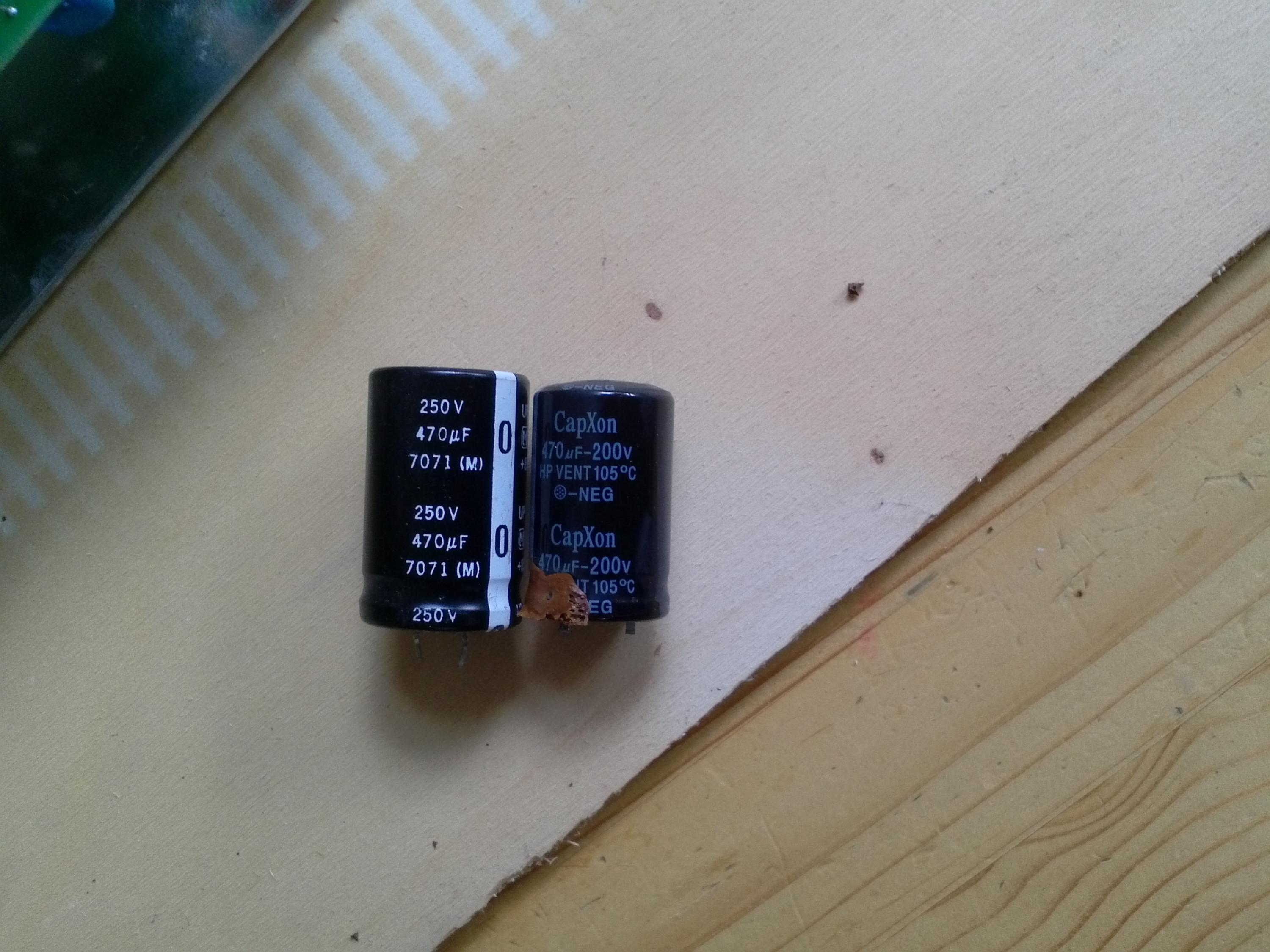

                              Today was the big day, a friend and I opened up the unit again and replaced the Capxons with the caps photographed on the left @ CAM00181.jpg. We had to be careful since the new caps were slightly wider, but we managed to connect all four of them. Then we decided to open up the Capxons for a post-mortem (and some revenge). This is when Hello Zepp by Charlie Clouser from the SAW soundtrack started playing. Capxon. uses. plastic. covers. that. are. convex. for. their. caps. (take a look @ CAM00183.jpg).
                              Despite this shocking revelation we replaced the fuse, reassembled everything and turned the unit on. We did fix something because there was no more popping noise and the fuse is still intact. Also: the led power light on the back was blinking quicker. But it still won't turn on.
                              Since I am at a loss I have attached some more photographic evidence for you to take a look at.
                              Would removing all of the brown glue and replacing it with super glue work (I'm guessing that depends on the difference between intentionally and unintentionally conductive glue: http://www.siber-sonic.com/audio/carnage.html? Which of the two would be used here?) ? (my super glue is only rated for 50 degrees C, btw.). I noticed, for example, that in CAM00182.jpg the brown glue is connected to the steel standoff, do you think this is by design?
                              Or do I need to replace something else. I would be very thankful if you were to take a look at some of the pictures and respond. I will stick with this topic until it is either fixed or the consensus is that I should just bin the unit (which would make me very sad since a replacement product is prohibitively expensive for me). I can take pictures of other areas if you so require.
                              Thanks in advance and kind regards,
                              Xavier.

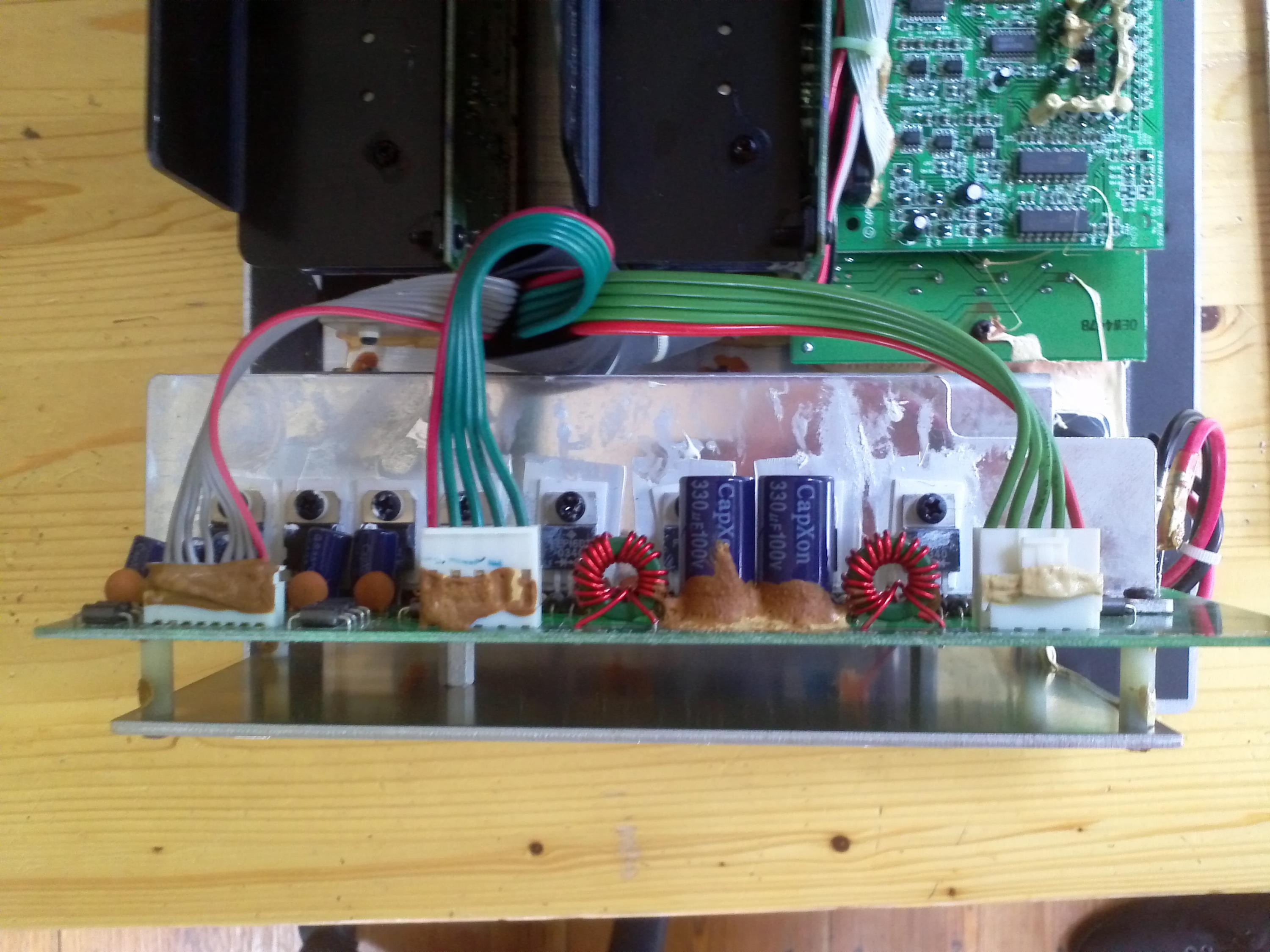

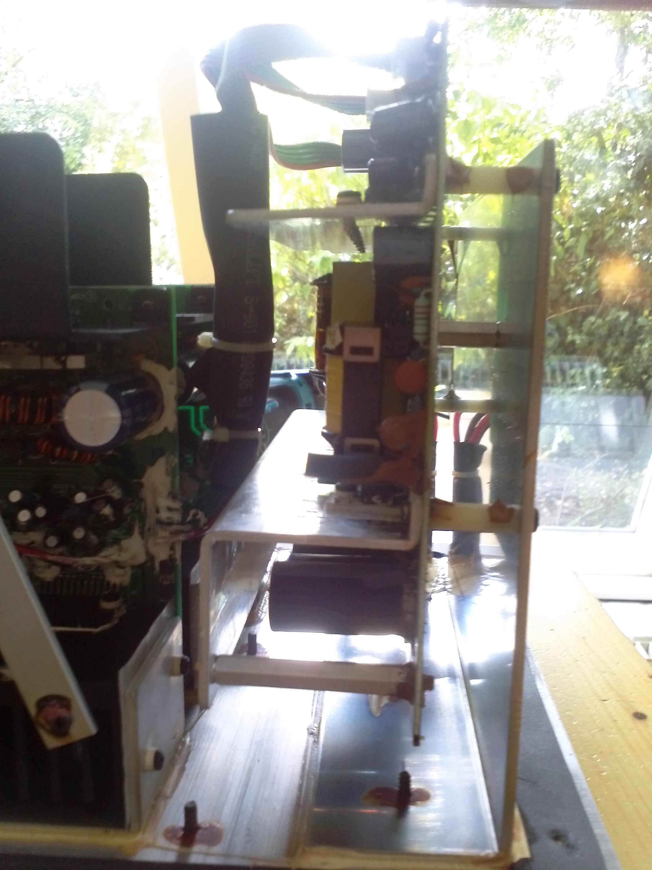

                                Another picture for your entertainment. The shrink wrapped capacitor (to the left of the blue one) is a bit loose to the touch.

                                  The CapXon capacitors may still have failed. I do believe that the HP series are prone to short out rather than just go high ESR. I would check the ones you removed for being short or open. They may have caused the fuse to blow and maybe other damage.
                                  If the power light blinking is NOT a fault code, I suspect the PSU is power cycling. Conductive glue causing a short may be the problem. The glue does not need to be replaced but it should probably be removed from any component leads and other circuitry.
                                  There may also be other blown\shorted parts in the PSU or in the other circuitry causing the PSU to cycle.
                                  I would refer to this: http://www.repairfaq.org/sam/smpsfaq.htm for advice on checking the PSU if it is indeed a power cycling issue.
                                    I got my multimeter right here. I think I understand how to check for a short (measure resistance in Ohms, if it shows some low number there is a short?), is that also how you check for them being open? Good thing I saved them
                                    I'll follow the power supply tutorial in the coming week (it's quite a long read I believe).

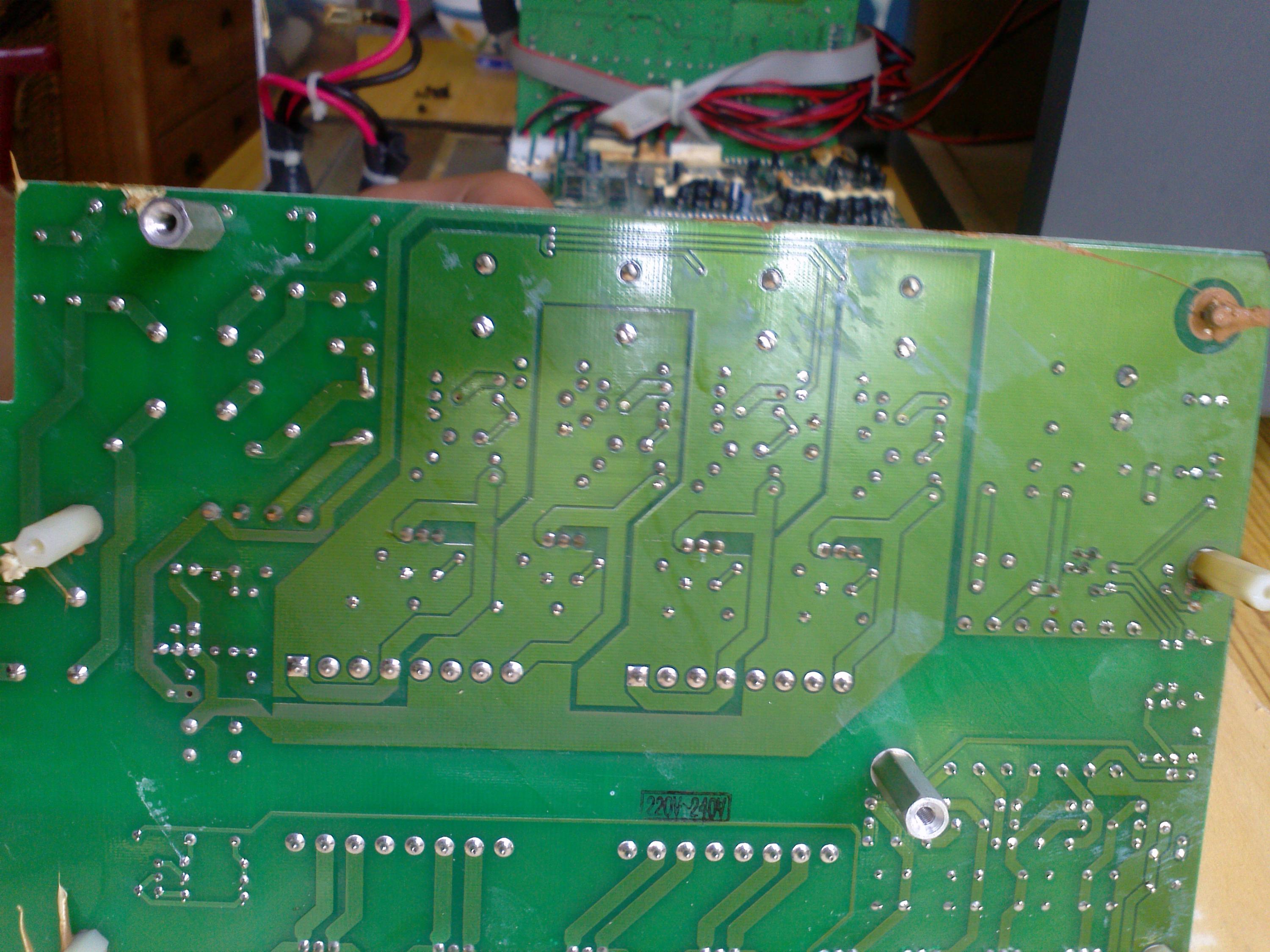

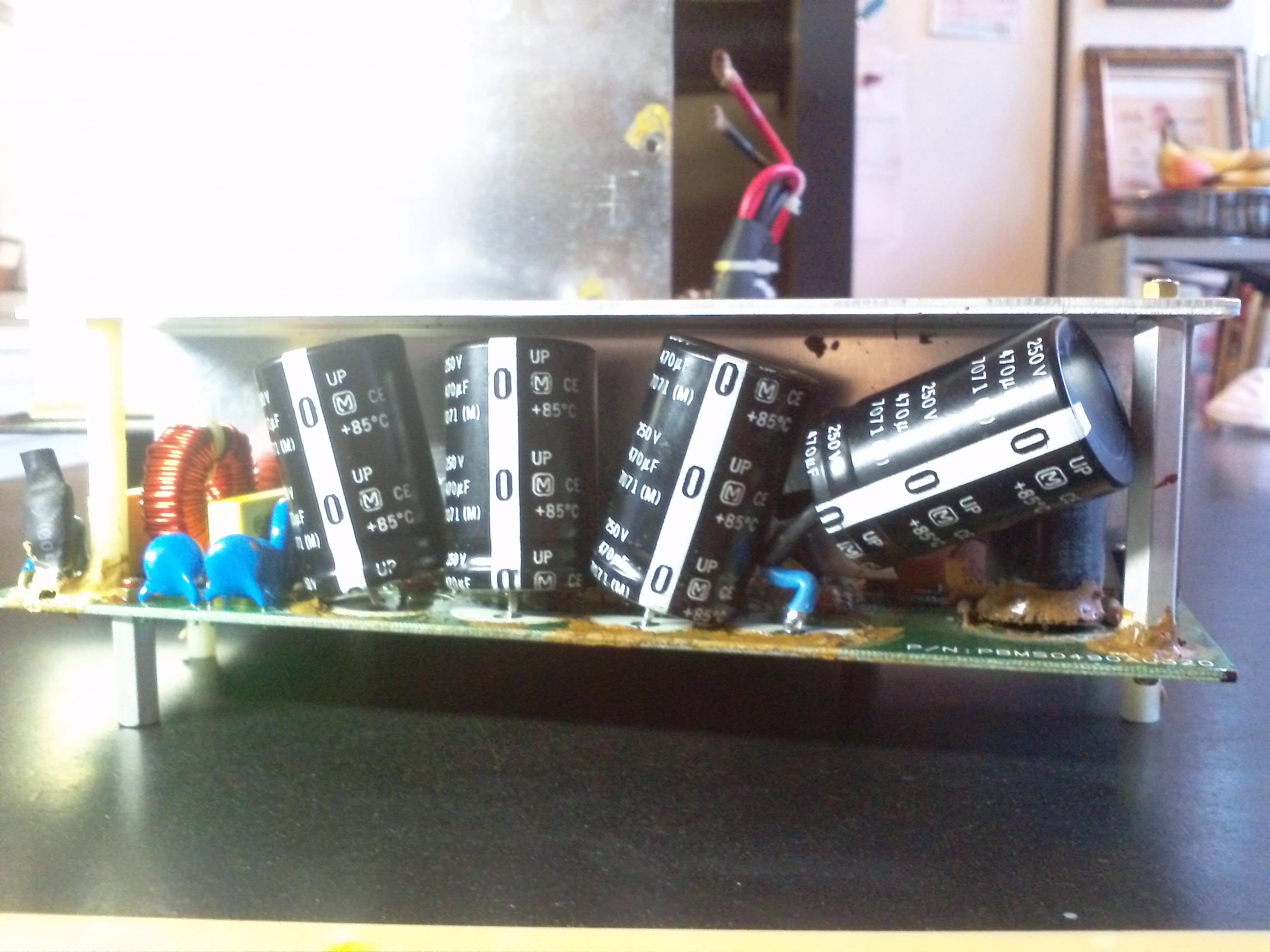

                                        I think this thread needs more pictures of the power supply board. The pictures in post #1 are excellent, but a picture of the underside of the power supply would also be helpful. That way we can see how things are connected and possibly try to force the power supply to turn on to see what could be bad.
                                          Agent24 and Momaka, I'll follow both of your suggestions as soon as possible, this will probably be during this week. For now I do have some more photos (in CAM00190 you can see how we managed to get the slightly bigger capacitors in there. It's not perfect but then again, neither was Creative's work), but looking at it I realize I should definitely take one of the underside (you mean the part of the pcb that is not covered in components I suppose).
                                          When I got more I'll make a new post in this thread!
