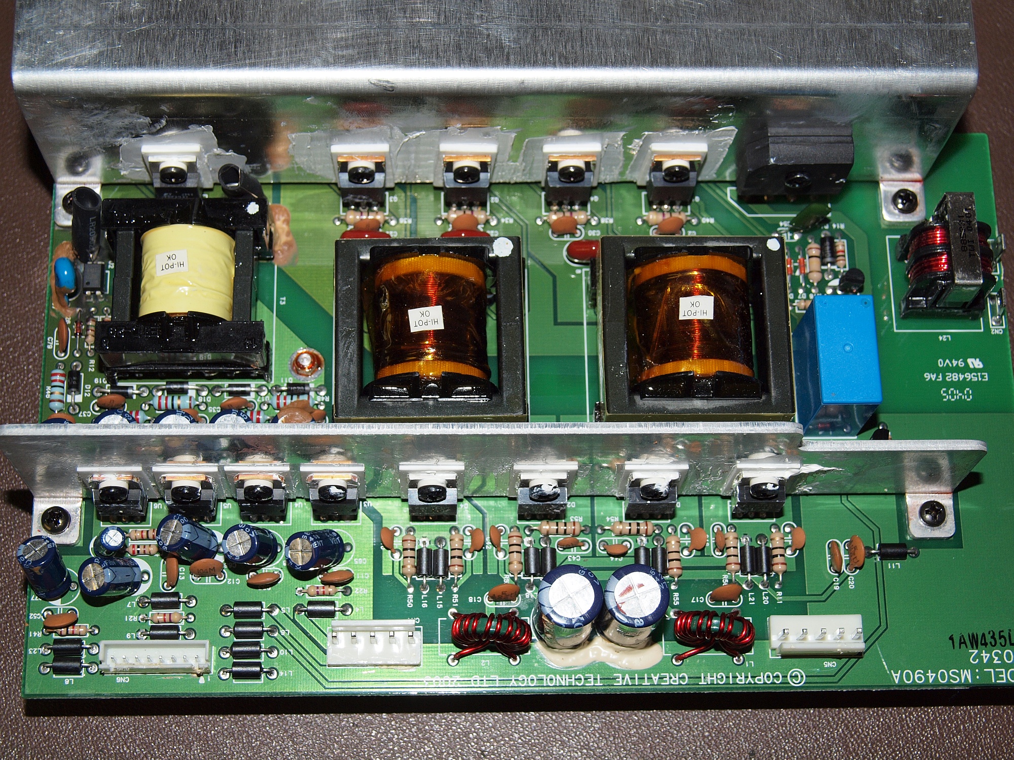

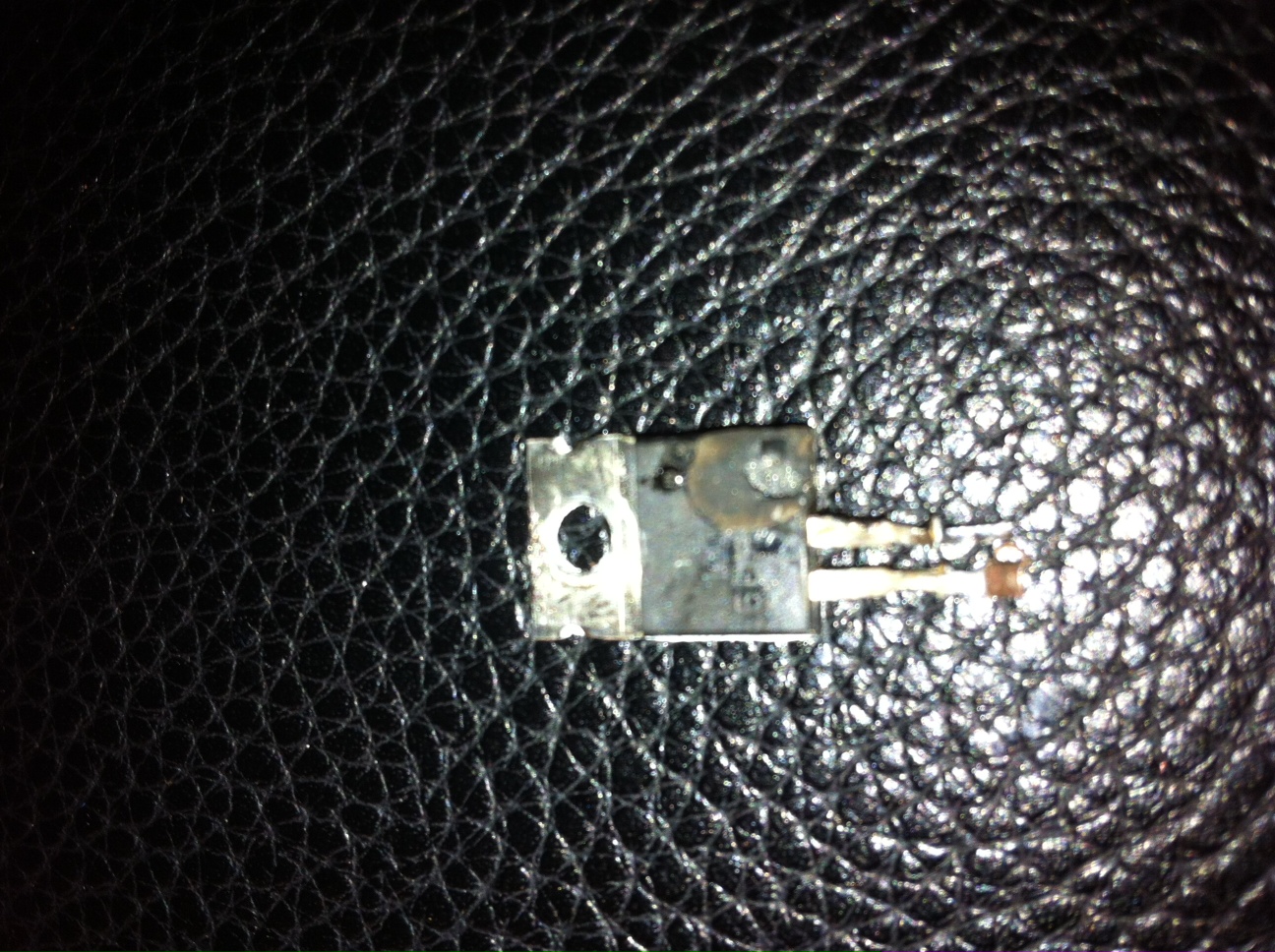

    Few days ago there was popping sound from subwoofer unit under minute after turning speakers on and then it went dead with control pod showing no power.
    Quick googling showed that in UK people have had these to blow fuses but 3,15A glass tube fuze under power cord socket is intact, and neither did 10A plug fuse trip even though it's probably faster to react.
    After taking unit out from under the table I tried turning power switch and unit's power LED blinks like in some search results of this speakers dying problem.
    After that I unscrewed about dozen screws and already opening unit's back for few centimeters showed bulging CapXons (HP 105C) in primary.
    There are no visibly burst caps but if you look second pic closely you might notice something on surface of PCB in its left side near smallest transformer.
    While scraping that gum for removing shrink wrap I took that third pic showing signs of sparking or flame from that shrink wrapped Su'scon.

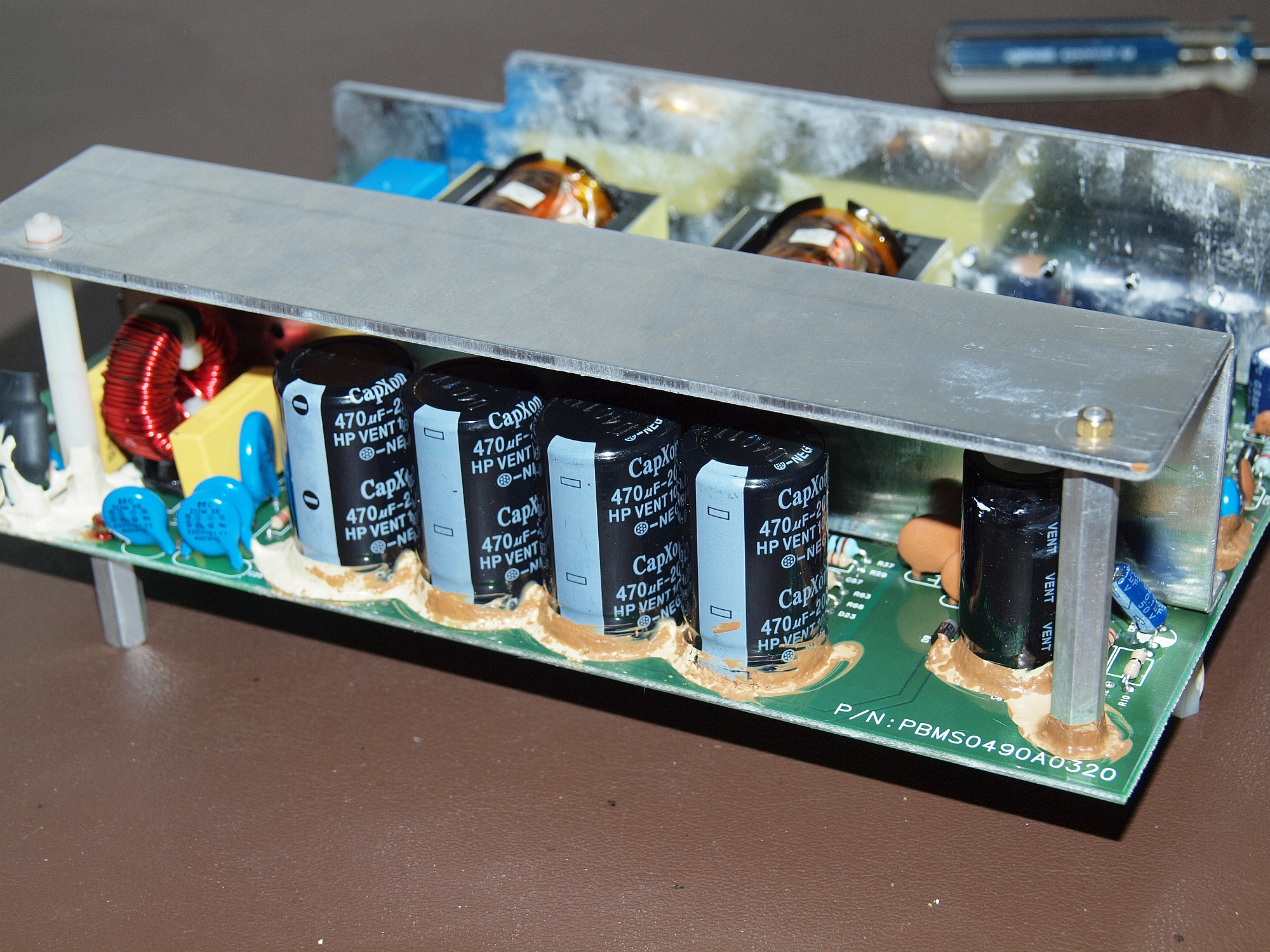

    Fifth primary cap (CapXon KM 105C) along that smaller transformer belong to "standby" section whose power is controlled by power switch in back of subwoofer unit and which gives power for control electronics and control "console/pod" whose power button in turn activates main power with that blue relay.
    All secondary caps are from CapXon GS serie. That one tiny cap in secondary along that "sparky" and little one next to standby's primary cap are Su'scon SL
    While having been bought/made in 2003 I've used so much headphones that I wonder if these speakers have even over 500 usage hours (and at very moderate sound level) meaning basically those caps expired all by themselves.
    With that high quality circuit board material and very good soldering someone should be shot for then going dirt cheap and using such junk time bomb caps!
    As no fuse was blown and there aren't signs of blown up semiconductors being responsible for that noise there should be decent chances for other components being intact.
    Any suggestions for highest quality caps to replace these junks?

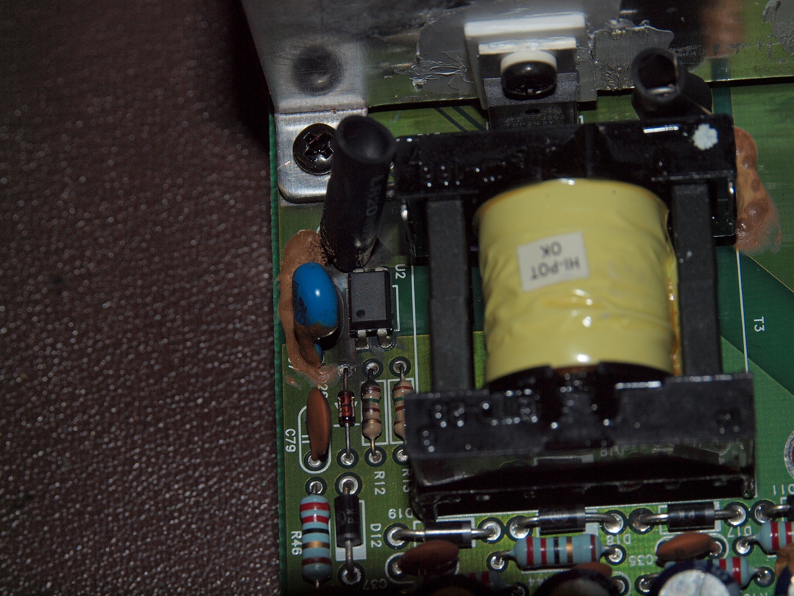

    Judging by the damage in that area there's a good chance that the optocoupler is shot too. If it doesn't power up after replacing the caps, drop in another opto as well. You can find several in any spare ATX power supply.

      ^2 on the opto.
      It also looks like the glue on the board went conductive.
      Remove all of the glue, recap with Pan FC or FM's.
      Check diode D26 for being open or shorted (out of circuit).

        Glue that turned conductive over time also did some nasty things to the Enermax Liberty PSU series.

          At least neither end of opto is shorted and same goes for D26 which seems as normal as it's possible to say without detaching it.
          Four 470uF 200V (22x36mm) primary caps are snap in models and standby's 68uF 450V cap is equally high but normal leaded. (18mm diam.)
          Also 40mm high ones could just fit in without removing heatsink but it's probably best to avoid decreasing gap between capacitors and heatsink for allowing better airflow.

                Standby's switcher is TOP243Y (seems instact as that LED blinked indicating some life and nothing is shorted between legs) and that little Suck'scon which gave fart connects to its control leg/pin (where opto is connected) through resistor.
                There's basic single diode rectifying for transformer's outputs and then L7920, L7908, L7809 and L7824 regulators in "secondary" heatsink.
                Opto's emission end seems to be burned broken as forward voltage should apparently be 1,2V typical but nothing shows on multimeter in either direction.
                L7824 is shorted between input and ground and this is also the rail monitored by opto so looks like same spike took out both. My guess is that Suck'scon's failure spiked outputs enough to zap these two parts.
                L7920's input-output shows 800 ohms but there's at least 1kohm resistor in between them so that's not yet entirely sure sign of failure.
                In addition next to Standby's primary cap there's one "Resistance is futile." 1N4004FS friode with 0ohm/0V to both directions but despite of its position in there I'm not yet sure what's its function: Cathode is connected to ground and anode is apparently connected to also main bridge rectifiers one leg and trace continues also to main power's relay contact. (have to remove those other primary Crapxons for better view)

                  Some multimeters aren't able to test LEDs, and that includes optos. Try measuring a red LED with your meter and see if it lights up and/or shows any reading. If it doesn't, then your meter isn't adequate for testing the opto, but replace it anyway.
                  1N4004, change with 1N4007. I can hardly believe they still use the lower rated ones, it might be that it's the only diode of that kind on the board, coz sourcing 1N4004s AND 4007s would be more expensive than getting 4007 alone. True, the 4007 has a bit higher forward voltage, but i'm 90% sure it doesn't matter in there.

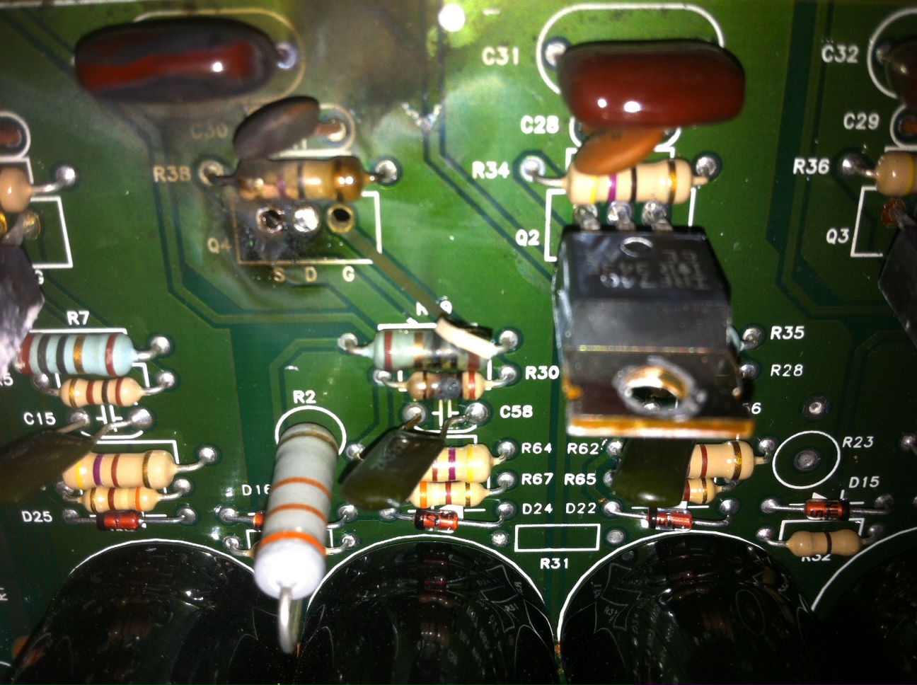

                                      Well, i just fired this thing up again like i did before, using a hairdryer, it almost powered on, started switching on/off as usual, then suddenly one of the MOSFETs exploded! Now I'm starting to worry that I won't be able to revive this unit.
                                      Now I am looking for a Mosfet, it's labeled IRF740 I*R 343E 6E A3, can't seem to find this exact numbering anywhere.
                                      Also, now that I have it apart I can read the 5th cap info: Capxon info, 450v, 68uF 450V

                                        Those resistors are probably bad now too (R30 and R38)
