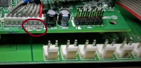

                            #93
                            Re: Creative Gigaworks S750
                            Hello @all !
                            If I write here, you can think a have a trouble with my S750 set.
                            In resume, it works well for many years (~12 years) ; for a month ago, I wanted to start my set again, after so many weeks off (but it was always connected to the AC outlet and in standy mode) ; as I pressed on the power on button of the remote console, I heard a "pffff"-sound, then all switched off.
                            I check the fuse : it had burned. I also opened the subwoofer, and it very smells badly. Yes, a cap had explosed ! And guess what, it concerned the 4x 470uF 200V, the C70 one. The 3 others were bombed, so I decided to replace all 4.
                            After reading so many posts, I clear all the "burned" glue everywhere I could and replace the 4 caps and the fuse.
                            Pluged on power outlet, switch on : the green led on the back turned on : check ! But I heard a "boom" sound. As the leds are still on (green on back, red on console), I decided to power on : it powered on, 2s... and then total black out. The fuse has burned again.
                            I open it again, but nothing "bad" to see.
                            As, when I replaced the cap, the negative "port" under the board were broken under 2 caps (I checked, all were conductive), I decide to remove all the caps and deport them, as you can see on the picture.
                            But again, the same story : when pluged in, the green led powered on. No more. But, when I power it on via console, after 2-3s all goes off, the fuse burn. To notice, I've glued the caps, the first one (c70, which one has explosed, had "jumped", but not explosed.
                            My electronic knowledge are very limited, so I don't know whats wrong. I tested the port on the caps ; I have a short circuit on the C69 and C59 (the 2nd and 4th ones). I visually check all the other component, they're seem to be OK. I tested the PSU board alone (the 2 DASH board were deconnected).
                            I really want to repare my set (and not throw away), can you please help me ? What can be the problem ?
                            I post some pictures if it can help you
                            Thank you in advance,
