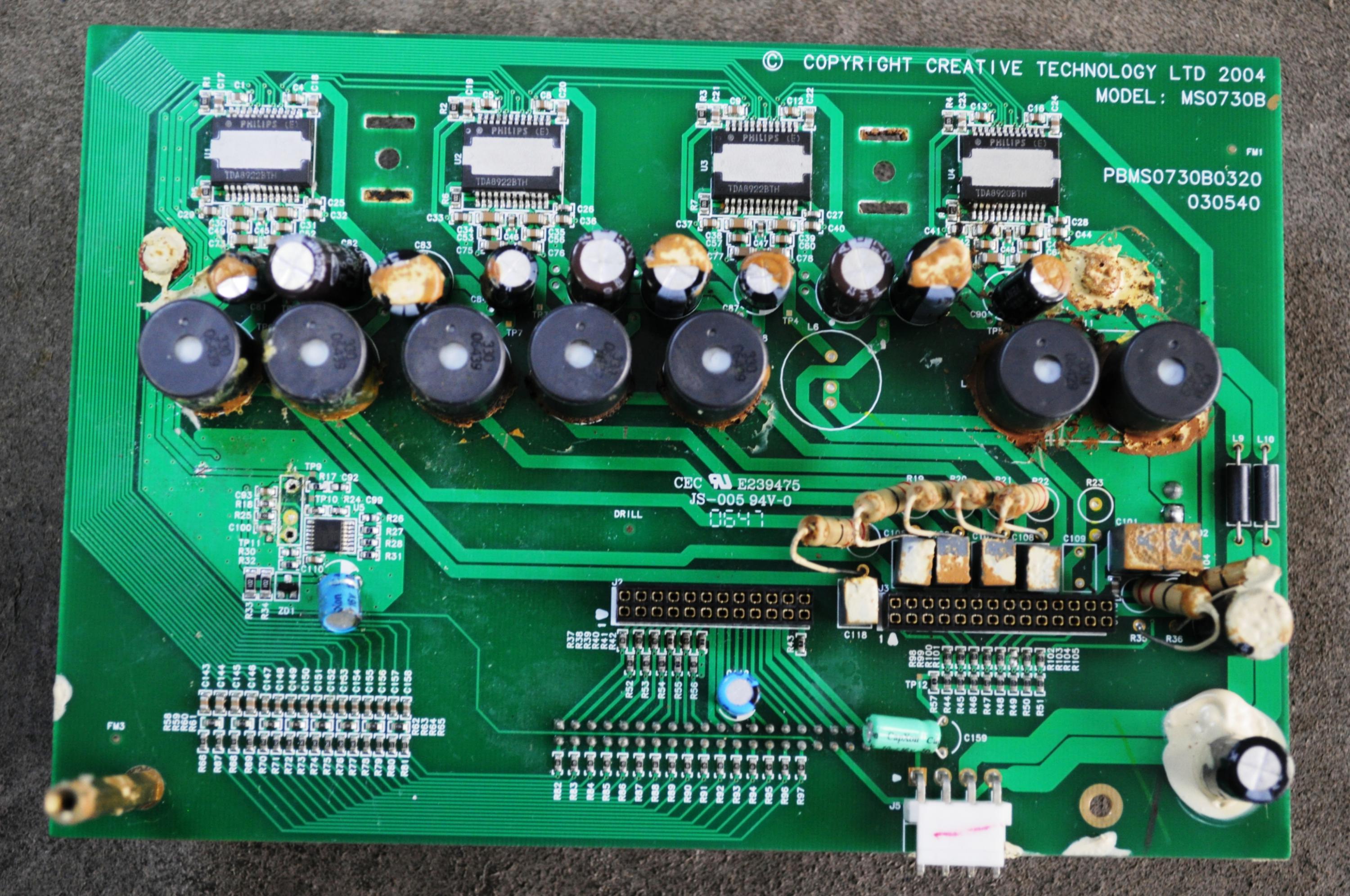

    Re: Creative Gigaworks S750
    That crap glue that turns brown and conductive should always be removed, it will go bad later and wreck things.
    If you want good glue for replacement, I would go with 'Neutral cure silicone rubber' as mentioned here: http://electronics.stackexchange.com...oid-vibrations
        Originally posted by jnzz001
        Well, that's ez - got plenty of HQ 3M silicones, how about removing the glue - that's chemical or just mechanical stripping and what did you use???
        Just make sure it's a neutral cure type or you'll corrode things and make it even worse.
        lexwalker says he used a screwdriver to scrape the glue off. I think some kind of mechanical removal is the best idea. Chemical would probably damage other parts too.
        -David VanHorn

          #64
          I just booted them with new parts and so far so good.
          What I suspect is that a pad (positive one on one of 4 big caps) was hanging in the air or barely connecting.
          I was soldering them 1 at a time now and checking connections - the first one was fail and I just had to offset them all and solder from another side (had to leave like 2mm between the cap and the board)
          Aye, beware of damaged through holes and always check for connectivity. Even though the solder pad may be still there, the connection to the top PCB layer could be be iffy (e.g. solder touching only) or broken altogether. That's why I've used the "L" wire method connecting to top PCB layer through the hole together with the capacitor leg. That ensures good connection at all times.

          You don't have to use any glue furthermore...
          and these other boards, glue and caps just look atrocious...
          should I be worried or not just yet?
          Yes, clear them whenever possible especially those glue that have turned from deep yellow to darker brownish colors. Sometimes cannot tell from the top of light yellowish glue if there are degraded glue underneath. Thus you need to scrape to check for degraded glue hidden from plain view...
          Just use a flat head screwdriver. Can be a tedious job and sometimes time consuming job. Need to be careful around fine traces as not to accidentally damage and/or break any traces/tracks. That's why I've mentioned avoid using very sharp tools like a knife or blade for most of the cleanup. You can still use sharp tools but only when there are difficult spots (and have to careful not to damage fine traces). The more difficult parts are the places there are small SMD (surface mount) components under the degraded glue (such as the audio controller board). Thus must have lots of patience (otherwise may end up cracking and/or damaging those tiny SMD thingy)...

            #65
            well... my glue came off mostly with film - much copper exposed
            never mind

              #66
              never mind
              Well, no one is perfect. The degraded glue has probably eaten/embedded into the green solder resist layer. Here is another one of my work-in-progress, first image is before cleanup and the second image is after cleanup. This one is a Creative GigaWorks G500 ProGamer, which has some SMD thingies and some of the degraded glue got between the power amplifier I.C (TDA8922BTH) pins. The degraded glue has eaten into the green solder resist layer. The previous repairer did a bad job (was returned to the owner as "un-repairable"). Not only he did not remove the degraded glue but also damaged the through holes for the capacitors (he also re-soldered the original bad capacitors back with many of the capacitors having its legs hanging with a blob of solder and not secured to the board!)..

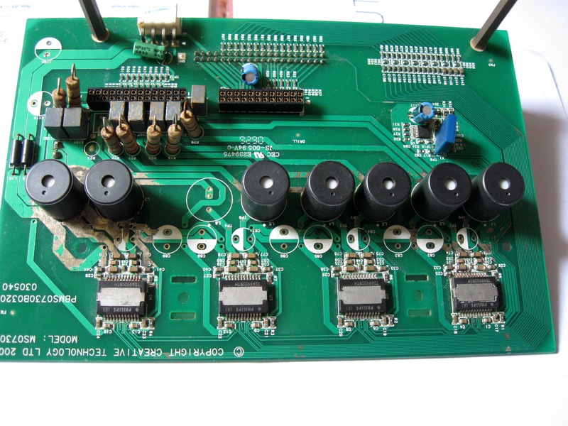

                                hello
                                i had problems with my system, and i replaced the relay
                                now the power supply is ok, but i have no sound. i can power it up, turn the volume to max but no sound comming from the speackers
                                i measured all voltages on the TDA ,
                                on the mute pinof the TDA i have 4.6v so i think it should be ok,
                                i problem i think it is with the oscillator. i see this system uses external oscillator, and to work with external oscilator i read on the TDA datascheet that the OSC pin should be 5v. that is pin no.7 of the TDA. and on that pin i have olny 1.2 V.
                                can anyone help with a measurement?

                                  #76
                                  I have not looked at this thread for a while.
                                  Which TDA chip is this? Model number?
                                  Can you post some good photos of the amp board?
                                  Do you get sound on any channels or none at all?
                                  -David VanHorn

                                    #77
                                    here are some photos of the 2 boards

                                      #78
                                      TDA 8922BTH
                                      And i don't get sound on any channel

                                          #80
                                          I looked at the datasheet (attached)
                                          It seems for an external oscillator input, the 5v means that's how high the signal can go above SGND (signal ground).
                                          You will need to measure with an oscilloscope or look with a frequency counter and see if there is a waveform between 210-600kHz as described. I assume it will be a square wave. When measuring with a voltmeter you will get the average DC value (think PWM effect) and it will not be 5v.
                                          What else have you checked?
                                          Do all the ICs have the correct voltage rails present?
                                          Have you checked the audio input pins to see if anything is going in?
                                          Did you check the MODE pin 6 to make sure the ICs are not in standby or muted? It should be above 4.2v for normal operation.
