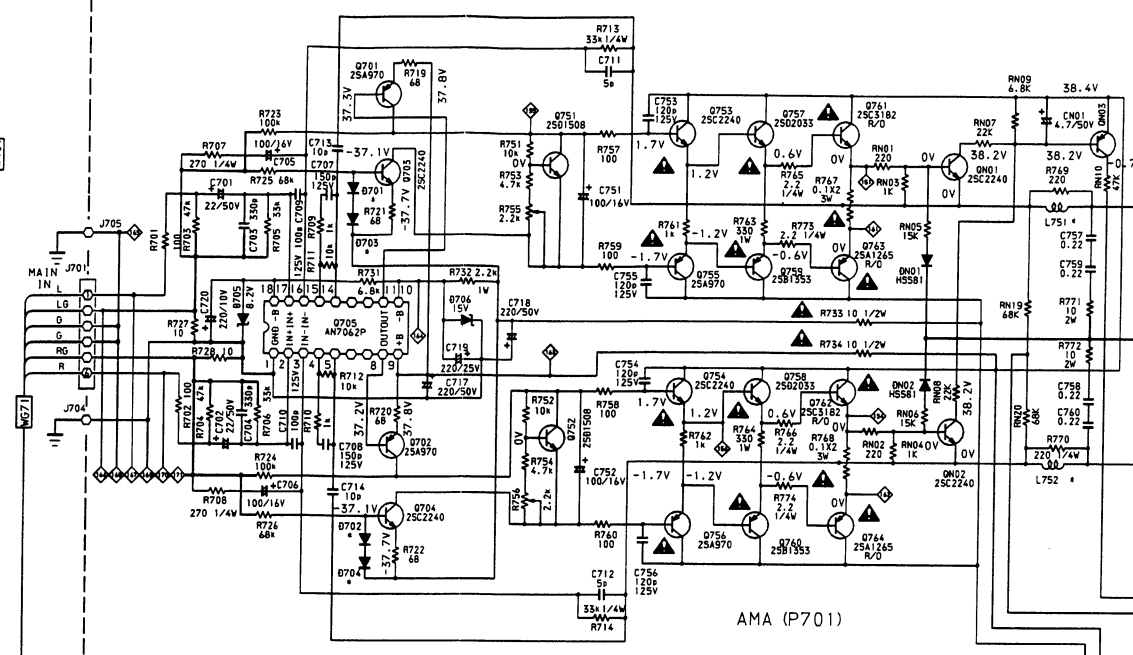

    quickly get voltages at bases of q754 q756 .

        Re: Marantz PM-66SE Burns Transistors
        Seems Q754 Q756 and Q758 should be in cutoff but they're not ... somehow Q758 is shorted or has the wrong polarity?
        Check the npn/pnps carefully if the transistor still tests good...

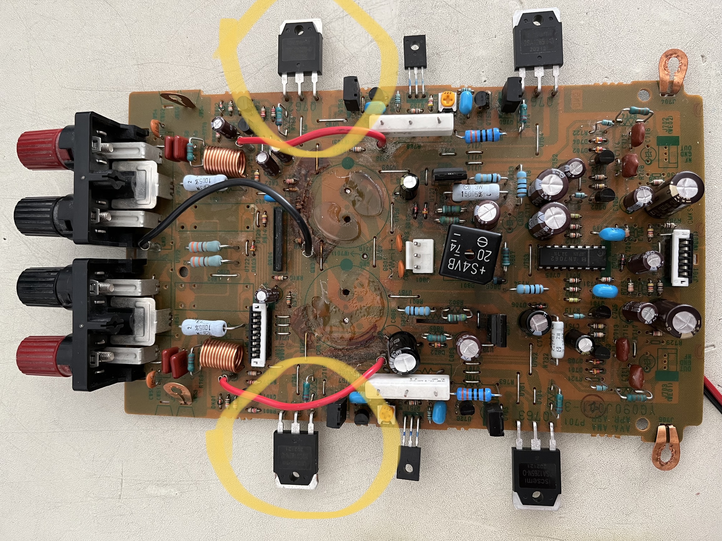

        adding original board photo to this thread too...since icloud is so slow for non apple users apparently.
              Put all the transistors back except Q757-Q764. you should be testing at steady state - after everything settled. When you mentioned -12V@B(Q754) and -17V@B(Q756) this was a bit large of a differential but should be okay - as long as the difference between the two pins stay less than 4v or so apart after settling. According to the schematic they should settle to 3.4V difference or so, 1.7V each to GND when idling/silent.
              At the next stage with Q758/Q760 installed, their bases need to be within 3v of each other. It says 2.4V or 1.2v to GND at idle/silent.
              The gains of Q753-Q764 don't matter very much, they just need to work as transistors.
                  17.8V-14.5V=3.3V so this is actually good for Q754/Q756 but its absolute value should not be so high unless there's an input bias (are you shorting the inputs to 0v during testing?)
                  With the voltages at 14-17v, Q756 and Q760 should be cutoff, but you're saying the B-E junctions of Q754 and Q756 are 0 volts difference and thus shorted?
                  R762 is in place? Did it fry?
                  What is the voltages at Q702 and Q704 (B,C,E)? In any case the voltages on the drivers are looking like they shouldn't cause the drivers to fry unless the wrong devices were inserted or pins swapped.

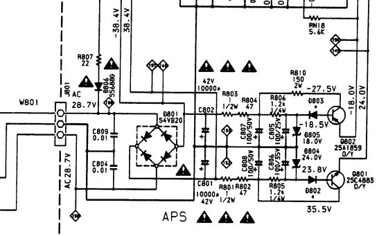

                        Check C-E of Q801, Q802, they are probably shorted.
                        Then check the voltages from attached screenshot.
                        +24V and -18V must be there otherwise something else is wrong with those regulators.
                          Those are not shorted.
                          Q801: B 24.4V; C 41.0V; E 23.8V
                          Q802: B -18.0V; C -40.3V; E -17.5V
                            OK, but +24V and -18V are not the only voltages. +/-38V are used for the amp.
