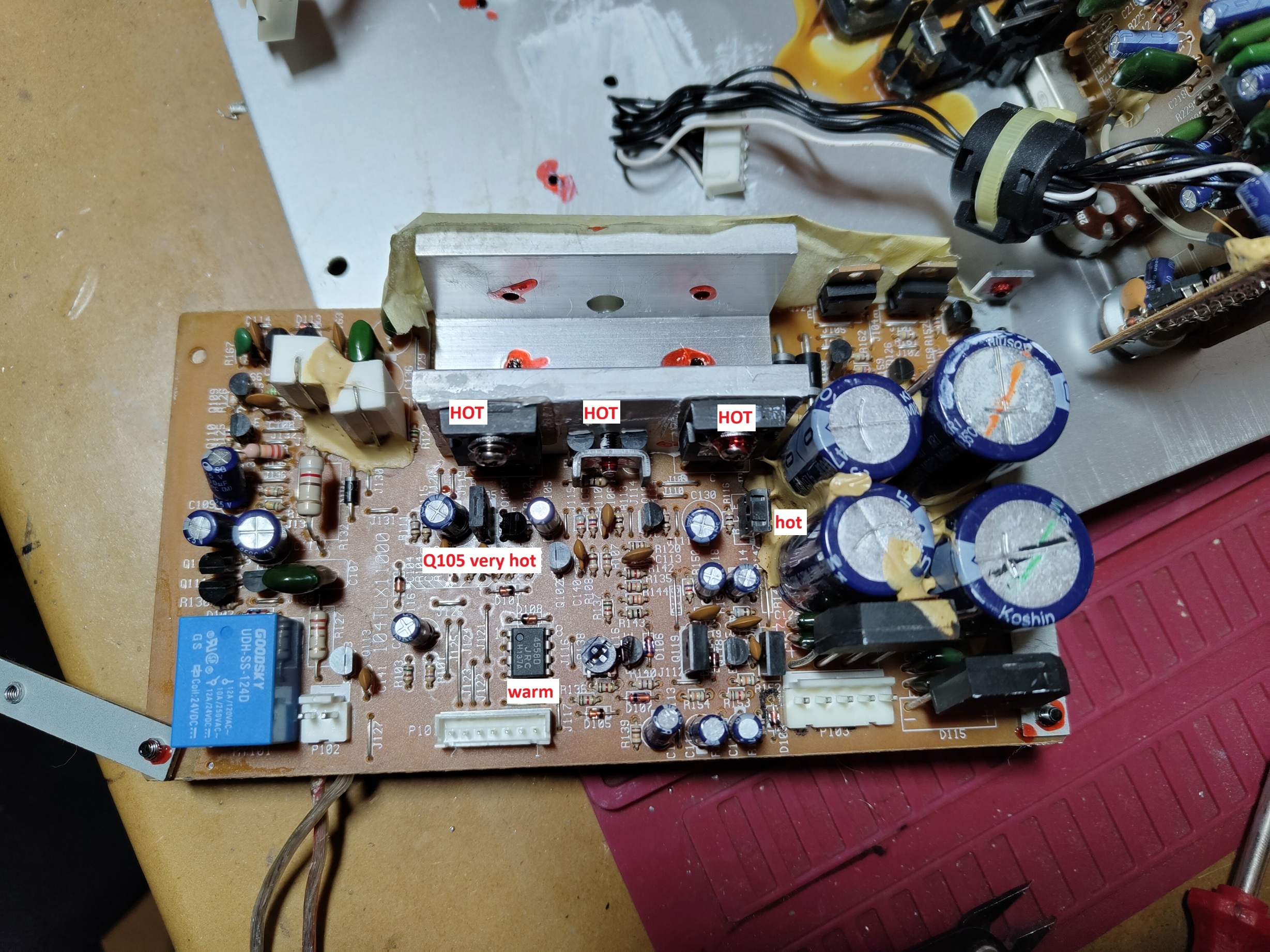

    I'm trying to diagnose this amp but my knowledge run out and need advise.
    The transistors on the amplifier are rapidly heating up after power on and the speaker produces a wobbly humming noise. I can also measure a lot of weird things on the board.
    Checks I did so far:
    • visual inspection for burns, bulged caps and so
    • speaker terminal measures 0V during operation
    • checked all transistors for short and voltage drop - they all pass
    • checked all capacitors nearby transistors as well resistors
    • no shorts anywhere
    • Scoped the transistor and I can measure a 5Mhz sine wave on the emitter

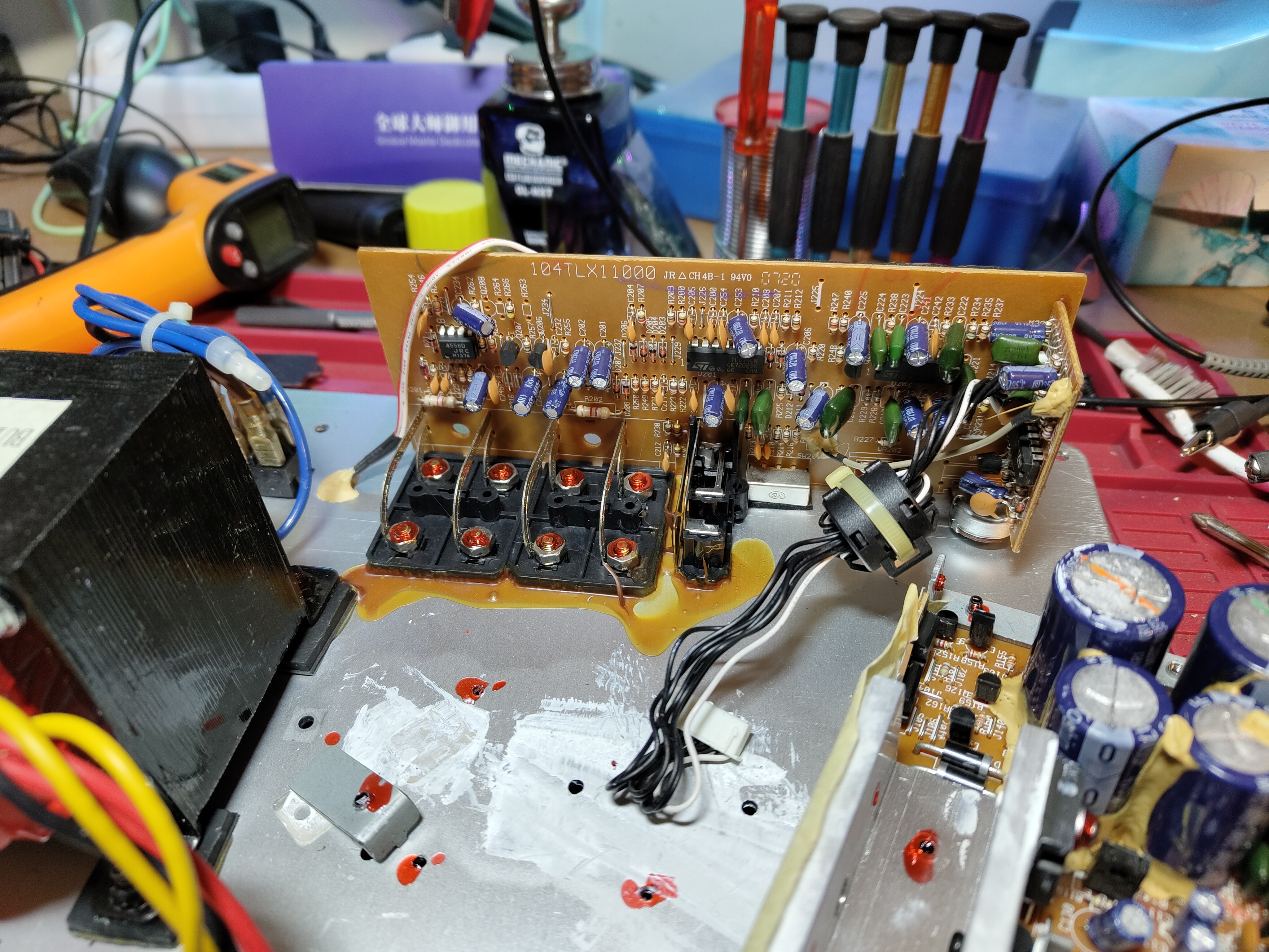

    • when preamp board is not connected no signal and no heat
    • TIP35 and 36 Transistor Vce measures 6V
    • Cement resistors behind transistors measure 145mV difference between the two

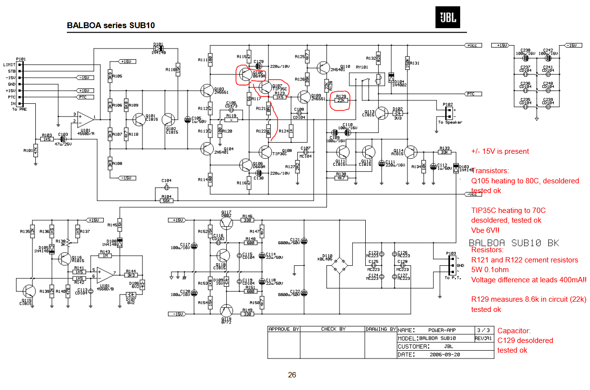

    there is no schematic available for this exact amp but the JBL Sub10 schematic is 95% the same so i have used that

    I thought it was something with the bias circuit but i cannot really find a faulty component. Maybe opamp? or something on the preamp board? I'm not sure.
