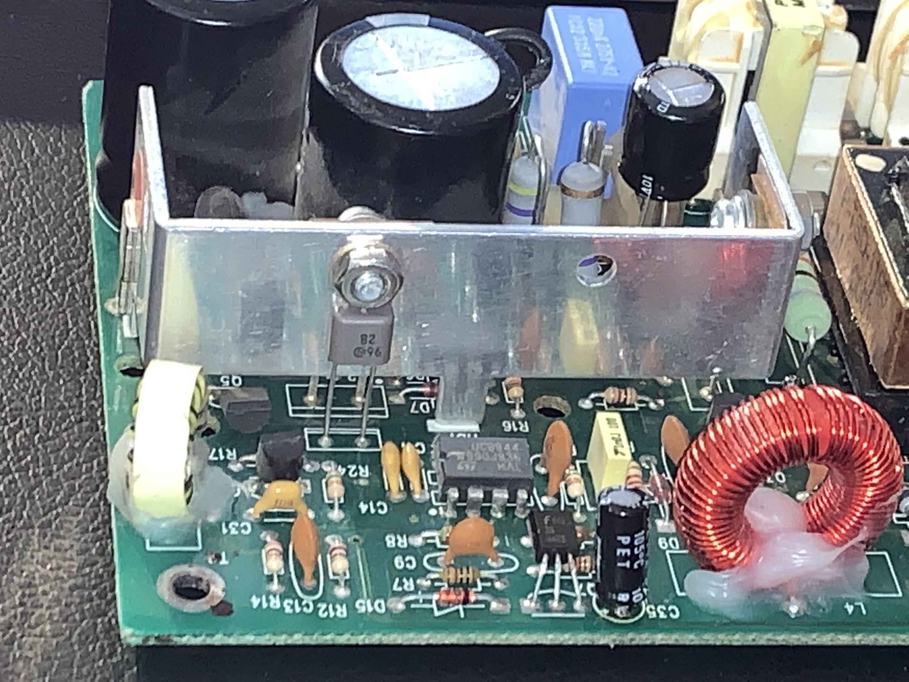

    Re: Repairing Alesis M1 Active mk2 Monitor Speakers

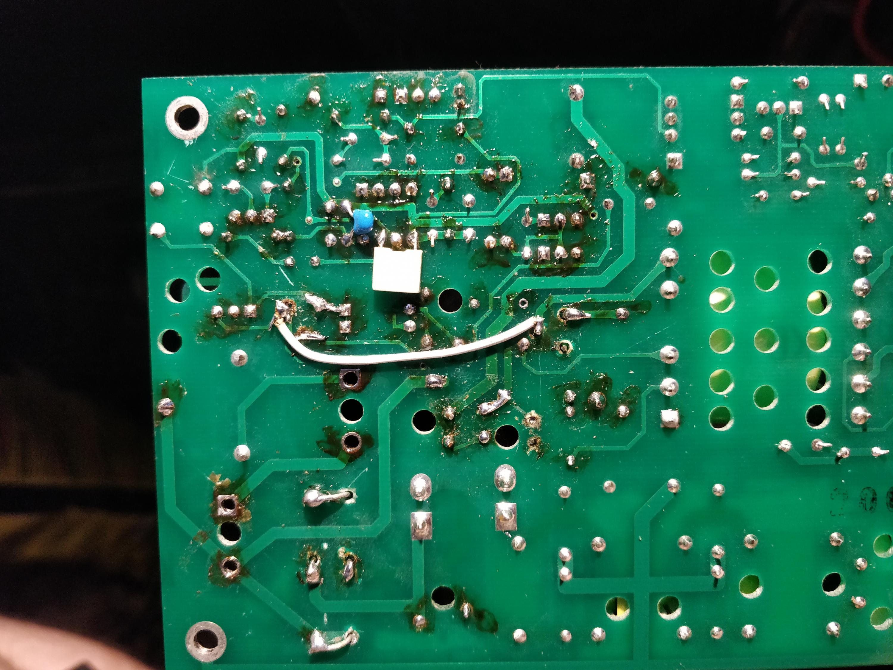

    I know this might make me sound like a "vulture" / "scavenger", but with filth's frustration with this project, i struck a deal with him and bought his dead pair of M1's
    First one was delivered last week, its pair is due next week.
    This first one turned out to have quite the "chain" of problems. Before even plugging it in the first time, i took the liberty of doing the relocating trick with C8, as well as replacing D5 with a 1A fast-recovery diode. All the silicon on the primary measured fine. Amp-board-less testing revealed that the PWM controller was powering just fine, but both outputs were at least 50% higher than they were supposed to be (+/-36v and +/-57v instead of +/-18v and +/-36v).
    After a quick consult with Th3_uN1Qu3, i even swapped out the TL431, to no avail. Which then led me to start measuring the resistors around it, and R30 (100k) turned out to be the culprit - open-circuit. Replacing it brought the output voltages back in line
    The overvoltage, though, had killed the LM3886 woofer amp (both output transistors shorted through, so V+hi, V-hi and the woofer output were basically fused together). Fortunately i still had a few sample ones from well over a decade ago, and once that was replaced as well (complete with cleaning the heatsink, the mica isolators and the LM2876 tweeter amp, and adding some fresh Arctic Cooling MX-4 paste), the thing was completely revived
    Looking forward to receiving its pair now...

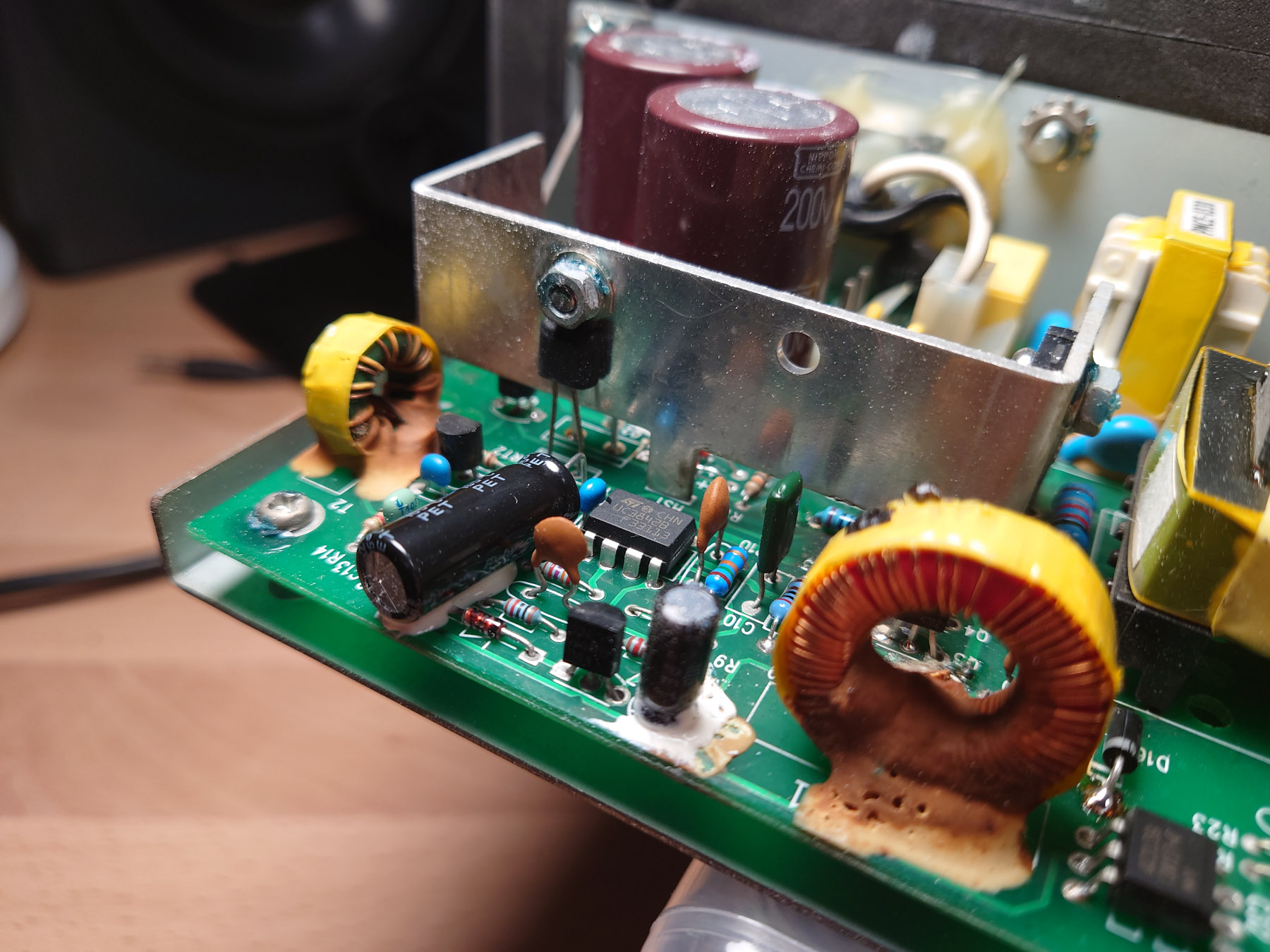

                        It was past midnight last night (with my alarm about to go off at 5:50am to get up for work), but i got it done! And, of course (?), all is well and working fine
                        A piece of solder-drenched solder-wick here, a (thick-ish) resistor leg there, solder-resist scrapef off etc...
                        As part of the rebuild, i also stuck in two pairs of Teapo LXK 680u/200v caps on the primary, "for good measure".
                        But it's done!
                        I "couldn't" sell these even if i wanted to (to make it worth the time and effort), so it's just as well they'll be part of the anniversary gift to my significant other

                          WOW!
                          That PCB sure has seen better days. Not talking about the wires on the bottom here - while they aren't a great job from the original owner, they aren't terrible either. What really intrigues me here is how many components have let out their magic smoke - particularly that one TO-92 transistor in spot Q4. It's like someone took a bite right out of it. Must have been quite the sight to see when the whole board went off.
                          But it's done!
                          Not bad at all!
                          It's classes above this ghetto trace repair job I did... which still works!

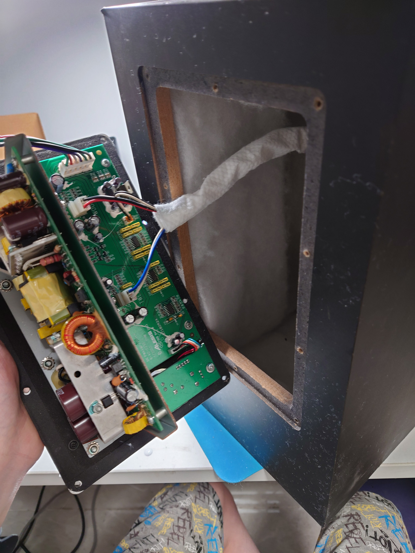

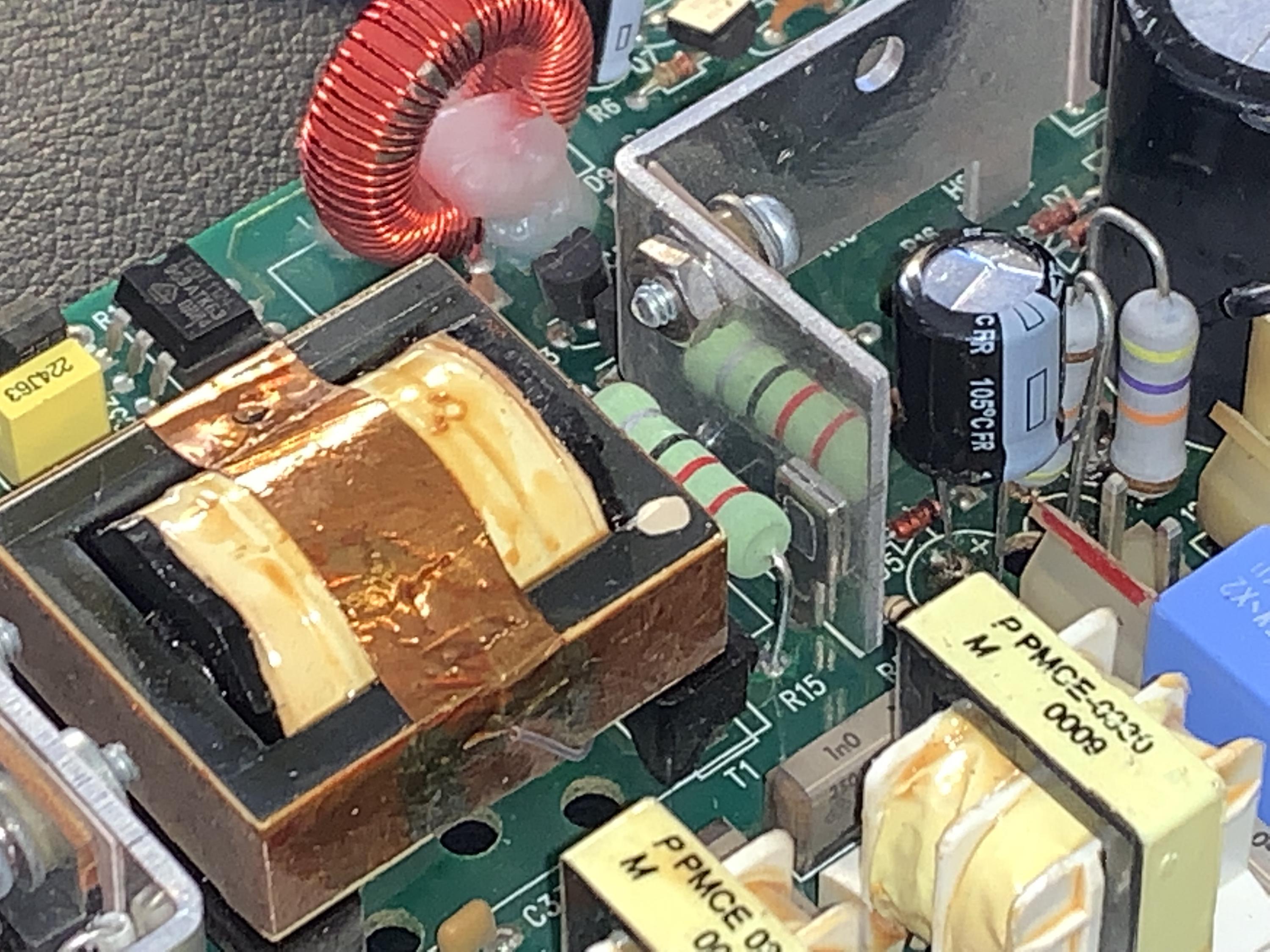

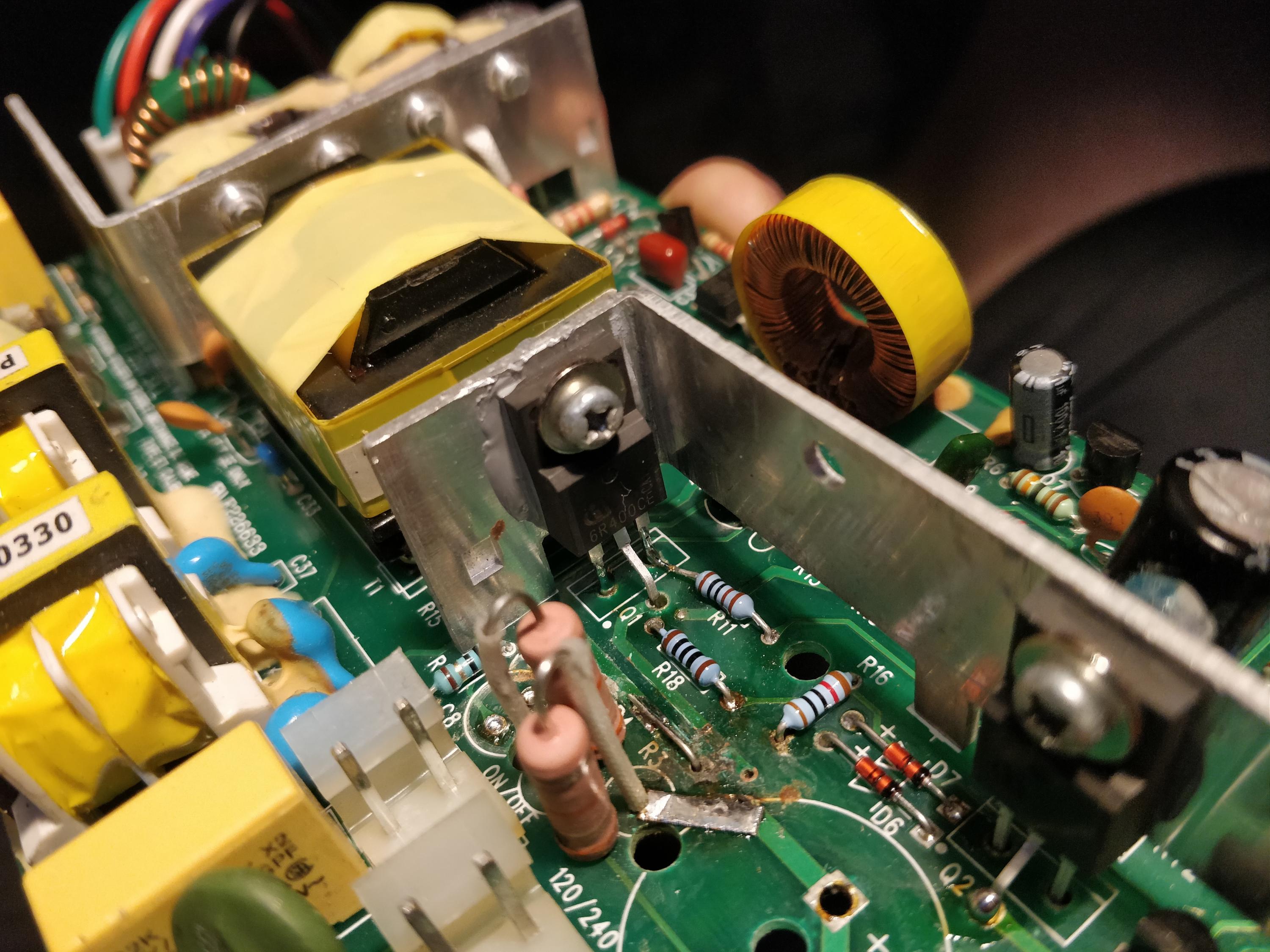

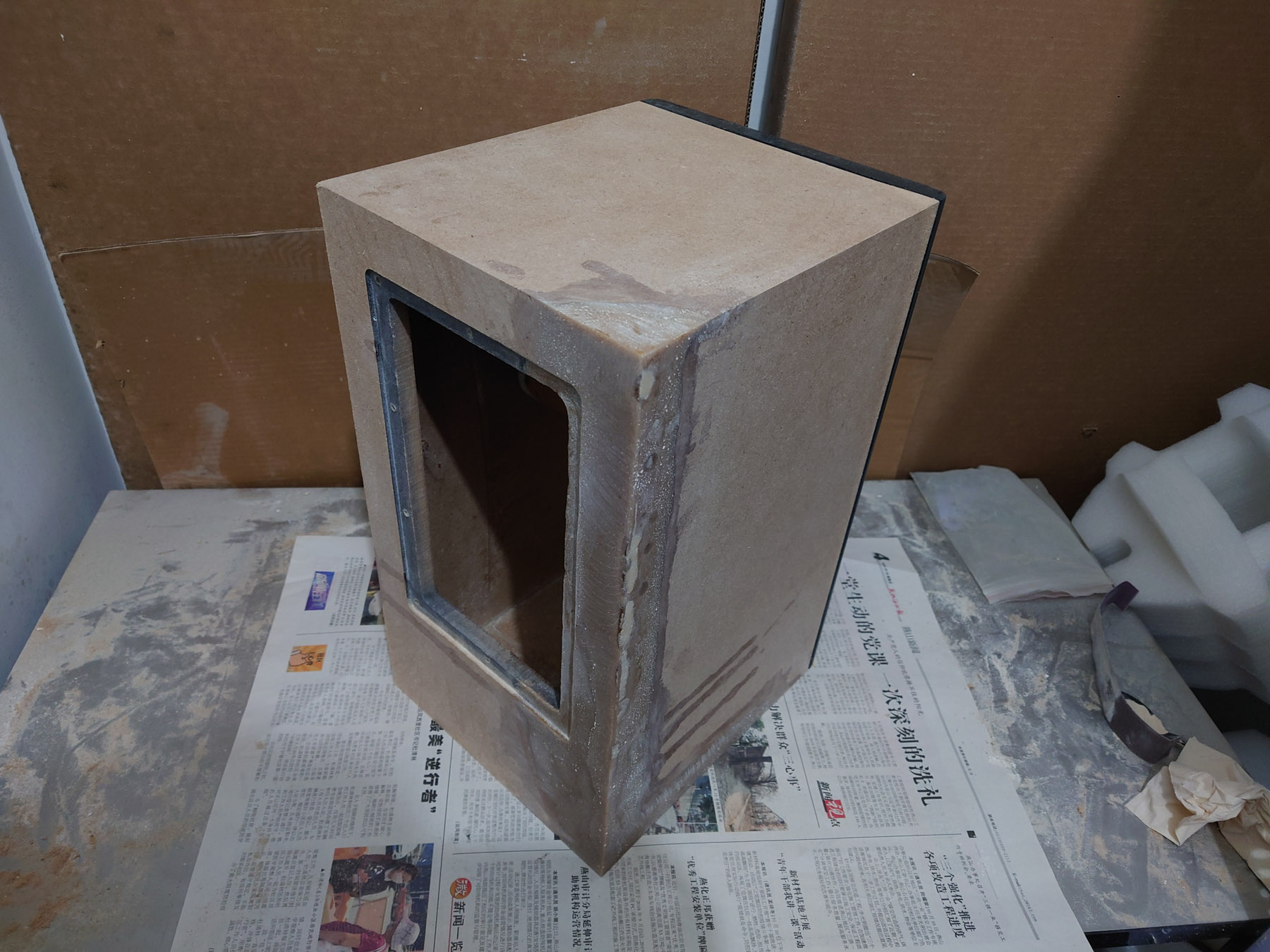

                            Found this thread while searching for repair knowledge on the MKII, was surprised to know there are still so many people interested in these speakers(it has been more than a decade, obviously).
                            I recently acquired a pair of MKIIs, one in working order with some water damage to the cabinet, while the other one won't turn on. Took both apart and found the working one has a lot of bulging caps.
                            The bad one has exploded F1 R11 R15 and Q3, which seems to suggest a short in Q1. This one also has been repaired at least once before, it have exactly same burnt traces as LuigiDJ posted in 2011. These were fixed with some soldered-on wires, and D1~D4 D14 D16 were replaced. C6 C7 C8 were replaced with Nippon-Chemicon ones but C8 is already bulging again. A small fire was started obviously and part of the acoustic material has been consumed by the fire, nothing too serious luckily.
                            I think what I will do is try to fix the water damage first. I plan to scrape out and sand down the swelled MDF, use epoxy to stabilize it, and use some filler before sanding and re-vinyl.
                            For the electronics, I will replace all electrolytic caps in the good one, move C8 to C14. The bad one probably needs the whole chain of components replaced, and the series light bulb method for testing(hard to find tungsten these days).
                            I will post back when I have made some progress(have been busy these days). This is a wonderful thread. Thanks everyone for providing their part of information.
                            • ryanz9752
                              • Feb 2022
                              • 3
                              • China
                              #394
                              I have good news, I successfully repaired my Mk2s and they have been powered on for a month or so without any problem. Sounds very nice, especially the bass are very impressive for woofer of this size.
                              I basically followed my plan and things mostly went OK. I repaired the water damage by removing part of the panel with burrs, then filled it back to shape with wood flour and epoxy, with the help of 3D-printed mock back plate. Replaced the ferrofluid in tweeters with APG L11 low viscosity FF, put in new polyfill, and 3D printed a new plate for one of the audio input jack.
                              For the burnt PSU board, apart from obviously bad parts, I replaced UC3842 with newer UC3842B, MOSFETs with 600V 10A ST MOSFETs in plastic TO-220 package, D14 D16 with SF18G 600V 35ns, optocoupler with CNY17-4. All primary side silicon parts, NTC resistor, and any other parts that may have been damaged were replaced for good measure. There was one via on the ground trace which was vaporized and had to be plugged. Both speakers had R3 R4 47K increased to 68K, C8 to C14, and fuses changed to 3.15A slow-blow. All electrolytic caps on both amp and PSU boards of both speakers were replaced with either Chemi-Con, Rubycon or Nichicon ones.
                              During reassembling I found the screws on the amp board holding the amp IC to the heatsink were extremely hard to screw in. So I drilled the hole to 3mm and used M3 nuts and screws instead of the original self-tapping rubbish. New thermal compound were applied (I used leftover Arctic MX4 which was way overkill). All tall parts were reinforced with RTV silicon rubber(flapping in the breeze is never a good idea, especially as this is a loudspeaker which always vibrates).
                              Tested with series bulb, without incident. The bulb never did fully light up and no magic smoke were released. Although I failed to realize that this PSU may not run properly under no load, which created some confusion when I first started to test. Everything worked fine after I hooked up the amp board.
                              Here are some photos.

                                        Per Hansson:
                                        Thank you very much. Please find 8 photos attached. The blackened areas of the bottom of the board were originally somewhat blackened, but my humble work to de-solder and re-solder darkened them further. I also had to bridge a couple of tracers due to my poor de-soldering skills, but I tested the connections and they are just right.
                                        The C8 Capacitor (along with the other parts) was purchased from Digi-Key. The C8 is Panasonic, MFG# EEU-FR1V331UB, CAP ALUM 330 UF 20% 35V RADIAL TH.
                                        Thank you for your kind help!
                                          The blue LED has a direct connection to the power board and has nothing to do with the actual board the connector is on.
                                          So if it is flashing it probably means the UC3844N is shutting down because it senses overload condition, then restarting again.
                                          Referring to the schematic posted by Khron in post #29 you need to check basic voltages:
                                          Start after the bridge rectifier, for example across negative of C7 and positive of C8, you should have around 325VDC.
                                          If you do then check across UC3844N pin 5 GND and pin 7 VCC, you should have around 15VDC, you can also measure this across C8 instead if it is more convenient.
                                          If you do then measure all voltages on the connector that goes over to the PWRAMP/XOVER PCB board.
                                          P.S: Did any of the resistors you replaced measure bad, or why did you replace them?
