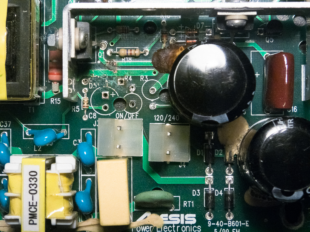

      Hi guys,
      Hope someone can lend me a hand here! My mk2s blew a few months back and I've finally gotten round to opening them up. Bare in mind I'm a complete novice when it comes to electronics.
      I can see a trace that's burned off so that's an obvious fix but I'm stumped as to what else may be wrong. I've tested the c8 and c35 caps and they seem fine to me so I started testing other components in the hope that I'd stumble across the fault. This is probably a silly way to go about it but I'm not sure what else to do. Anyway, I took off R3 and R4 to test them and found they measured 38k instead of the 47k that the service manual declares them to be. Excellent! Or so I thought. The colour code (orange, grey orange, gold from what I can see) tells me that it's a 38k resistor.
      So then I thought I'd pull out another resistor to see if I could make sense of that measurement. I pulled out R27 and tested that. Service manual says it should be 100ohm but the colour rings (red, black, gold, gold) tell me it's a 2ohm resistor with a tolerance of 5% and it's reading at 2.4ohm which is outside of its tolerance.
      I'm so confused. Should I just ignore the service manual altogether? Is R27 bad? Help... please?

        1) Photos
        2) Tested C8 / C35 how, exactly? And "they seem fine" to you, based on what?
        3) What colour code / resistance can you measure on R28? They should be the same (at least in theory).

          Thank you for replying so quickly Khron, I appreciate it.
          1) I've attached some photos, hope it works, not used this forum before. There was a load of gunk there that I cleaned out (didn't realise how much I'd scratched the board until I took the photo... *facepalm*).
          2) Sorry, was way too vague there wasn't I. I tested them using an ESR meter.
          C8: ESR=0.31ohm, Vloss=2.0% and 342.3uF
          C35: ESR=6.8hom, Vloss1.2% and 1081nF
          Forgot to say that the C8 cap is 330uF 35v but again the service manual says it should be a 220uF 35v although from what I've read it's ok to have a higher capacitance... ?
          3) Colour code on R28 is the same as R27 (red, black, gold, gold) and also measures 2.4ohm
          Looks like that whole area around D5 has overheated. C8 has some brown stuff caked on to the bottom as you can see in the photo. D5 was covered with the same or similar brown substance what I thought at the time was burned adhesive but doesn't make sense why D5 would be covered in adhesive in the first place. Measured D5 with a multimeter and got 0.62v so I assume it doesn't need replacing even after being covered with that crap?
          Wondering if I should remove the burned adhesive on the board just to the right of R18? I read somewhere that it's conductive once browned but don't know how much truth there is to that. Got some conductive paste to repair the broken trace under R18. Do you think maybe the problem is just that broken trace?
          Also, after taking out D5 I noticed that the holes for D5 and R5 are pretty close and looks like they'd join when I replace D5. I didn't notice this before removing D5 so I'm wondering if it's my rubbish soldering skills but then looking at the diagram in the photo it looks like they should connect perhaps? Sorry, so many questions and a complete electronics noob... but I'm enjoying it, so far

            As a rule of thumb, if an electrolytic says "VENT" on it, i don't trust it as far as i can throw it. Only (some of) the crap brands have that written on them; the good ones don't - coincidence?
            I'd replace that, if only to save myself potential headaches down the road. And i'd recommend you use the method i did - relocate C8 to replace C14 next to the chip (and away from the heatsink), and add C14 back, on the bottom of the circuit board. It's in parallel with C8, so no worries there.
            If the colour code matches the measured resistance, AND they're both the same, i'd call them good. Highly unlikely they'd both deteriorate to the same exact value, wouldn't you say? And their values aren't exactly critical anyway, they're there more for current-limiting purposes.
            Why would D5 be covered in that crap? One reason - zero f**ks given during applying of said goop. But if it measures ok, and the legs aren't too corroded (from the goop), i guess D5 should still be ok.
            Yes, remove as much of that adhesive as you can, burnt or not. Yes, it does indeed turn dark, brittle and conductive, as well as corrosive, which is, as i'm sure you can imagine, quite unhealthy for copper traces and component legs.
            Conductive paste? I wouldn't, sounds messy, and since that's the drain of one of the MOSFETs, that'll be handling "a bit" of power. Just scrape off the soldermask (green transparent varnish) from the trace, and run a wire (or a resistor leg) where the trace should be / used to be.
            Well, what good would "one leg in the air" for either R5 or D5 do, hmm? No physical connection = no electrical connection (since this isn't RF black-magic-voodoo stuff), soooo...
            PS: Investing a couple quid in some decent solder-wick (aka. desoldering braid) is priceless - works great for cleaning holes like those.

                Also, some multimeters have considerable offset at low resistance measurements. It's not uncommon to see up to 0.2-0.5 Ohms on a decent meter and up to 3 Ohms on a very cheap meter. So always keep that in mind (best way to check is to touch the multimeter leads together and see what resistance it shows on its lowest scale - that's usually your offset for low resistances below 10-30 Ohms.)
                I concur.
                That tan glue is absolutely horrible. While it doesn't usually go conductive enough to pass considerable amounts of current, it can pass enough current to turn on a transistor or pull a signal low or high - and that alone can destroy your power supply.
                And like Khron said, it corrodes traces, so that's another good reason to remove it.
