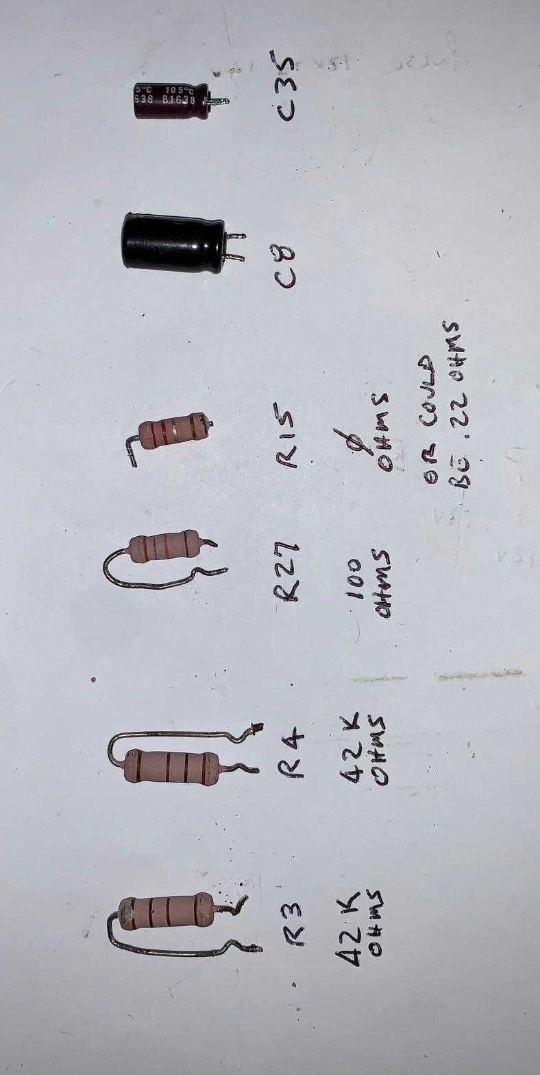

          I have attached a photo of the parts I replaced, with measurement descriptions, now measured while now removed from the PCB. Possibly all the resistors were okay? The new parts ordered and soldered on the PCB were in accordance with Post #29, because I found it difficult to identify a few of the color rings on the resistors.
                  Yes, most likely your R3 & R4 resistors where rated at 38K when new (orange, grey, orange, gold)
                  looking back through the thread I found many others report the same value.
                  I'll refer back to what I wrote previously in this quote:
                  An example here is resistors R3 and R4: These resistors charge capacitor C8 (from the 325VDC measured previously) up to around 16VDC.
                  At that point the UC3844 controller kicks in and starts regulating the voltage through transformer winding T1B via resistor R5 and diode D5 to 15VDC
                  From your voltage measurements quoted below it sounds like the UC3844 controller does get charged up by these resistors to the "kickstart" voltage where it is suppoosed to start working (oscillating).
                  However when it tries to hand over control via transformer winding T1B via resistor R5 and diode D5 it fails and the voltage sags: the process then repeats.
                  So please measure the resistance of that resistor, and do a forward voltage check of the diode with a multimeter that has a diode check function.
                  P.S: Since your new resistors have a higher resistance they let through a lower kickstart voltage, so it's actually harder for the unit to start.
                  But I don't think that is the issue, as you mentioned changing those resistors had no effect, still it's worth to keep in mind...

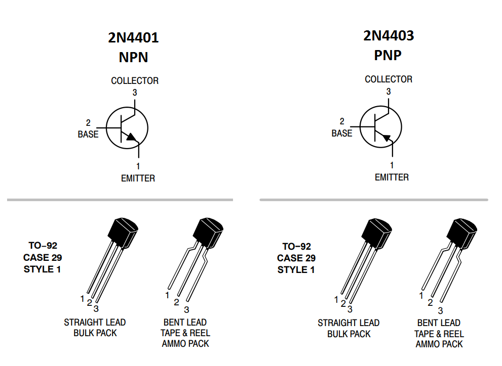

                              Ok, lets try to test Q3, Q4 & Q5 in circuit starting with Q3 an NPN transistor:
                              With everything off and allowed time to discharge connect your meter in ohms mode, positive lead to the base of the transistor and negative to its emitter.
                              You should expect a voltage drop of one diode here, or around 0.7v that we previously tested on your analog meter and you saw around 24 to 28ohms.
                              Reversing the leads it should show as open.
                              You can also test Q6 while we are at it, it is the only other NPN transistor on the board.
                              Testing of Q4, Q5 (and Q7 for good measure) is the same, except you have to reverse your test leads since it is a PNP transistor, report what you find, as tests in-circuit can be tricky and also give false results...

                                Wow! I am learning a lot from you! I followed your instructions exactly, and here are the results:
                                1. Q3 NPN diagram. (base with Pos lead and Emitter with Neg lead). Measurement = 30 ohms. Reversed (base with Neg lead and Emitter with Pos lead) = 30 ohms again. I did this and each one below in the same order as you described.
                                2. Q6 NPN diagram. Forward = 150 ohms. Reversed = 30 ohms.
                                3. Q4 PNP diagram. (base with Neg lead and Emitter with Pos lead). Measurement = 30 ohms. Reversed (base with Neg lead and Emitter with Pos lead) = 30 ohms again. This is exactly the same result as Q3 (of course it was NPN).
                                4. Q5 PNP diagram. Forward = closed circuit. Reverse = closed circuit.
                                5. Q7 PNP diagram. Forward = 300 ohms. Reverse = open circuit.

                                  Q3/Q4 results: Their bases are connected together, so equal results are expected.
                                  Q6 results: This transistor has a 100ohm resistor (RT2) between base and emitter so this result could be normal.
                                  Q5: This transistor does seem to be shorted because there are two diodes (D6 & D7) between base and emitter, they should not be forward biased though, however the transformer winding T2A also in circuit does not care and will conduct so it makes sense... It needs to be tested out of circuit. Since it has long leads I would recommend to just cut them close to the board, that will make it easier to remove the remaining legs with the soldering iron + tweezers.
                                  Q7: This is the only reading that looks normal
