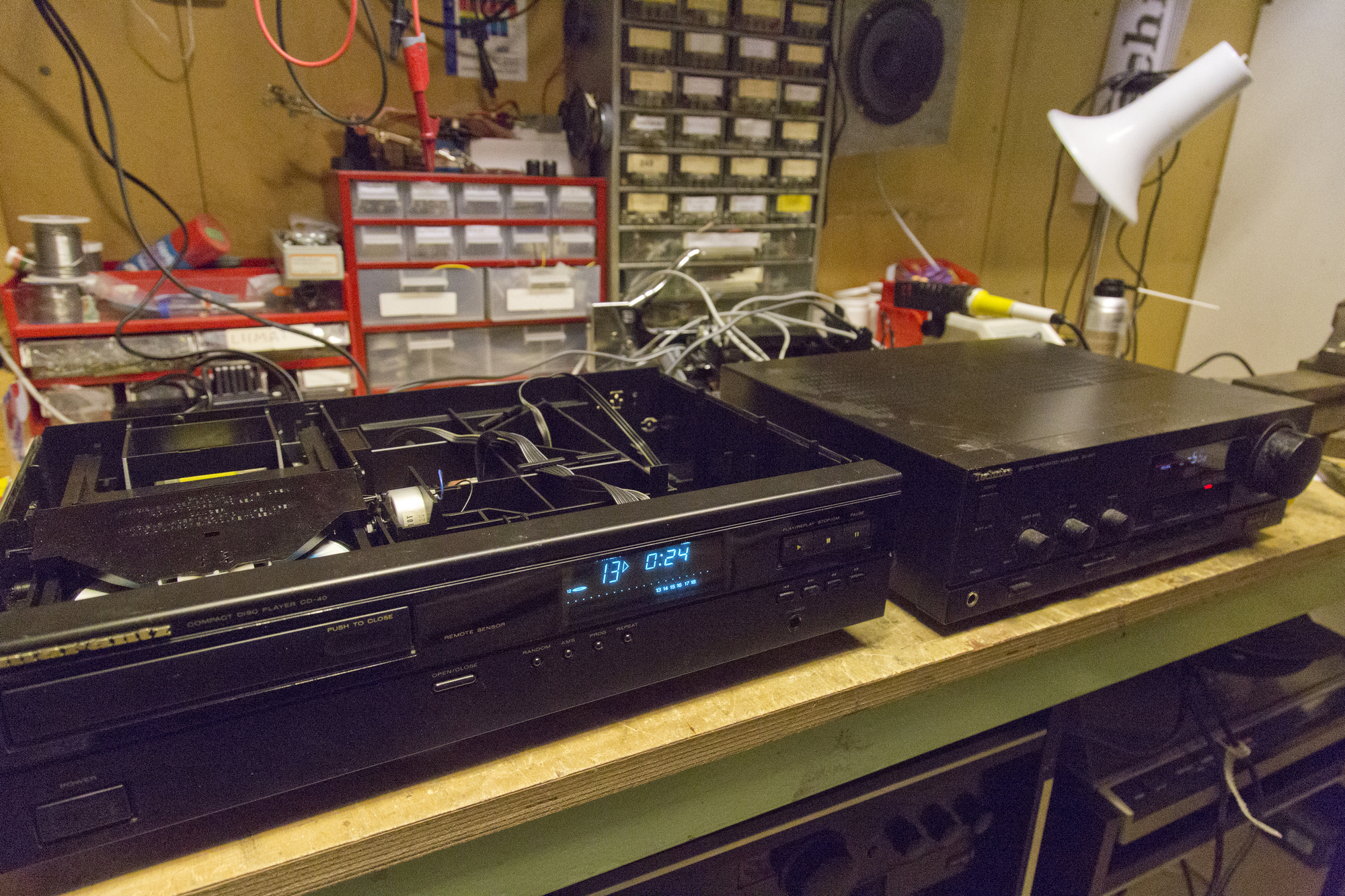

    Philips CDM4-mechanism
    Two totally different cd-players, but the mechanism was almost plug and play, only needed to change the connector for the spin motor. Technics SL-PJ28A -> Marantz CD-40.
    Note: SL-PJ28A is more different with identical looking SL-PJ28 than the Marantz...

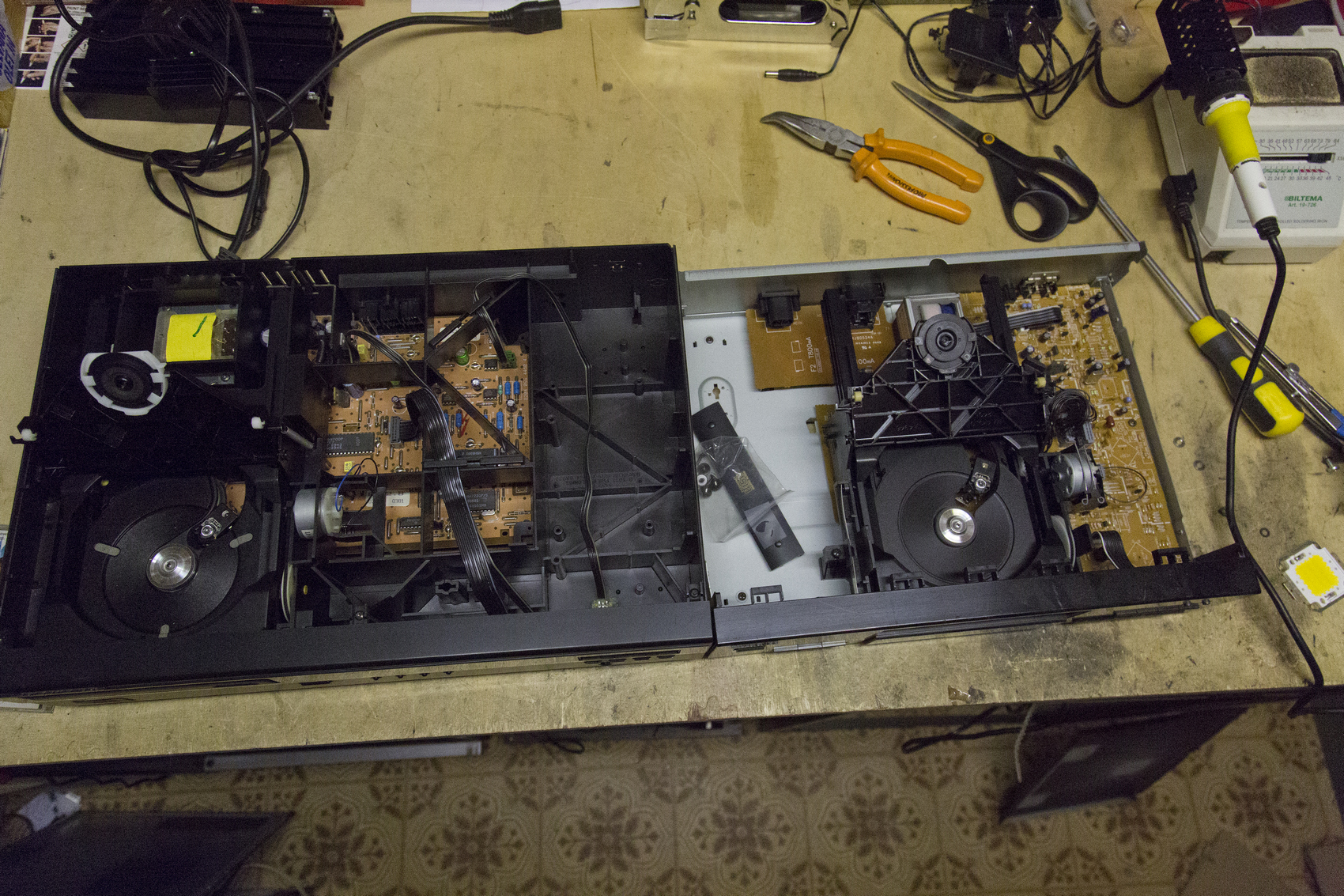

    Re: Philips CDM4-mechanism
    Is there any adjustment, sometimes it skips a bit when "cold" while playing CD-R's. No skips when it has been on for a couple of minutes.

        Where's that cap? I got the player as it would not play to the end, and made some clonking sounds. I can still hear those occasionally.
            Changed the cap to 22u (which the old one was), but first it went only worse. The original cap had 6% Vloss. Then I changed to 47u which was in the service manual, it seem to work better.
              It was the clamp. I managed to move the fault to another identical Technics, only by moving the clamp. It had a dip in the middle of the small plastic thing which should be smooth.
