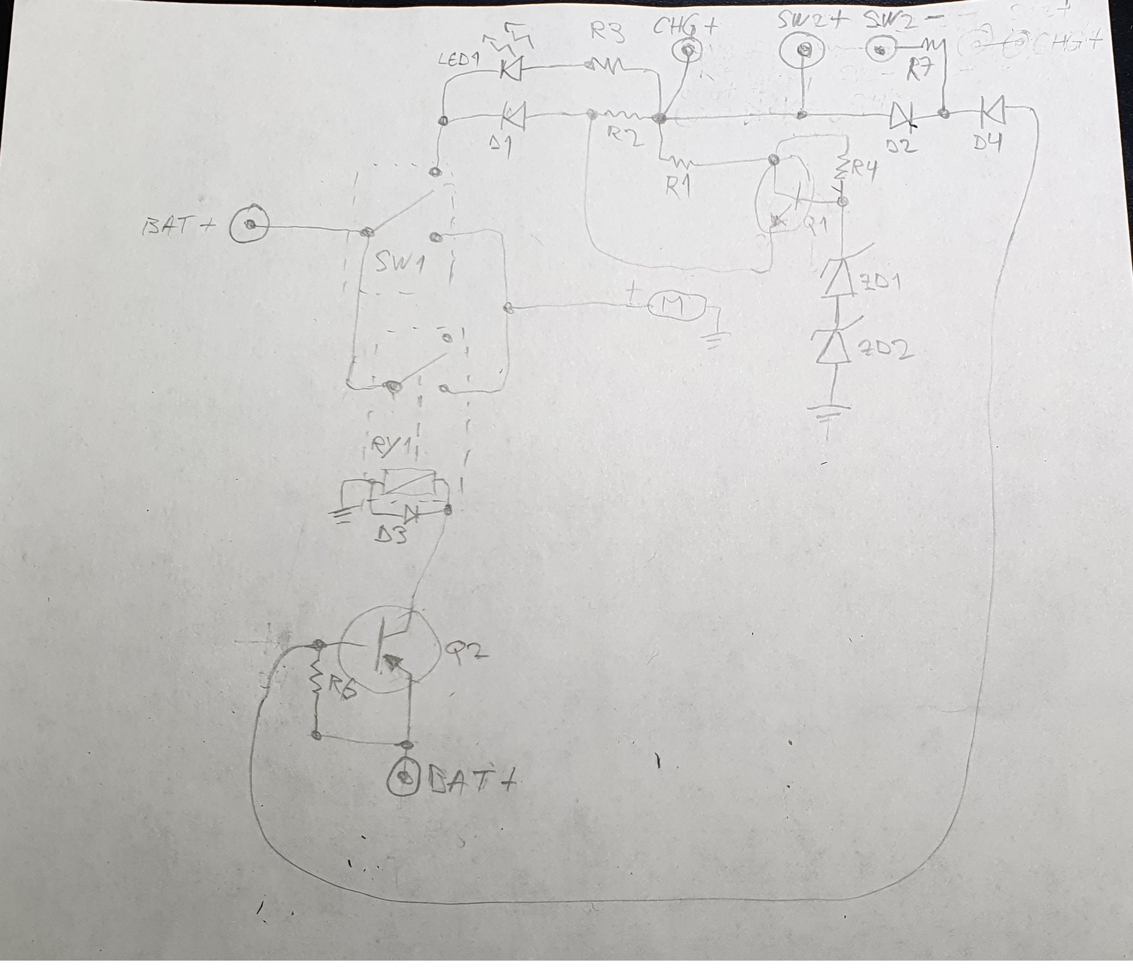

    Good day folks. A friend of mine asked me to take a look at this handheld/upright vacuum cleaner which supposedly has power adapter issues and would no longer charge. Upon first inspection, its original 14v/400mA adapter was dead - the thermal fuse in the transformer's primary windings was open. I went out of my way to replace it and indeed brought the adapter back to life. I gave it back, it worked fine for a few days, then the chap calls me again and tells me the vac no longer charges again......
    Ok, so this time I asked him to bring in the motor part as well since I thought something must be drawing excess current or is shorted and that causes the adapter to overheat and blow the thermal fuse, which was open again, by the way. I opened up the vac today and here's what it's inside....pretty basic, not that I expected more, but nothing looks out of the ordinary either. The battery pack was replaced at one point after it would no longer hold a charge, as it happens with NiMhs, and indeed it works now, but it doesn't charge back for some reason.
    I doodled a schematic myself just out of curiosity and to better understand how it works and how it's supposed to charge: when you close the power switch on the handle, current from the battery goes straight to the motor - easy enough. When the charger is plugged in, current starts flowing through R2 and D1 to the battery. When discharged, the battery's resistance to GND will be low, so LED1 also comes on...I THINK. Not sure what happens with Q1 and those zenners on the right there...looks like some sort of regulator, but I can't understand how it works....
    Another thing I don't get is SW2+ and SW2- points: there's a set of 4 metal contacts on the bottom of the motor part - these mate up with a set of contacts on the floor adapter/dock. Two send power to the roller brushes and two connect the second power switch on the top of the handle, though this last part I'm only speculating, since I don't have the dock part too, so I don't know if there's additional components in it too, though I doubt it. I imagine when the base of Q2 is pulled low, Q2 conducts (since it's PNP A1270) and closes the relay. To do this, I was expecting the switch on the top handle to simply close a path to GND across those two metal plates, but SW2+ goes to the adapter input...what gives ? :|
    What I'll try is to drain the battery and charge it up with my bench supply in place of the power adapter to see what the current draw is. Could've just been a bad adapter, BUT here's the catch: the owner also tried it with a 12v SMPS adapter while I was fixing the original one, which although didn't match the voltage precisely, was good enough for a test and I think what happened was the vac didn't charge and also shut down that one too at some point, pointing to overcurrent. It only worked after I patched up the original one for a little while, until it died again....
    Any help with this issue is appreciated, as always. Cheers guys. Thanks

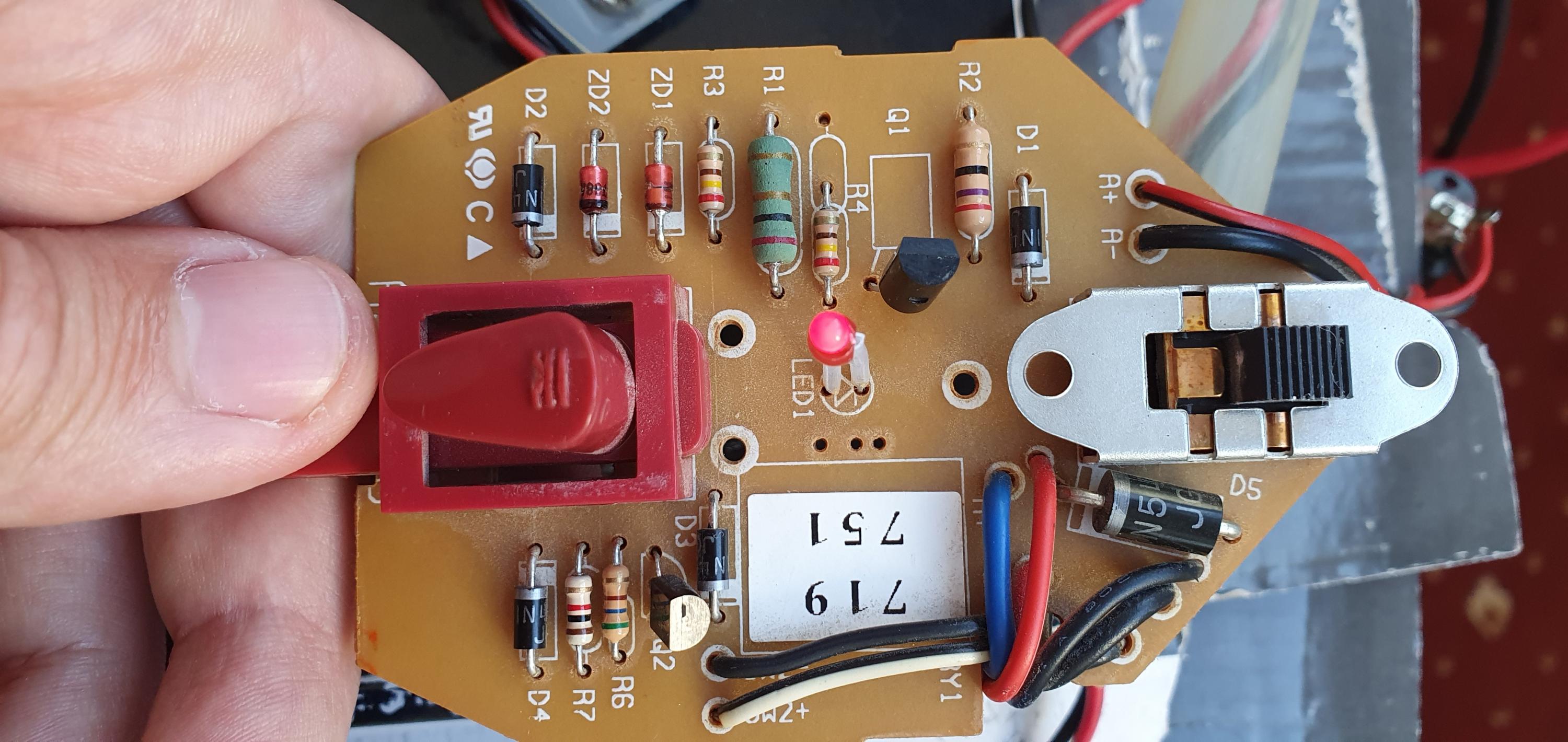

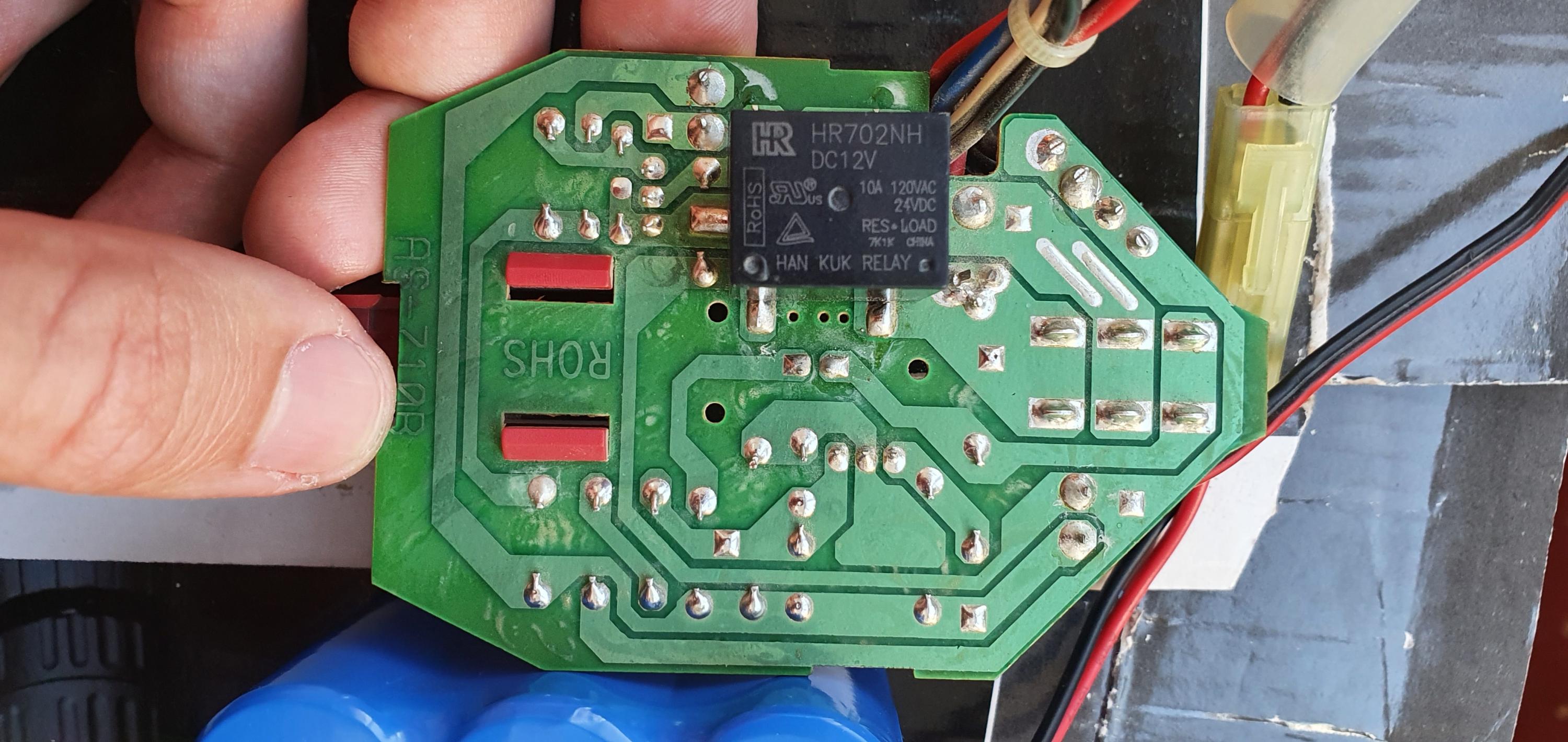

        I took the board and battery with me home today so I can provide some shots of the board at least - I took some at work too, along with the schematic, where I wrote the post, but they got lost along the way like I said. The reason I took it home is because I wanted to discharge the battery some and then charge it up on my bench supply....don't have one of those at work - I know...professionalism at its finest >_> The schematic shall be posted tomorrow. The vac is a Zepter LMG-310 BTW.
        Power supply was set at 14v and no current limit: red LED comes on and the whole thing draws around 300-350mA. After around 10 minutes, it dropped down to 160mA. Voltage on the battery terminals was 12.4v (still charging). Q1 and R1 get warm to the touch. 12v on the input is not enough, which explains why the brick he tried using didn't work - 0 current on the supply at 12v. 15v goes a bit too high for my taste, at 500mA. LED turned off after around 30 minutes, with a current draw of 140mA and 12.1v on the pack.

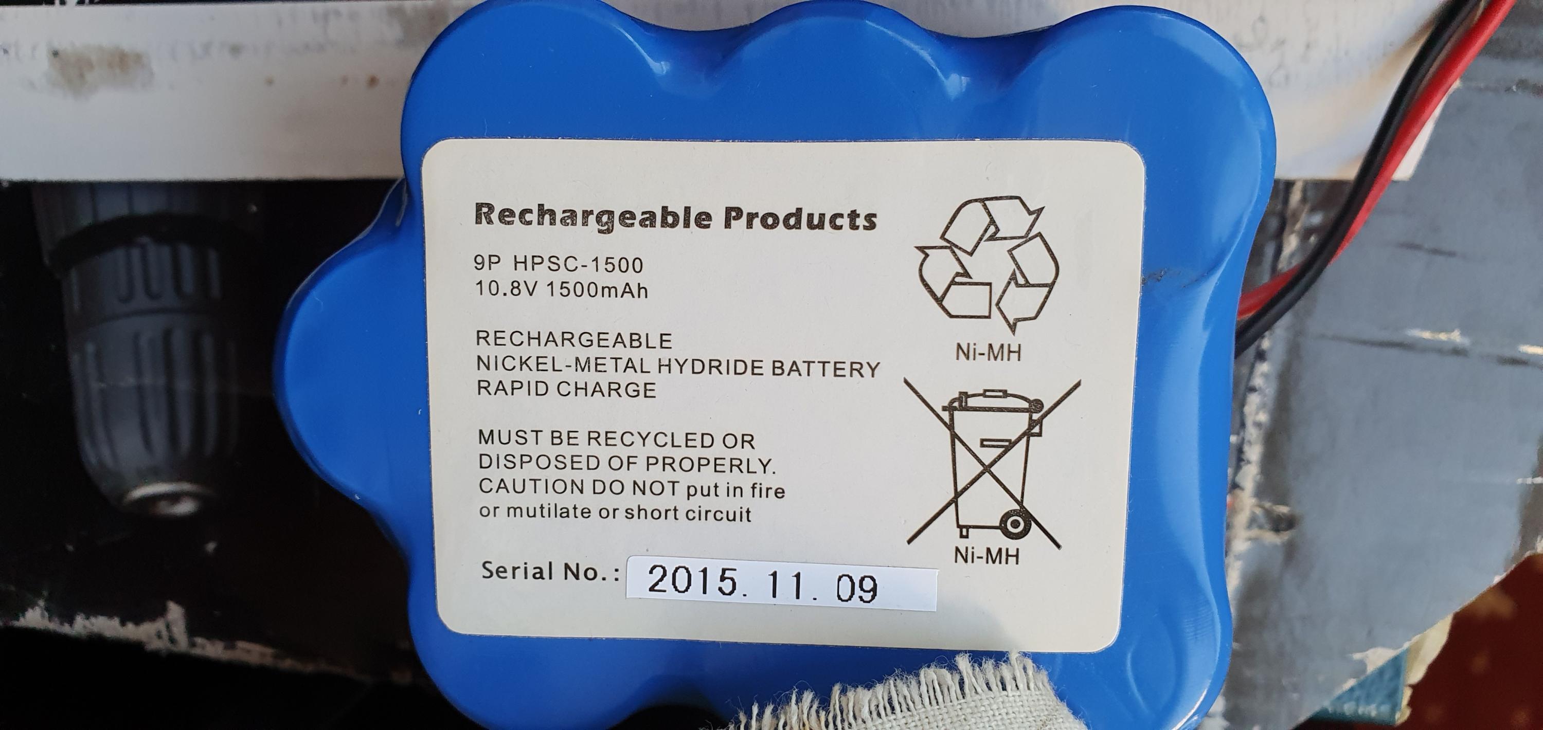

          Some people run the batteries totally dead - to the point some cells in the pack get reverse voltage across them. There might be weak cells in the pack. Those cells can act like a short and so the initial charging current is very high.
          I don't see a fix here, even adding a limiting resistor just makes a ton of heat.

            The date code on the pack would suggest it's from 2015. I'm not sure how you'd check for dead cells - would the faulty one have less voltage on it ?

              cut the shrink off the pack and look for leaks and differing cell voltages.
              maybe even test each cell seperatly

                  Re: Handheld vacuum cleaner kills power adapters (With schematic)
                  Here's the schematic at last.
                  I connected the motor today and it does run.....for a while. The pack voltage quickly drops to around 4-5v but it still spins rather nicely. It seems to charge fine even with a 15v brick I had laying around the shop, since I don't have a bench supply like I said, but I'm not sure if this run time is considered acceptable or satisfactory to the end user, hence why I was thinking of upgrading it to LiIon which they were happy to hear about, apparently. 15v makes Q1 and R1 even hotter, of course, since they appear to do some sort of regulation.

                                Fairly easy to check for shorted cells in a pack:
                                1. Charge battery as much as possible with a constant current charger.
                                2. disconnect and rest 5 minutes and measure voltage
                                3. If voltage is significantly less than # cells * ~ 1.4 volts, you probably have a shorted cell...
                                For your 9 cell pack, if it measures less than about 12+ volts freshly charged, you probably have a shorted cell somewhere.
                                  Since the cells are connected in series, you can check the Voltage drops of each cell while charging, that will give a clue as to which one is bad.
                                    I think it tops out at around 12.1v or thereabouts, so maybe it's good after all and that's just the normal run time.
