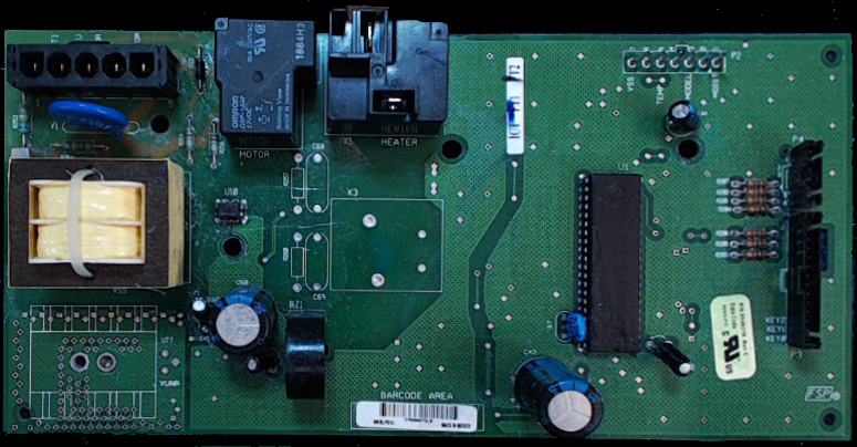

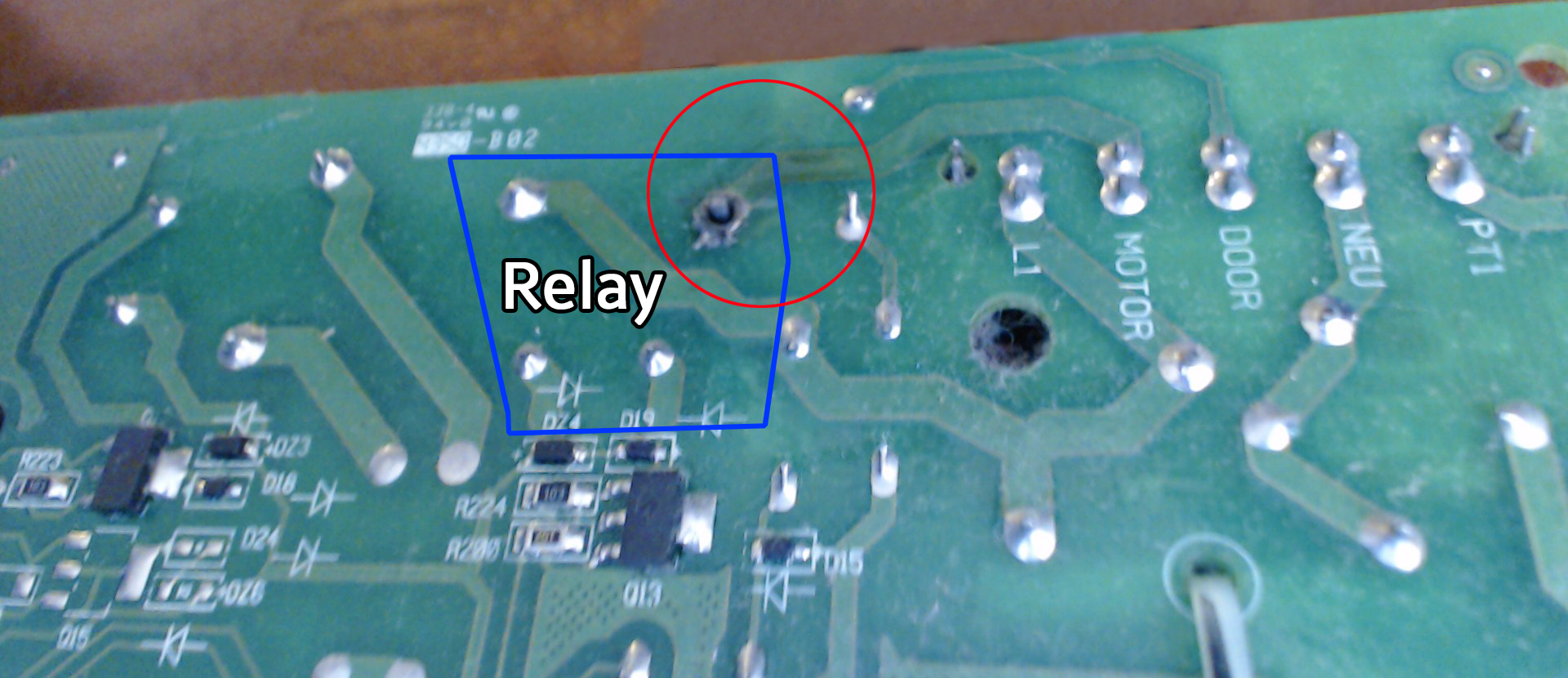

    I've been troubleshooting a Kenmore clothes dryer and discovered on the PCB one lead from the relay that supplies 120VAC to the motor that spins the tub had completely blown itself clean away from the PCB. It did it with so much energy that it left ocean wave shaped bends in what was left in the solder that connected it to the PCB.
    I suspect that the motor was shorting out for some reason, but I don't know how to test my theory. I don't want to plug the motor directly into 120 obviously, so is there any other way I can test it to see if in fact it is shorting? I know that reading the resistance in the motor could possibly show me almost no resistance even if the motor is good so is there some other way to verify my theory?

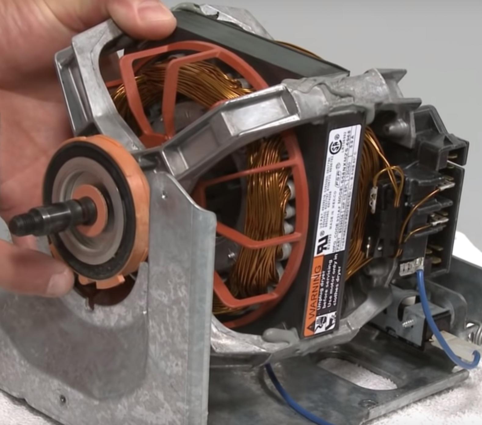

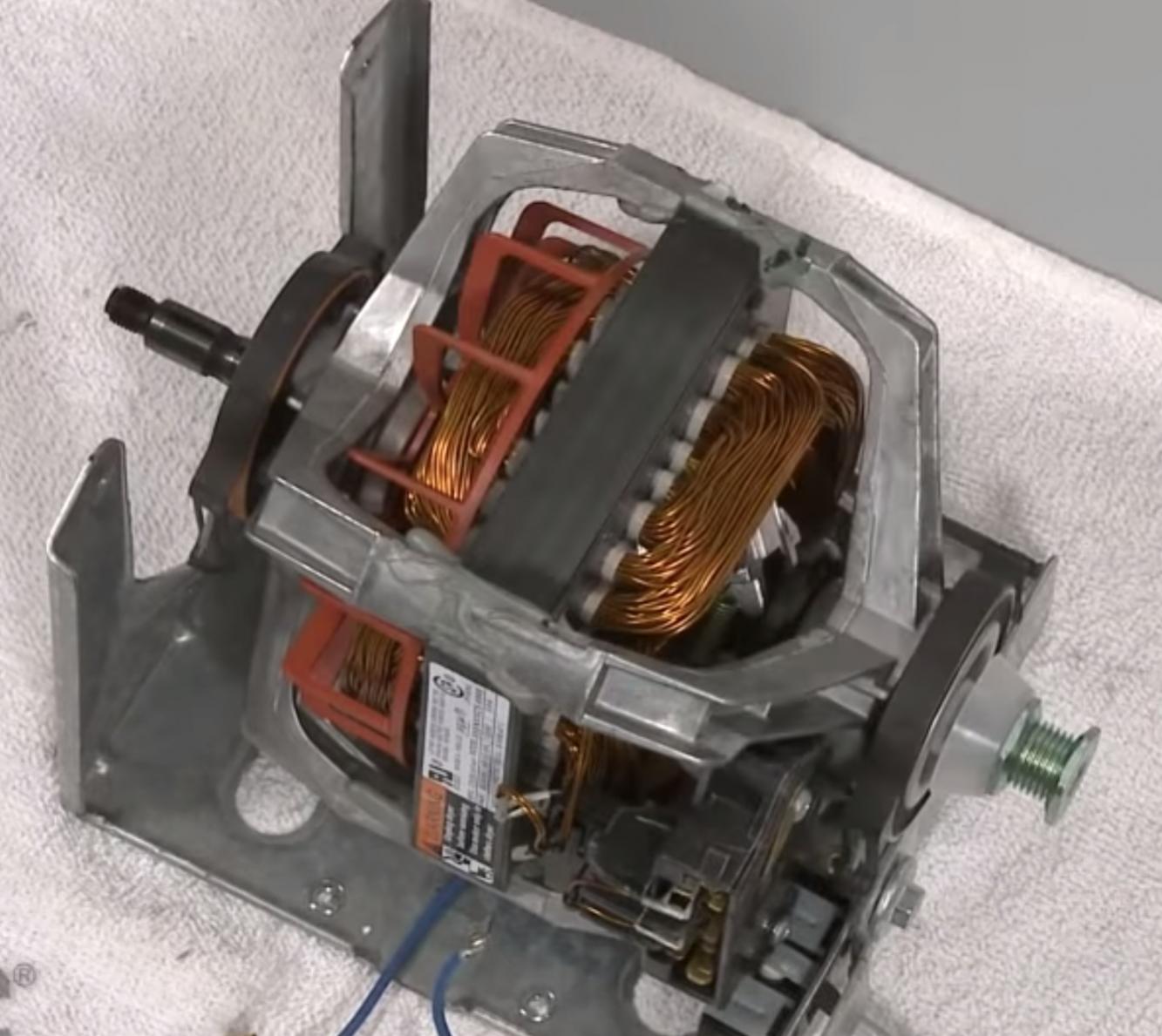

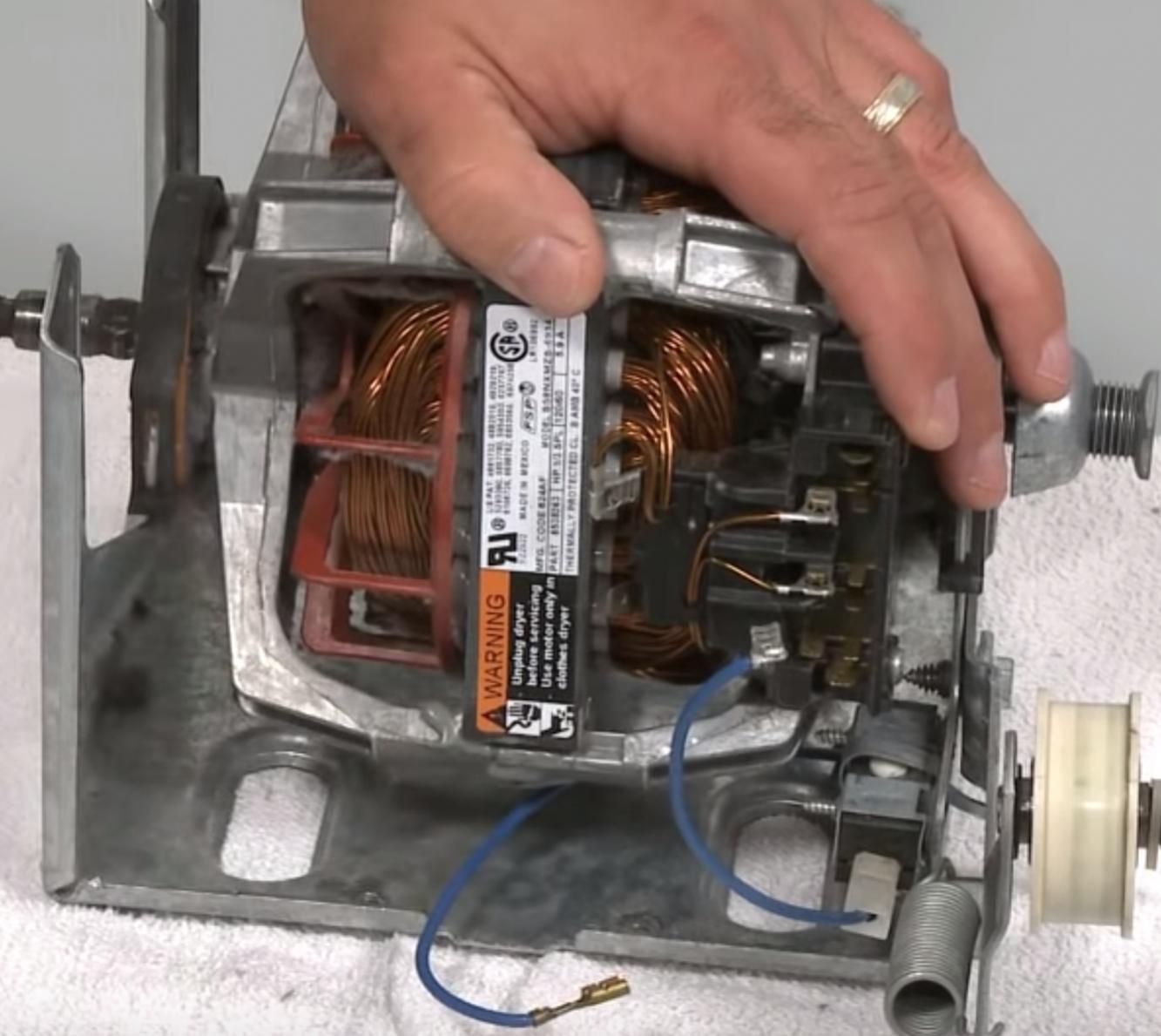

    Please post a picture of the motor that you are taking about

      Re: Dryer Motor Possibly Short Circuiting

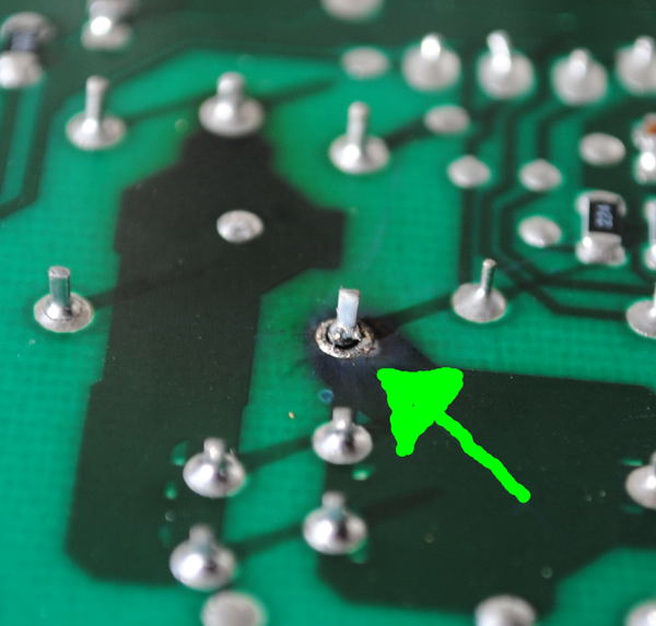

      It likely developed a poor connection, arced and the wire burnt off. Post a couple pictures
          One note
          Check and make sure that your motor is NOT shorted to the case of the motor if it is then it is trashed
          It's quite an open design ... not much of a chassis to short out to ... and I didnt see any immediately visible signs of electrical damage on the motor when I was spinning the shaft and examining it under a flashlight while its still installed in the dryer...

          THANK YOU SO MUCH ... so far you have been the only one who has actually given me something other than shrugged shoulders .... as I was reading what you were saying about the fast acting fuse ... a thought came to me ... what about taking a standard light dimmer and turning it to max resistance then putting it in series with the motor then plug 120 in and SLOWLY turn the dimmer (potentiometer) while watching current draw on a meter to see if the motor is drawing too much current and not moving etc. Would that work in determining if it's no good?
              I think this pic says it all ...

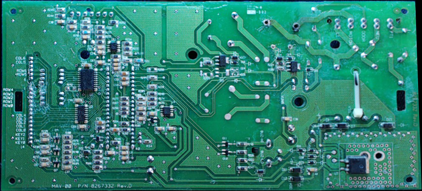

                • 31187
                remove the cover where the terminals are - there may be a bunch of surpression caps in there - it definatly looks like it's housing something.
                  That looks like arcing damage to me. Personally i would stuff that motor across the mains without hesitation.
                    Clean and Resolder the the relay connection, reassemble and start drying clothes

                      Yes this does have a low / high speed centrifugal switch you need to make sure that it is working correctly and that you are not stuck in the high speed ( or stuck in the low speed winding ) winding because you are suppose to start with the low speed winding first then when it speed up to a certain rpm then it switches to the high speed winding ( this happens all in a matter of second or less at full voltage )
                      The centrifugal switch arm is the device that has two springs next to where the terminal block is where you make the connections for powering the motor
                      PLEASE make sure that if you remove any of those terminals off that terminal block that you exactly where they came off from and they go back on in the same position other wise you can burn this motor up take pictures before you start
                      You can try the centrifugal switch by hand you should be able to move it fully open position
                      and should move freely with out getting stuck in any position
                            Just resolder all the high-current connections on the board.
                            Vibration is high on a clothes dryer and stresses connections.
                            The Kenmore/Maytag/Whirlpool dishwasher fires had the same problem - PCB fractured soldering joint at the power relay. It arcs, made heat and cooked the relay and board until your house burned down.
                            I wouldn't blame the motor. It is an inductive load and will trash any poor connection, and the windings would look burnt if it was shorting out.
                                In this case, however, the relay still works fine. I took it out of the board and tested it. If there was any kind of arcing happening wouldn't I see damage on the board in two places?
                                  Just to be clear, you have the same bad connection at a relay terminal on the PC board as the pics below? Bosch dishwasher that has bad connection just like your dryer pic.
                                  It's a common problem in appliances. Vibration or poor soldering fractures the joint, it arcs (tiny, inside the hole) and spews out solder vapor and gets worse.
                                  To fix it, if the relay is not damaged from the heating, just clean the joint and resolder it.

                                  • EasyGoing1
                                    Shock Therapist
                                    • Sep 2016
                                    • 977
                                    I took these just for you ... if you want closeups of any areas let me know.
                                    They coat this board with some kind of lacquer and when I cleaned up all the lint material with rubbing alcohol it reacted a little with the coating causing somewhat of a mess but it looks better than it did with all the lint and dust on it.
                                      The Whirlpool, Kenmore, or Kitchenaid dishwasher class action suit, you get $100, or 30% buying a new one. It was the same bad connection arcing.
                                      Wow, that looks EXACTLY like what happened here ... I suppose the worse that could happen is that I get it cleaned up and re-soldered and if the issue is with the motor then it will just do it again ... if not, then the problem is solved.
                                      I will take the motor out and do a much closer visual inspection of it and all the windings that I can see just to make sure there is no obvious issues with it.
                                      When I got sucked into this problem, I was at my friends house and she started to hang up her clothes to dry so i asked her if her dryer was broken and she said yes ... so I asked some questions then got sucked into it ... but its been a great learning experience since I've never taken apart a dryer before. I guess I was most surprised with how simple they really are conceptually ... I had never really thought about it before.
                                        Do you think it would be a good idea to go over this board and re-enforce all solder joints that handle AC?
