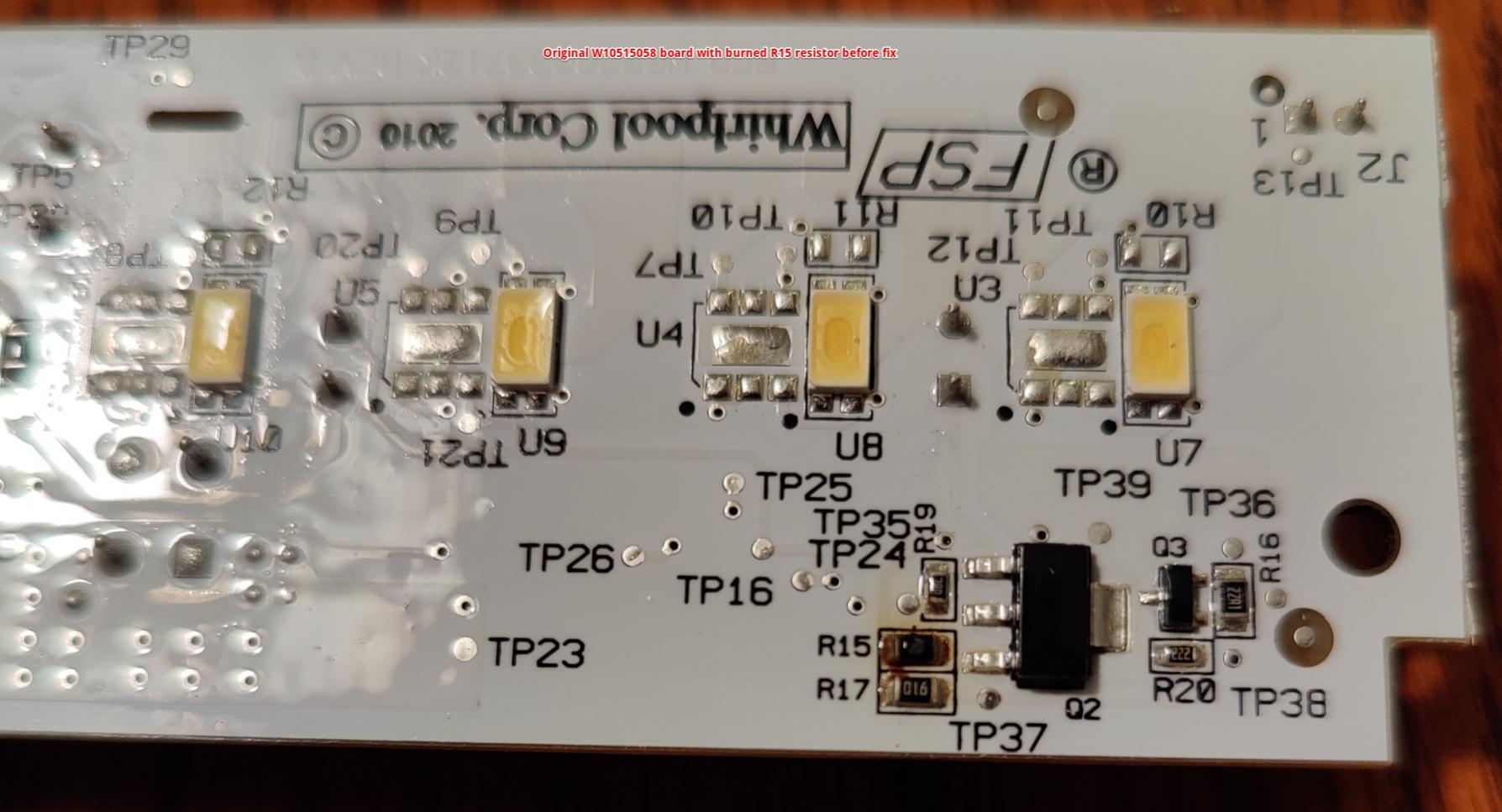

    Confirmed and solved.
    My board had burnt-looking R15 with board lacquer damaged on top of it.
    Board needs 320+ degrees Celsius of iron temperature to melt the lacquer.
    Soldered 150 Ohm 1/2 W huge resistor in place of that bugger: there's a lot of space available around.
    Looking at all discussion, it looks like a design mistake: the wattage of resistor was not calculated right.

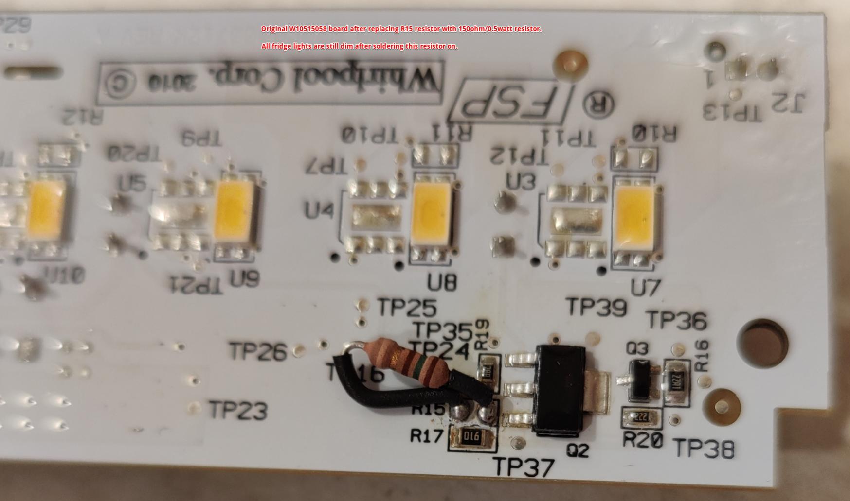

    I repaired mine this way also. My original R15 chip resistor was scorched but not blown. One end had broken free. The old resistor checked 135 ohms.
    The light fade-on effect is absent, possibly because I used a 150 ohm resistor instead of 135.

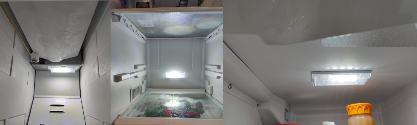

        I had the same issue with the dim lights in the fridge and freezer. I was going to do the "log-on-Bob" fix but was able to find the WS10515058 board (the one in the fridge) for about $25 (new). My board had a burned R15 resistor and since I did not have any to use there, I just bought a new board. When I put the new board in, the lights were still dim. From what I had learned by reading this thread and looking at the schematic, I was able to find that the board in the freezer actually had a bad LED (this is what probably caused the board in the fridge to pop).
        So I ordered a new board for the freezer also (WS10515057) for about $12. Installed it and the lights work perfectly now.

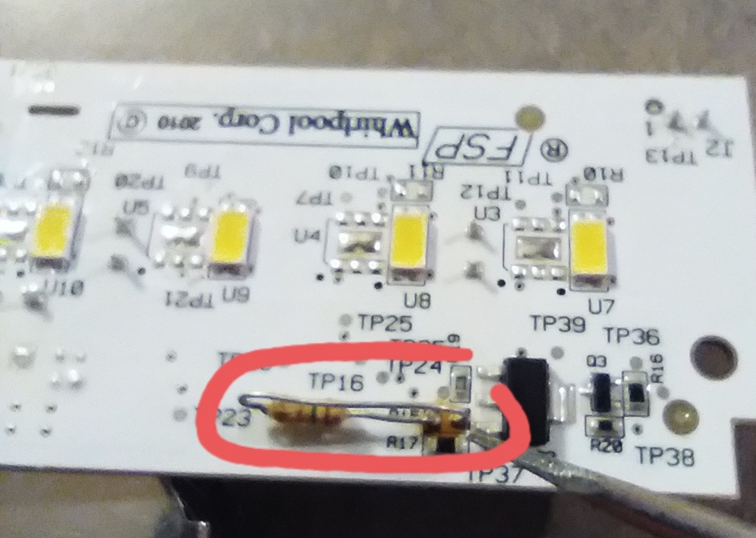

          When my Whirlpool WRS322FDAB05 lights stopped working I found this thread and after pulling out the main fridge board at the top (W10515058) I noticed my R15 resistor was burned out so I brought it to a random electronics shop and paid them $20 to remove the burned out R15 resistor and solder a new 150 Ohm/0.5watt resistor onto the R15 spot. I brought that home and plugged it into my fridge and the LED's on that board worked but were super dim, can barely even see they are on. I found your post about the freezer LED board (W10515057) being burned out so tested out my freezer board by switching it up with the other W10515057 board in the bottom of the fridge and sure enough that freezer board LED's were completely dead. I ordered a new W10515057 on Amazon for $26 and just put it in my fridge so at least now all 3 LED light boards show very dim lights, so I assume this means the repair I did at the electronics shop of replacing the R15 resistor on the main board (W10515058) with that new 150 Ohm/0.5watt resistor didn't actually fix that board.
          Before I buy a new W10515058 board on Amazon, can any of the pros here let me know if they think there's something wrong with the resistor fix I got the electronics shop to do, and if there's anything I should try first before buying a new W10515058 board?

                I bought this W10515057 board to replace my LED burned out board from the freezer for CA$26.12 which arrived yesterday, I can only confirm that it does work, but no idea yet how long it will last: https://www.amazon.ca/Refrigerator-W...ls%2C84&sr=1-4
                Since I think my soldering that new resistor onto my existing W10515058 main top fridge board didn't fix that board, I'm going to just order this 3 set from Amazon (two W10515057 boards and one W10515058) for CA$34.87 and will respond back in here on whether it works when it arrives in a week or so: https://www.amazon.com/W10515058-W10...ot_top?ie=UTF8

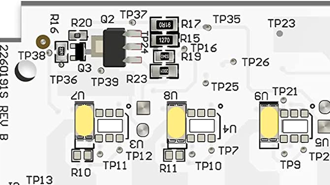

                  To be exact, then R15 - 1270 = 127Ω 1%.
