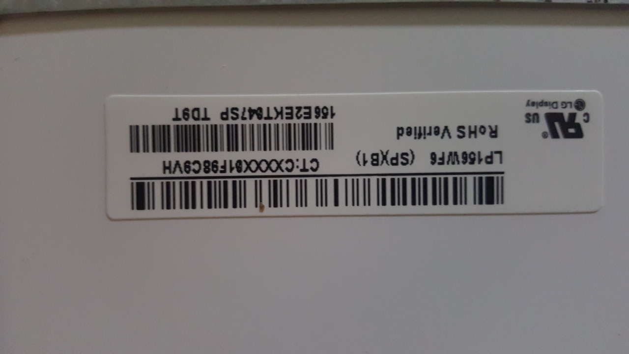

    So I'm dealing with screen flickering problem on my laptop.
    I'm not quite sure if it's the display cable or the screen itself that's causing the issue,
    so I'm turning to you all wonderful expert on Badcaps for some guidance. Your help is much appreciated!

    Hardware Info
    • Laptop: Acer Aspire VN7-591G
    • Display: LG LP156WF6-SPB1
    • OS: Windows 10 LTSC 2021
    • CPU: Intel Core i7-4720HQ
    • Chipset: Intel HM86 (Lynx Point)
    • Integrated Graphics: Intel Haswell-MB GT2 (Intel HD Graphics 4600)
    • Dedicated Graphics: NVIDIA GeForce GTX 960M
    • Display Settings: Default at 60Hz, as per the model specs

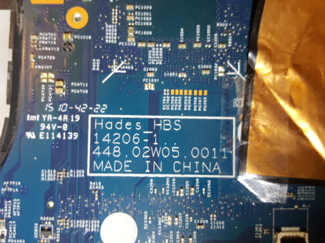

    • Mboard: Hades HBS 14206-1

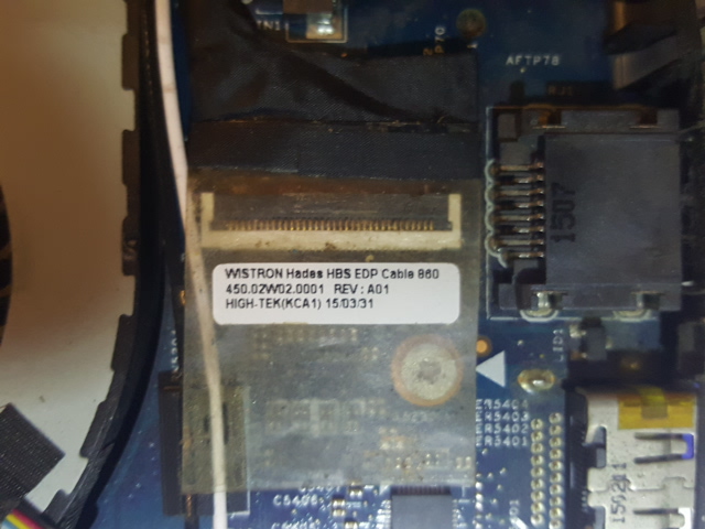

    • Display eDP cable: WISTRON Hades HBS EDP Cable 860 450.02W02.0001 (Not sure if this is correct I just wrote down what on the labels)

    • Cable and Physical Condition: I opened up the case and checked the cable connecting the main board to the screen (Haven't try unplug and reconnect in yet);
      it seems secure on both ends but don't know how to test. No drops or spills near the laptop, so there's no physical damage or cracks from the outside.

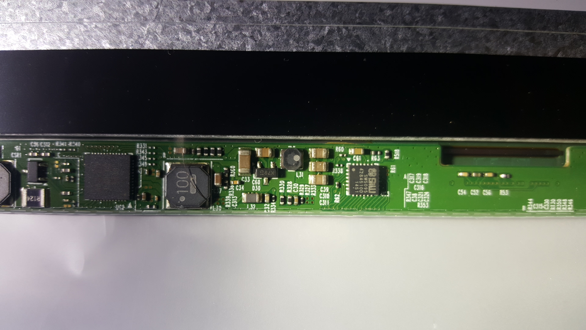

    So I been reading and researching as complete beginner. but I'm currently stuck and would like to seeking further guidance.

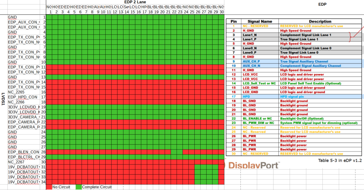

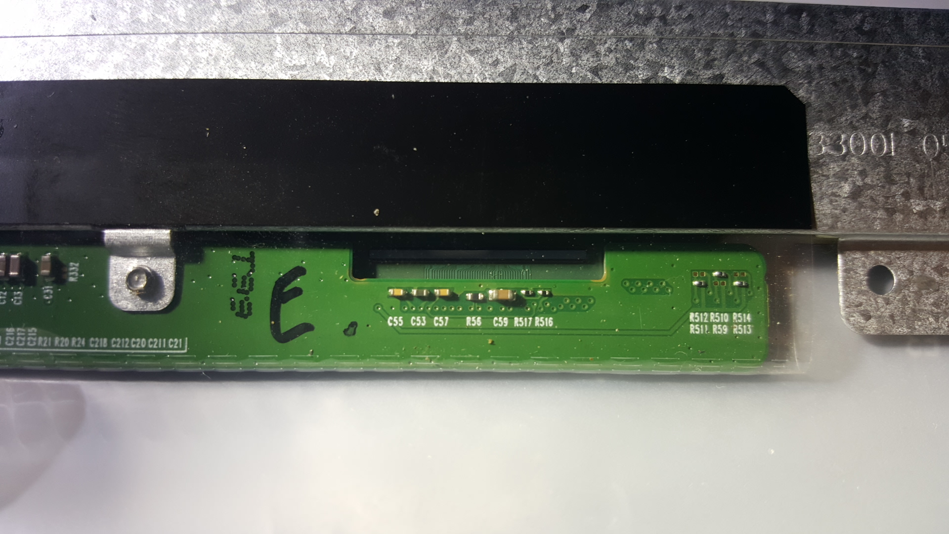

    I've measured the voltage on both ends of the eDP cable. The side connecting to the mainboard shows 19V on all four power pins, but on the other end, 1 of the 4 power pins doesn't seem to have 19V. Could this be indicative of a damaged cable and cause the flickering?, or should I explore other potential issues on the inverter board?
    Additionally, I'm curious if it's possible to obtain the schematic for the LP156WF6-SPB1 Display LCD. I'm struggling to identify what is what and finding out the first un-power pin on inverter board lead to, and I'm wondering if taking a picture of the interface could assist in troubleshooting?

      Connect the edp cable on both sides.All power source removed.Put meter in diode mode.Now put one probe of multimeter on 19V pin of edp connector and check with each pin on screen connector. It should buzz on couple of pins.If it buzzes,then you may be having difficulty in locating the pins on screen side and 19V is indeed reaching the screen.

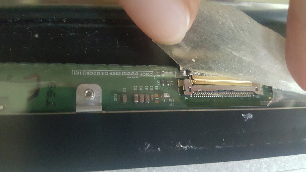

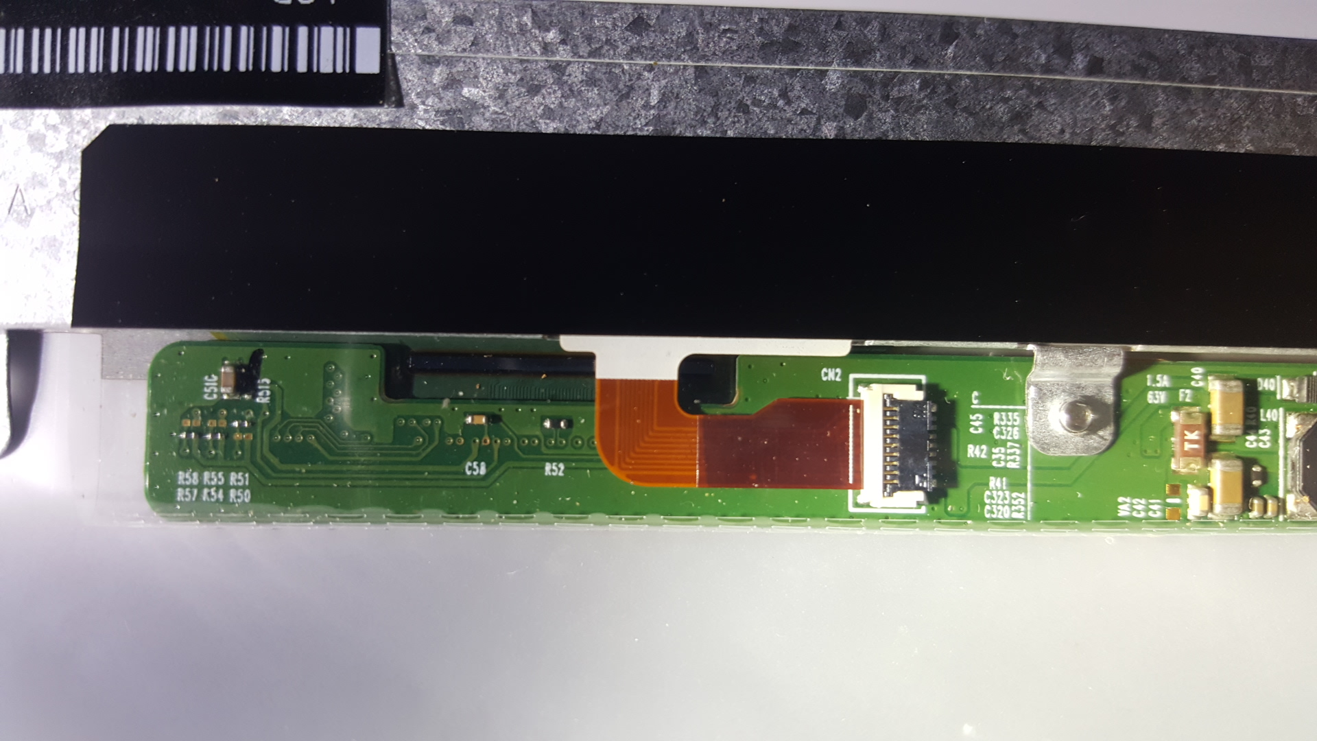

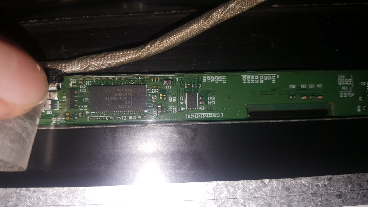

        Thank you very much Mcplslg123 for your suggestion. I followed your advice and disconnecting all power sources then measuring the pin in diode mode
        It appears that I initially misunderstood the labeling of the eDP 30 pin and LVDS 34 pins and assume it laid out the same way. The 19V_DCBATOUT_LCD appears to be correctly linked to the backlight power, with all four pins (25-29), while the last pin seem to (30) not connect by default.
        I'm not certain if this is due to a short circuit in the inverter, causing it to affect other pins or the damage cables.
        However, there seems to be an issue with the 3D3V_LCDVDD_PWR pin and some other. That seem to buzz (shows voltage) on all the pins on the screen side. I'm uncertain if this is caused by a short circuit within the inverter, or due to damaged cables.
        Here's a list of LVDS:Edp pins that I measured that seem to have issue: EDP_BLCTRL_CON, 3D3V_CAMERA_PWR, 3D3V_LCDVDD_PWR, and three of the EDP_AUX_CON pairs. It's possible that I may have missed some labels some, as my eyes started to become blurry after awhile.

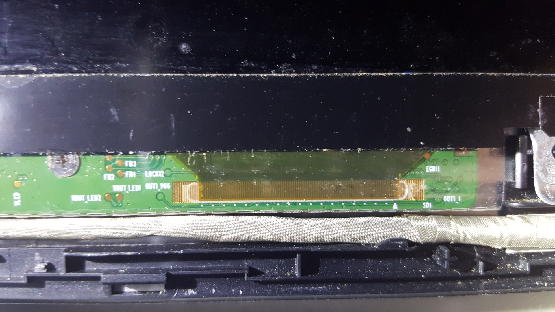

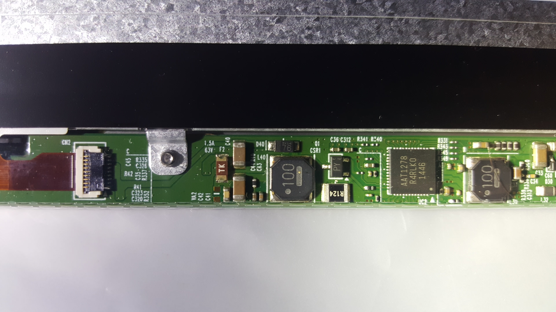

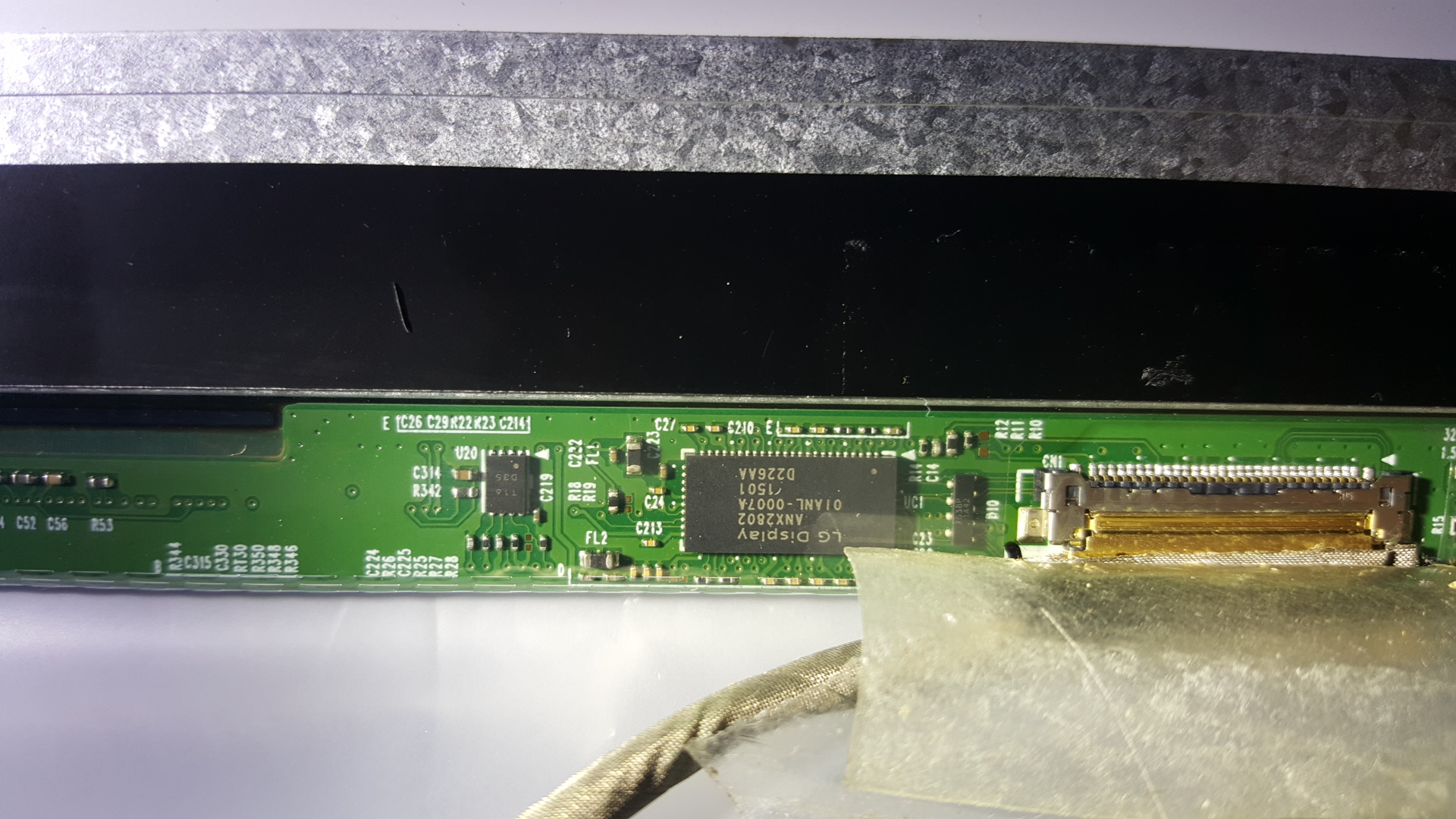

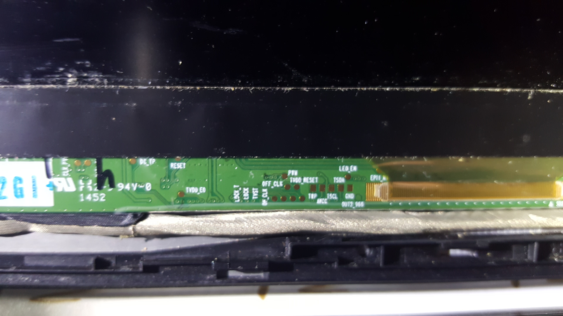

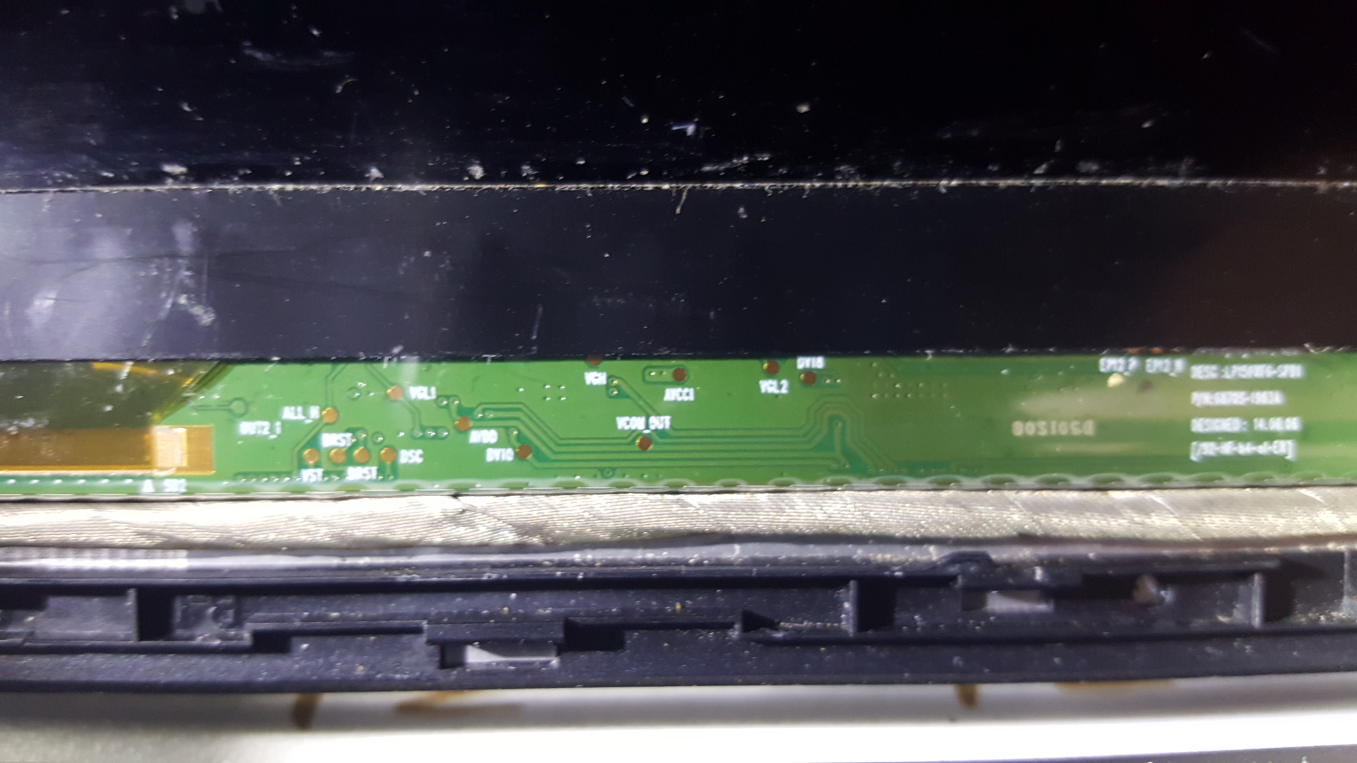

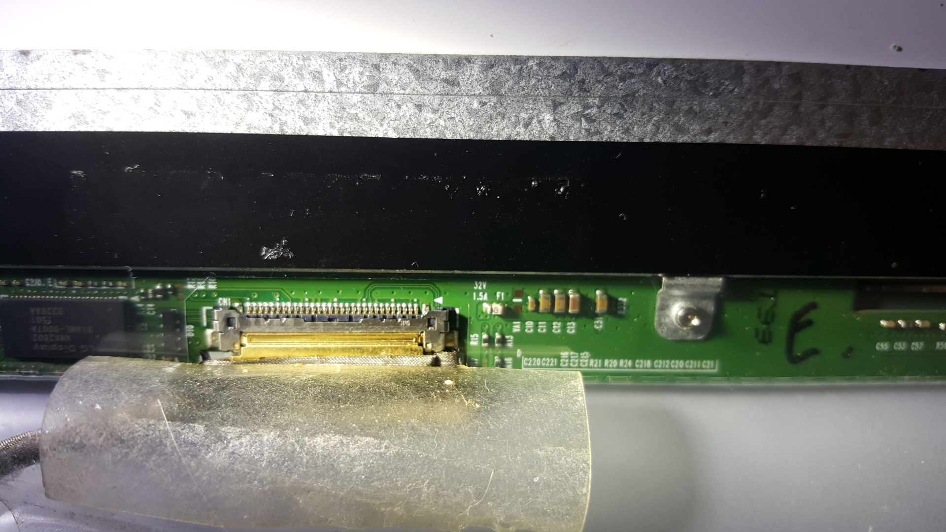

        Additionally, I've attached an Excel spreadsheet and images that highlight the pins with voltage issues and those that normal complete a circuit. I've also included pictures of the inverter board for reference. Apology for any blurry images
        Could you please recommend the next course of action? Would it be possible to pull out the cable and check it without attach to anything just to be sure, or should I focus on the inverter board component next? Thanks you in advance and have a good day.

          Its difficult to say anything going by the images. To me,mb seems ok-its either the edp cable or the screen itself. My bet is the screen is faulty. Try replacing that coil marked "100" on the screen with exact same markings. this works in some asus-not sure about Acer.
          • reformatt
            • Feb 2020
            • 1519
            Re: Acer VN7-591G-70RT Display Flickering
            I'd say damaged LCD if it came across my bench.
