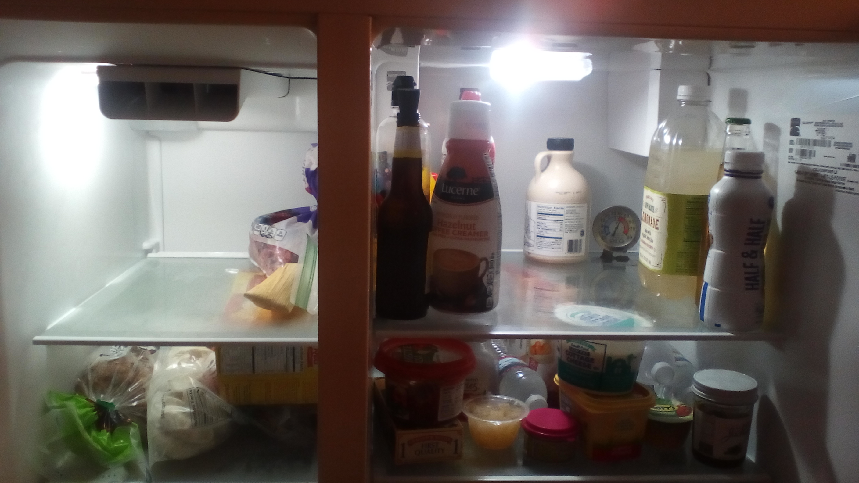

      OK, I am done for now though I might experiment later adding the lower Refer light. I choose to just go with a Top Refer and the Freezer light. I am running a test on the Bench with Two Lights in series off the Top Refer. Have about four hours run time so far, so that should be months of opening and closing the doors.
      I taped the Door Switch closed. Keep in mind both doors are in series so open one turns on all. If you are not comfortable, unplug the Refer or at your own risk.
      1. All four Connectors were snipped off the wires stripped back.
      2. Lower two refer light wires attached together with a simple Wire Nut. This completes the circuit ( once the bulbs are in ) Top light through the Freezer and back to the Top.
      3. On the Bench ( pic 1 ) I found some Insulated Female Quick Disconnects in my junk drawer. Fry's carries them or Ebay. If you only have the un-insulated then electrical tape or heat shrink tube, I wouldn't leave them open.
      As mentioned, I couldn't solder direct the bulbs. Butt connector worked but these will allow you to plug a new bulb down the road easily or, Maybe an actual G9 socket MIGHT fit, I don't know.
      So on the bench, the connectors were not as tight as I would like, so simply squeezing one side ( one side is all that fits ) of the connector with pliers did the trick, you want it very firm.
      4. Freeze side, I just left the Female connector on the bulb while crimping the wires. These connectors happened to be 14-16 gauge, I had to extra squeeze with a large pair of pliers, pull test on the wire and I could feel it not so secure with just the crimper.
      5. NOTE: Unplug or Tape the door switch ---- Top light Refer, now you have to join ( see Bluto's diagram #60 ) the two 120v wires to the other two circuit wires. This makes the Top Light 120v and very bright and the lower & Freezer in Series at half voltage, still bright.
      There you go,, oh another tip, I had to use a flashlight while connecting and crimping..:-)

        Pic 3 Bench Testing - unfortunately you can't in the picture see much difference but there is. Full 120v is hard to look at and if you look at Pic 1 you can see all the individual LED's, at 120v you can't but in Series and Half the Voltage you can see the LED's but It's still pretty bight. About 6 hours now and they have not burned out so lower voltage may be OK. FYI - 120v Bulb gets to uncomfortable to hang onto for very long, the other two are just Warm.
