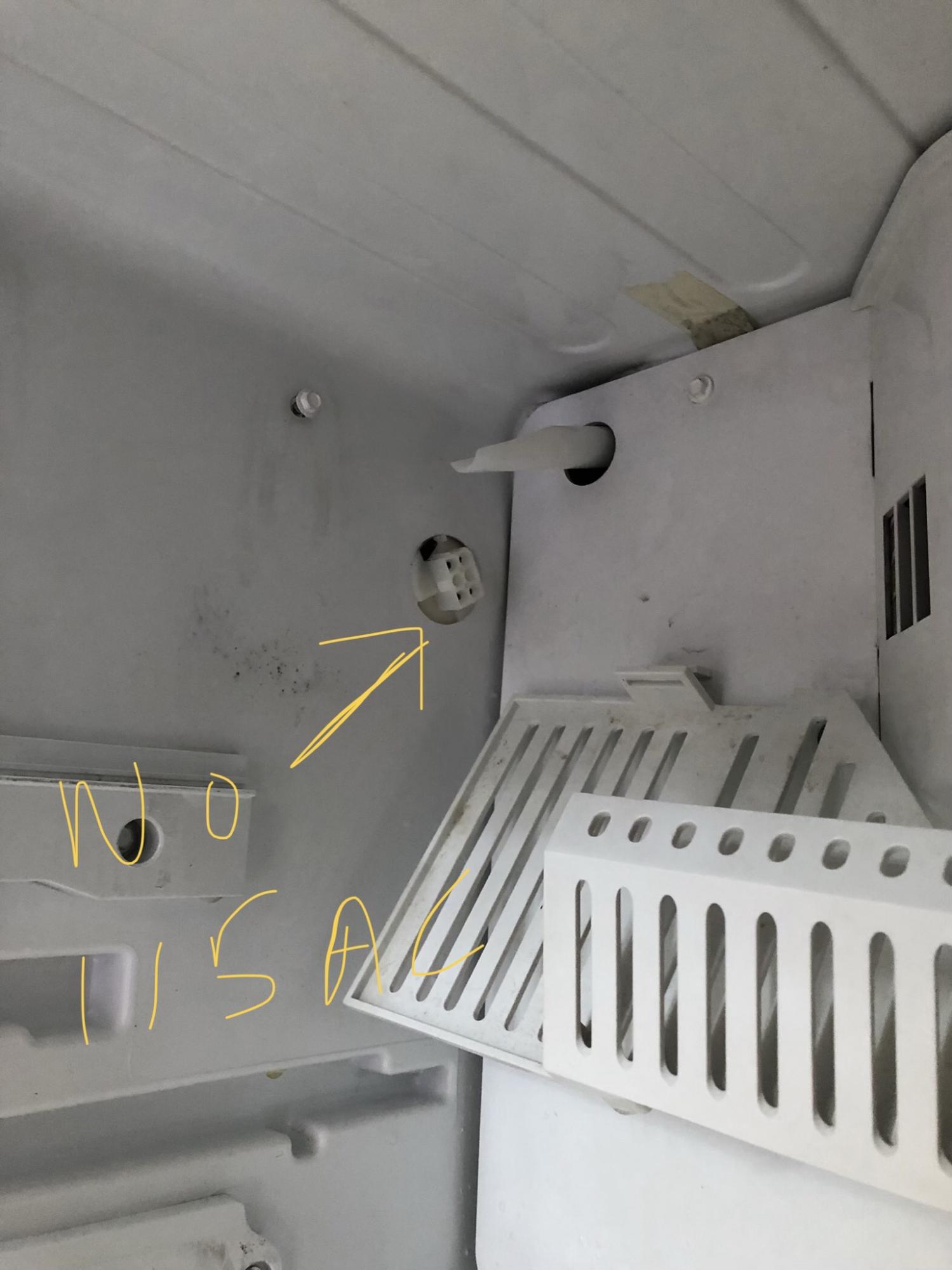

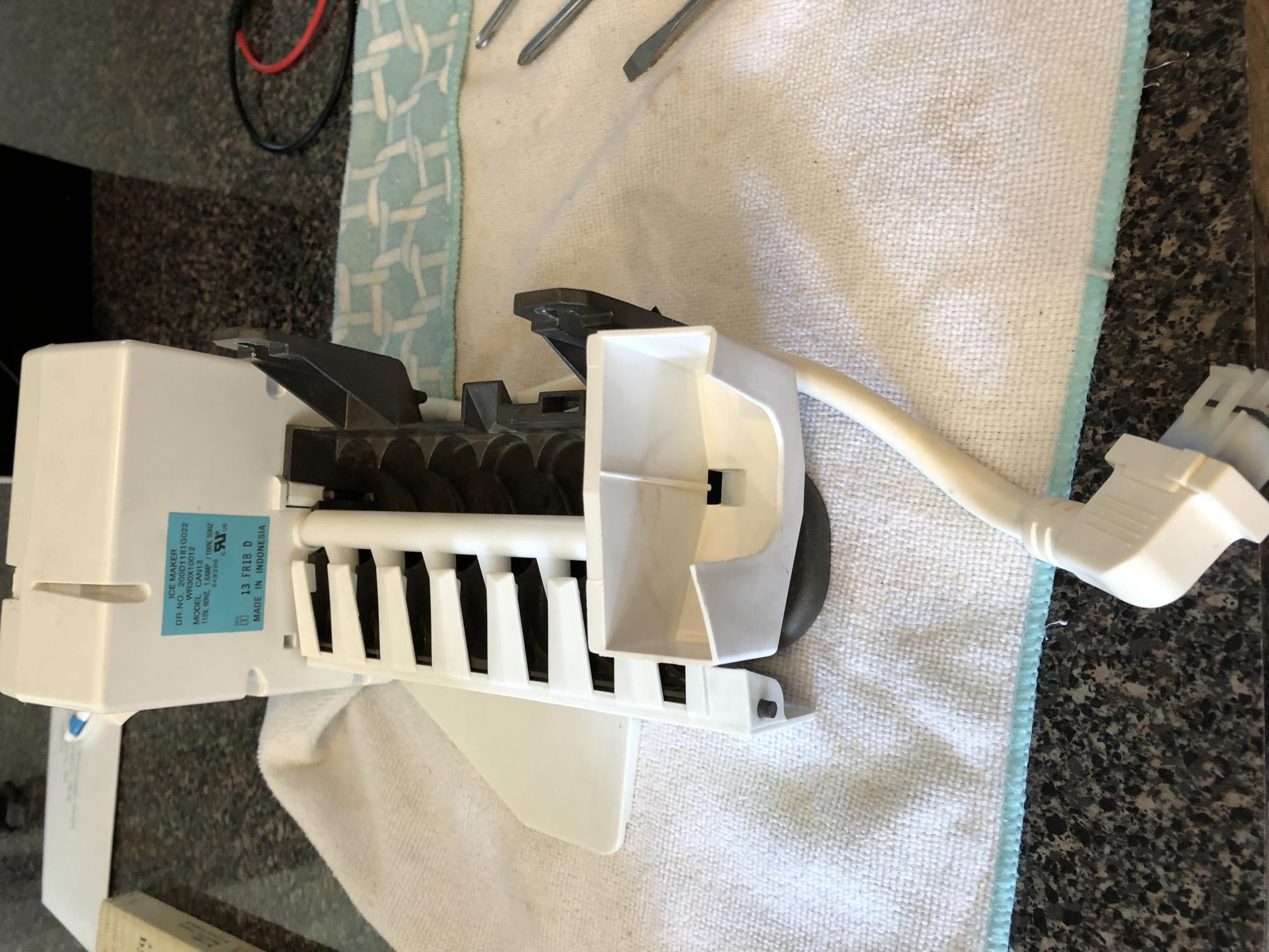

    Ice maker in my GE Model# GDSOKCXARWW bottom freezer stopped working.
    I've diagnosed no 115acv reaching the ice maker itself but can't figure out where it would come from.
    Would it be from the main board itself or is there another line with a fuse possibly?
    The ice release mechanism was jammed and I'm guessing it overworked the motor causing something to either burn out or a fuse/relay to pop down the line preventing power reaching the ice module. I've jumped 115acv directly from a receptacle to the ice maker and it powers on so it's something with the feed.
    Any help would be appreciated

      But with the ice maker removed I don’t get 115acv at the connector that the ice maker plugs into. I only measure 15acv. I’ve uploaded pics to original post

        Icemaker power is in series with the (freezer) door switch, so push it in and see what you get.

          Ah thanks for that yes now I have proper voltage. So the heater fuse should be inside the ice maker itself then?

            Is the thermal fuse accessible?

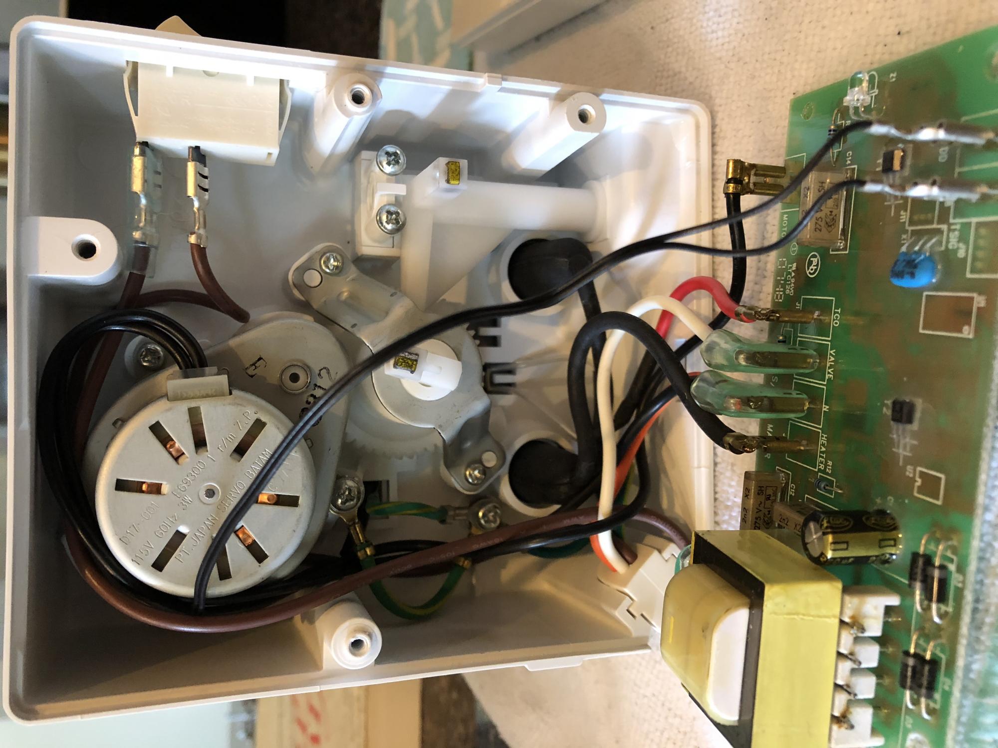

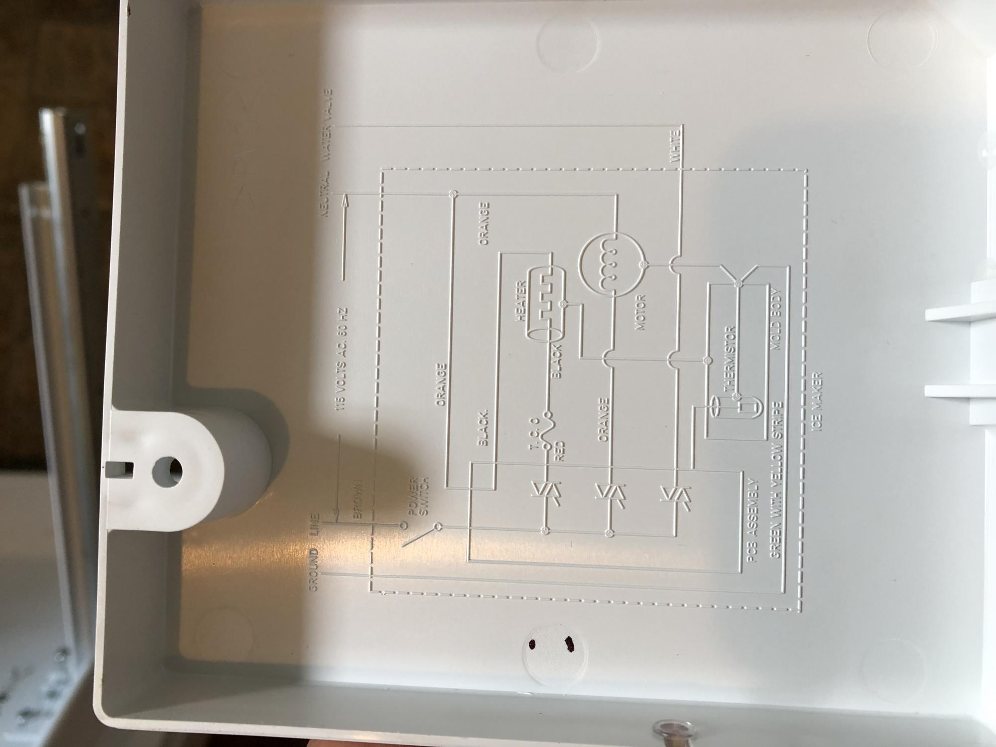

              The two ROUND, black spots (one above the other) to the right in your first photo represent the leads that feed the heater. Check for an open. Trace the pigtails to see what they tie to.
              Note that the small "timing motor" will have a cam driven switch on it to apply power at the right point in the "mechanical" cycle. So, if you have continuity IN the heating element, next verify that the switch engages the power to that element (and hasn't worn itself open).
              You can often diagnose these on a bench just (patiently) waiting for a complete mechanical cycle and noting where it stalls.

                i see it's got the infamous film caps on it - check them for cracks or splits.

                  It seems to be a GE IM6.
                  Follow red wire PCB label "TCO" to the TCO fuse then heater, check ohms-- it only goes to the heater, so the motor should still run.
                  I usually find the thermistor gets knocked out of place on Samsung icemakers.
                  Diagnostic mode
                  "...If the Harvest state takes more than 7 minutes, the icemaker will initiate a Harvest Fix mode. In Harvest Fix Mode, if the Harvest state is not complete within 30 minutes, the icemaker will enter the Fault state. In the Fault state, the green light will flash. This often indicates the icemaker will need to be replaced."
                  Good to know the Lelon electrolytic works when cold lol
                    Re: Anyone repair appliances? GE ice maker issue
                    https://www.badcaps.net/forum/attach...0&d=1533664557
                    You can see that red wire which is connected to the 'T.C.O' terminal of the PCB goes to one end of the fuse, anther end of the fuse connected to the black wire of the heater unit.

                      Ok so the thermal fuse seems fine tests good in continuity mode.
                      I’m hoping the ice release mechanism begins jammed was the only issue. It has power now as indicated by the green light when I close the door switch.
                      I can hear water being entered just have to wait I suppose to see if it produces ice

                                      Also glad to report it's making ice again
