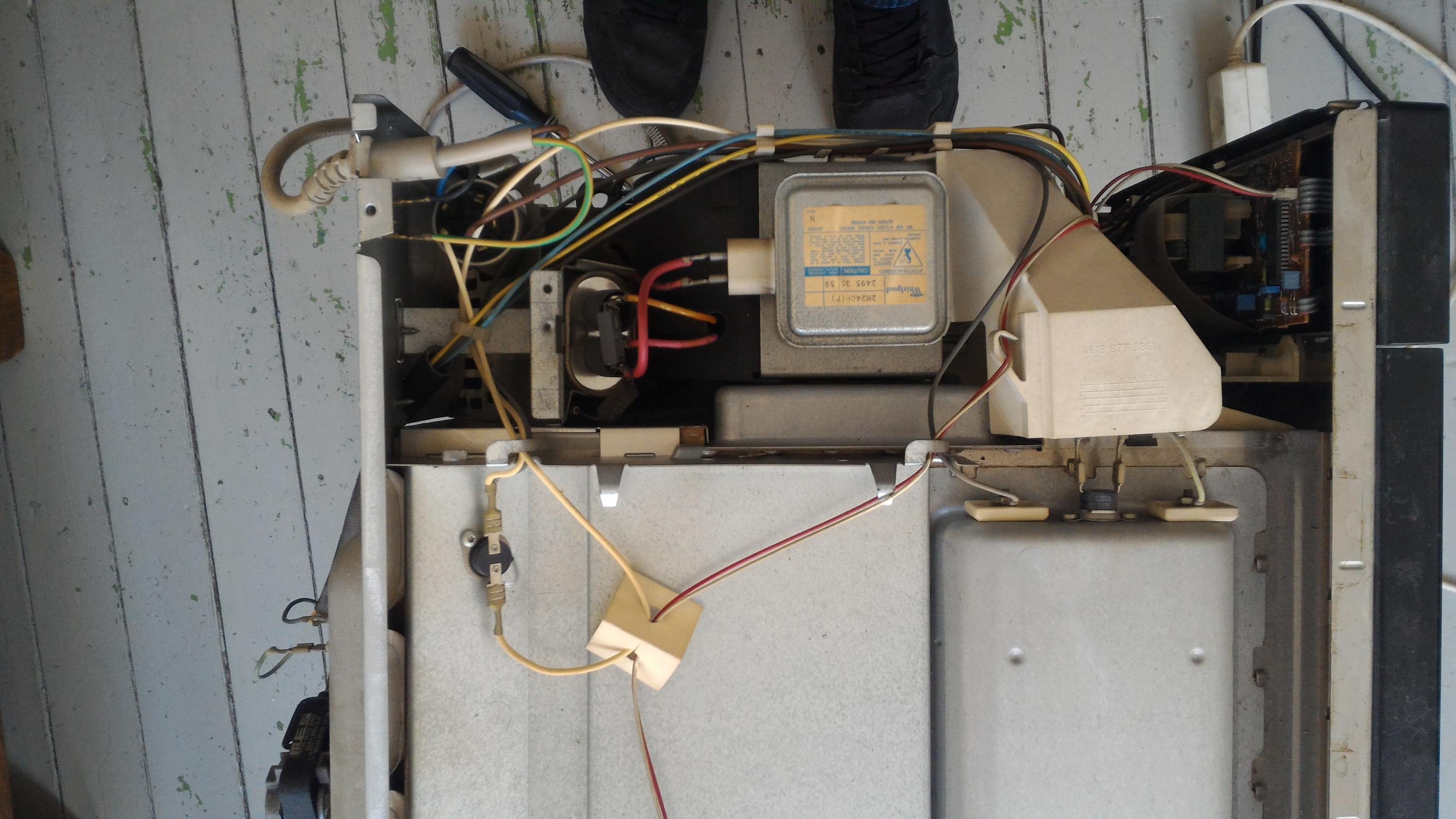

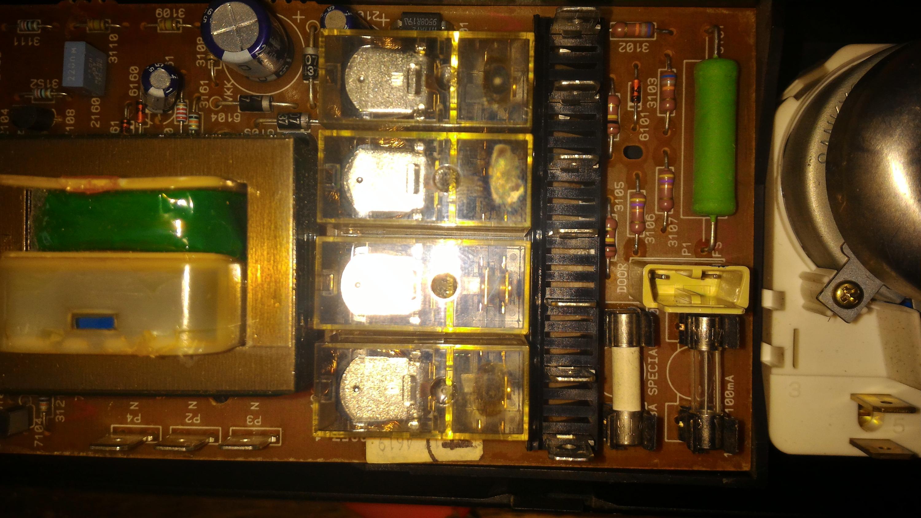

    I have a Whirlpool combi oven/microwave that some time ago, when cooking rice with the microwave function blew a fuse and keeps doing so when plugged in.
    No matter what setting the oven is on, door closed or open.
    I've opened the device and there's a spark to be seen when plugged in, hard to tell where it comes from though.
    (I think) i know it's not a problem with the outlet/fuse because the oven used to work on the same outlet before. (32A fuse)
    I did a check on the internal fuses of the oven i could find and they had continuity.
    After some google'ing i checked the door switches and they seem fine aswell. (continuity when pressed, none when open) All of the switched had some black oxidation? on one of the leads, but the others were clean.

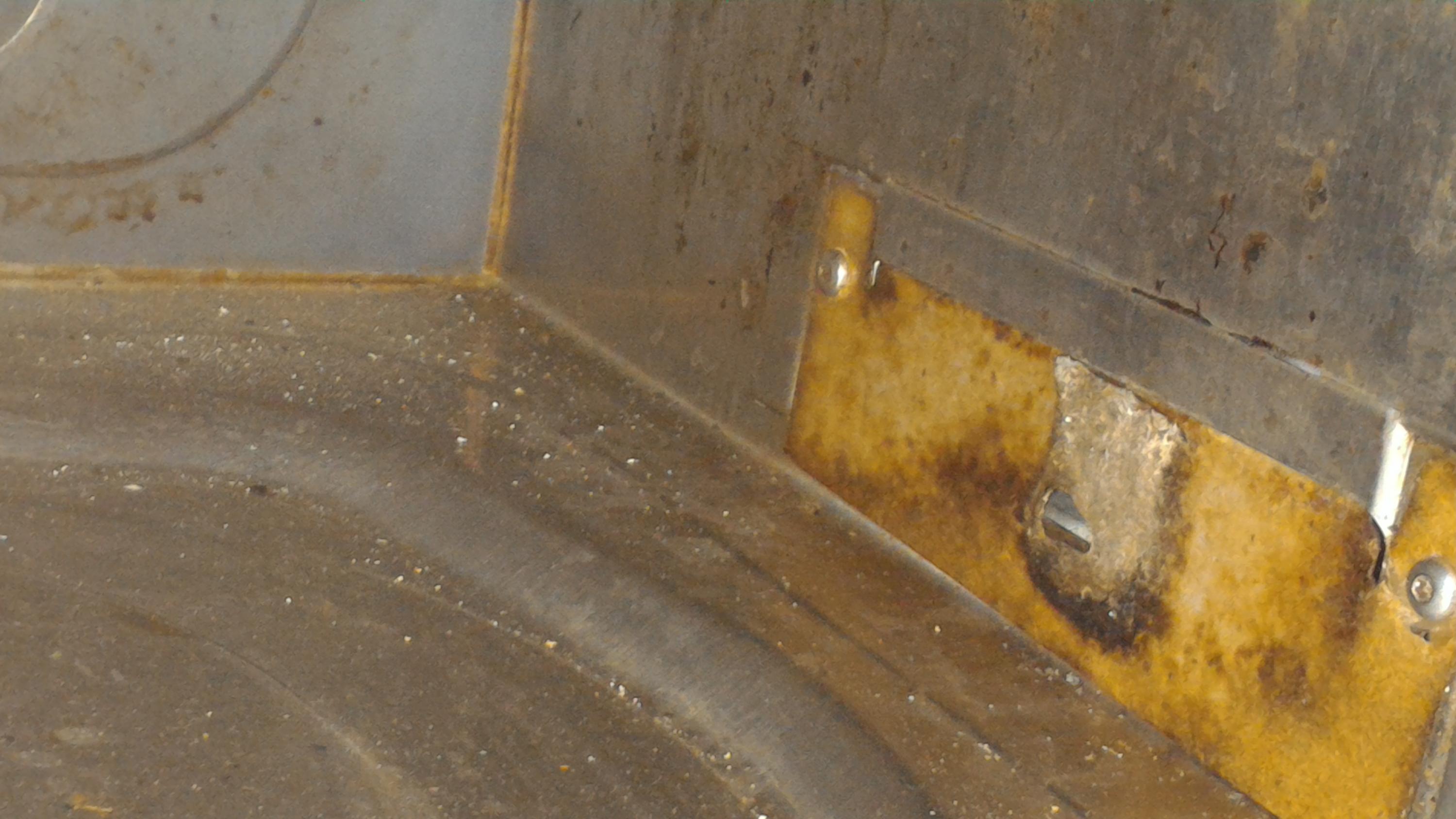

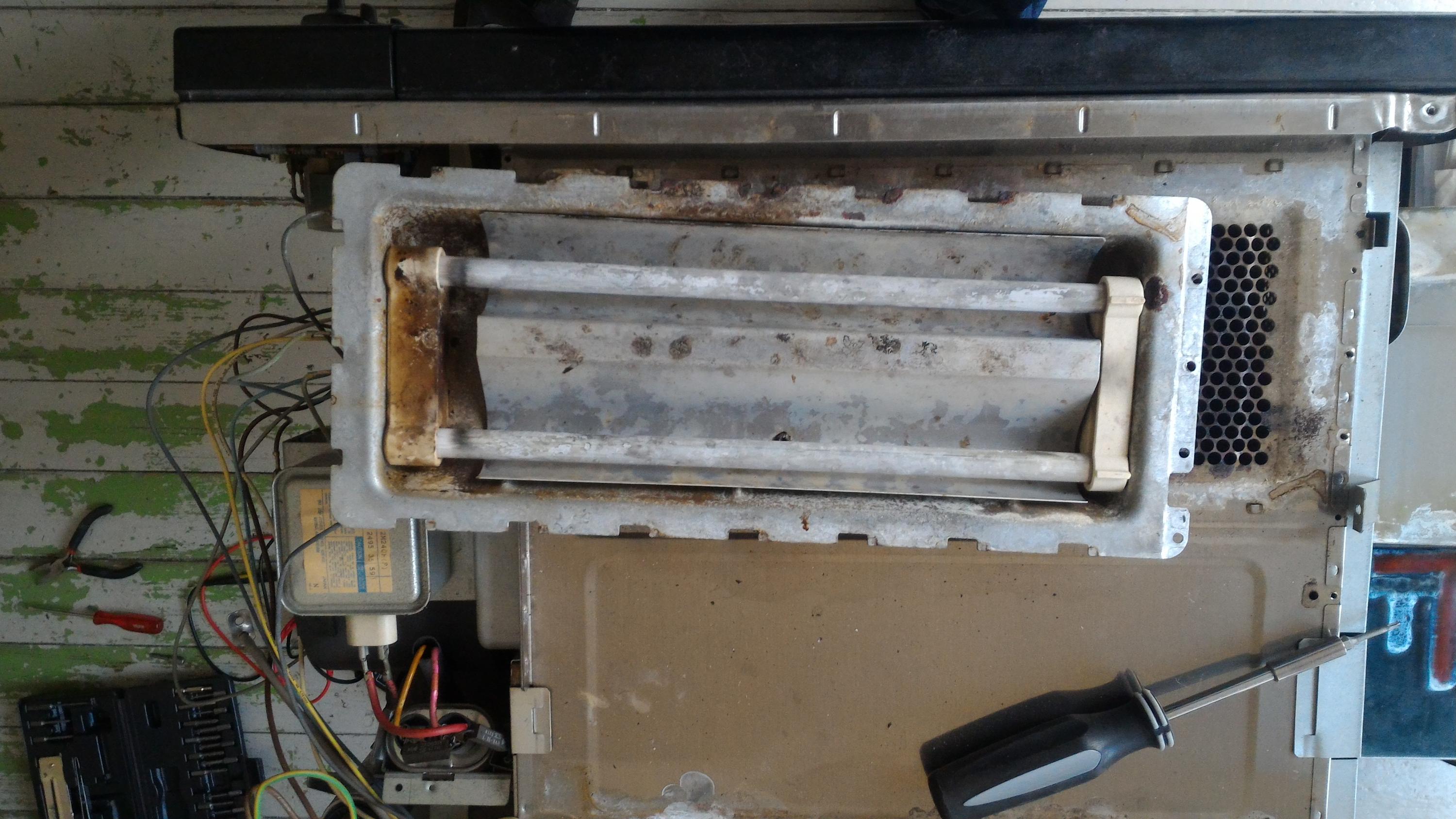

    The bottom mica plate has a hole burned through, the top one looks ok.
    I believe it's a Whirlpool AM 220 BL (Vip 34 Crisp Series Forced Air Combi), but it's hard to tell because the sticker displaying wattage etc isn't to be found.
    However, there is a sticker found on various parts of the device with two 12 digit numerical codes, accompanied by barcodes.
    (8538 220 20491 & 37 9517 601113)
    Whirlpool has a manual on their site for a model with code 853822020490. (AVM 220 WP BL)
    My electronics knowledge is poor at best but i like to tinker/repair, so i've come here to see if anyone can/wants to help me out.
    I can make pictures/video of the device if this helps.
    [EDiT: added video]

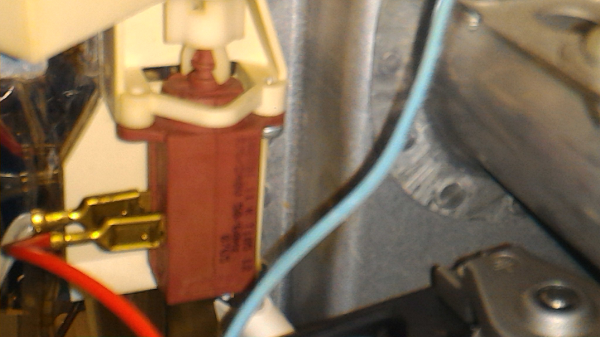

    Spark at ~11 sec, to the right of the thermoactuator
    1) What else can i check with my basic multimeter?
    2) Given the information above, where is the problem most likely to be found?

    Photos always help.
    Blowing fuses is usually something in the high voltage side of the power supply. Voltage rectifier, mosfet are usual suspects. The location of the spark is i feel a good stating point.

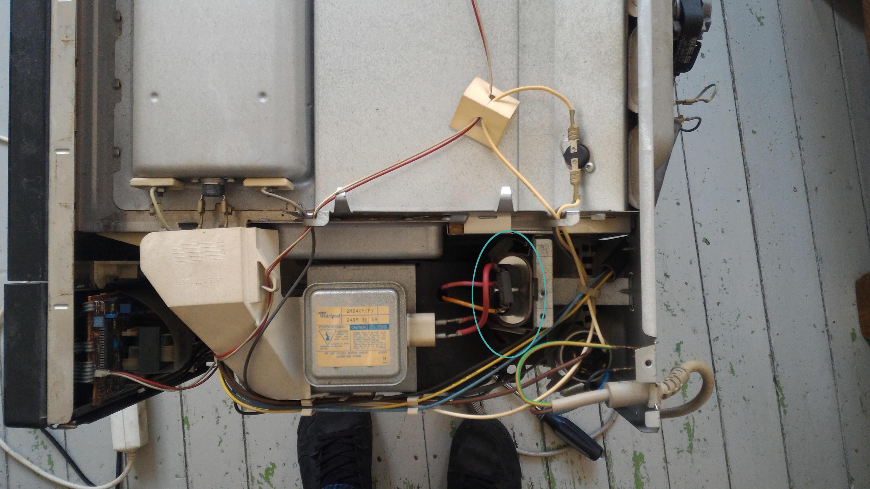

      I've added a video to my original post, and here's some pictures:
      http://imgur.com/a/W1lKA
      I was able to identify the red part to the left of the spark which is a thermoactuator (Eltek 100331.11 K T105 12), to the right of the spark is the magnetron itself?

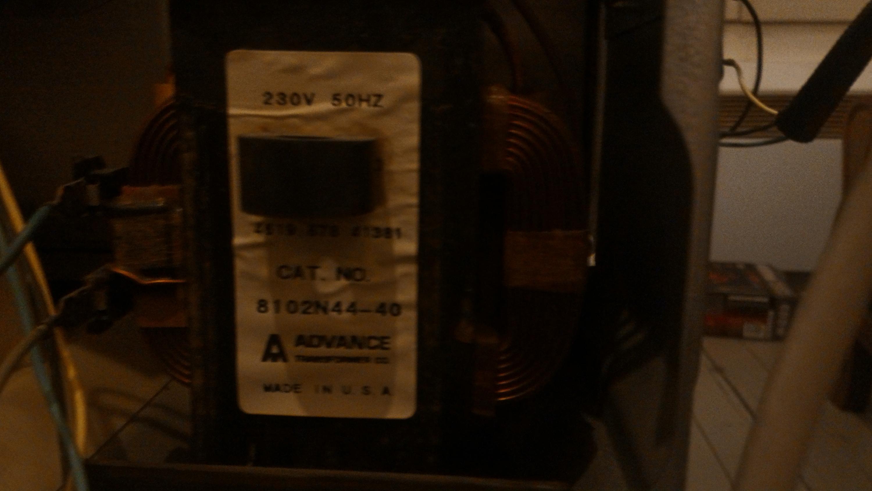

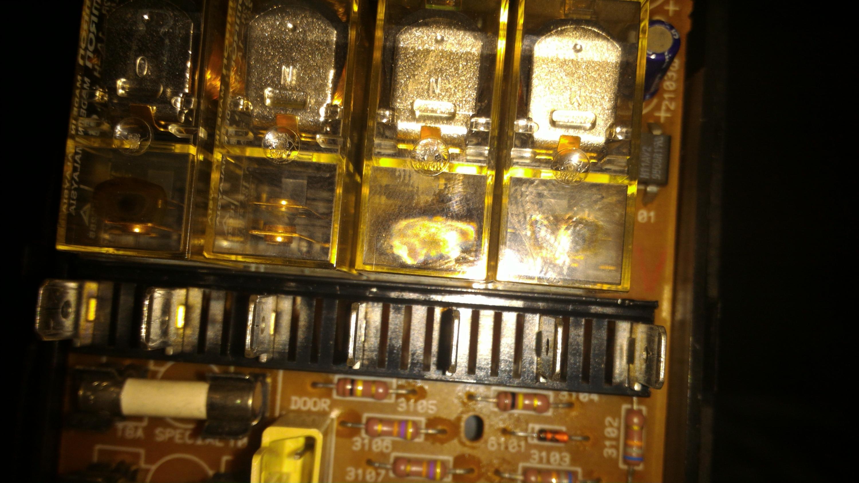

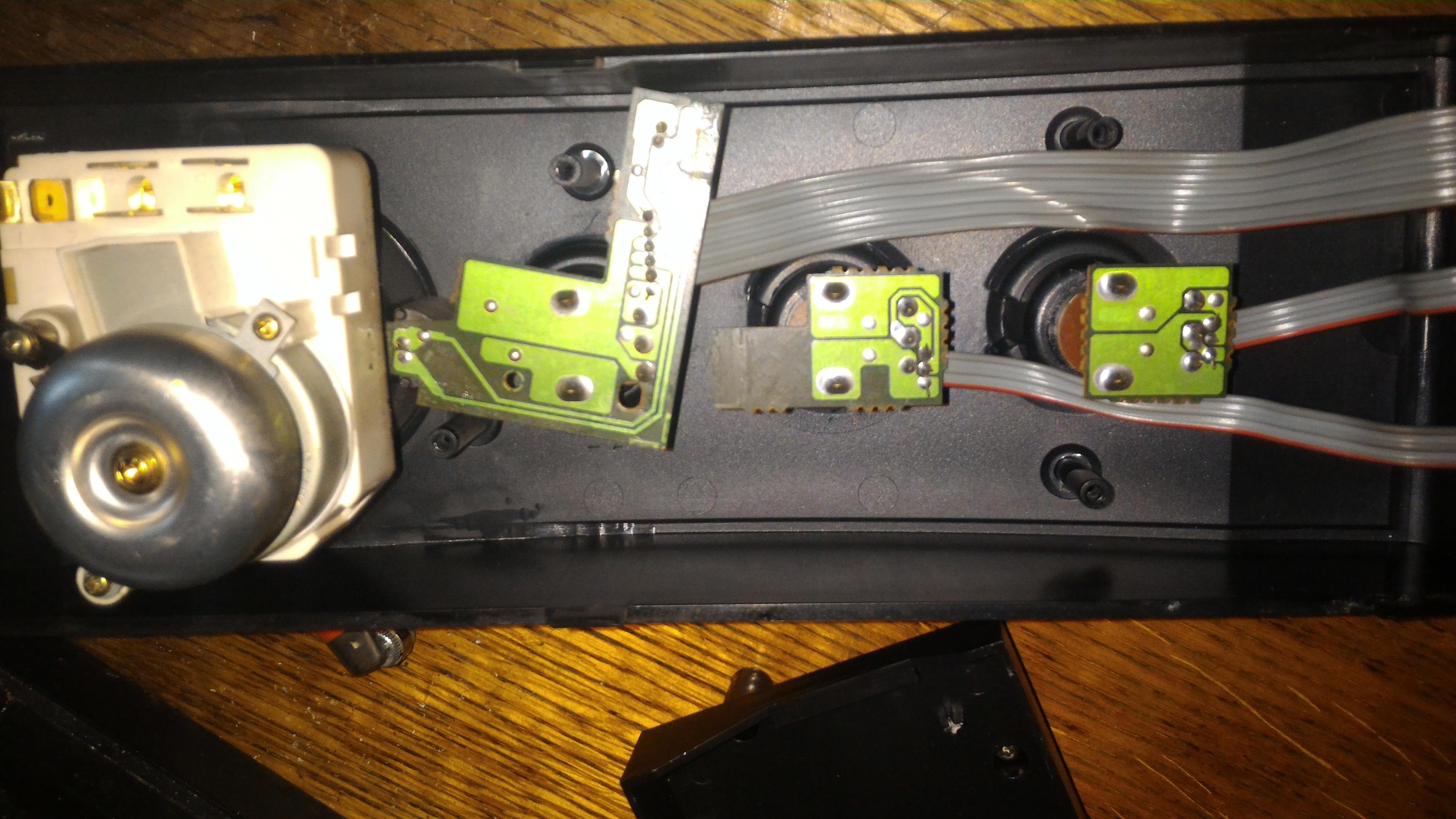

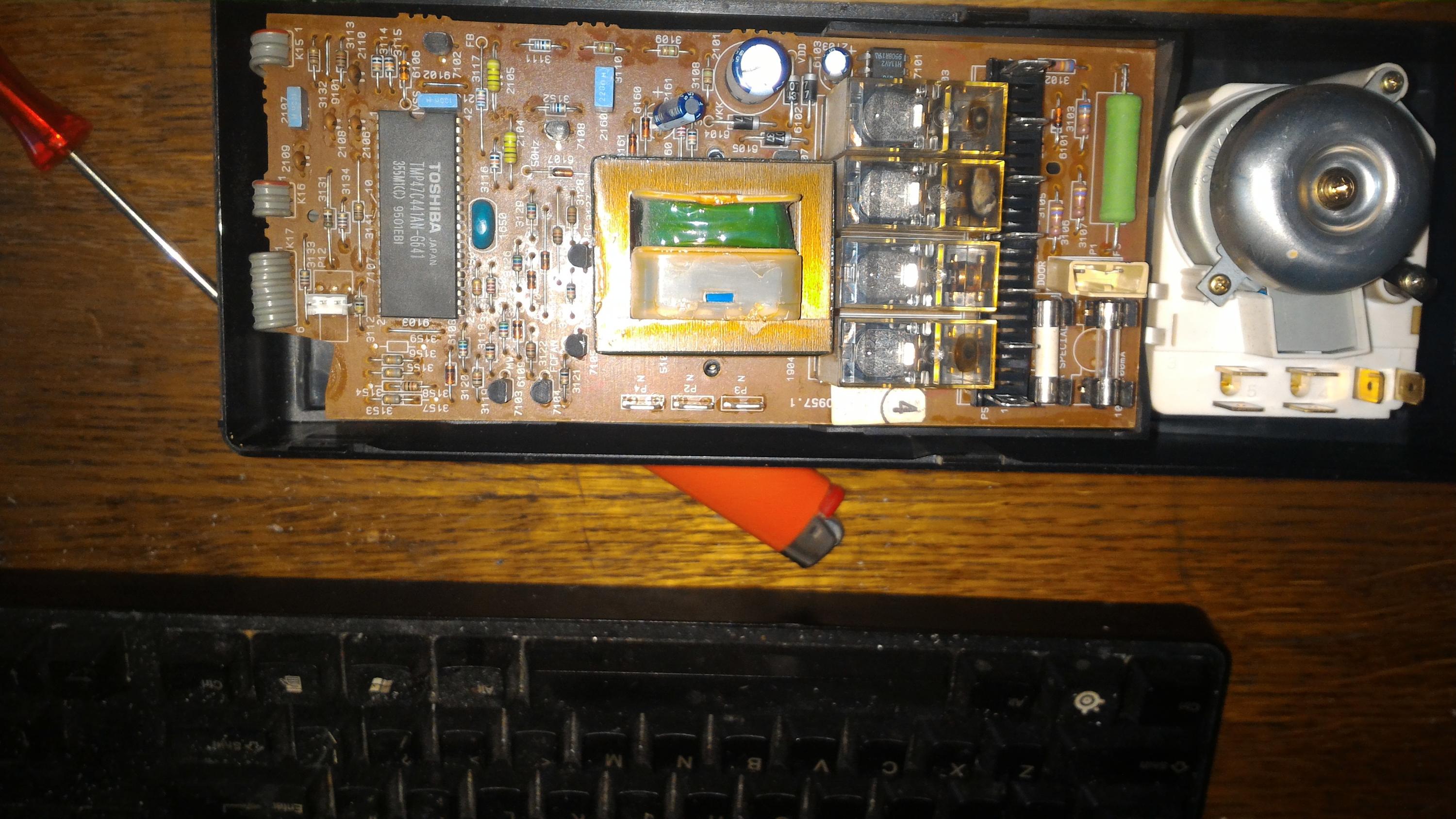

              In the last picture it looks like the middle relay is burned and the inside copper contacts melted together, could this make sense?
                Yes the one in middle is looking bad and one on the right side it hard to tell what shape it is as well

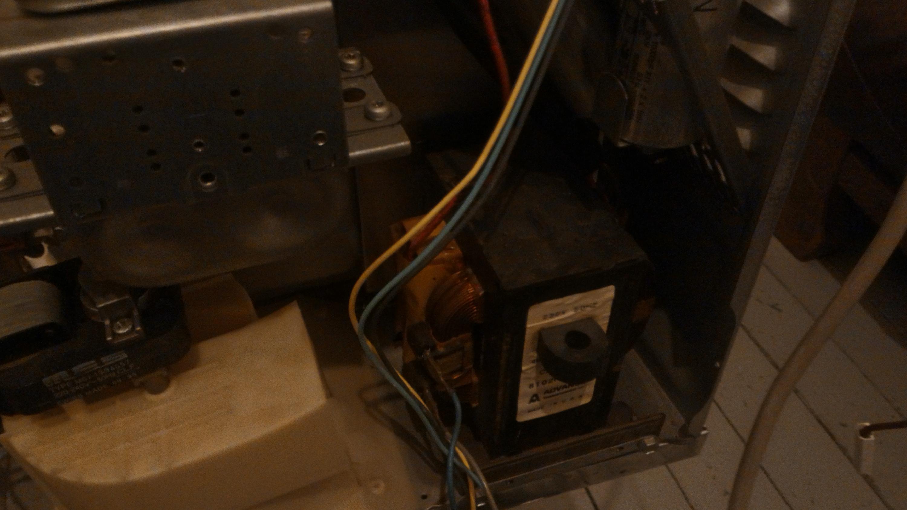

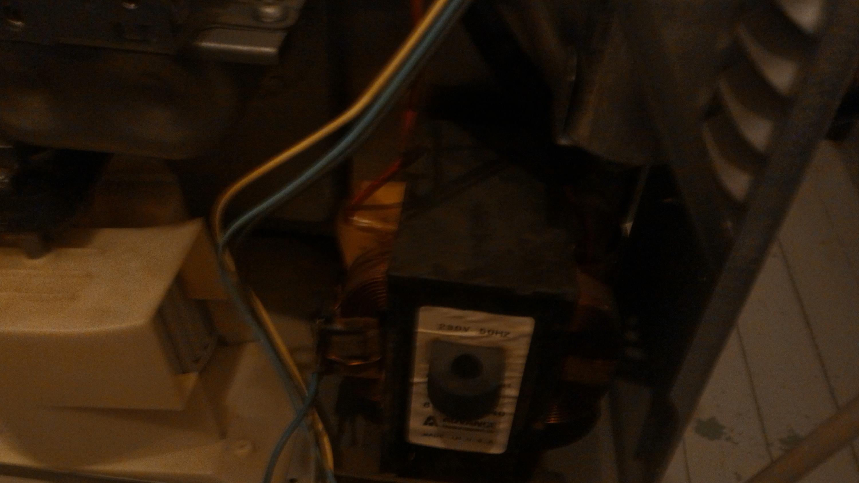

                Take a real close look at both of the also check the two heating elements for short and open
                In all of the photos I do not see the high voltage transformer please take of that transformer

                  That relay does look like it's splattered to hell, i suppose if its part of the interlock and welded closed that could very well be the problem.

                    that arc is rather large .. lots of volts there i guess .. seems to come from the part in the middle . transformer/coil looking thing ,

                      I took some more pictures including the transformator:
                      http://imgur.com/a/fOKH7
                      The quartz grill has continuity, i'll check the heater for the hot air tomorrow.

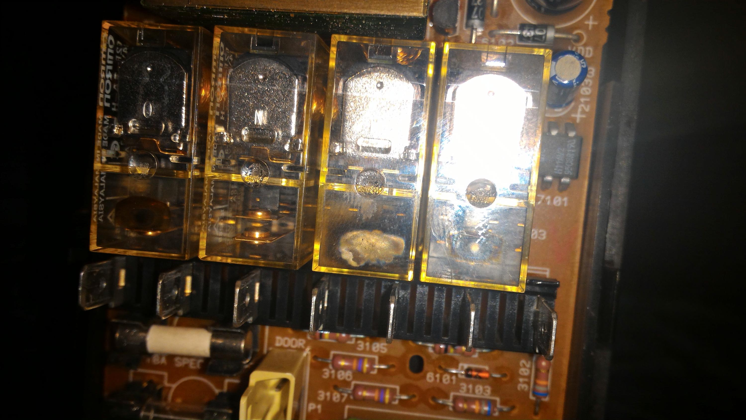

                      I'm thinking about desoldering the relays from the board so i can have a better look at them.
                        I think it's coming from behind the transformer in the middle, where the cavitation chamber (waveguide?) for the magnetron is.
                        The part with the transformer is the ventilation fan, could that even produce such a spark?

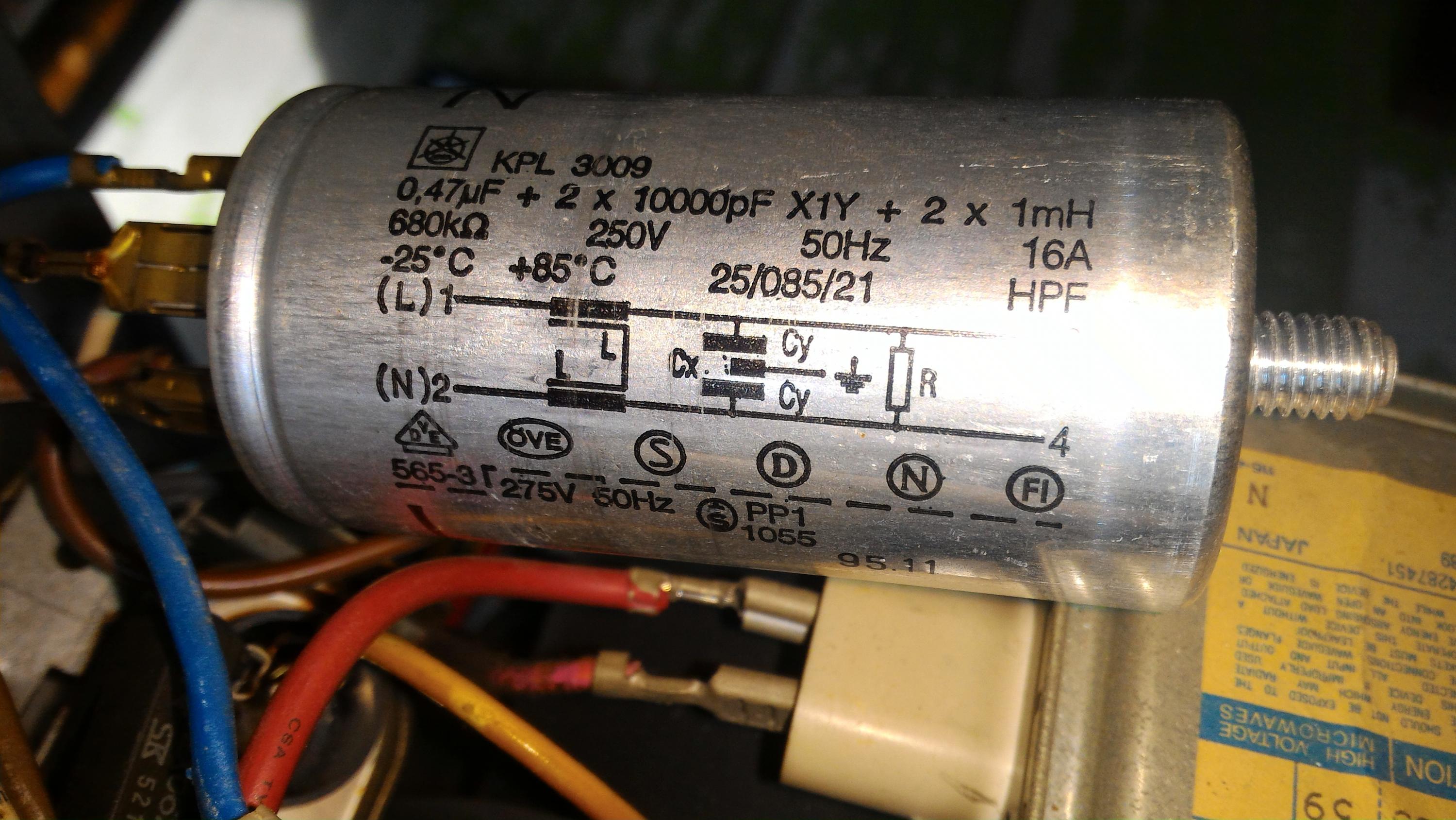

                          BTW, what you have pictured isn't a cap. This is.

                                  Re: Whirlpool Combi-oven blows fuse, please help.
                                  I don't know exactly what you mean by "what you have pictured"
                                  Yes, the one you circled is a filter cap for the magnetron and slightly to the right is another filter cap for the quartz heater and hot air element. (that's the main's filter?)
                                  Originally posted by stj
                                  you know, if it's blowing external fuses but not internal ones - it could be a shorted capacitor inside the mains-filter can behind the incoming power cable!
                                  This one?
                                  Can i test this cap when it's removed from the device?

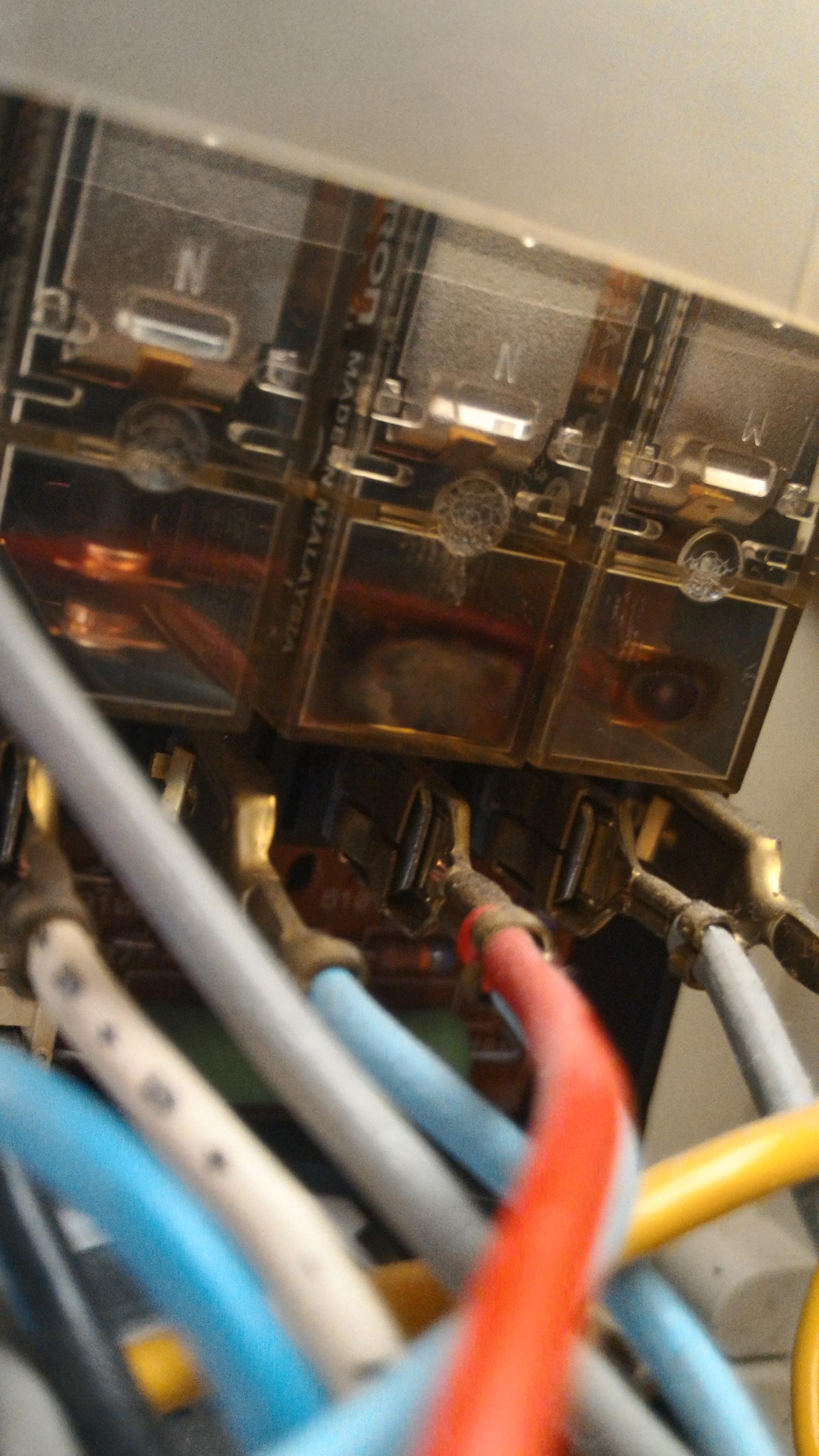

                                      I don't know why you can't access imgur but i've added some pics as attachment.
                                        • 31051
                                        3bad relays,
                                        cracked soldering on the pcb,
                                        signs of water damage that needs to be investigated.
