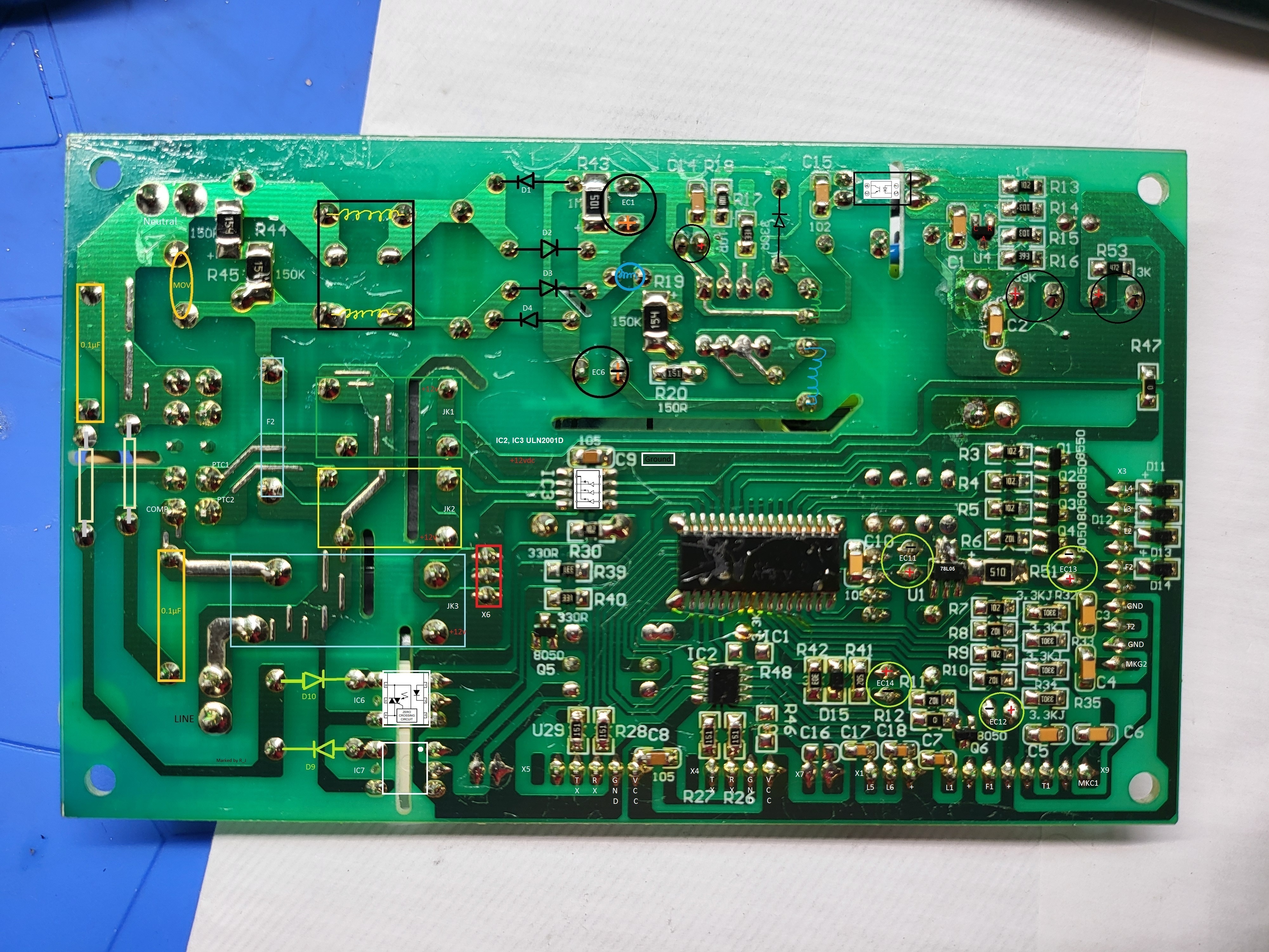

      So I have checked every wire, connector and accessory on this fridge. There are no shorts. Every wire has continuity from beginning to end and no component outside of the PSU seems suspect.
      By process of elimination I am confident that the issue is with the PSU.

        So as I mentioned, I think I have narrowed the problem down to the PSU.
        Specifically the PSU is not providing adequate voltage (or any voltage at all) to the accessories and components.
        The controller/display is actually getting 12V from the PSU via X4 and X5 connector (VCC + GND) but no backlights show up.
        I will have to go back and remeasure voltages on the bench as I realize i made a mistake. I was checking pins against ground but I should have been checking them against (+).
        When i realized this I checked the LEDs against their corresponding (+) but i got the same voltage readings. Not sure what to make of that....
        I have fresh questions about that EF20 transformer.
        Its not giving me any expected readings on the secondary side but I don't have enough experience with them.
        Plus I have no idea what voltage its suppose to be putting out as I can discern anything from the part number.

          This is a switching power supply it operates at around 60KHz if the transformer had even one bad turn the power supply would not work and the switching ic would be blown.
          The power supply supplies 12 volts dc for everything. Do you have +12 volts across EC4 ??? when everything is hooked up
          What are these "expected readings" you are looking for?
          I checked for voltage going to the relays.JK1 has 11.5v going to it
          Recall the PSU was only supply 1.2V when it was on the bench....
          Lets start from the beginning:
          The power supply supplies 12 volts dc for everything. Do you have +12 volts across EC4 ??? when everything is hooked up?
          if not then we can check the primary side and see what voltage is ACROSS EC1 and ACROSS EC6

            One the bench i have a voltage of 12.26V on EC3 and EC4 and the same is true when its hooked up.
            EC11 is 5.07v, EC12 is 0v, EC13 is 0V and EC14 is 4.8v but very slowly decreases ~0.02v per second. These behave the same hooked up and on the bench.​​​

                          EC11 is the output filter for the U1 5 volt regulator, it better not have more than 5 volts on it. I would need a clearer picture of the board to see the actual traces to trace the function of EC14 but it is likely on a vcc supply line for something that is turned off at the moment
                          You could check the voltage on IC1 pin7 this is the microprocessors reset pin.It looks like the voltage should be about 1.4v
                          a closer look at IC2 and I think it is the same as IC3? instead of driving the relays it drives the led strings L5, L6, L1

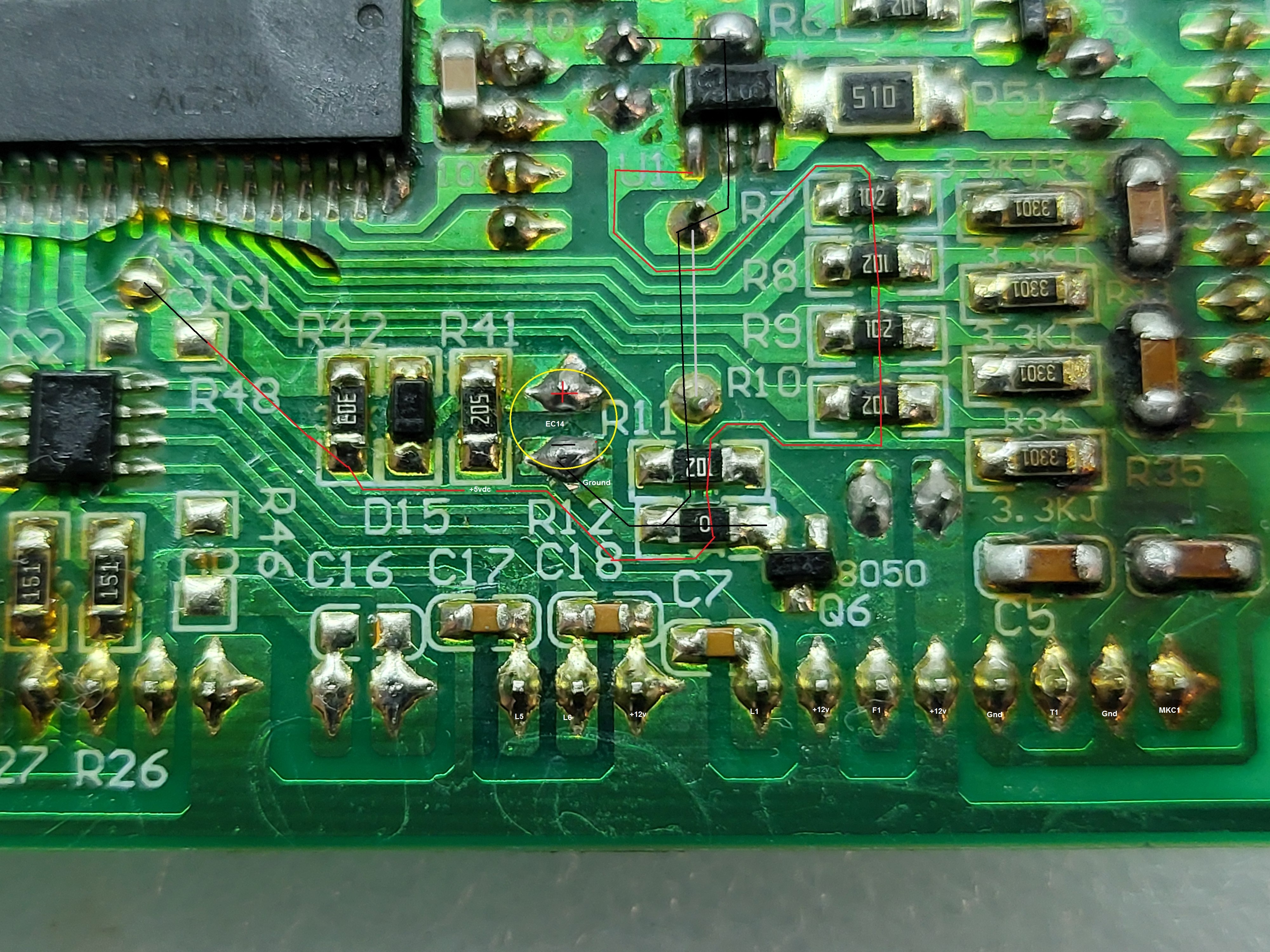

                              Not sure what EC14 is for exactly, but it seems to be for some time delay. its negative is connected to ground and its positive connects to R41 (5kΩ) and D15 cathode and the other end of R41 connects to +5 volts, D15 anode goes to pin 20 of IC1
                              So 5 volts charges EC14 via a 2meg resistor and the anode side of the diode connects to the 5v via R42 (30kΩ)

                                    Correct me if I'm wrong but isn't the negative of EC14 connected to emitter of Q6 after going through the 0-ohm resistor?
                                    The collector of Q6 seems to be connected the F1 lead as well as the neg of EC12.

                                      There is a jumper wire from U1 ground to just above R11, a trace runs under R11 and connects to the left side of R12. The lower side of R41 connects to a +5v ltrace that also runs under R12 and R11 and finds its way up to U1 +5v
                                      Your X1 pinout is wrong, should be L5, L6, +12v
                                      Q6 is the fan control transistor, it connects the fan negative to ground, Q6 base is controlled by the micro via R11
