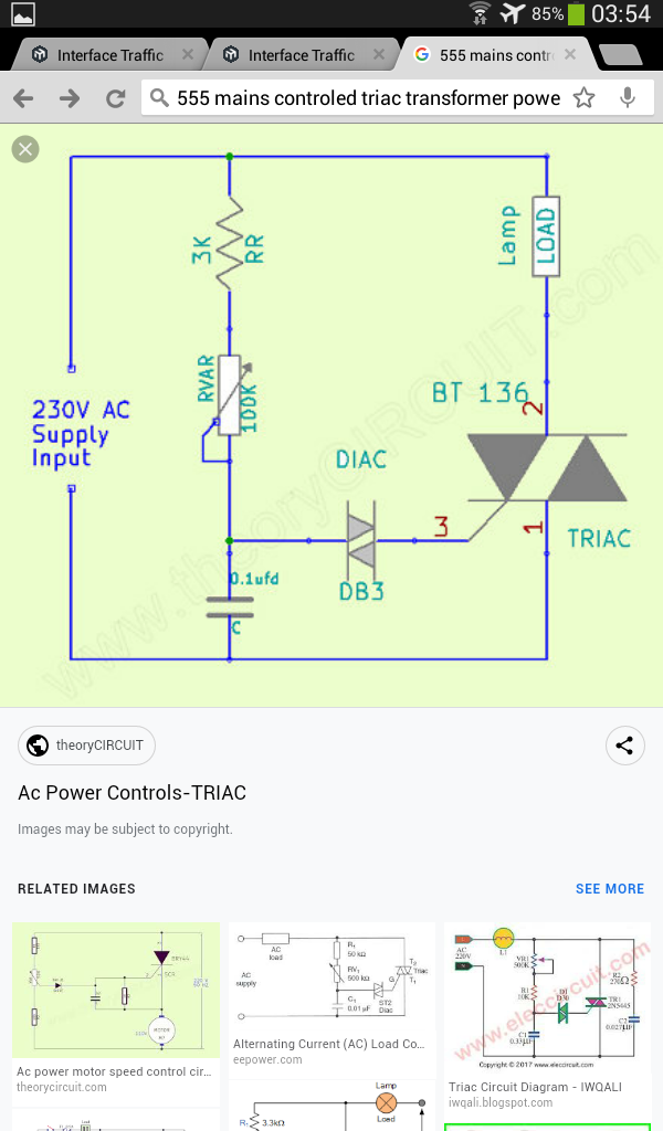

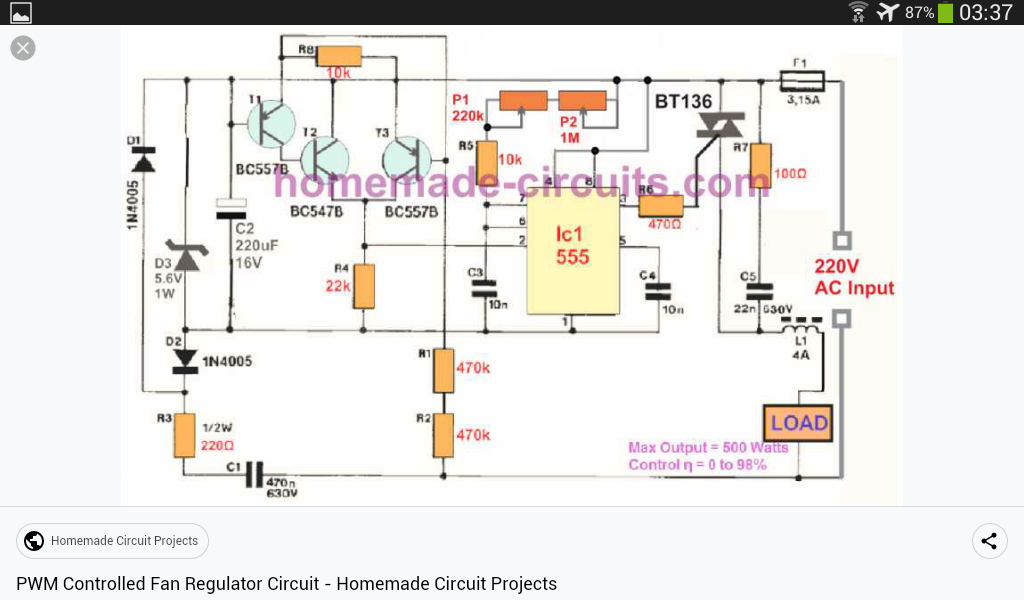

                  I look and steirs at datasheet... and nothing... I can not see how to determine what component is "better"... for different point of switching...
                  Anyway, all videos presents control triac in therir narrow midrange or so, I can not clearly see to one circuit that fully start at beginning after zero cross and control cutoff till end.

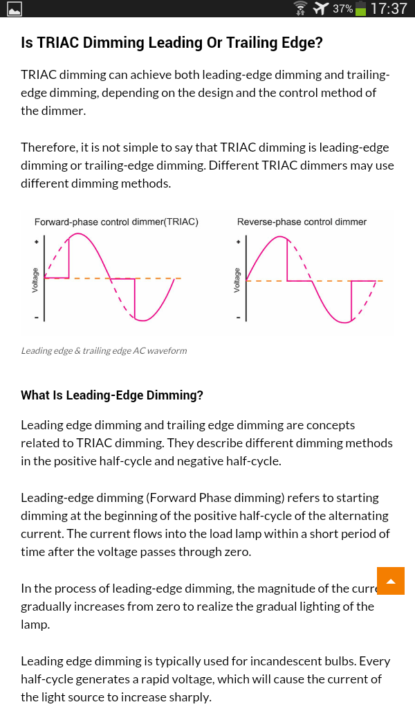

                  Now I found that switching phase can be control in reverse order also, so it is interesting point to me, it not shock end device so much, but nothing to conclude how circuit look...
                  For control mains transformer primarry windings, is it better (efficient) to triac act normally or in reverse order?
                    • 31187
                    i dont think you can use a simple diac+triac circuit for 0-100% because you need a minimum threshhold to drive it all
                    i think the lower limit is about 5%

                      Plus the fact that I do not think that you can have it all either you do leading edge or trailing edge but do not think you can use the both edges at the same time so if that is the case then you have to decide what uses the most of the sign wave and the most efficient use of it
                      Now to me is how smooth the transition from fully off to fully on the question is how attainable is this process and how difficult is going be built it and what are trade offs going to be this is the question and the question also is can this be done with a transformer being controlled this is what I am interested in and have been for a very long period of time and I have not really found the perfect solution to this question and issue with controlling a transformer
                      This is I have been following this post now I have found a few solutions but you are giving something up the either the transition is not very smooth or you do not get fully off or fully on or it suddenly turns on and it is not very smooth transition and suddenly fully on it is usable but I more interested in something that is smooth transition for the majority of the transition if I have give up fully off and fully on because if I going to use it for battery stud welder this is the consideration that has to be considered for best results
                      This is also has to be be reliable and repeatable and consistent each time to achieve this is the hardest part of this process

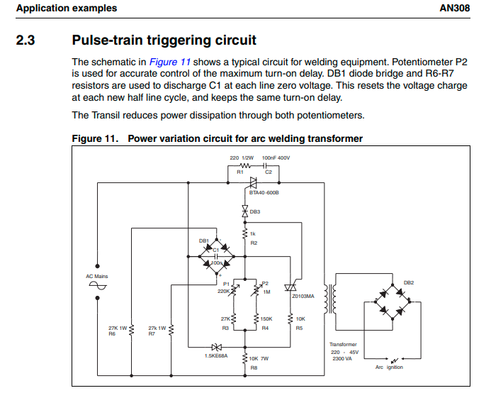

                                I think I have found what I am looking...
                                What is transil?
                                EDIT
                                Ok, TVS diode...

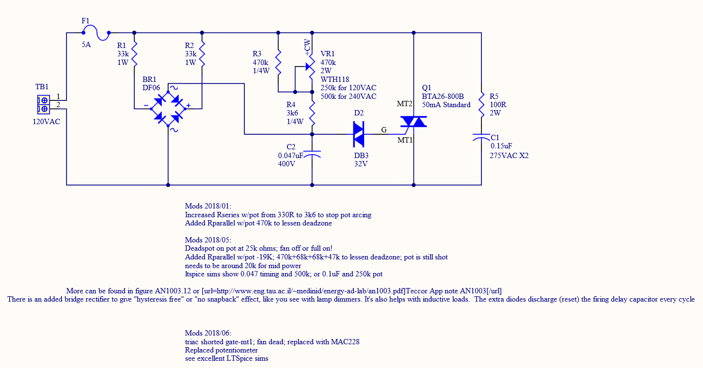

                                • redwire
                                  • Dec 2010
                                  • 3912
                                  This app note is good for what you are trying to do. More can be found in figure AN1003.12 or Teccor App note AN1003
                                  My notes and schematic for eBay/Ali 4,000W power controller after it died - TWICE. Cheap triac, then the pot smoked. It's a good start for a simple circuit.
                                  The hard part is getting good adjustment range, say 50% with the pot at 50% rotation.
Name:	eBay power controller schematic.png
                                  • harp
                                    • Jun 2022
                                    • 622
                                    • Planet Earth
                                    Nice, this is from 5% to 95%
