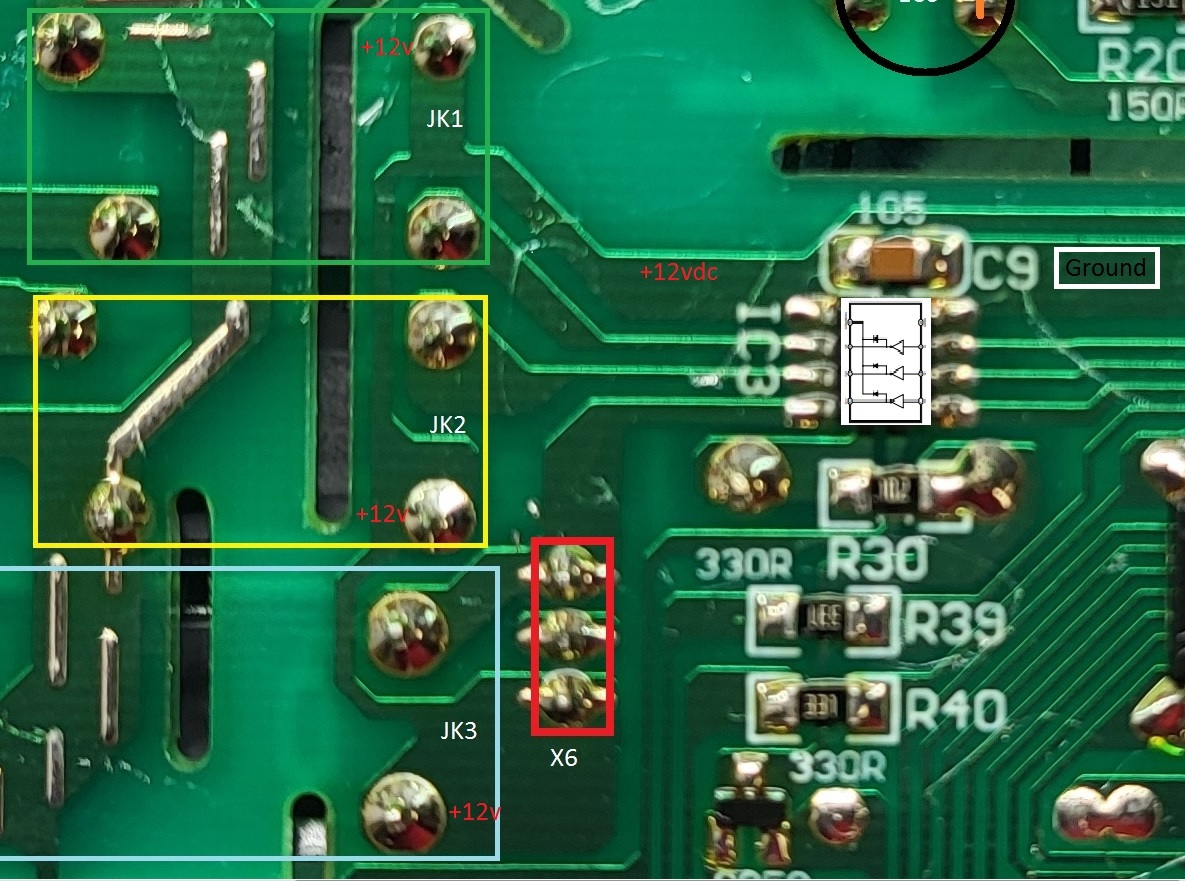

                      • R_J
                        • Jun 2012
                        • 9625
                        #31
                        I checked for voltage going to the relays.
                        JK1 has 11.5v going to it, while the others (JK2 and JK3) have none.
                        This is from post 20, if this is true then you have a broken trace between the +12v on JK1 and where it connects to JK2 then on to JK3. Look at the circuit traces, all 3 relays have one pin connected to +12 volts and the other pin is connected to IC3 which controls the relays. Plug X6 should have +12dc on pin1
                        Why keep checking the power supply? it is working! The diodes capacitors etc. are all working there is no need to replace them, you will just end up destroying the power supply section.
                        The so called crack you see is just a plastic molding mark

                          #32
                          Wow.. Thank you very much R_J.
                          Your diagram of my PCB is better than what I am doing.
                          I have to step my game up!
                          Regarding checking and rechecking components on the board I wanted to ensure that I am thorough as possible this 2nd time around (recording readings, etc) and that i did not miss anything.
                          My cursory checks are often with components in circuit. Or if i ddi take them out i dont write down my findings.
                          Redwire also mentioned that everything can look good on the bench but when the board is put underload it fails.
                          I have already found a bad cap which i have overlooked today.
                          But there is truth in what you advice... constant soldering and desoldering runs the risk of ruining the board.
                          Once measurements are recorded i will not have to take them out of circuit again if they are found to be good.
                          Regarding the +12V traces and positive leads on the board all have continuity as I just ran down to the bench and checked.
                          When i checked whether they had voltage or not I checked the + and - leads of each of relay.
                          The UN2001D driver (IC3), for some reason, is not providing ground for JK2 and JK3. I believe this signal to provide ground should be on by default or come from the main IC (IC1).
                          If not on by default it must be waiting for a signal/trigger from one of the connected accessories.
                          But as I mentioned there is 120V going to the internal heater coil as soon as the board is connected to the mains (this is connected to the JK1 relay which is powered on as automatically).
                          That seems wrong to me...
                          At no time during my testing have i seen JK2 or JK3 cut on.
                          • R_J
                            • Jun 2012
                            • 9625
                            #33
                            Check U3 pins 1,2 & 3 using pin4 ground, that will tell you the state of the outputs from the micro ic1 It may be that when ic3 shorted it damage ic1 port

                              #34
                              when i measure the resistance as you instructed i get ~14.8 kohms on pins 1. 2 and 3 (against pin4 ground)
                              • R_J
                                • Jun 2012
                                • 9625
                                #35
                                Resistance does not turn on the ic, you need to check the Voltage on those pins, I suspect pin 3 will be high indicating that driver is turned ON causing JK1 to be activated
                                • KYBOSH
                                  • Oct 2011
                                  • 581
                                  • Unknown
                                  #36
                                  Sorry about that... i thought we were looking for an internal short of some sort in IC1.
                                  So when the board is not plugged into mains there is no continuity on any of the 4 pins as I mentioned before.
                                  But when the board is plugged in and activated you get 0V (actually shorted to ground) on pins 1 and 2 then 1.75V on pin3.
                                  • R_J
                                    • Jun 2012
                                    • 9625
                                    #37
                                    The microprocessor is outputting 1.75 volts which turns on the ic3 driver pin3.so either the micro output for that pin is bad or the program is turning on that pin to turn on the heater, maybe a bad sensor is causing the problem.
                                    This fridge has two zones correct, a left zone and a right zone, It should then have two separate sensors, so I would find a way to switch the sensors on the board and if one of the sensors is causing the problem it should turn off JK1 and turn ON JK2. Or maybe try unplugging both sensors and see what the relays do.
                                    Which plug do the sensors connect to?

                                      • R_J
                                        • Jun 2012
                                        • 9625
                                        #39
                                        Im a complete laymen when it comes to microprocessors Im affraid.
                                        Micro output is internal to the microprocessor?
                                        Also which sensor would you referring to?
                                        Remember the PCB is sitting on my bench and the only thing that is connected to it is the mains power line.
                                        So there would be no input from any sensor it would normally be connected to when hooked up to the fridge.
                                        What would be the next step to rectify or at least verify your ideas here?
                                        Well without a sensor connected to tell it the temperature, it may think it needs to turn on the heater? I guess at this point you may need to install it back into the fridge to see what it does.
                                        here is a similar fridge controller wireing diagram

                                          #40
                                          So when I connect the board to the fridge and power it up I get a short beep from the surface mounted speaker and that's it. No sign of life after that. But I will connect everything up and take voltage readings this time.
                                          Will let you know how it goes in the morning.
                                          Thanks for the assist and brainstorming session (mostly your brains!)
