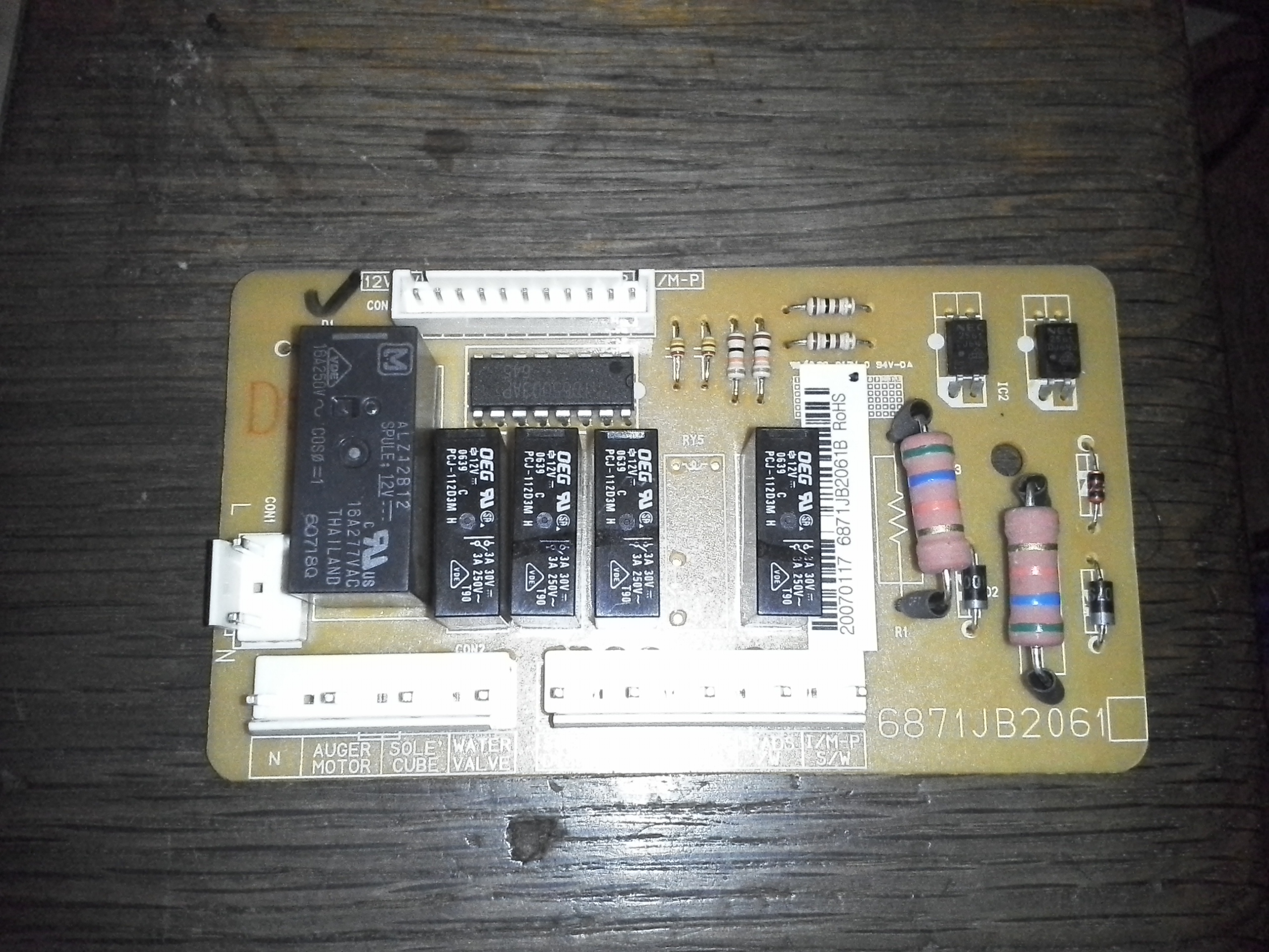

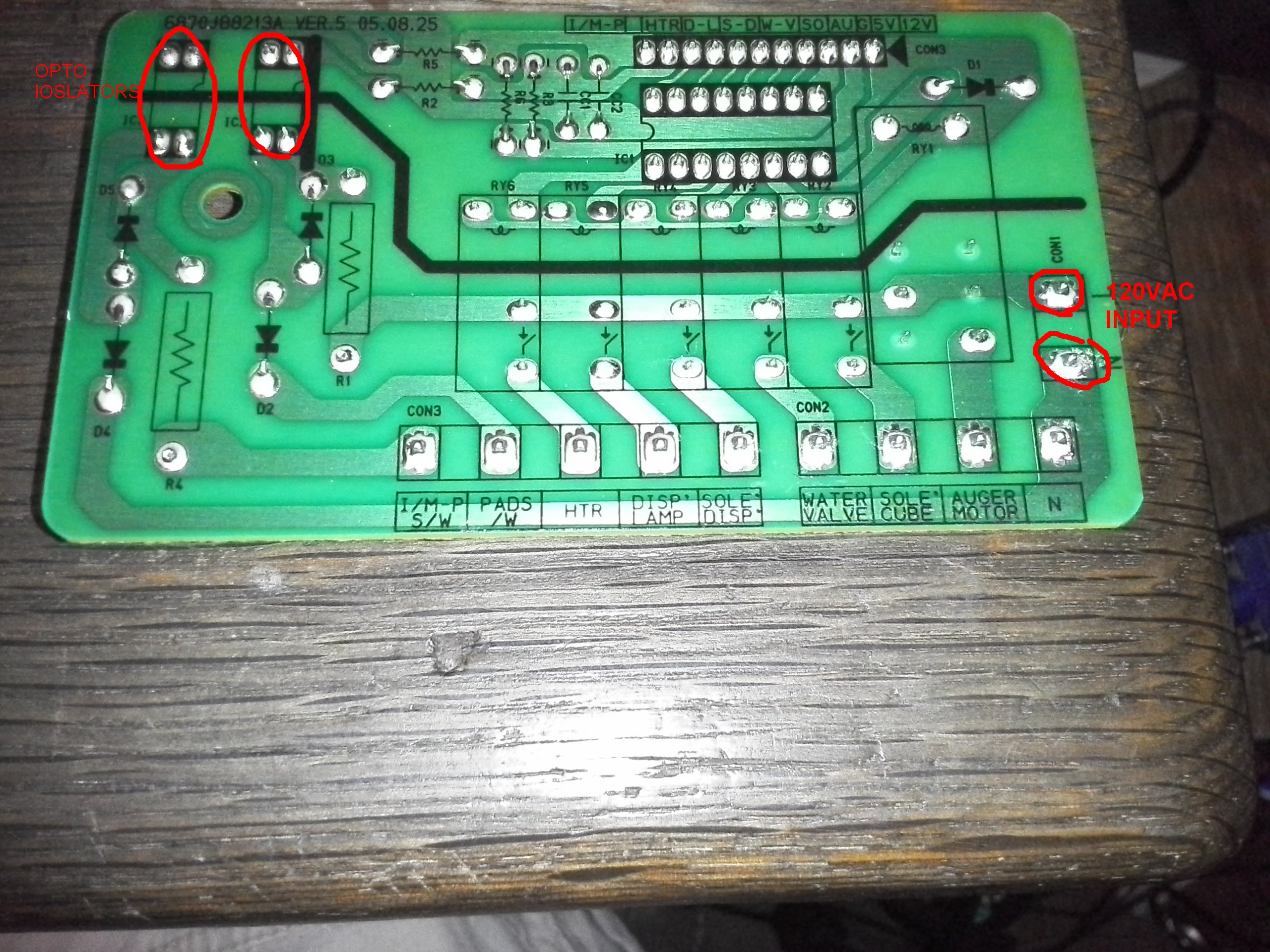

I got a friend with LFX25960SW, it will dispenser ice but not water.
I checked the tube for blockage by disconnecting and blowing through it and it was fine and obviously water is getting to the ice maker.
I check the water valves which has three in the system, one for ice, one for water and one for a primary (pilot) shut off. Obviously primary shutoff works fine and ice works fine too.
After ohm testing the coils on the water valves that come out to 360 ohms each, I tested for voltage. Well I get no voltage on ice solenoid which I shouldn't get but on the water solenoid I get 104v on purple and on white!??!?!, obviously something is shorted. Also when water tube is disconnected from water valve it doesn't trigger the pilot valve either, but every time I switch to ice the line is full of water.
I checked the dispenser lever switch, it tested ok.

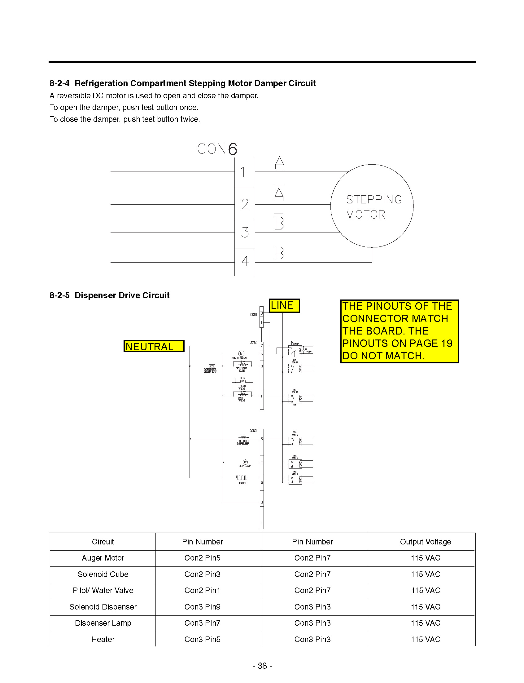

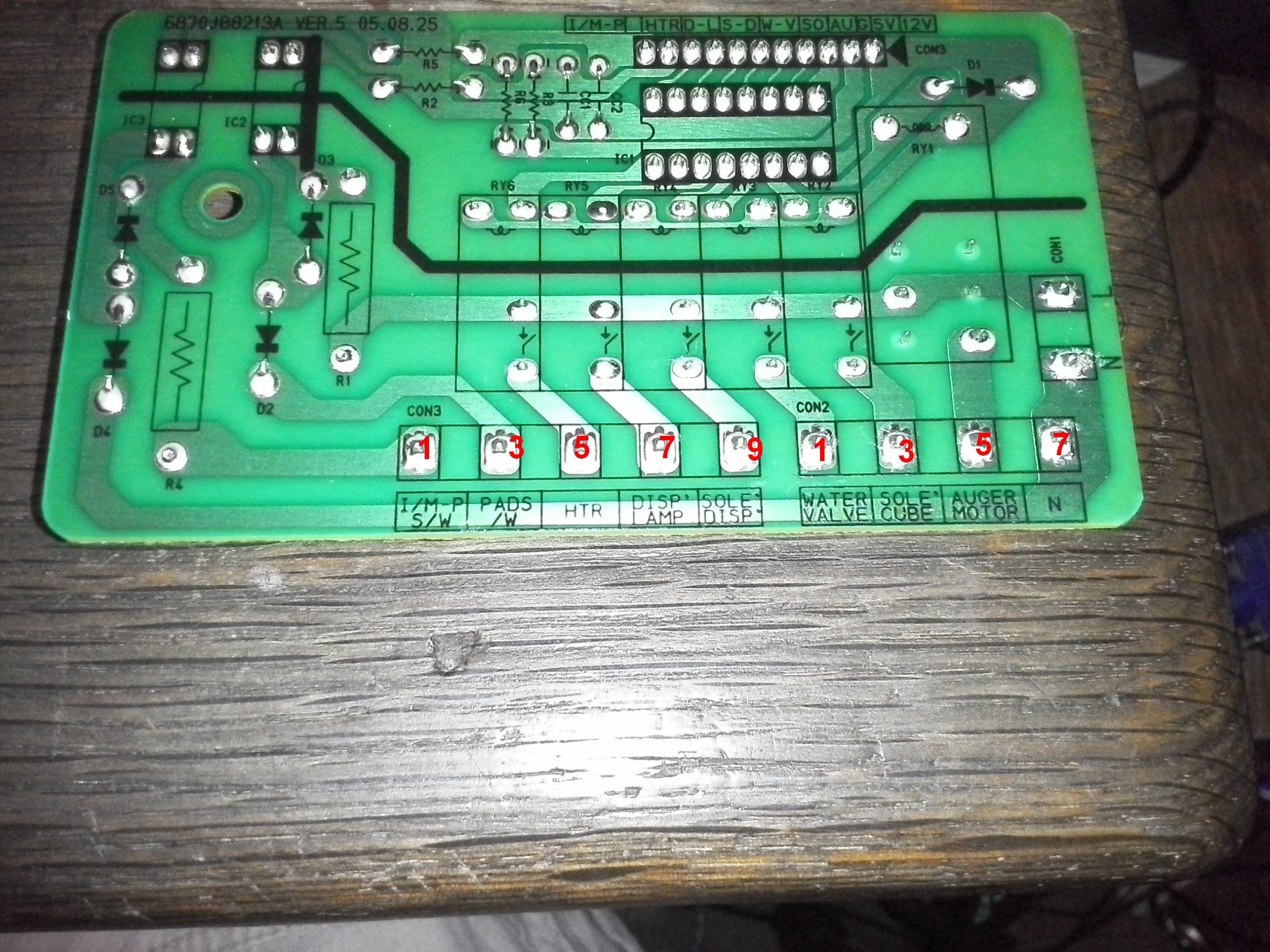

Now if you go to the diagram on page 5 of the service manual look at "PWB ASSY, DISPENSER," it's not accurate some of the connectors are reversed.
But it does wire in the same manner.
White/purple/black/skyblue/red should be on or off depending on the setting. If I select water then obviously red/black/skyblue/white should be off. I'm not sure how the dispenser door and ice water valve work, if black handles the dispenser door or if red does, because the ice water valve has red and blue wires, but a black wires goes to sole. cube on the board and blue is "N" for load/neutral/grounded conductor. I didn't get a closer look at the dispenser door, I should have.

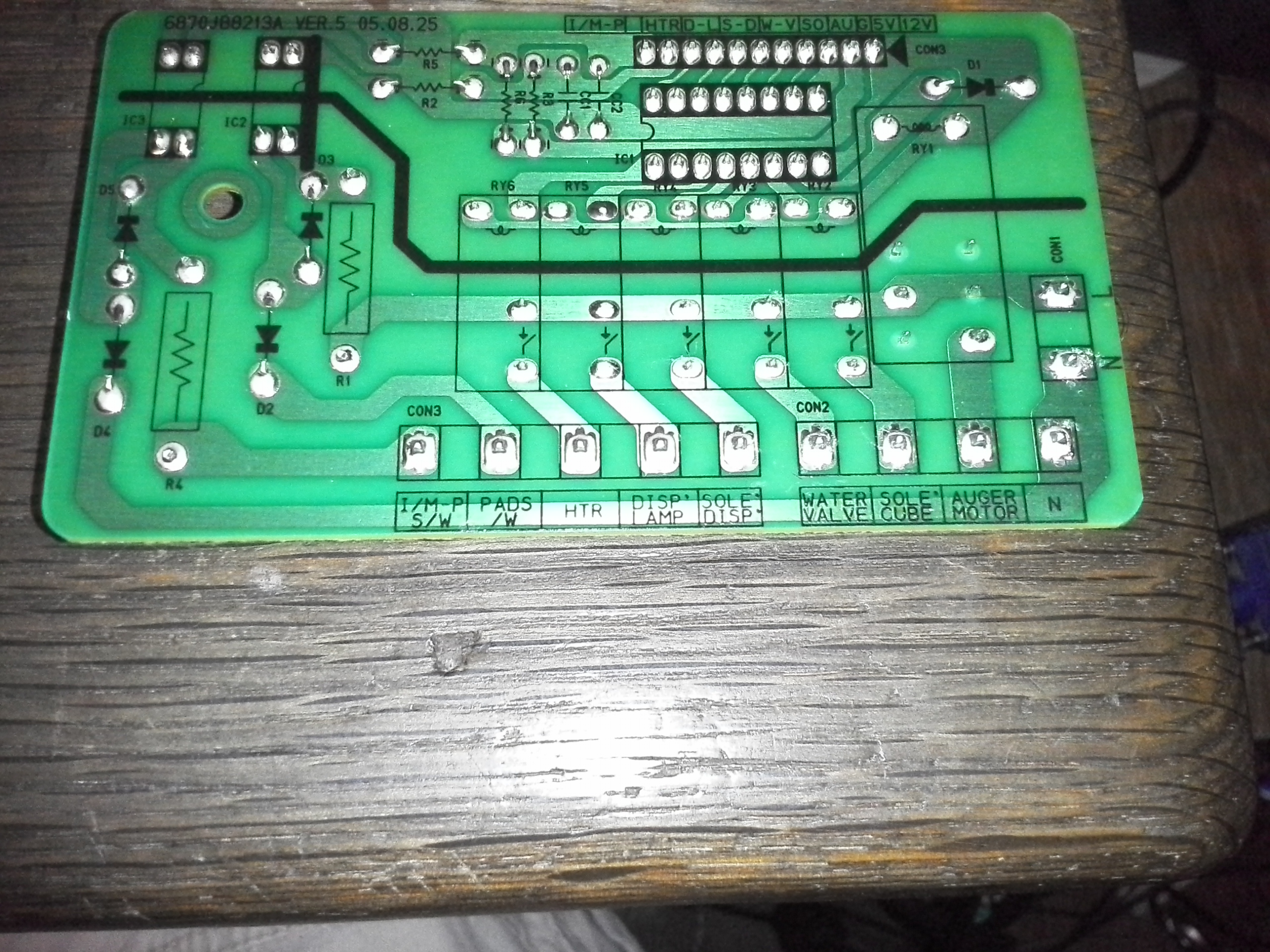

Well here's the problem, all the relays are closed except for the auger in the ice maker, when you remove power they return to their open state but apply power and all the relays close. I removed the DISPLAY assembly connection to this small board and all the relays are still closed. obviously it shouldn't be. My guess is an IC crap out. I tested the zeners and diodes then resistors which leaves two small IC (ic2 ic3), cc1 cc2 and a 7 circuit darlington transistor.
My money's on the darlington transistor.
I can smell what appears to be electronic burning odor residue, strongest around the darlington transistor.
It's KID65003AP
Am I correct to assume this is the fault?
My guess for a replacement would be one of the these?
http://www.digikey.com/product-searc...=0&pageSize=25

The display on the fridge was still working, the micro switch on the dispenser tested good, but it was intermittent dispensing water.
Mostly actually it was not. Really weird. Sometimes it would dispense water and ice with the right fridge door open, but not when closed.
