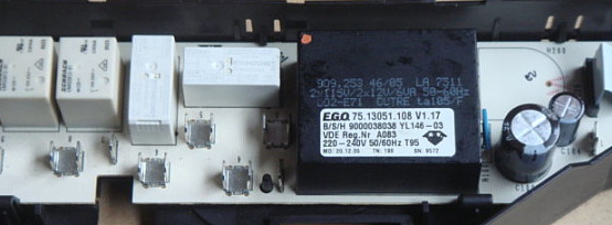

    hi in ceramic oven the transformer is damaged
    and writes
    2x115v/2x12v/6VA 50-60hz ta105/f
    can you suggest me a compatible transformer ;
    i have found in 70 degrees celsius do you think is suitable for ceramic oven ;

        Re: dead transformer on ceramic oven
        yes right
        is connected in series 230 volt power supply and the output has 2 x 12 volt ac
        and hat to connected 0 of first coil connected to 12volt to second coil and to ac pin of bridge rectifier
        and the 12 volt of the first coil connected to 0 volt of secondary coil and goes to the other ac pin of bridge rectifier and eac coil must be 3va 250 ma fuse
        so accordingly the above connection the bridge has 24 v ac input ; i ask because i am thinking to test the pcb with an external power supplu just to be sure
        but the temperature enviroment is 105 degree celsius because writes 105ta/f
        all the transformers i have found until now is ta 70 degrees
        furthermore the transforer is solder on pcb so i have to find a transformer with the same pins to solder on the pcb
        the device is ceramic oven
          105/70C is the temperature the thermal fuse inside the transformer burns at. I doubt the PCB reaches anywhere near 70C as there must be some capacitors on it as well. I would say go ahead with the transformer with 70C fuse If all other parmeters match.

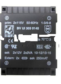

            and why the specific transformer sir writes ta105/f
            and all the other that i can find from datasheets writes ta70;

                  This transformer is ta105/F Fahrenheit which would be 40C (many have this 40c rating)
                  The HAHN transformer is ta70/C/B Celsius maximum ambient temperature 70°C, thermal class of insulation B (130°C)
                  If the pins match it should be ok.
                  There are many suppliers of this type of transformer from different manufacturers

                    so in your opinion its better to choose transformer with temperature
                    ta 40 degrees as the original or 70 degrees like this on the foto ?

                          The original transformer was rated 40C, and that should be all that is required, but if you want to install a 70C that will be fine as well, I doubt the area for the power supply gets that hot.

                            thanks a lot sir finaly i look for transformer with ta 40 celsius like the original and not for 70 celsius
                            because i am thinking if something go wrong as about as the temperature to break the thermal fuse of the transformer to be sure for the worst case e.g fire
