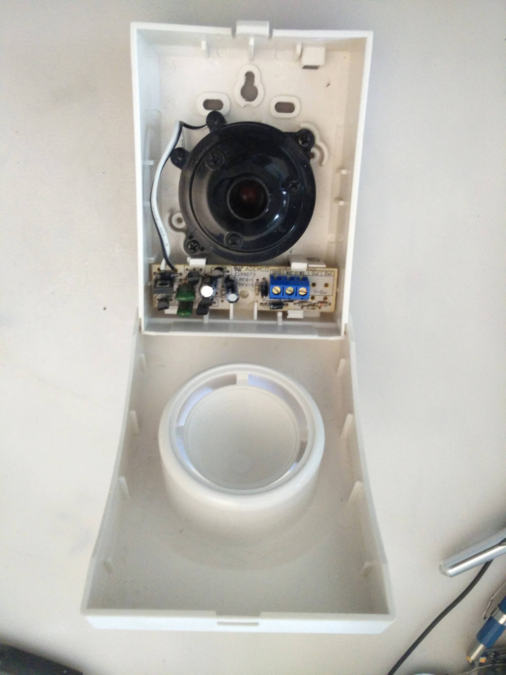

    My garage alarm siren was sounding a bit quiet and the tone was weird, like mixed with another tone.

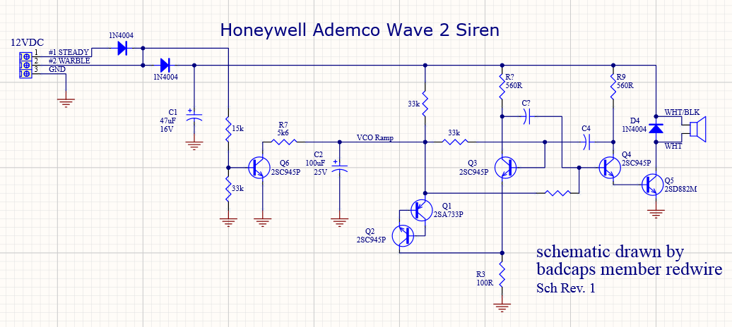

    Powered up it draws about 14V 300mA with a spike to ~1A briefly during the low pitch yelp, seems normal.

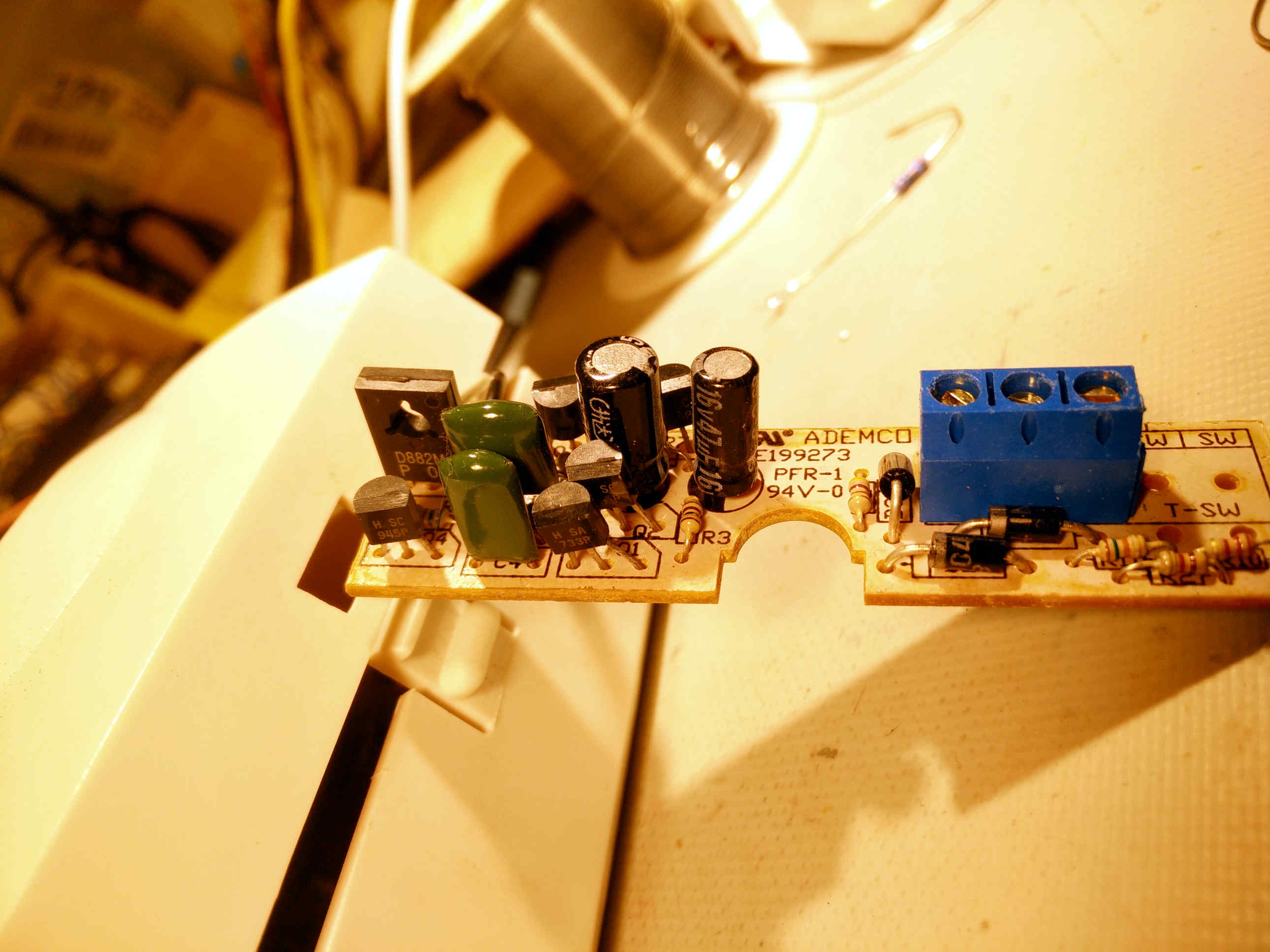

    Teardown reveals only two electrolytic capacitors inside, so I replaced them. 100uF 25V for the warble ramp, and 47uF 16V for decoupling.
    The old ones tested OK sort of? - 100uF reads 68uF (-32%) ESR 0.80Ω, and 47uF reads 41uF ESR 0.87Ω as well so it was a bit confusing if the caps were to blame.
    The tone caps are green film caps I left alone. Newer versions of this siren are more SMT but the same 6-transistor circuit I think.
    I checked drive voltage from the alarm control board and it's good.
    Afterwards, the siren is loud and not making the strange whimpy tones.
    I did a schematic for the siren as well, it seems to use a SCR out of 2 transistors for the ramp i.e. cap charges pitch goes up, SCR fires and discharges and it repeats. The main tone osc and VCO is a two transistor multivibrator.

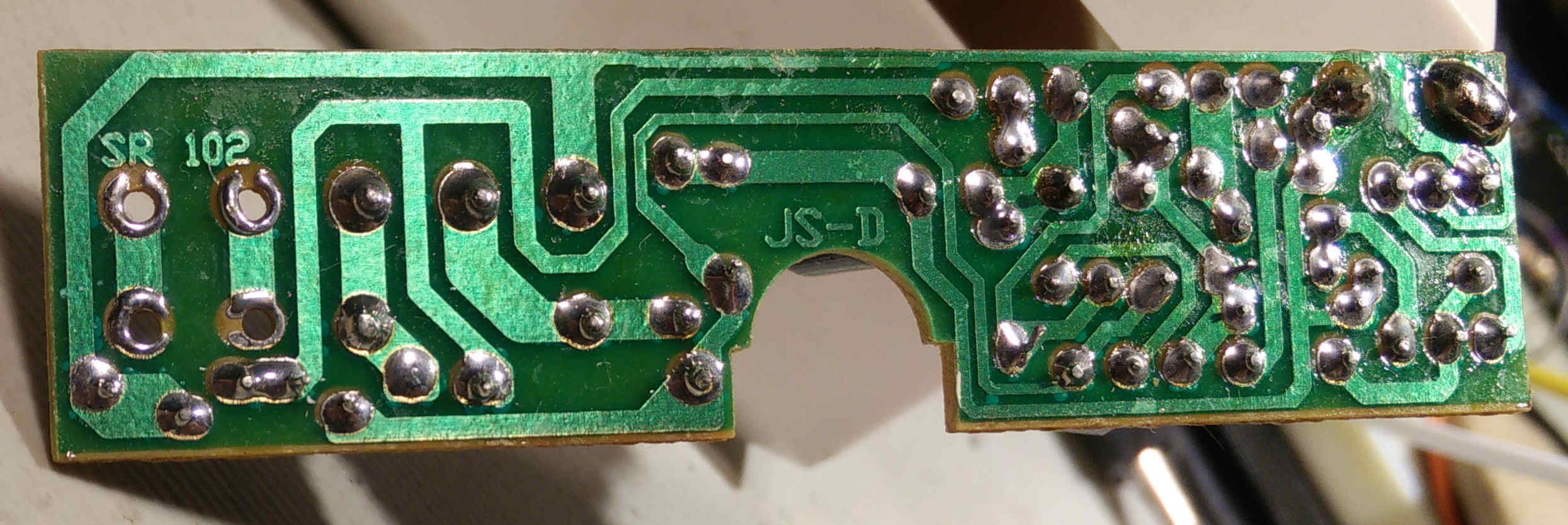

    broken solder joints all over that board.
    not surprising with the speaker so close

      Well, just for you I climbed back up and brought the unit down, back to the workbench. I had resoldered (after that pic) a few things but wondered if I missed one. It's whole life probably runs a few minutes per year. These things are mission critical nowadays.
      The solder joints are shiny, no signs of fracture yet there are a few rings and many pins not wet. So the solder is fully around the pin but not sticking to it. I usually see that with crappy solder that looks dull finish, or wave soldering that jiggles or moved during cool-down.
      I desoldered and resoldered all parts a few times as needed. The solder is lead-tin, rosin flux yet still not working well. This was more hassle than I'm used to, so I looked and the problem is the PC board hole sizes are basically huge so the solder has too much surface tension and doesn't wet to a pin.
      After a lot of work, I resoldered everything and did another test OK. We'll see how it does.

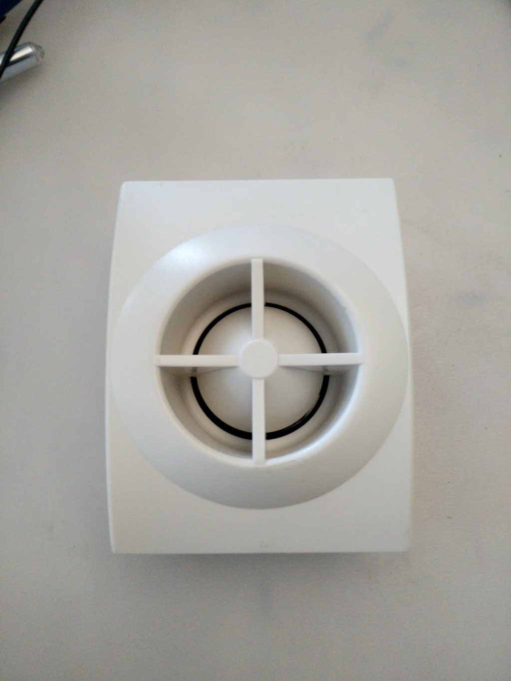

      The speaker doesn't vibrate that much, it's a small bullet horn driver and there's a patent about it.
      You can also use the siren board to drive an external big horn speaker.

        it could also be the mylar caps.

          That reminded me on the Algo Duet I repaired a while back. It uses an IC to do the warbling. https://www.badcaps.net/forum/showthread.php?t=112675
          Yes, I did see a few solder joints on your board that looks in the picture that there are some cold solder joints.
