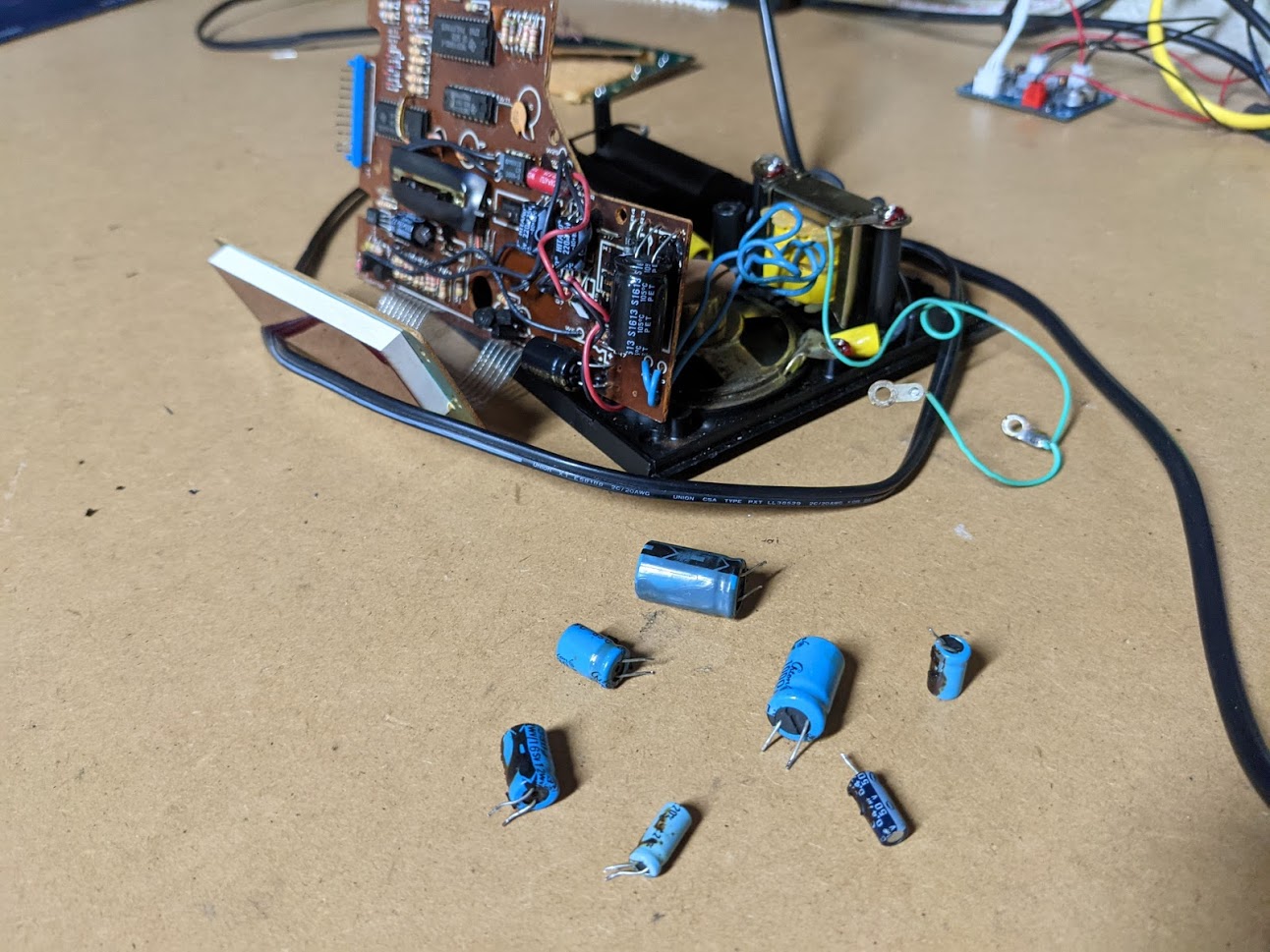

    My grandfather had this Micronta VoxClock3 digital alarm clock that just had random digits displayed when you plugged it in and just overall acted crazy. Opened her up last night and found every single cap either completely open or ESR in the 50 ohm range. All caps replaced but waiting on a .47uf 50v cap to arrive as I didn't have any.

    .47? use a polyester cap - 470n

      I don't have any of those lying around either. Need to invest in a polyester assortment.

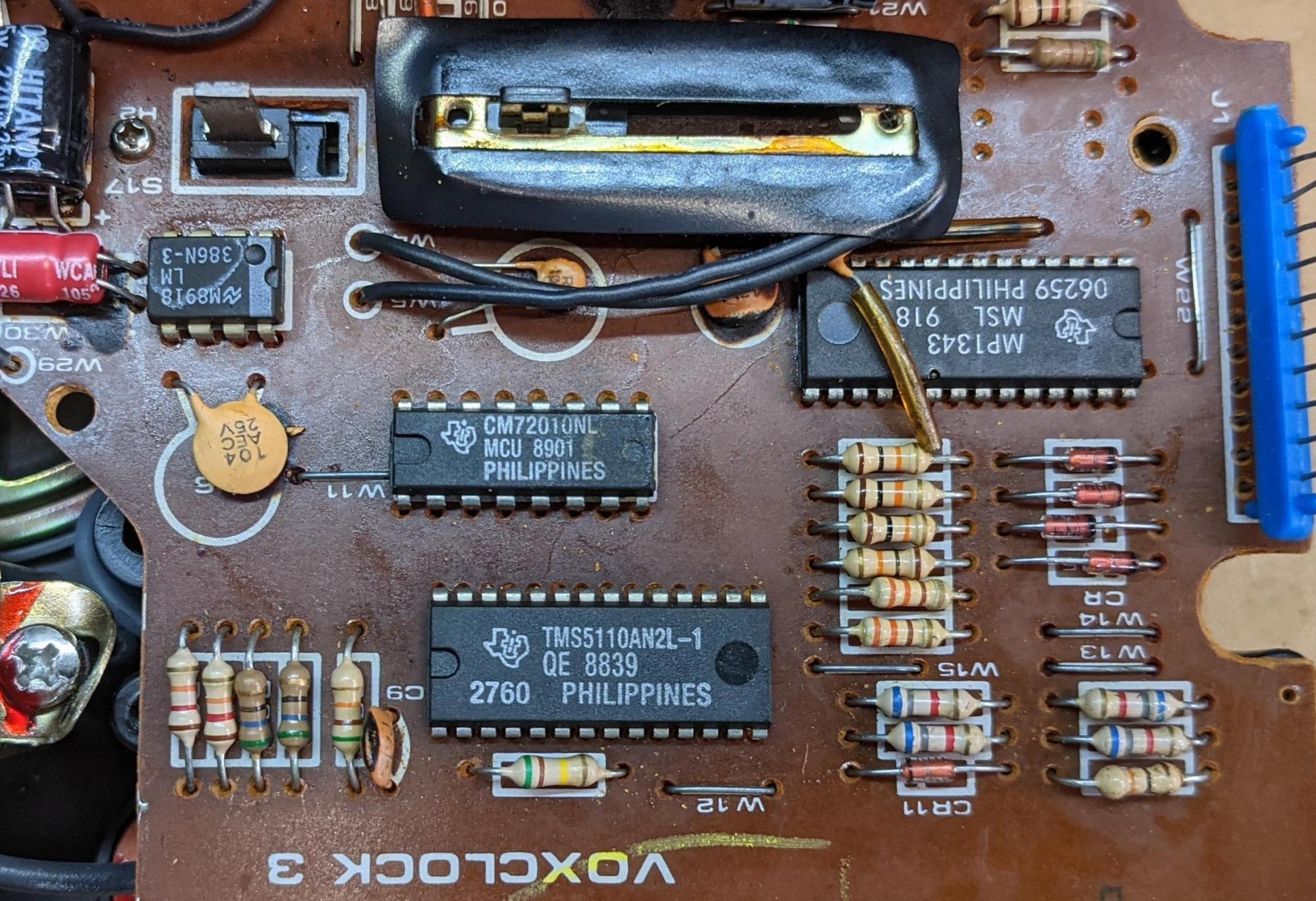

        well even 1uf electrolytic caps are being phased out because film caps are small enough to replace them.
        what chips are in that clock?
        spo250? spo256? texas tms5110??

          My pic is out of focus, I'll check soon

            Here you go. Probably late 80's early 90's by the date codes on chips.

                  TMS5110 speech synthesizer was in TI Speak & Spell, it used LPC linear-predictive coding. I think it had better speech quality than SPO256 allophones.
                  It looks like it could use a 1-bit or 4-bit databus to read ROMs. One IC must be the main MCU and another ROM.
                  TMS5110AN2L-1
                  MP1343
                  CM72010NL
                    • 31304
                    Re: Micronta Talking Alarm Clock Full Recap
                    it uses a custom databus for the roms - there are replacement projects online.

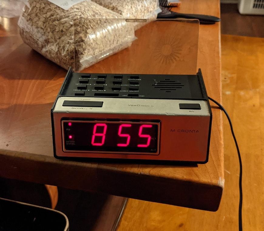

                      Got the new .47 cap today and installed. Powered up without the daughter board even being re-soldered back in and it's working great! good crisp digits, no funny business. I'll post later on once I have it fully back together.

                        All done, working great.

                            i like the colour, that's done using red leds behind a purple filter isnt it?

                              In the 80's many red LED displays were behind a purple filter. I think it works much better for contrast (compared to red).
