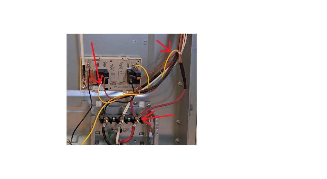

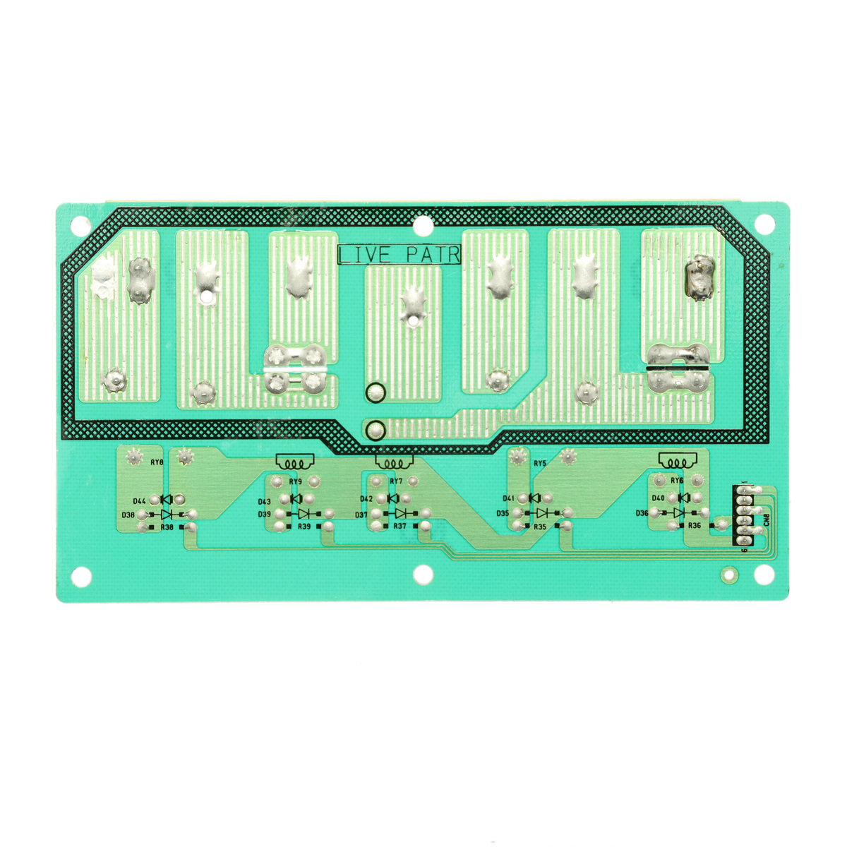

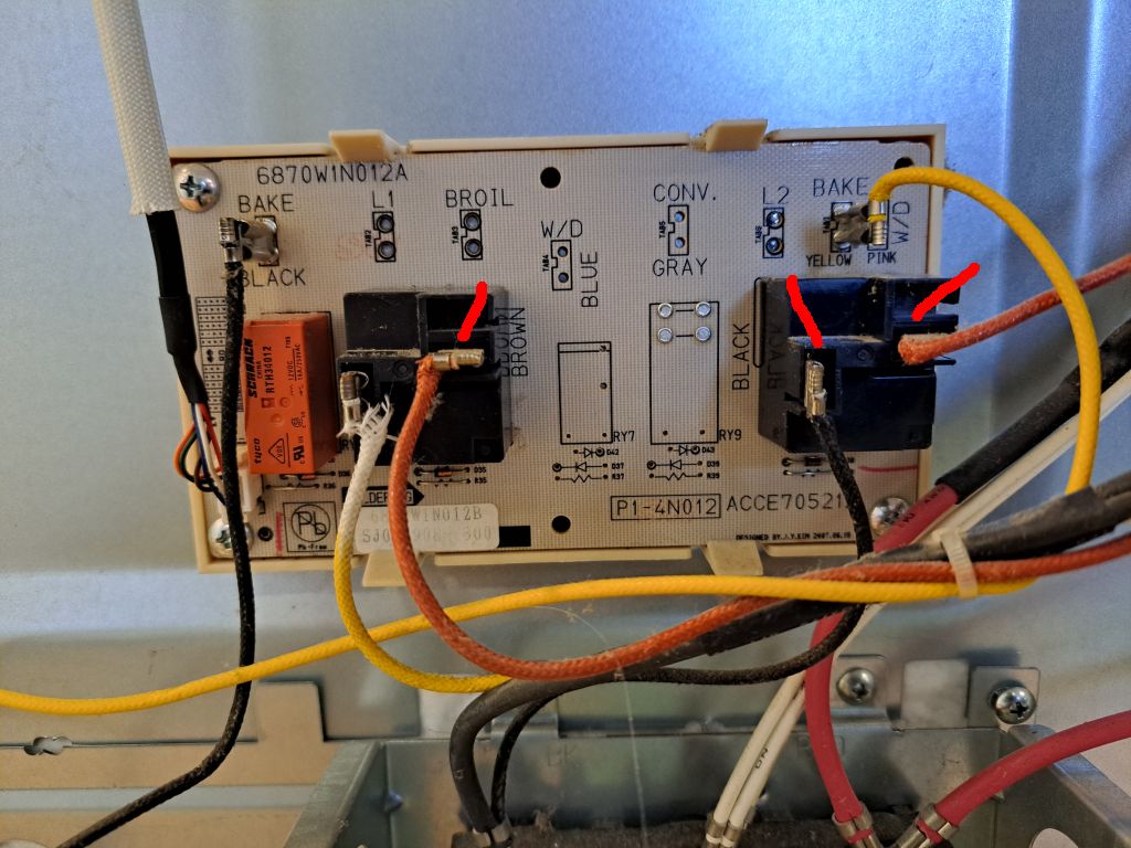

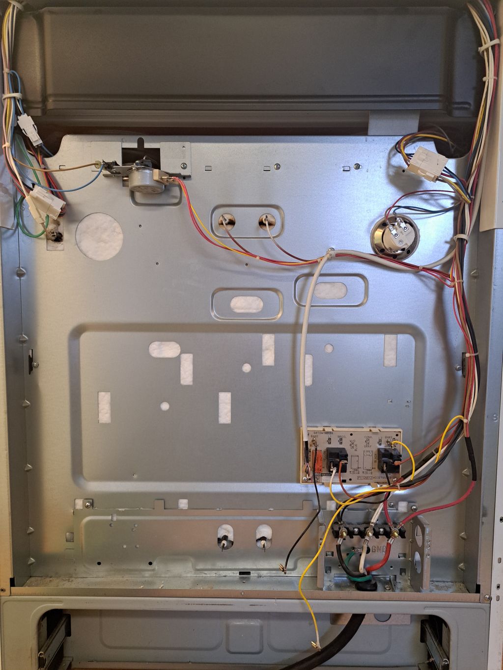

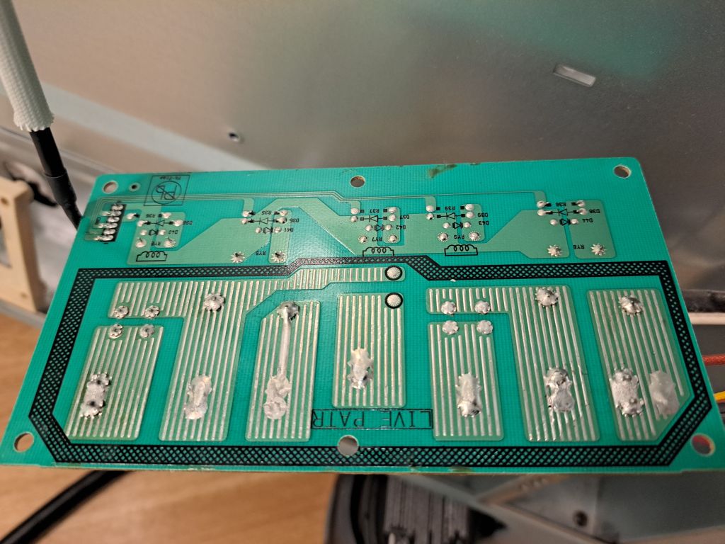

LG LST5651SW stove: oven not heating properly
  • Curious808
    • May 2022
    • 39
    LG LST5651SW stove: oven not heating properly
    LG LST5651SW stove: The oven has a hidden bottom (bake) element that seems not to be heating up, but tests OK.
    PROBLEM DESCRIPTION: Set oven to 400. The display shows it heating up normally to about 365, and stops there. The top (broil) element is visible and heated. Can't see the bottom element, but the bottom of the oven isn't extremely hot. A wet cloth on the bottom doesn't sizzle and doesn't really heat up. The stovetop burners seem to be working fine.
    TESTING SO FAR:
    1) Removed the back panel and leads to the bottom element. Using multimeter, continuity test is positive (continuous tone). Ohm test reads about 16.5 ohms; the product sheet says it should be 17 ohms.
    2) Removed the sensor for testing. Plug openings too small to fit multimeter probes, so inserted wires into the back of the plug where the sensor wires go in. No continuity tone, but ohm reading is 1,100; product sheets says it should be 1,090.
    It seems the bottom element is not heating, but is OK. Not sure why the sensory continuity test fails, but the ohm reading seems OK.
    Any idea what to do next? Thanks!
  • CapLeaker
    Leaking Member
    • Dec 2014
    • 8352
    Re: LG LST5651SW stove: oven not heating properly
    What were the oven settings during the test? The bottom element only comes on in the bake and convect bake function.
      • 31294
      Re: LG LST5651SW stove: oven not heating properly
      you metered the element cold, it could go open as it heats.
      put a high wattage lamp in series with it to see if it draws current continuously
      or use a clamp-meter
      • Curious808
        • May 2022
        • 39
        Re: LG LST5651SW stove: oven not heating properly
        Originally posted by stj
        you metered the element cold, it could go open as it heats.
        put a high wattage lamp in series with it to see if it draws current continuously
        or use a clamp-meter
        I don't have either of those. Is there another way to check?
        I haven't actually removed the element, only disconnected the wires. Would I be able to get a more useful reading if I plugged it back in and turned on the oven for a few minutes before testing? Or if I removed the element, would it likely show physical damage?
        • petehall347
          • Jan 2015
          • 4450
          • United Kingdom
          Re: LG LST5651SW stove: oven not heating properly
          you could check the voltage is getting to it
          • Curious808
            • May 2022
            • 39
            Re: LG LST5651SW stove: oven not heating properly
            I removed the element. There's no damage, corrosion, anything like that. It looks perfect. There's no visible damage and the resistance is to spec -- does that mean that it's fine?
            Last edited by Curious808; 01-07-2023, 06:24 PM.
            • R_J
              • Jun 2012
              • 9625
              Re: LG LST5651SW stove: oven not heating properly
              It looks like there is a oven relay control board in this stove, I would check the relay solder connections, then check the relay operation.
              • redwire
                • Dec 2010
                • 3912
                Re: LG LST5651SW stove: oven not heating properly
                LG LST5651SW Parts with 6871W1N012B oven relay board like https://www.reliableparts.ca/product/inv_16906185
                You should be able to hear the relay clunk, or swap the wire with the bake/broil heating element.
                edit: weird the board shows no "BROIL" spade terminal, even the 6871W1N012A with extra relays doesn't show it.
                I would do a visual for bad solder joints on the relay board, including the connector to the (other) oven control board.
                Last edited by redwire; 01-07-2023, 08:44 PM.
                • Curious808
                  • May 2022
                  • 39
                  Re: LG LST5651SW stove: oven not heating properly
                  More info:
                  No error code shows on the display. On the product sheet, there's an error code table, with "F7 Main oven heating error" that covers both oven heating elements, sensor, and PCB.
                  It seems to get up to around 365 and stops. I'd been setting it to 400 450 to test. Now I set it at 300. When it gets to 300 and the preheat complete alert -- beeping and flashing oven light -- goes off as normal.
                  • redwire
                    • Dec 2010
                    • 3912
                    Re: LG LST5651SW stove: oven not heating properly
                    It sounds like there's simply not enough heat to get the oven past 365° with only the broil element puttin' out.
                    As was mentioned, the bake heating element (or relay circuit) could be going bad, open-circuit when it's hot.
                    You're going to have to troubleshoot it. I could not find the LG service manual which has a test mode and wiring diagram to make repair easier.
                    Post pics of the relay board backside, I suspect a intermittent connection to the bake heating element or a bad relay.
                    The temp sensor if bad will show the wrong temperature or an error code. It looks fine. A multimeter continuity test is for wires and connections, readings under 100 ohms beep so it's normal for a thermistor to fail a continuity test at 1,000 ohms.
                      • 31294
                      Re: LG LST5651SW stove: oven not heating properly
                      wanna try something questionable?
                      in theory if you wrap a few turns of insulated wire around a power cable and then hook the ends to a voltmeter it will show current-flow as volts.
                      but i dont know the turns-ratio so you could get mV or you could get much higher
                      • redwire
                        • Dec 2010
                        • 3912
                        Re: LG LST5651SW stove: oven not heating properly
                        Yeah that's an old trick of seeing a millivolt voltage drop across a wire or fuse which indicates current flow. We don't know if there is power to the bake heater or current flow when the oven is hot and craps out.
                        Hey, I looked a bit more and apparently LG ovens have thermal limiters (fuse) i.e. https://www.reliableparts.ca/product...al Safety Fuse
                        OP, can you post a picture of the back wall of the oven?
                        You would be able to see one of these, or spot bad connections etc.
                        Usually a bad connection or relay contact will make heat and burn/melt things as well as a zzzzzzt sound. They can stand out.
                        edit: there was an LG recall for this stove. "The burners on the electric ranges can fail to turn off after being switched off or the temperature setting can increase unexpectedly during use, posing burn and fire hazards to consumers. To determine whether your electric range is being recalled, please follow the instructions below."
                        https://www.lgelectricrangerecall.com/
                        • R_J
                          • Jun 2012
                          • 9625
                          Re: LG LST5651SW stove: oven not heating properly
                          Most ovens will turn on both the main element and the broil element to get the oven up to temperature faster (preheat), In this case it seems that only the broil element is being tuned on to get the temp to 365, If the lower element is not operating it is either open or not receiving any voltage.
                          Locate the relay board and check it.
                            • 31294
                            Re: LG LST5651SW stove: oven not heating properly
                            Originally posted by redwire
                            Yeah that's an old trick of seeing a millivolt voltage drop across a wire or fuse which indicates current flow.
                            no, i'm talking about creating an induction coil to obtain some mV based on the current flowing into the heater
                            • Curious808
                              • May 2022
                              • 39
                              Re: LG LST5651SW stove: oven not heating properly
                              Originally posted by redwire
                              Post pics of the relay board backside, I suspect a intermittent connection to the bake heating element or a bad relay.
                              Here are photos of the back and a close-up of the relay board.
                              I marked the relay board photo with three red lines. Any combination of these test OK for continuity. Of the six connecting posts on the board, no other combinations test OK for continuity. If that means anything...
                              Please excuse my ignorance. I have pretty good common sense, but little electrical/electronics knowledge. I'm learning as I go.
                              The big sheet that was attached to the back of the stove has diagrams but doesn't mention a test mode, only instructions to test for continuity, and what the ohms reading should be for all the components.
                              How do I properly test the relay board?
                              • R_J
                                • Jun 2012
                                • 9625
                                Re: LG LST5651SW stove: oven not heating properly
                                The first thing I would do is inspect the solder side of the relay board for poor solder connections on the relays
                                Can you provide the part number off the relay?
                                Last edited by R_J; 01-08-2023, 03:52 PM.
                                • Curious808
                                  • May 2022
                                  • 39
                                  Re: LG LST5651SW stove: oven not heating properly
                                  Originally posted by R_J
                                  The first thing I would do is inspect the solder side of the relay board for poor solder connections on the relays
                                  Can you provide the part number off the relay?
                                  Is that it on top left of the board: 6870WIN12A?
                                  • R_J
                                    • Jun 2012
                                    • 9625
                                    Re: LG LST5651SW stove: oven not heating properly
                                    Originally posted by Curious808
                                    Is that it on top left of the board: 6870WIN12A?
                                    NO, on the black plastic relay itself. but I think I figured out the pinout
                                    Have you removed the board and checked the solder connections?
                                    It looks like the smaller relay (RY6) is the one that controls the bake (lower) element
                                    Does that sheet diagram show how the elements are connected to the relay board?
                                    Last edited by R_J; 01-08-2023, 04:50 PM.
                                    • Curious808
                                      • May 2022
                                      • 39
                                      Re: LG LST5651SW stove: oven not heating properly
                                      The two black plastic relays are marked Potter & Brumfield T9AS1D22-12.
                                      The solders look good to me. They are all shiny and reflective though the photo doesn't capture that. Some have a dull spot in the middle.
                                      Last edited by Curious808; 01-08-2023, 04:54 PM.
                                      • R_J
                                        • Jun 2012
                                        • 9625
                                        Re: LG LST5651SW stove: oven not heating properly
                                        The connections look ok. That leaves the relays, so either the relay contacts are burnt and not closing OR the coils are not being energized (turned on). I would suspect the smaller relay (RY6) could be bad as it connects directly to the lower element
                                        Is this wire (red arrows) all connected to the same point (red ac line in)?
                                        Last edited by R_J; 01-08-2023, 05:14 PM.
                                        • JayPoorJay
                                          A Central Air Heating Element, A PID and a Sauna
                                          by JayPoorJay
                                          What could go wrong...?
                                          I'm not sure if this is the right sub category or even the right forum but here goes,,,
                                          I'll just dive right in. I want to see if it's possible and what it would take to use a PID Controller (or 2) to run a central air conditioning heater element (the kind that goes into an air handler) and a small blower fan... The application is a DIY Sauna... Am I nuts? Mean, these components could be had for around 100 bucks.
                                          What do I need to be thinking?
                                          Of course I will go to Vevor and order one of their 200$ sauna heaters so I...
                                          01-10-2024, 02:48 PM
                                        • EasyGoing1
                                          The best way to drive a heating element?
                                          by EasyGoing1
                                          I've got this circuit that I've been playing with on a breadboard. I'm not happy with it mainly because the MOSFET gets too hot and generally controlling the temp of the heating element with the Arduino has proven to be a little more cumbersome than I would like.
                                          What I would like to know, is what is the best way to set up a circuit like this? The heating element is just a PCB and its going to be mounted under a 3D-printed enclosure that a lizard will use to warm his belly.
                                          This is the general setup that I have now.
                                          This is what the...
                                          01-25-2023, 11:29 AM
                                        • bohaboha
                                          Queen coffee CQ MN-2 Heating element
                                          by bohaboha
                                          How to test this queen coffee maker heating element...
                                          07-18-2022, 09:01 PM
                                        • flysky
                                          Gigabyte H610M S2H V2 help to identify the element.
                                          by flysky
                                          There is a motherboard Gigabyte H610M S2H V2 (DDR5), I can't find boardview
                                          Help to identify the element, marking on the element - C31PH. It stands next to the USB 3.0 and it looks like it is ESD Protect chip. We need a datasheet to this element. Maybe someone has already identified such an element. Help please.​
                                          01-23-2025, 07:21 PM
                                        • CuriousJohn
                                          Burco boiler power problem
                                          by CuriousJohn
                                          Burco BCPLSAFWM5L 5 Litre Wall Mounted Automatic Water Boiler With Filtration UK 240v
                                          Does anybody have any experience with these Burco units at all there is no record of them on the forum lol and a proper service manual would be nice. I invite you all to pesuade me not to botch repair it with a 5v relay, read on.
                                          This unit was rescued from a skip 3 years ago, the only fault it had then was no backight display (plus it wanted a new probe set and top seal) but the screen was never an issue you can still see the screen as is and I just use it to get 5 Litres of very hot...
                                          12-22-2024, 10:25 AM
