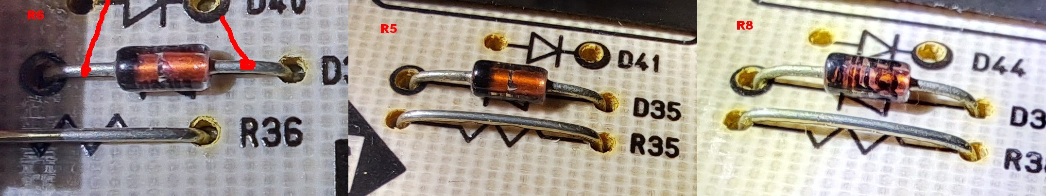

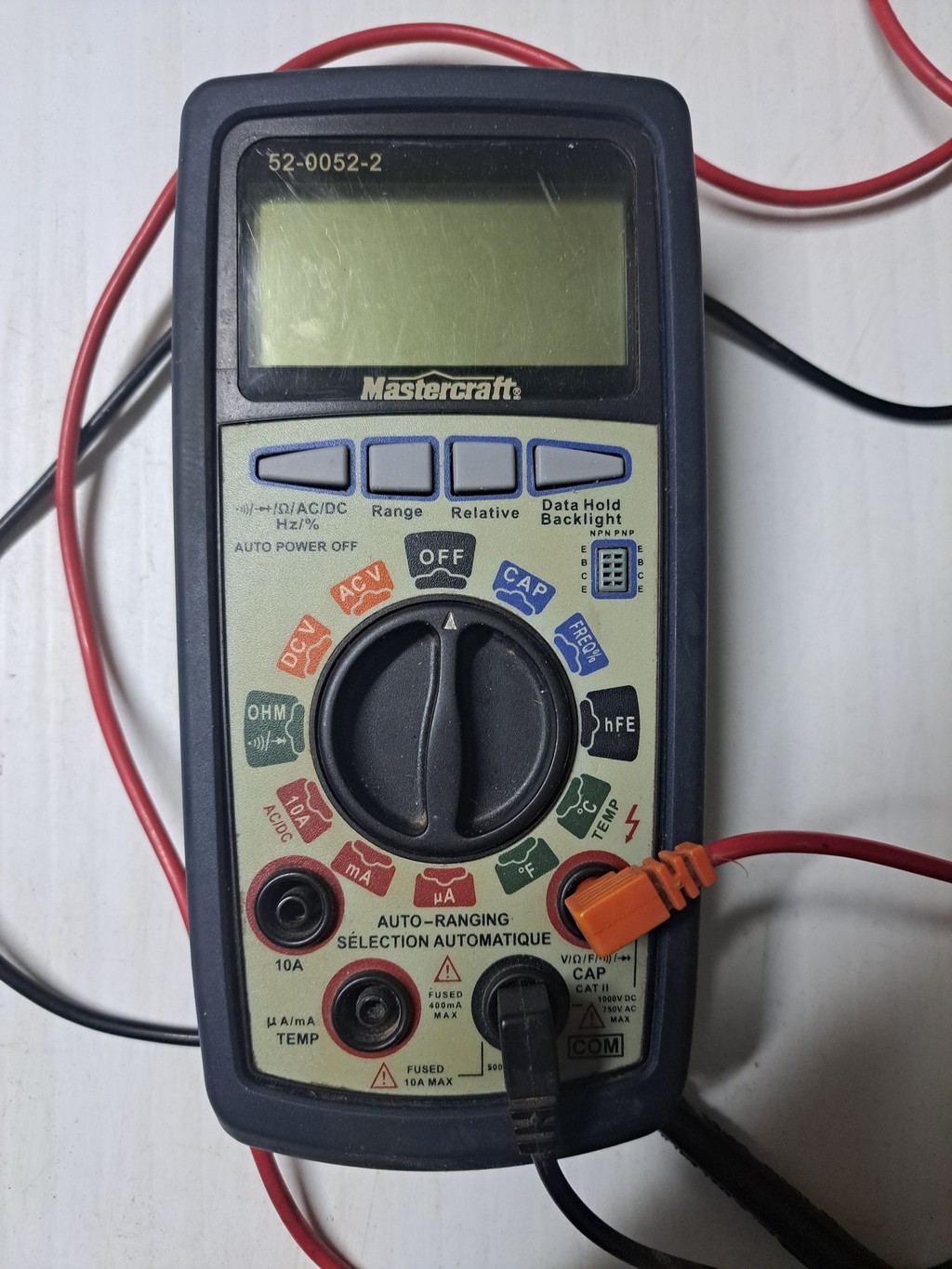

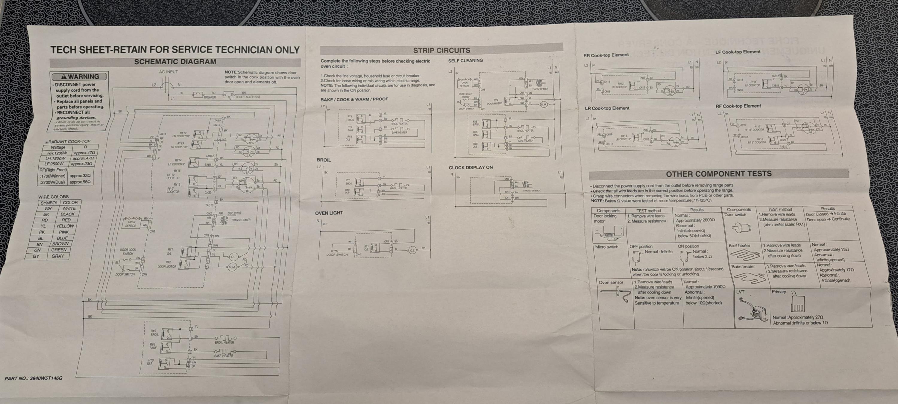

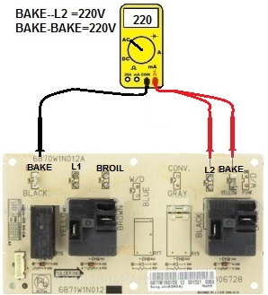

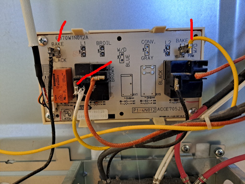

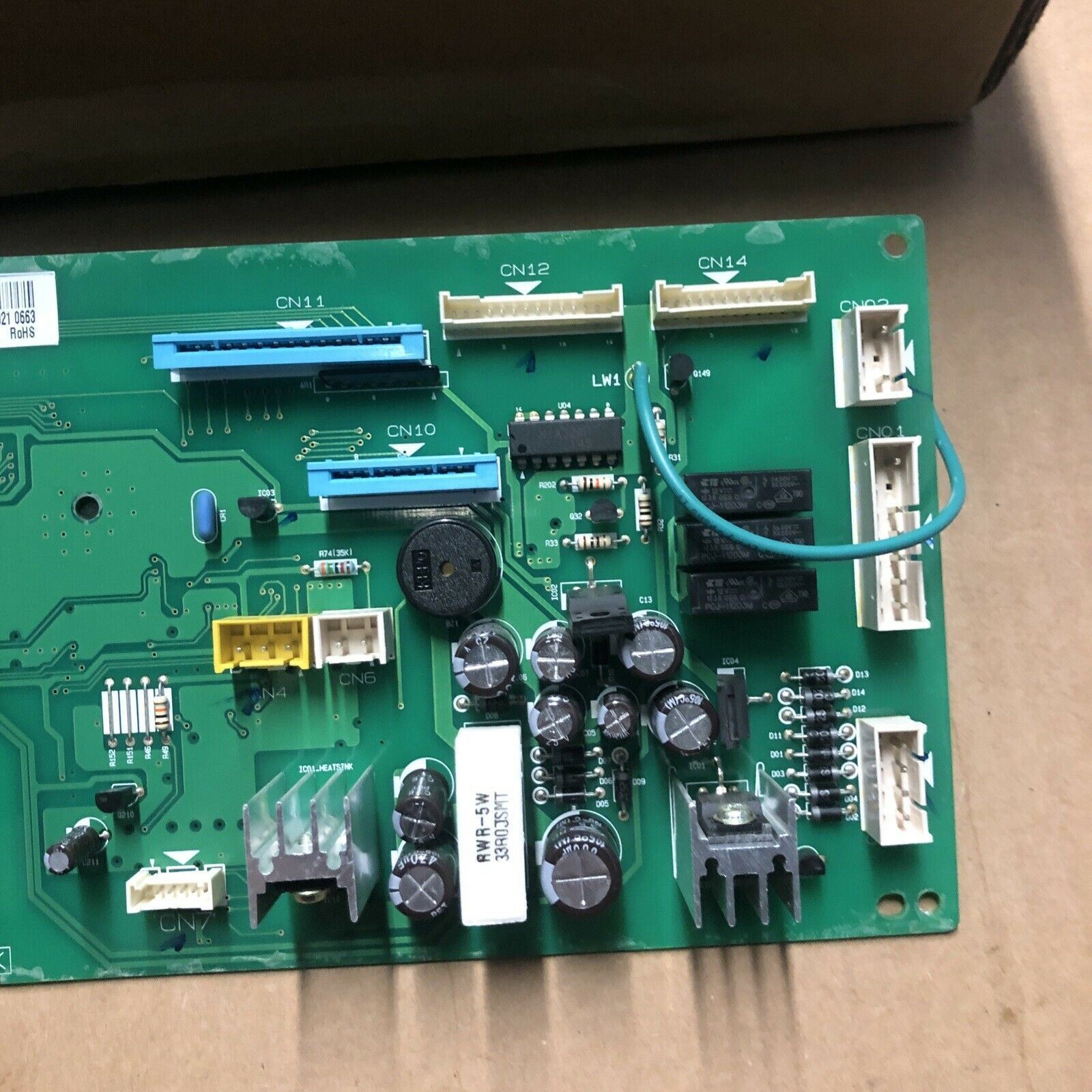

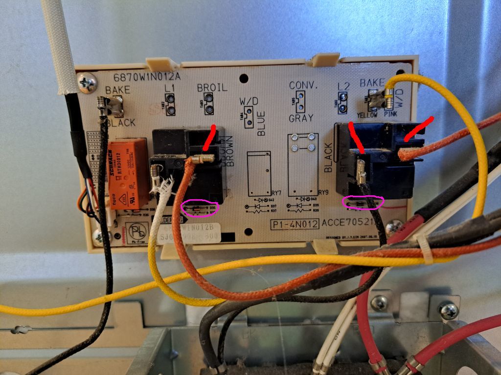

LG LST5651SW stove: oven not heating properly
  • Curious808
    • May 2022
    • 39
    Re: LG LST5651SW stove: oven not heating properly
    Here's the sheet of diagrams.
    • redwire
      • Dec 2010
      • 3912
      Re: LG LST5651SW stove: oven not heating properly
      From the pictures: Everything looks OK, board soldering has a few rough spots but no big fractures. There is no thermal safety switch in this model.
      I do see a blackened diode with splat of solder, on the relay on the right. I'd look to see if the relay spit some molten metal or what. Both diodes should look identical.
      RY6 is Bake, RY5 is Broil, RY8 DLB is the safety relay for both.
      Last edited by redwire; 01-08-2023, 05:17 PM.
      • R_J
        • Jun 2012
        • 9625
        Re: LG LST5651SW stove: oven not heating properly
        Since the top element (broil) works, I would suspect that RY6 is bad.
        It may or may not be getting told to turn on but to check that it would require working on a live oven.
        You could give the smaller relay a couple taps with a screwdriver handle and see if the bake element comes on, then you know the relay itself is bad.
        Last edited by R_J; 01-08-2023, 05:38 PM.
        • Curious808
          • May 2022
          • 39
          Re: LG LST5651SW stove: oven not heating properly
          Here's the diagram sheet.
          • Curious808
            • May 2022
            • 39
            Re: LG LST5651SW stove: oven not heating properly
            Originally posted by R_J
            Is this wire (red arrows) all connected to the same point (red ac line in)?
            Yes.
            • R_J
              • Jun 2012
              • 9625
              Re: LG LST5651SW stove: oven not heating properly
              Originally posted by Curious808
              Yes.
              I figured that after seeing the diagram but wanted to be sure.
              • Curious808
                • May 2022
                • 39
                Re: LG LST5651SW stove: oven not heating properly
                Originally posted by redwire
                I do see a blackened diode with splat of solder, on the relay on the right. I'd look to see if the relay spit some molten metal or what. Both diodes should look identical.
                One doesn't look like the others. Is this the problem?
                • R_J
                  • Jun 2012
                  • 9625
                  Re: LG LST5651SW stove: oven not heating properly
                  D38 does look a bit different but I doubt that is the problem, The only one that would cause the problem you are having (no bake element) would be if D36 was a dead short across the relay coil, causing the relay to not operate.
                  • redwire
                    • Dec 2010
                    • 3912
                    #29
                    Re: LG LST5651SW stove: oven not heating properly
                    The diodes look fine, one was black in the picture but it must be lighting.
                    I would put it back together and run the oven and make a (live) voltage measurement. Are you OK to do this? As long as the dog/kid etc. don't come running in, and your multimeter+probes are reasonably good quality.
                    I would measure the output of the relay board going to the bake heating element and confirm there is 240VAC across the wires to power the bake element. Like this:
                    "-->Set the oven to bake and check for 220 Volts AC across BAKE and L2 or DLB-OUT. The terminals are marked on the board. L1 is voltage into the board. then, depending on what's selected, bake or broil, it comes out through the relay and to one side of the element. The L2 voltage goes into the board and comes out the Double Line Break relay OUT and is common for both elements.
                    Touch one meter lead to BAKE and touch the other to L2 then BAKE. Your meter should indicate 220 Volts AC for both measurements."
                    pic taken from Jake at ApplianceBlog.com thread but no solution was posted.
                    • Curious808
                      • May 2022
                      • 39
                      #30
                      Re: LG LST5651SW stove: oven not heating properly
                      Originally posted by redwire
                      The diodes look fine, one was black in the picture but it must be lighting.
                      R8 looks broken up inside, compared to the others. That's fine?
                      Originally posted by redwire
                      I would put it back together and run the oven and make a (live) voltage measurement. Are you OK to do this? As long as the dog/kid etc. don't come running in, and your multimeter+probes are reasonably good quality.
                      Sounds ominous. I get the risk. Does this multimeter look up to the job?
                      Is it possible to continuity test the relay board first (the tech sheet says to do that)?
                      Last edited by Curious808; 01-08-2023, 07:24 PM.
                      • R_J
                        • Jun 2012
                        • 9625
                        #31
                        Re: LG LST5651SW stove: oven not heating properly
                        The meter should be fine, but PLEASE be careful, you are checking 240vac, so find a way to attach one lead, and probe with the other keeping one hand only to probe the high voltage.
                        to check the dc voltage across the diodes you can use both hands to hold each probe but again be careful.
                        If you are comfortable doing the above test, you can also check the dc voltage across each of those diodes, the voltage across the diodes would be around 12vdc, this test will confirm there is drive to each relay and if the voltage IS there, confirm a bad relay
                        Last edited by R_J; 01-08-2023, 07:30 PM.
                        • petehall347
                          • Jan 2015
                          • 4450
                          • United Kingdom
                          #32
                          Re: LG LST5651SW stove: oven not heating properly
                          i also suggest if very low or no volts to the element try disconnect the element and see if something like full voltage is there .if so there is a bad contact . possibly inside the relay .
                            • Jul 2011
                            • 6070
                            #33
                            Re: LG LST5651SW stove: oven not heating properly
                            I would check the bake relay because these relays are notorious for going bad
                            The easiest way to check them is when the bake relay is being called to be on check the terminals on the relay terminals for voltage if you have voltage a crossed the terminals then your relay has issues with it and you can do the same exact thing with the broil relay as well and compare the results
                            • Curious808
                              • May 2022
                              • 39
                              #34
                              Re: LG LST5651SW stove: oven not heating properly
                              Originally posted by redwire
                              "-->Set the oven to bake and check for 220 Volts AC across BAKE and L2 or DLB-OUT. The terminals are marked on the board. L1 is voltage into the board. then, depending on what's selected, bake or broil, it comes out through the relay and to one side of the element. The L2 voltage goes into the board and comes out the Double Line Break relay OUT and is common for both elements.
                              Touch one meter lead to BAKE and touch the other to L2 then BAKE. Your meter should indicate 220 Volts AC for both measurements."
                              Oven turned on, preheating to 350. There were several clicks over a couple of minutes. Tested several times.
                              BAKE YELLOW / BAKE BLACK 0.01 VAC
                              BROIL YELLOW / BAKE BLACK 240 VAC
                              No connector post at L2. The holes are bridged with solder.
                              L2 (holes) / BAKE BLACK 0.05 VAC
                              The photo shows what was tested.
                              Last edited by Curious808; 01-09-2023, 02:37 PM.
                              • R_J
                                • Jun 2012
                                • 9625
                                #35
                                Re: LG LST5651SW stove: oven not heating properly
                                Replace the orange relay RY6, as long as it is being told to close (12vdc across coil) the contacts are open.
                                Looks like Digikey pt# PB2478-ND, P & B # 1-14155369 (RTH34012WG) SPST-NO (1Form A) 16A
                                Last edited by R_J; 01-09-2023, 04:55 PM.
                                • Curious808
                                  • May 2022
                                  • 39
                                  #36
                                  Re: LG LST5651SW stove: oven not heating properly
                                  Tested the diodes. Not sure if that's how, but touched probes to lead wires on either side (see photo).
                                  Set oven to 350, preheat started.
                                  R6 0.0 VDC
                                  R5 13.5 VDC
                                  R8 13.5 VDC
                                  Tested 3-4 times each.
                                  (Thanks for the help, and sorry if it's taking so long. First time doing most of this, so taking it slow.)
                                  • R_J
                                    • Jun 2012
                                    • 9625
                                    #37
                                    Re: LG LST5651SW stove: oven not heating properly
                                    Now this is why I asked about the coil voltage, R6 (RY6) it has no voltage, so the coil is not energized, so this relay will not close, so it looks like the problem is somewhere else, It looks like the wire for that relay is pin4 of CN8.
                                    So check the wires and that plugs connections, if they are ok, trace that 6 wire cable, it likely goes to the main controller.
                                    Looks like that cable connects to CN7 on the main controller
                                    Last edited by R_J; 01-09-2023, 06:09 PM.
                                    • Curious808
                                      • May 2022
                                      • 39
                                      #38
                                      Re: LG LST5651SW stove: oven not heating properly
                                      Originally posted by R_J
                                      Now this is why I asked about the coil voltage, R6 (RY6) it has no voltage, so the coil is not energized, so this relay will not close, so it looks like the problem is somewhere else, It looks like the wire for that relay is pin4 of CN8.
                                      So check the wires and that plugs connections, if they are ok, trace that 6 wire cable, it likely goes to the main controller.
                                      Looks like that cable connects to CN7 on the main controller
                                      Sorry, not clear. Does that mean that the whole relay board is fine, and the problem is elsewhere?
                                      • redwire
                                        • Dec 2010
                                        • 3912
                                        #39
                                        Re: LG LST5651SW stove: oven not heating properly
                                        I'd say yes, the oven relay board looks OK and the problem is upstream. That means a little scream and then pulling the control board out. Or first taking clear pictures of the control board in the area that goes to the little cable that goes down to the relay board.
                                        There is power to the oven relay board, Broil and DLB relay have coil power, but zilch for the Bake relay coil. That means troubleshoot the command signal to turn on the bake heater relay. This comes from the control board I believe.
                                        It's worth the patience to troubleshoot, at least down to the board level because it's gets expensive otherwise. Hang in there. This is fun. So much fun.
                                        • redwire
                                          • Dec 2010
                                          • 3912
                                          #40
                                          Re: LG LST5651SW stove: oven not heating properly
                                          Trying to find the LG service manual for the LST5651 and I couldn't find anything. So, looking for its EBR74632606 Oven Control Board PCB Assembly, I find the same board is also used in American model number LSB5682.
                                          I did find that service manual, give it a looksee and I think it can help, it has a few extra options that might not be the same as your stove.
                                          So it seems to have no test modes, the service manual advice is replace the temp sensor, then the relay board, then the control board. OUCH that's crazy expensive.
                                          Next would be to remove the control board and post pictures here. LG does have low quality soldering so hopefully that's all we have to look for.
                                          • JayPoorJay
                                            A Central Air Heating Element, A PID and a Sauna
                                            by JayPoorJay
                                            What could go wrong...?
                                            I'm not sure if this is the right sub category or even the right forum but here goes,,,
                                            I'll just dive right in. I want to see if it's possible and what it would take to use a PID Controller (or 2) to run a central air conditioning heater element (the kind that goes into an air handler) and a small blower fan... The application is a DIY Sauna... Am I nuts? Mean, these components could be had for around 100 bucks.
                                            What do I need to be thinking?
                                            Of course I will go to Vevor and order one of their 200$ sauna heaters so I...
                                            01-10-2024, 02:48 PM
                                          • EasyGoing1
                                            The best way to drive a heating element?
                                            by EasyGoing1
                                            I've got this circuit that I've been playing with on a breadboard. I'm not happy with it mainly because the MOSFET gets too hot and generally controlling the temp of the heating element with the Arduino has proven to be a little more cumbersome than I would like.
                                            What I would like to know, is what is the best way to set up a circuit like this? The heating element is just a PCB and its going to be mounted under a 3D-printed enclosure that a lizard will use to warm his belly.
                                            This is the general setup that I have now.
                                            This is what the...
                                            01-25-2023, 11:29 AM
                                          • bohaboha
                                            Queen coffee CQ MN-2 Heating element
                                            by bohaboha
                                            How to test this queen coffee maker heating element...
                                            07-18-2022, 09:01 PM
                                          • flysky
                                            Gigabyte H610M S2H V2 help to identify the element.
                                            by flysky
                                            There is a motherboard Gigabyte H610M S2H V2 (DDR5), I can't find boardview
                                            Help to identify the element, marking on the element - C31PH. It stands next to the USB 3.0 and it looks like it is ESD Protect chip. We need a datasheet to this element. Maybe someone has already identified such an element. Help please.​
                                            01-23-2025, 07:21 PM
                                          • CuriousJohn
                                            Burco boiler power problem
                                            by CuriousJohn
                                            Burco BCPLSAFWM5L 5 Litre Wall Mounted Automatic Water Boiler With Filtration UK 240v
                                            Does anybody have any experience with these Burco units at all there is no record of them on the forum lol and a proper service manual would be nice. I invite you all to pesuade me not to botch repair it with a 5v relay, read on.
                                            This unit was rescued from a skip 3 years ago, the only fault it had then was no backight display (plus it wanted a new probe set and top seal) but the screen was never an issue you can still see the screen as is and I just use it to get 5 Litres of very hot...
                                            12-22-2024, 10:25 AM
