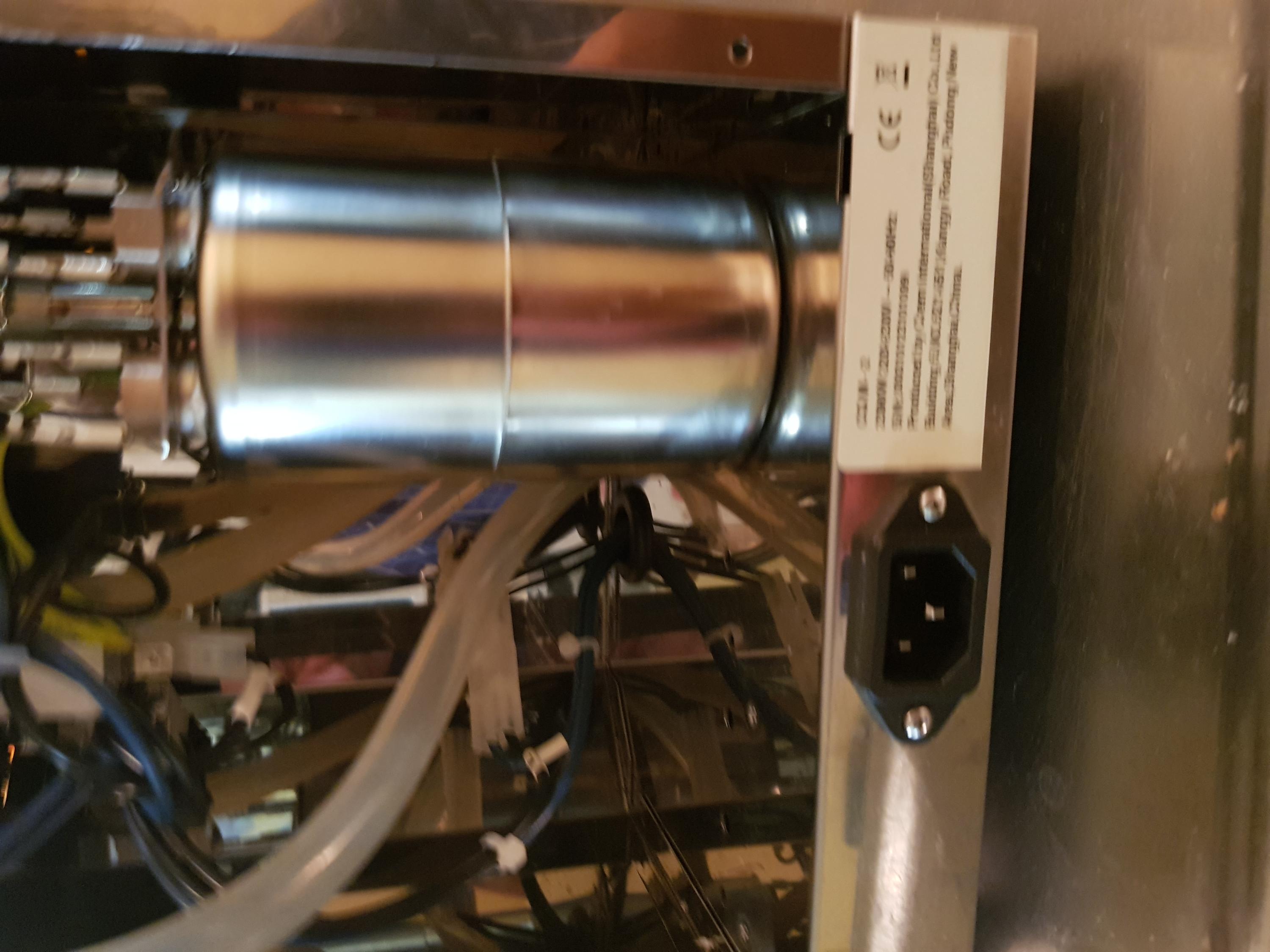

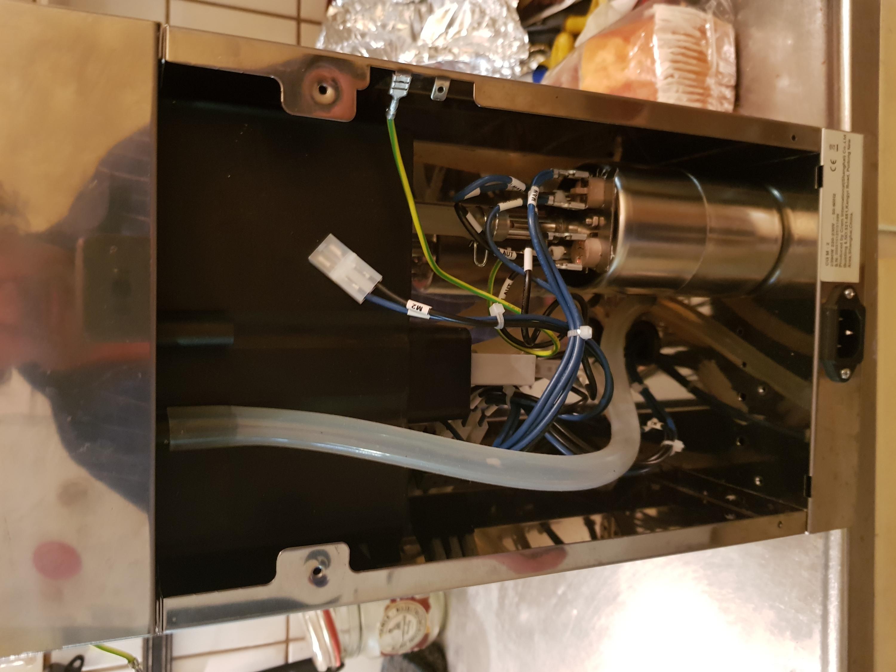

    How to test this queen coffee maker heating element
  • redwire
    • Dec 2010
    • 3912

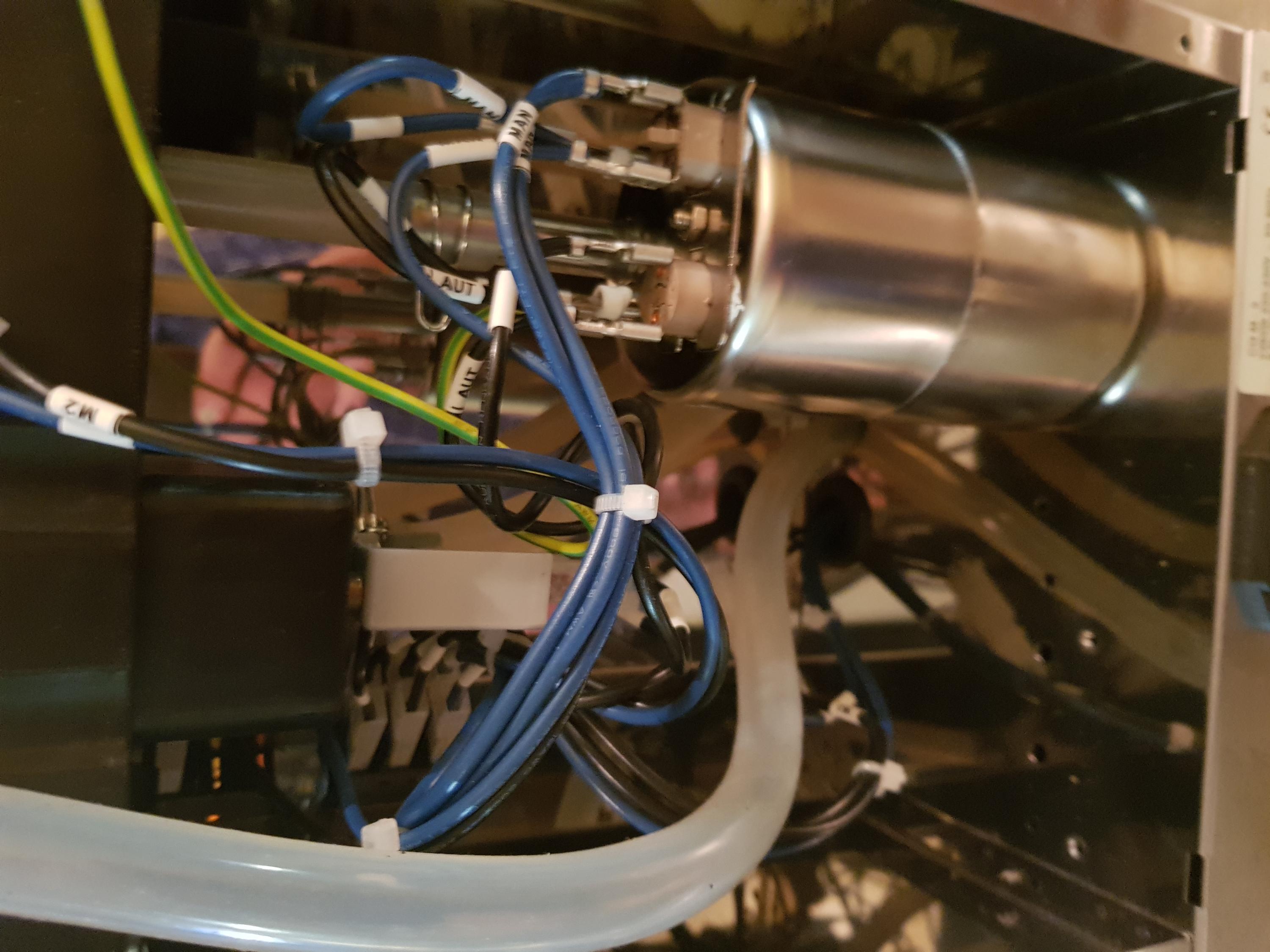

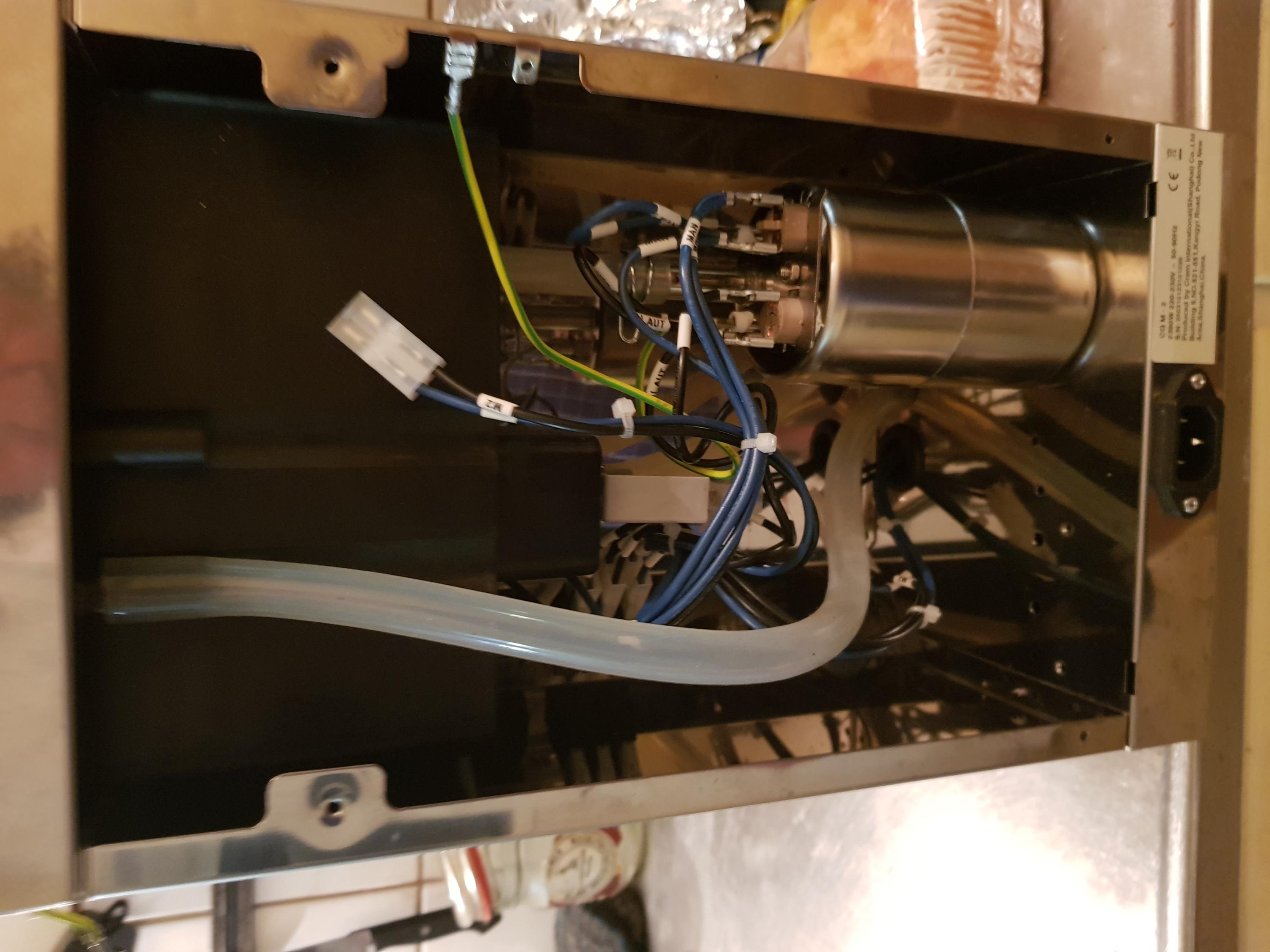

    Re: Queen coffee CQ MN-2 Heating element
    The heater connections are at the back of the can.
    The front of the can has what looks like two thermal switches. One is for temperature regulation and the other is a safety-limit (klixon). I might be wrong because I don't know the difference between AUTO/MANUAL operation of the heater, maybe it has two running temperatures.
    I would measure resistance across the heating element, and to the can housing to see if the heater is not open-circuit or shorting to ground.
    The two thermal switches should be normally-closed I think. The one on the right might have a reset button you can see, try push it down. But if it tripped then the left one is for temperature regulation and might be stuck on, so another problem.

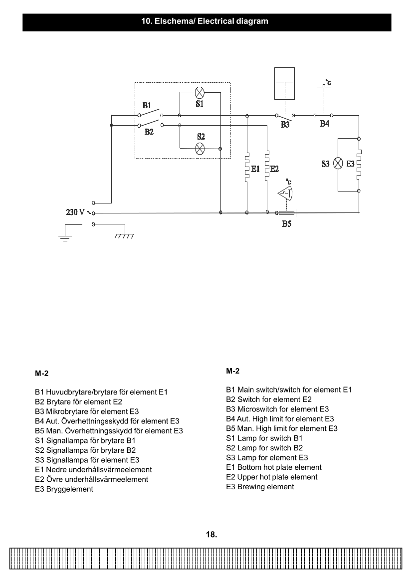

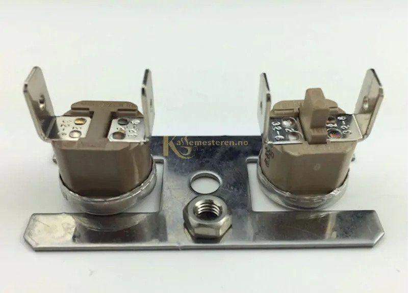

          B5 high limit switch has a manual reset but the schematic symbols are a bit beyond what I've seen.
          Cream Coffee Queen boiler/thermostat part no. 160212-03 is one big assembly.
          Pic you see the two switches.

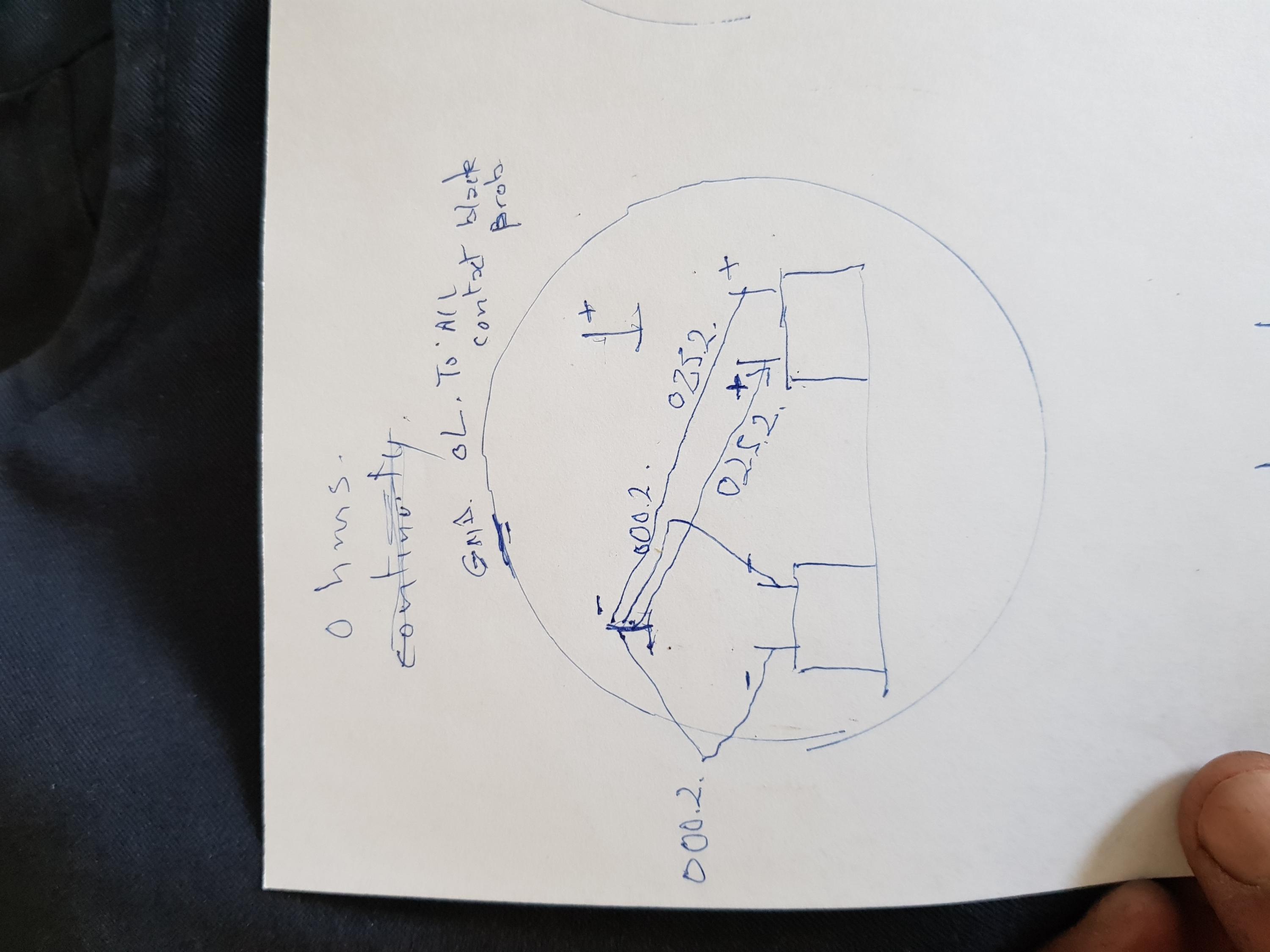

                  I get 26.1 ohms on all contacts if I have measured correctly
                    On what? The heating element or the high limit temperature trip switch? If you do get continuity on both, things are good and it should work, unless one of the on / off switches or fuse is bad.

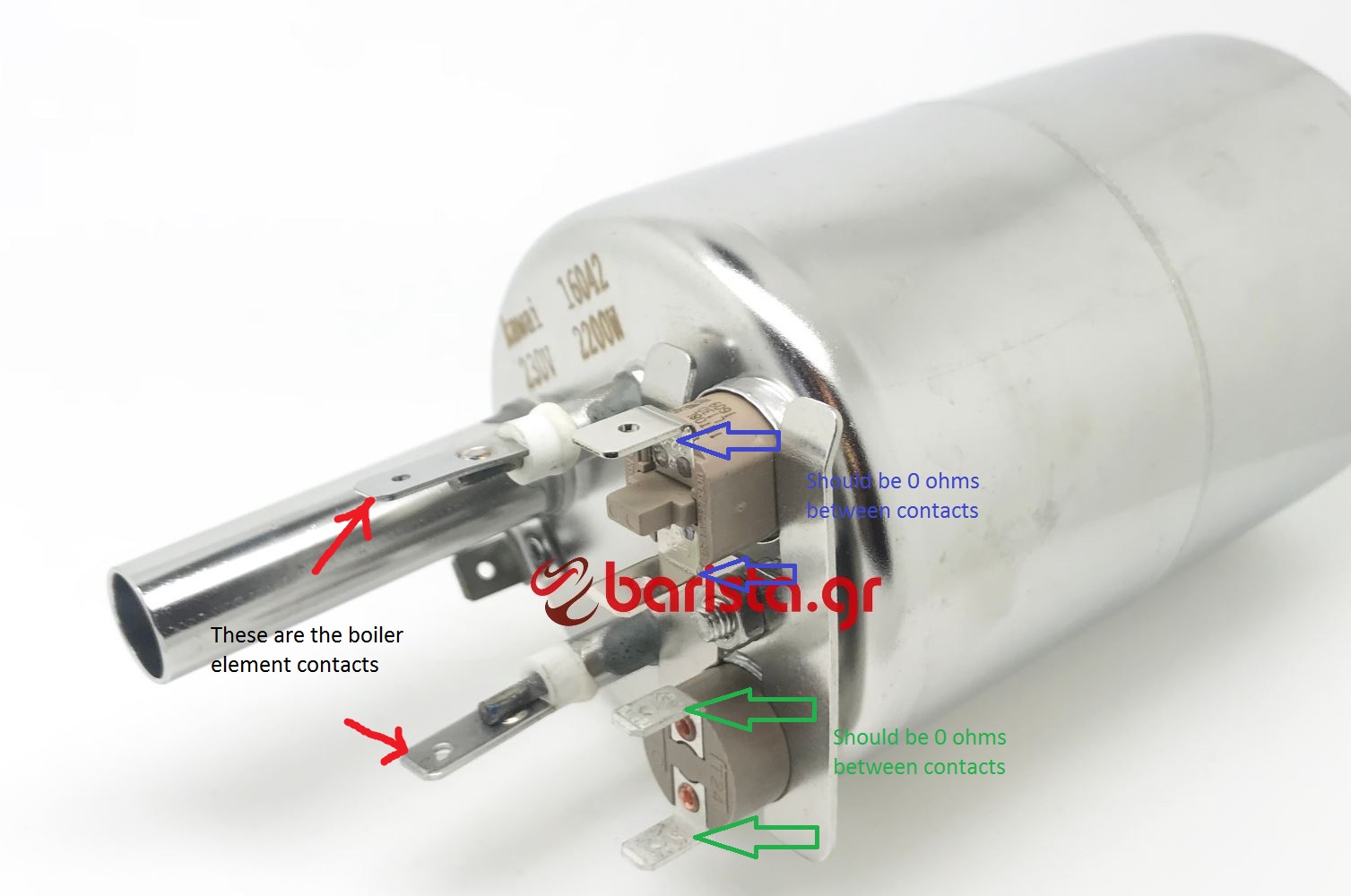

                        Here is the boiler, check the resistance of the element, The thermal cutouts should read 0Ω.
                        What is the problem you are having with the machine?
                            Originally posted by bohaboha
                            first it didn't work then on test it just worked but then nothing and I don't know what to look for plus I can't find a fuse anywhere
                            There are two separate warming plates, do either of them work? There are also three lights, do any of them work? If none of the lights work and neither of the warming plates get warm, I suspect the main switch or the wiring going to the switch.
                            If the lights S1 or S2 light when the switch is turned ON, but the S3 brew light does not come on, check the micro switch B3, check that it is being activated. I believe the micro switch is activated by the water level, so if there is no water in the top reservoir, the boiler and the brew light will not work.

                              2300w element should be about 25 ohms
                                  Even if the boiler element was open, the Brew light (S3) should still light, If both thermal cutouts B5 and B4, mounted on the boiler are ok, and not open, I suspect B3 micro switch is either bad or not being activated.

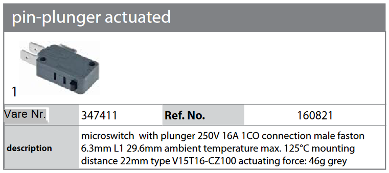

                                      Yes I think the water level switch or float is not working.
                                      I am not sure how the water does not leak to the microswitch, there must be a seal or gasket. Something mechanical that might jam or get stuck.
                                      pic from parts catalogue https://cdn.badcaps-static.com/pdfs/...5e66bfbe58.pdf

                                        ok it's obviously the float that's malfunctioning. because now i've tried filling in water and i hear the float activating the process and it works but how long should it last ? i can't find the float itself in the link you posted.
