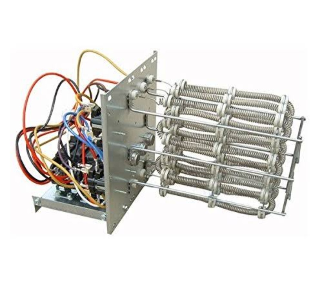

      For the element. Not this, but something like this. It's all wired up.(see attached link)

                    Absolutely. I know it can be dangerous (electricity and heat both are) going outside of the box. It's why I'm asking for y'all's guidance.
                    This is a Goodman unit (photo) and it does have fail-safes and controls built in. $93 bucks and has the capacity to heat large areas - houses... And for feedback, the PID with a thermocouple inside the sauna to track temperature. Set the coils to run at 40% let's say, no more, with air moving over them in a well made housing. Air housings for air handlers from the factory are simple things, just made up of a heavy sheet metal for the most part...

                          You're taking a device that heats to about 30c and want it to heat to 150c. It won't do that by design for safety reasons.

                            You are going to have issues doing it this way because those heating elements are inot designed to get that hot the temperature cutout will be around 150* to 180*F and not only that the type of heating element wire used on most of them if gets over heated it most certainly will fail
                            I would highly recommend that you but a commercial made heater made for this purpose even if you do not buy the controller that made for but it might end costing you just as much as just buying the controller as well because it should have the safety device already incorporated into the design of the system and probably UL listed as well
                            I thought you were only going up to around 100*F and what you have in mind would probably work but you would have to be careful about the CFM across the the heating element not get so low that you overheating the heating element wire but what temperature you are looking for is not going to work with what you have in mind and something else to keep in mind is that if you had a major failure and you burn your house down and when the investigation was conducted and they find out that it was home made you will be in trouble with the insurance company and I can promise you will not collect a dime

                            Now if you insist on doing with the air conditioning stile heating element if you were to put the temperature sensor on top of where the high temperature cutoff sensor is and keep your temperature controlled at a temperature no higher than 120*F maximum you might be able to get the to work but my suggestion to you would be as follows
                            You need to do this with a 120 volt version space heater that the heater element glows when running with the fan in it a temperature controller sensor mounted right next to maximum temperature switch and keep the maximum temperature below the temperature switch cutoff temperature you will have to experiment with this and once you have determined what your maximum temperature that you can have with out tripping the temperature switch then you know if this possible or not in other words “ a proof of concept “ and then you know what the limitations will be with type of heating element and a lot less expensive if you find out that it not feasible for cost effective to make your own

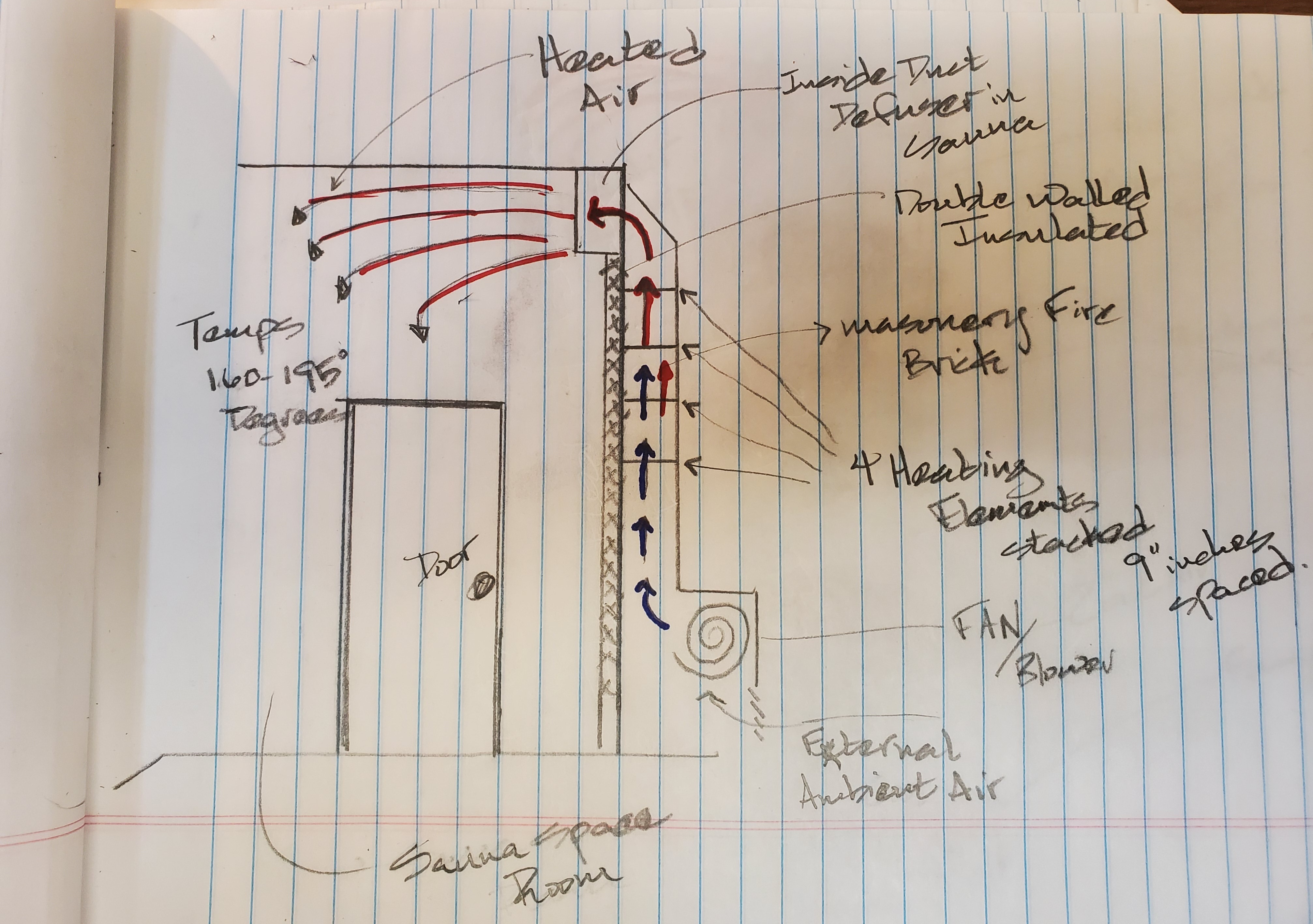

                              Based on what you all have said, I'm going to shift a litte bit...
                              Of course safety is the chief concern which out weighs any other consideration in moving forward at every step in this idea. I want to state that clearly and I am SUPER grateful for it seeming to be y'alls primary concern too! That said,,,
                              Let me put forward another idea or possible approach.
                              In thinking about the element/coils to be used I (obviously) was NOT aware of all of the dangers and limitations of the central heater air handler style element. So I think I will scrap that idea all together. Toooo complicated, tooooo many things to think about and tooooo many limitations - wrong equipment - wrong application... I have been watching guys on YouTube building all different kinds of PID controlled ovens and what they are using is just basic household oven elements. Designed to operate for hours (if need be), glowing cherry red at high temperatures, and surviving. Not even requiring air flow for cooling. A couple of guys I've watched made their own coils/elements out of wire to heat Kilns, Heat Treat Ovens with temps of 1400 and 1500 degrees. Another guy using two electric oven elements for a large powder coating oven. Gets to 400+ degrees in 7-8 minutes. At 400 degrees for extended periods - there are loads of videos. Ill attach a couple.

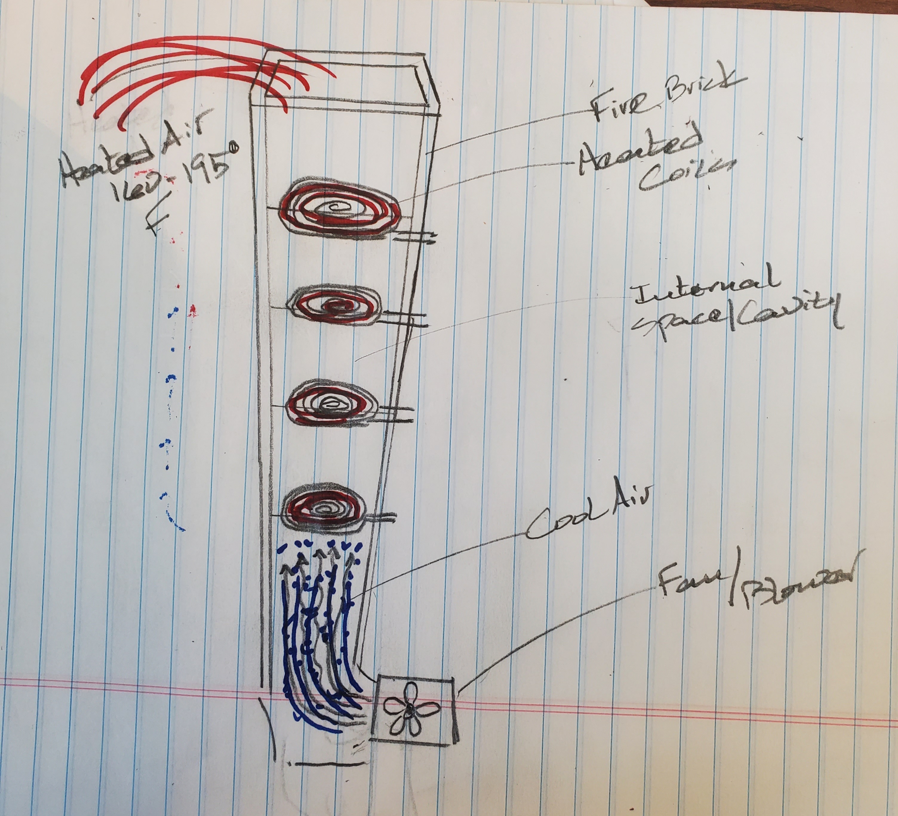

                              So, heres my "new" thinking. First there is these products (or ones like them) I see on Amazon -
                              a Fire place blower motor.
                              stove top elements.
                              Then this stuff
                              Then this stuff
                              Then this stuff is a possible direction for the heating element....
                              Then a couple hand fulls of these...
                              The idea is to (like the guy in the Heat Treat YouTube video) to encase and suspend the stove top elements in a tunnel of fire brick made to smartly support the elements while creating a tunnel for air to be pushed/forced thru. Blower would be connected to the brick tunnel with sheet/duct, to and thru brick tunnel with elements, back to sheet metal duct and then defused in to a well insulated sauna structure. I think this would heat a sauna MUCH faster than the 45-60+ minutes it takes even the BEST pre-fabed sauna heaters to reach temp.
                              Then, there is wiring the PID, setting the limits (limiting the elements at 40, 50, 60% to achieve desired temps), powering the blower fan so it comes on automatically. Breakers, SSR's (how many???)
                              I think y'all must be able to see where I am going with this.
                              Ill also say.... I'm sure you are thinking - why doesn't this guy just drop the 2000$ and get the proper premade heater??? Here's the thing, the prices for what you are actually getting are crazy... Then, this being a new house and a fixer-upper the BILLS are already coming in, then - I like to MAKE things... But clearly I need help and there are a million things I don't know.
                              So, what do folks think about this new approach?

                                The commercial heater sits in the enclosed sauna heating the air, it has safety features built in.
                                i think you want to blow air you are heating into the sauna ? You're taking it out as well to recirculate ?

                                  Here is a thought that you might want to consider what about finding a commercial unit that is not working anymore and buying it for a reasonable price and then you take it apart and see how and what was use and try to fix it now this might not an option because it might hard to find one and I get this
                                  To use one from a wall mount oven you will have another set of issues to deal with because on these units do not have ANY SAFETY devices whatsoever so this is even worse in this scenario and respect so might feasible but it is not going to be easily done because now you are going to have known how to use a micro controller and how to program one and here is reason why I say you should to know how to use and program one
                                  You must have a way to monitor the temperature of the heater element that is this style because if you allow this element to get to hot one of two things is going to happen one you will cause the element will open up and stop working if you are lucky which is the best outcome that you can ask for
                                  The second senecio is the worst case scenario because this is dangerous at best because in this situation is that the heater element short to ground and if you are lucky you will trip the breaker and this is assuming that the device is properly grounded if not grounded properly then you will have shocking situation that you will very possibly shock if you touch the enclosure if not properly grounded safely hazard
                                  You have to continually monitor the temperature of the element and keep it under control because you do not want to have thermal runaway stimulation because this will cause thermo damage to the element and cause the situation that you want to avoid at all cost no matter how difficult this situation might be
                                  This situation must be thoroughly tested and you will need to try to make the device to fall and see if your safety procedures actually work properly do not assume that they work test them to make sure that they work properly this where program a micro controller comes in play

                                        Sam, thanks so so much for all of your guidance and ideas..., Ill add a couple of photos (not to scale and drawn quickly) to give a better sense of what I am thinking at this point...
                                        Nothing will be directly above the elements except the next element(s) all encased in fire/furnace brick. They will only be on when the fan is on. There will NEVER be water near any part of this. And, the yet to be determined maximum running percentage, the amperage applied to the elements will not cause them to be powered maxed out. I'm hoping for something like medium 60, 70 or 80 % power maximum. In that they should never get red hot, maybe just slightly glowing. Also, they will be run ONLY on a timer. 60min to 90min max, and will not be able to be powered unless the timer is running.
                                        I want to add - wood stoves and fireplaces can be unsafe. Space heaters and portable heating devices can be unsafe. Pretty much anything can be unsafe if not used properly. Pools can, fast cars can etc etc etc motorcycles. Then, there's children's swing sets.. With that in mind, I view projects like these.
                                        I still have a long ways to go with this idea and again, will not move forward unless it can be dont safely, safely, safely...
                                        I need to know if a PID can be set up to bring a heating element up to heat slowly - rather than coming on full blast at startup to reach set temps?
                                        I need to know if a PID can be set up so that when it is turned on it goes right into its programing OR is there a bunch of fiddling one has to do in order to run the ONE and only program on the device?
                                        I also need to know if a PID needs to be SET and programed every time OR does it have a memory and can HOLD programs when powered down?
