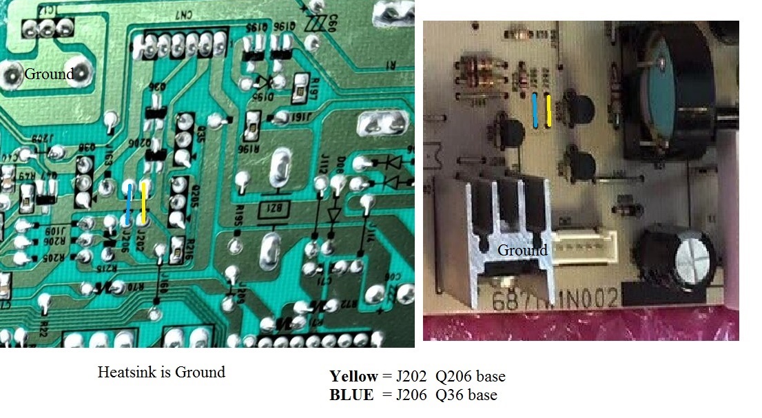

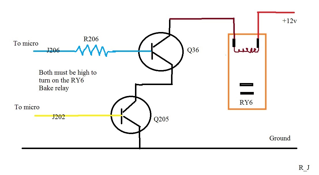

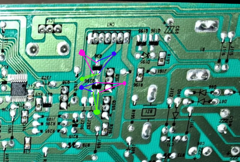

LG LST5651SW stove: oven not heating properly
    • Jul 2011
    • 6067
    #61
    Re: LG LST5651SW stove: oven not heating properly
    Originally posted by Curious808
    No Sabbath mode: long press BROIL does nothing.
    START is oven lockout, it's marked on the pad.
    Long-pressed other main controls. Ones that did something:
    BAKE -> Adj
    COOK & WARM -> Opt
    This might be demo testing mode what does it allow you to do when selected
    • redwire
      • Dec 2010
      • 3912
      #62
      Re: LG LST5651SW stove: oven not heating properly
      You can calibrate the oven bake temperature, so you do not fail Hell's Kitchen lol. The service manual 10. has procedure to adjust the readings up to +/- 35°F (19°C), in the case the temperature sensor is not exact and Gordon Ramsay is screaming at you.
      I don't know what OPT is, some option. The manuals are terrible, poorly translated Korean.
      • redwire
        • Dec 2010
        • 3912
        #63
        Re: LG LST5651SW stove: oven not heating properly
        OK, if you can take some multimeter Diode-Test readings (power off) on the oven control board to see if the two (bake) transistors look to be reasonable.
        Each transistor has three pins, so that is three readings across each pair, but you also need to flip the test lead polarity so that is another three readings, total six per transistor.
        I tried to draw that in different colours, so you know which two pins to take a reading on, and then reverse the test leads and take that reading as well.
        If you can do that and write down and post the results here, we can see if the board has an easy fix. Beyond any bad solder joints, these two transistors are the only replaceable parts on the control board right now that I know of.
        Wild guess I would expect the green readings (emitter-base) to be wonky.
        Still need a magnifier and read the numbers on the little parts too.
        Last edited by redwire; 01-11-2023, 03:15 PM.
        • R_J
          • Jun 2012
          • 9588
          #64
          Re: LG LST5651SW stove: oven not heating properly
          Originally posted by Curious808
          No Sabbath mode: long press BROIL does nothing.
          START is oven lockout, it's marked on the pad.
          Long-pressed other main controls. Ones that did something:
          BAKE -> Adj
          COOK & WARM -> Opt
          This option is to change the clock from 12H to 24H (press 1 to change, START to accept)
          If you like you can check the logic that controls the two transistors, The main control board can be installed and you can access the two test points I marked in Blue J206 and Yellow J202. These two test points are the base of Q206 and Q36 which are directly controlled by the microprocessor ic (probe carefully) I would guess a voltage of between 1~5v for a high.
          The small heat sink can be used for your meter ground
          Last edited by R_J; 01-11-2023, 04:11 PM.
          • Curious808
            • May 2022
            • 39
            #65
            Re: LG LST5651SW stove: oven not heating properly
            Continuity test OK for all 6 wires in relay CN8 to main board CN 7.
            Last edited by Curious808; 01-11-2023, 04:06 PM.
            • Curious808
              • May 2022
              • 39
              #66
              Re: LG LST5651SW stove: oven not heating properly
              Originally posted by redwire
              OK, if you can take some multimeter Diode-Test readings (power off) on the oven control board to see if the two (bake) transistors look to be reasonable.
              Each transistor has three pins, so that is three readings across each pair, but you also need to flip the test lead polarity so that is another three readings, total six per transistor.
              I tried to draw that in different colours, so you know which two pins to take a reading on, and then reverse the test leads and take that reading as well.
              If you can do that and write down and post the results here, we can see if the board has an easy fix. Beyond any bad solder joints, these two transistors are the only replaceable parts on the control board right now that I know of.
              Wild guess I would expect the green readings (emitter-base) to be wonky.
              Still need a magnifier and read the numbers on the little parts too.
              Not sure of these readings. Had to move the probes around to get anything, wasn't just touching the solders and catch a reading. I did manage to get all of the readings below more than once.
              In diode test mode, based on the color-coded drawing above:
              Top transistor (in photo)
              PINK 0.65 0.00
              BLUE 0.00 0.00
              GREEN 0.65 0.00
              Bottom transistor
              BLUE 0.88 0.00
              PINK 0.98 0.00
              GREEN 0.87 0.55
              • redwire
                • Dec 2010
                • 3912
                #67
                Re: LG LST5651SW stove: oven not heating properly
                Sometimes there is a slimy oxide layer that makes readings tough or wander.
                On Diode-Test, when multimeter leads are not touching anything, should see "OL" or "1---" or "OPEN"
                On Diode-Test, when multimeter leads are shorted together, should see "0.00"
                So I'm a bit confused about your 0.00 readings
                Transistor Q206 I don't know it's number (and there is no base resistor which might be a design flaw) so I can't confirm the readings you have. It could be a cracked resistor R206 (1000Ω?) you could measure ohms across it. Transistor Q36 readings look OK.
                Beyond this point, I would say there is a bad connection (cable/connector/transistors) cracked soldering joint to look for using an eye magnifier.
                Or the microcontroller output line is not working (which means bite the bullet and replace the oven control board).
                LG had the recall on these boards turning on the range top elements, you could talk to an LG tech and see if you qualify for a board swap.
                • Curious808
                  • May 2022
                  • 39
                  #68
                  Re: LG LST5651SW stove: oven not heating properly
                  Originally posted by redwire
                  Sometimes there is a slimy oxide layer that makes readings tough or wander.
                  On Diode-Test, when multimeter leads are not touching anything, should see "OL" or "1---" or "OPEN"
                  On Diode-Test, when multimeter leads are shorted together, should see "0.00"
                  So I'm a bit confused about your 0.00 readings
                  Thanks. Learning as I go:
                  In diode test mode, based on the color-coded drawing above:
                  Top transistor (in photo)
                  PINK 0.65 OL
                  BLUE OL OL
                  GREEN 0.65 OL
                  Bottom transistor
                  BLUE 0.88 OL
                  PINK 0.98 OL
                  GREEN 0.87 0.55
                  • Curious808
                    • May 2022
                    • 39
                    #69
                    Re: LG LST5651SW stove: oven not heating properly
                    To summarize:
                    1. Oven heater element: continuity and resistance OK and to spec; visual inspection showed no flaws.
                    2. Sensor continuity and resistance OK and to spec.
                    3. Relay board: no 240 current from bake relay (live), diodes OK.
                    4. CN8 to CN7 wires from relay board to main control board continuity OK. Wires and solders in general look OK.
                    5. Main board: transistor checks, 1 OK, 1 inconclusive.
                    As it stands, stovetop works, oven works to about 360 heated by broil element alone.
                    I think that covers it. What's the conclusion, unrepairable main board problem?
                    Last edited by Curious808; 01-12-2023, 05:17 PM.
                    • R_J
                      • Jun 2012
                      • 9588
                      #70
                      Re: LG LST5651SW stove: oven not heating properly
                      You didn't check the transistor base voltages which would have confirmed the fault is with the main microprocessor and not just a faulty transistor.
                      • redwire
                        • Dec 2010
                        • 3912
                        #71
                        Re: LG LST5651SW stove: oven not heating properly
                        It might not be easy and OP's skill level might be a concern, so I did not suggest it.
                        The oven control board has hazardous live wires and parts, and I'm not sure if you can use the keypad to active BAKE and then somehow probe the PC board face. Can you operate it with the board folded down?
                        I use wood/cardboard to prop up a board away from any metal (chassis) so there are no short circuits and kaboom.
                        There are some parts and jumpers on the backside which could instead be probed (they connect to the transistors). Like jumpers J202/J160, J206, R206 DCV readings would tell us everything.
                        Q206 might be suspect but again, we don't know its marking code or Q36 as well.
                        • R_J
                          • Jun 2012
                          • 9588
                          #72
                          Re: LG LST5651SW stove: oven not heating properly
                          The board can be tested when it is mounted in place, I marked the two test points so it would be easy and safe to test.
                          I'm sure the op skill level can handle checking two voltages on the control board as he already checked the three voltages on the relay board. The relay board also has hazardous voltages which did not seem to be an issue
                          Last edited by R_J; 01-12-2023, 07:53 PM.
                          • Curious808
                            • May 2022
                            • 39
                            #73
                            Re: LG LST5651SW stove: oven not heating properly
                            Originally posted by R_J
                            If you like you can check the logic that controls the two transistors, The main control board can be installed and you can access the two test points I marked in Blue J206 and Yellow J202. These two test points are the base of Q206 and Q36 which are directly controlled by the microprocessor ic (probe carefully) I would guess a voltage of between 1~5v for a high.
                            The small heat sink can be used for your meter ground
                            In the photo, I see the yellow and blue lines and the ground. Not sure how to test. The stove is live, oven set to bake preheat? Testing from the solder side. Where do I position the probes, one on one of the ground points and the other to each of the yellow and blue solder points?
                            • redwire
                              • Dec 2010
                              • 3912
                              #74
                              Re: LG LST5651SW stove: oven not heating properly
                              With the stove powered up, the BAKE heating element turned on, put your multimeter on DC Volts and (-) probe touching the heatsink ground (or its pads), and (+) probe each of the blue and yellow marked spots in the picture in Post #64.
                              You can access these points from either side of the board. I thought the solder-side was the front with the LED display and not normally accessible. It's safest if the board is mounted and does not move around flipped down.
                              • R_J
                                • Jun 2012
                                • 9588
                                #75
                                Re: LG LST5651SW stove: oven not heating properly
                                You can install the board back into the stove, then if you look at the second part of the picture, there are two jumper wires on the board, these have the logic from the microprocessor and are directly connected to the two transistor bases.
                                The voltage on these two jumpers will be low, around 1~5 vdc, so all you need to do is place your meter ground on the small heat sink and check the two jumpers J206 & J202, note the voltage on each (this is done with the oven in bake mode)
                                • Curious808
                                  • May 2022
                                  • 39
                                  #76
                                  Re: LG LST5651SW stove: oven not heating properly
                                  Originally posted by R_J
                                  You can install the board back into the stove, then if you look at the second part of the picture, there are two jumper wires on the board, these have the logic from the microprocessor and are directly connected to the two transistor bases.
                                  The voltage on these two jumpers will be low, around 1~5 vdc, so all you need to do is place your meter ground on the small heat sink and check the two jumpers J206 & J202, note the voltage on each (this is done with the oven in bake mode)
                                  Between clicks (I guess the relay opening and closing) they were alternately both 0.00 or
                                  J202 4.83
                                  J206 0.88
                                  Tested from the component side, not the solder side, during the first five minutes of the BAKE preheat. The 0.00 periods were much longer, maybe 30 seconds or more, than the periods lasting maybe 15 seconds that showed current.
                                  Last edited by Curious808; 01-14-2023, 01:46 PM.
                                  • R_J
                                    • Jun 2012
                                    • 9588
                                    #77
                                    Re: LG LST5651SW stove: oven not heating properly
                                    So Q205 is being turned ON but Q36 is not, the signal on J206 never goes high (4,83)
                                    Unless something else is preventing the microprocessor to output a high to Q36, maybe some safety feature we don't know about?
                                    I would try and contact L.G. maybe they will replace the board, being that you are so disappointed with there product and would not....
                                    Last edited by R_J; 01-14-2023, 02:28 PM.
                                    • Curious808
                                      • May 2022
                                      • 39
                                      #78
                                      Re: LG LST5651SW stove: oven not heating properly
                                      Originally posted by R_J
                                      So Q205 is being turned ON but Q36 is not, the signal on J206 never goes high (4,83)
                                      Unless something else is preventing the microprocessor to output a high to Q36, maybe some safety feature we don't know about?
                                      I would try and contact L.G. maybe they will replace the board, being that you are so disappointed with there product and would not....
                                      So that's the problem found? I'll try getting in touch with LG. Otherwise, it would mean replacing that main board?
                                      • R_J
                                        • Jun 2012
                                        • 9588
                                        #79
                                        Re: LG LST5651SW stove: oven not heating properly
                                        After a closer look Check that resistor R206 just in case it is open. It is just between J109 and R205
                                        Maybe this resistor is open?
                                        It looks like the same value as R205
                                        Alternately you could check the voltage on both sides of R206
                                        Last edited by R_J; 01-14-2023, 02:50 PM.
                                        • Curious808
                                          • May 2022
                                          • 39
                                          #80
                                          Re: LG LST5651SW stove: oven not heating properly
                                          Originally posted by R_J
                                          After a closer look Check that resistor R206 just in case it is open. It is just between J109 and R205
                                          Maybe this resistor is open?
                                          It looks like the same value as R205
                                          Alternately you could check the voltage on both sides of R206
                                          Checked resistance in place. Both it and the one above are 1.98 ohms. No signs of damage.
                                          Last edited by Curious808; 01-14-2023, 03:04 PM.
                                          • JayPoorJay
                                            A Central Air Heating Element, A PID and a Sauna
                                            by JayPoorJay
                                            What could go wrong...?
                                            I'm not sure if this is the right sub category or even the right forum but here goes,,,
                                            I'll just dive right in. I want to see if it's possible and what it would take to use a PID Controller (or 2) to run a central air conditioning heater element (the kind that goes into an air handler) and a small blower fan... The application is a DIY Sauna... Am I nuts? Mean, these components could be had for around 100 bucks.
                                            What do I need to be thinking?
                                            Of course I will go to Vevor and order one of their 200$ sauna heaters so I...
                                            01-10-2024, 02:48 PM
                                          • EasyGoing1
                                            The best way to drive a heating element?
                                            by EasyGoing1
                                            I've got this circuit that I've been playing with on a breadboard. I'm not happy with it mainly because the MOSFET gets too hot and generally controlling the temp of the heating element with the Arduino has proven to be a little more cumbersome than I would like.
                                            What I would like to know, is what is the best way to set up a circuit like this? The heating element is just a PCB and its going to be mounted under a 3D-printed enclosure that a lizard will use to warm his belly.
                                            This is the general setup that I have now.
                                            This is what the...
                                            01-25-2023, 11:29 AM
                                          • bohaboha
                                            Queen coffee CQ MN-2 Heating element
                                            by bohaboha
                                            How to test this queen coffee maker heating element...
                                            07-18-2022, 09:01 PM
                                          • flysky
                                            Gigabyte H610M S2H V2 help to identify the element.
                                            by flysky
                                            There is a motherboard Gigabyte H610M S2H V2 (DDR5), I can't find boardview
                                            Help to identify the element, marking on the element - C31PH. It stands next to the USB 3.0 and it looks like it is ESD Protect chip. We need a datasheet to this element. Maybe someone has already identified such an element. Help please.​
                                            01-23-2025, 07:21 PM
                                          • CuriousJohn
                                            Burco boiler power problem
                                            by CuriousJohn
                                            Burco BCPLSAFWM5L 5 Litre Wall Mounted Automatic Water Boiler With Filtration UK 240v
                                            Does anybody have any experience with these Burco units at all there is no record of them on the forum lol and a proper service manual would be nice. I invite you all to pesuade me not to botch repair it with a 5v relay, read on.
                                            This unit was rescued from a skip 3 years ago, the only fault it had then was no backight display (plus it wanted a new probe set and top seal) but the screen was never an issue you can still see the screen as is and I just use it to get 5 Litres of very hot...
                                            12-22-2024, 10:25 AM
