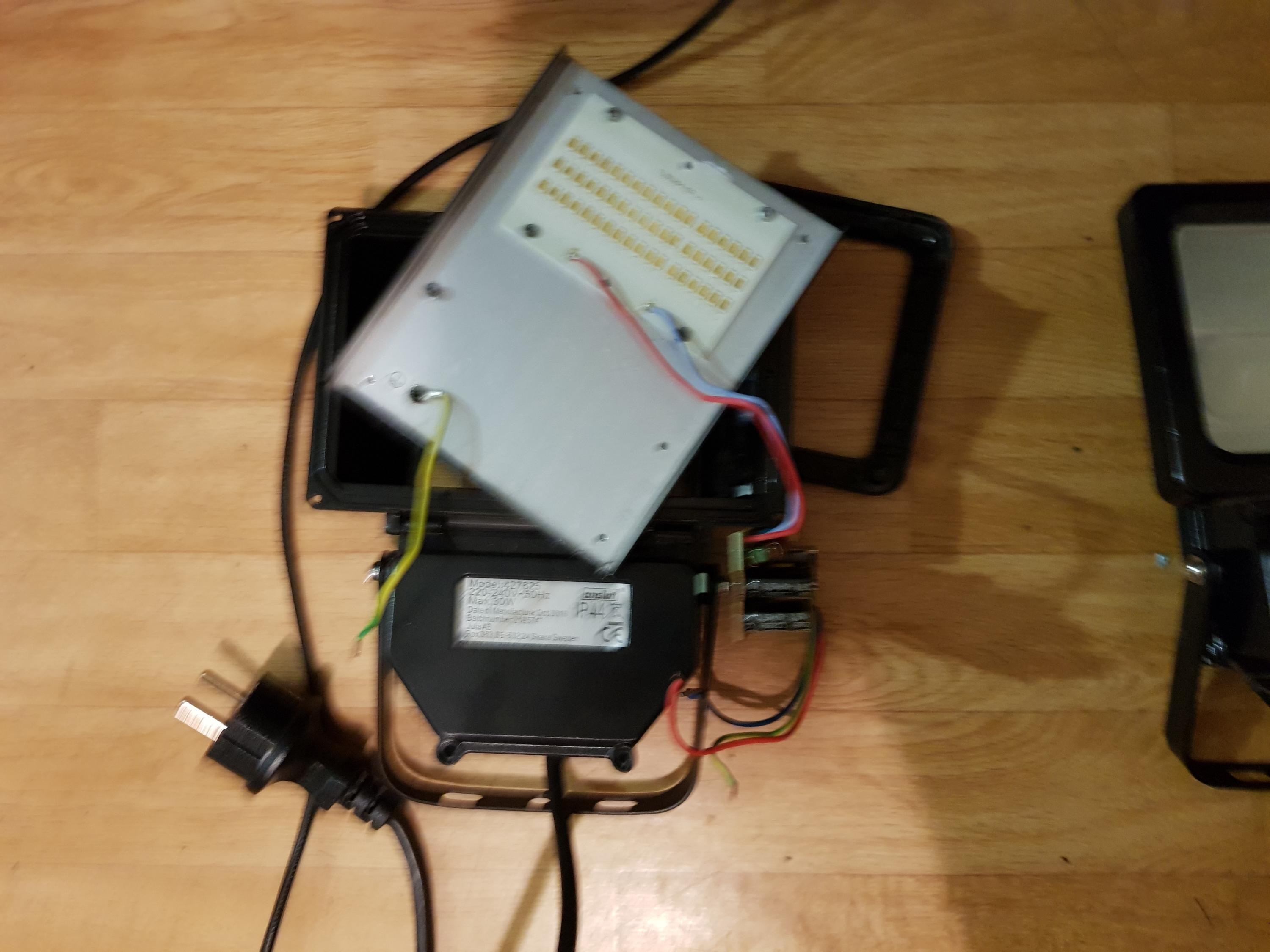

    Led spotlight 220-240W-50Hz max30W

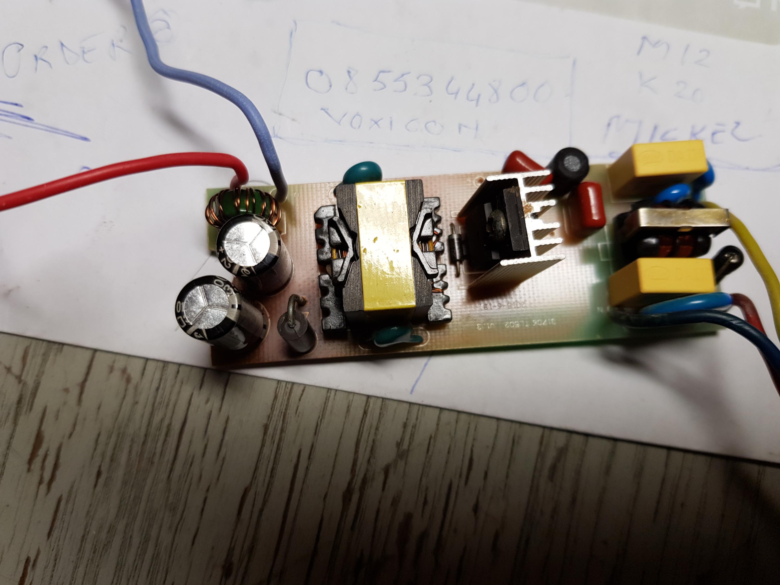

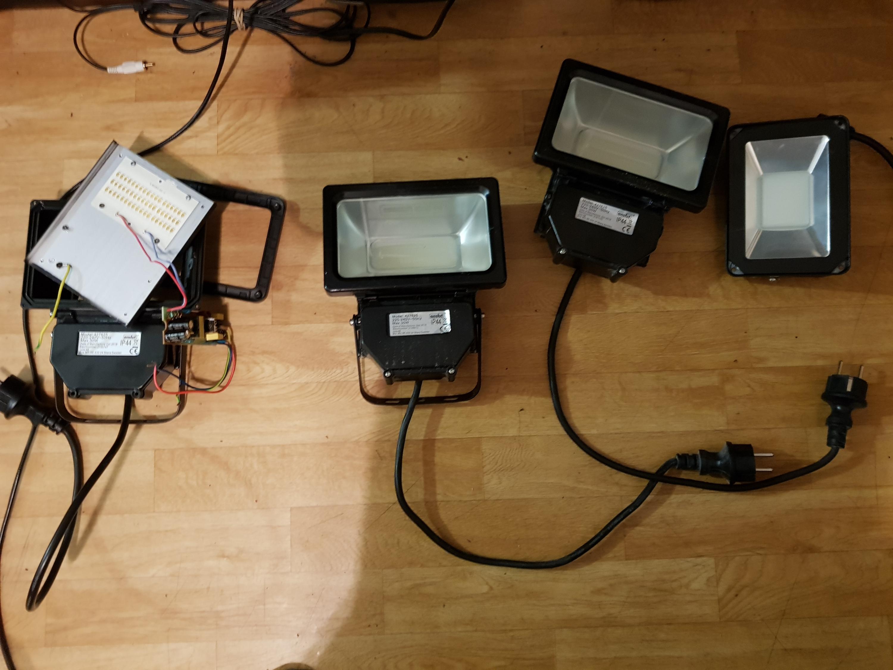

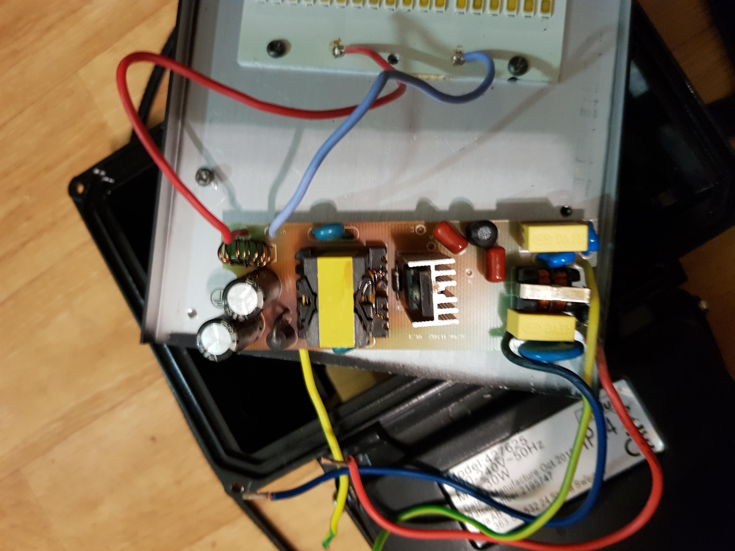

    Hi I have four spotlight only one is ok? that flashes can you help determine which lamp should I replace look at the pictures so you understand better thank you

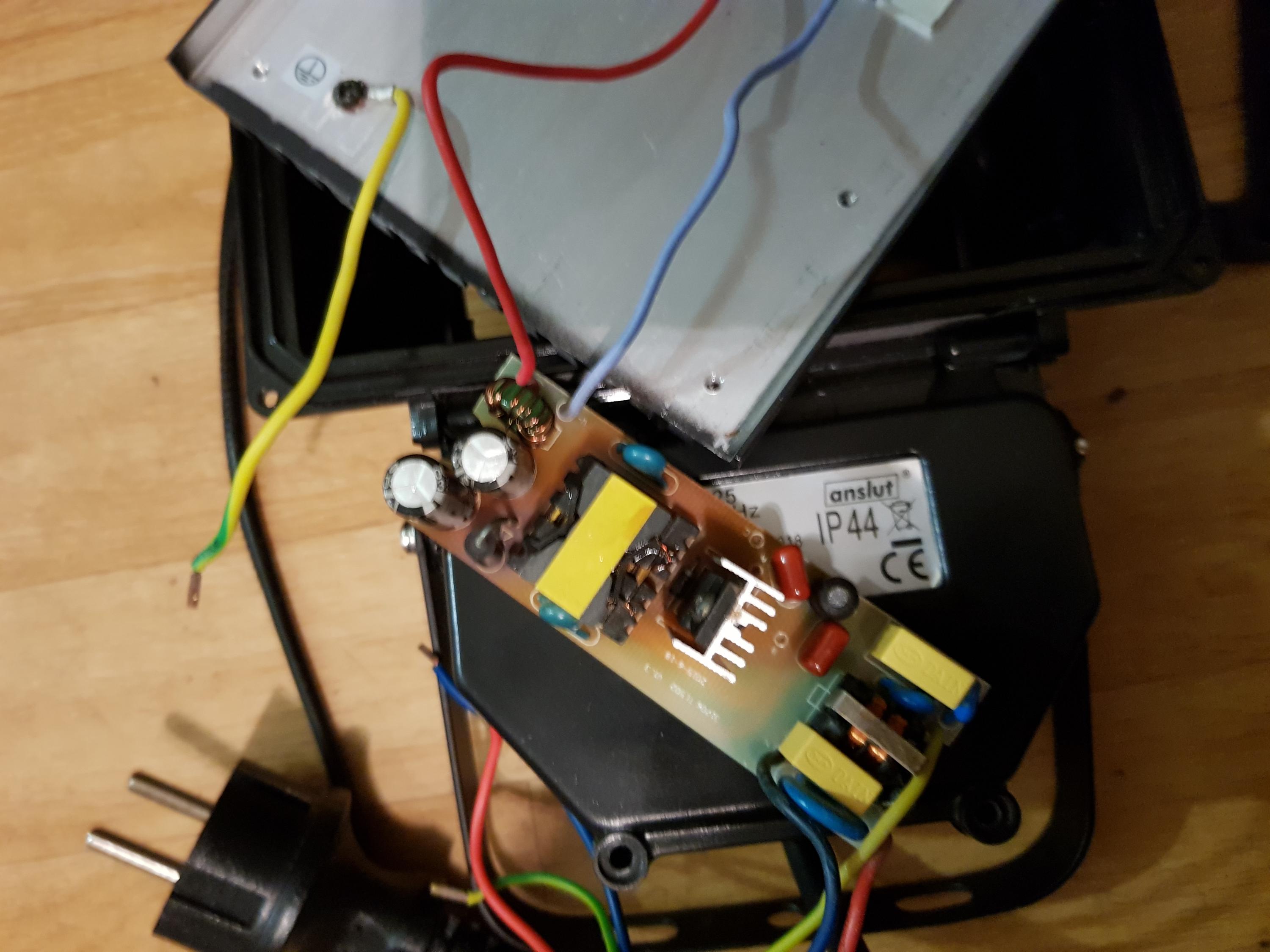

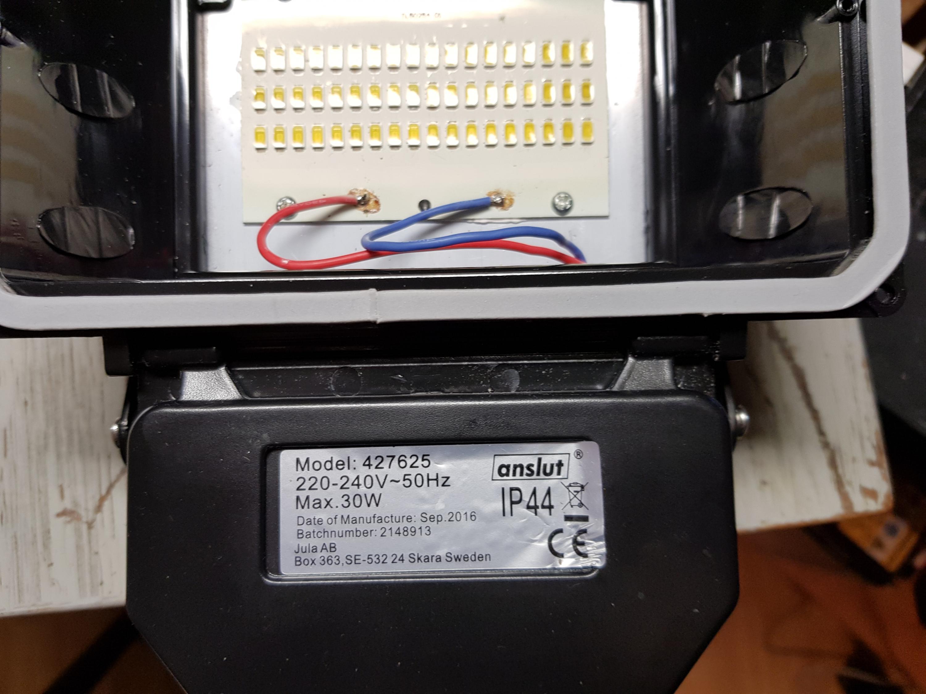

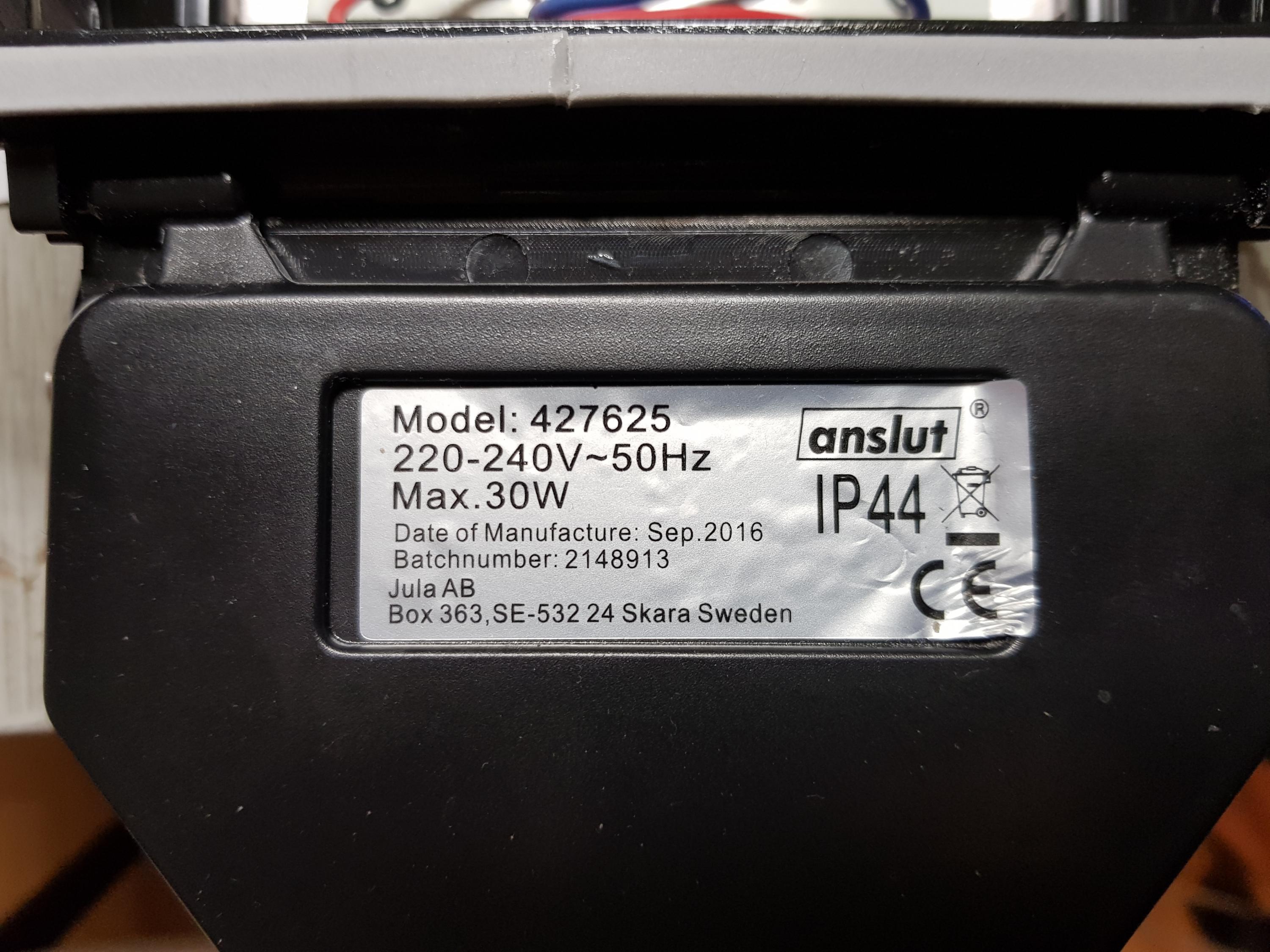

      Re: Led spotlight 220-240W-50Hz max30W
      Take a better picture of the transformer data plate so I can read the entire thing the picture that you posted is not very clear to read everything
      Also take a picture of the back of the circuit board so I can what it looks like

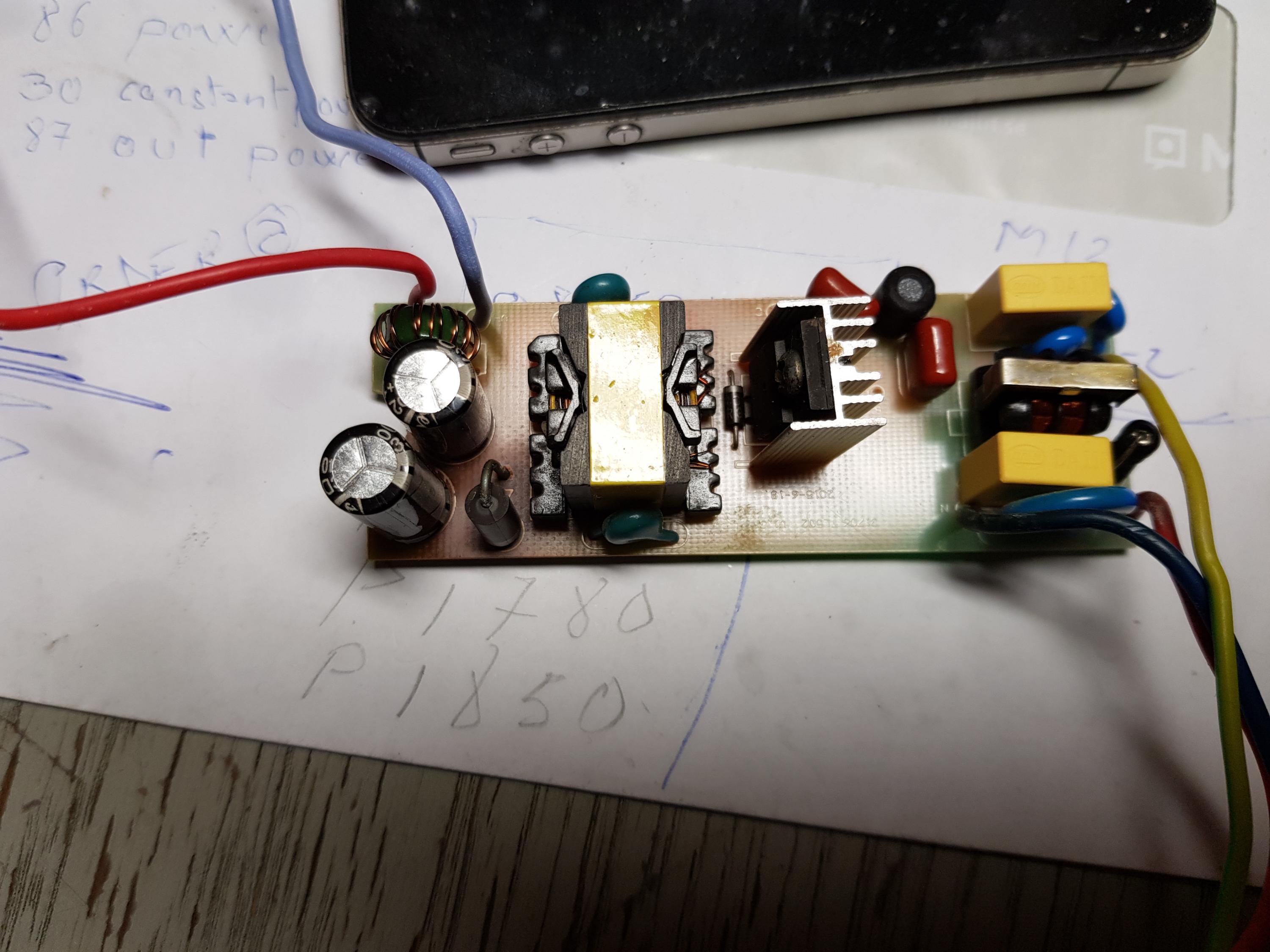

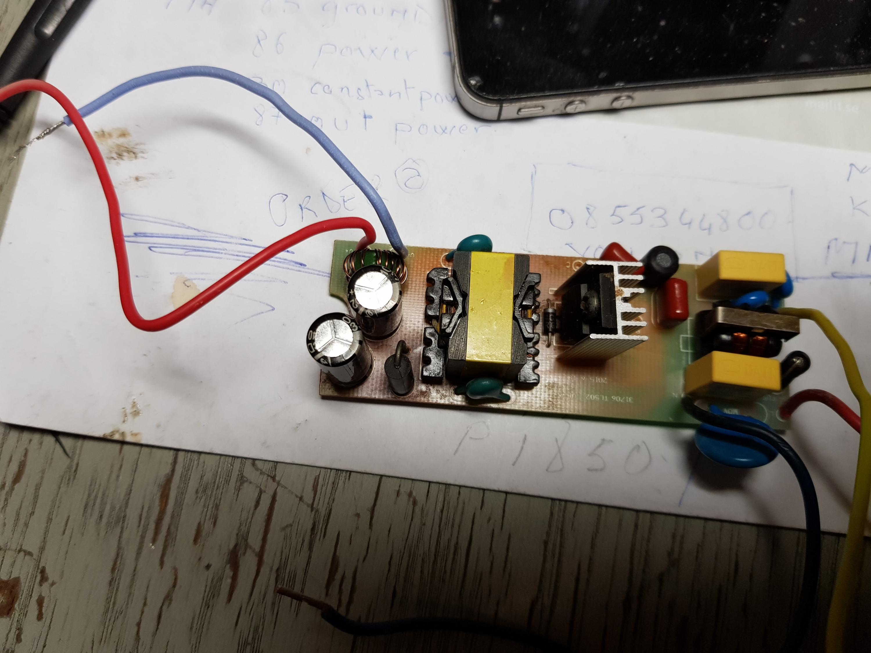

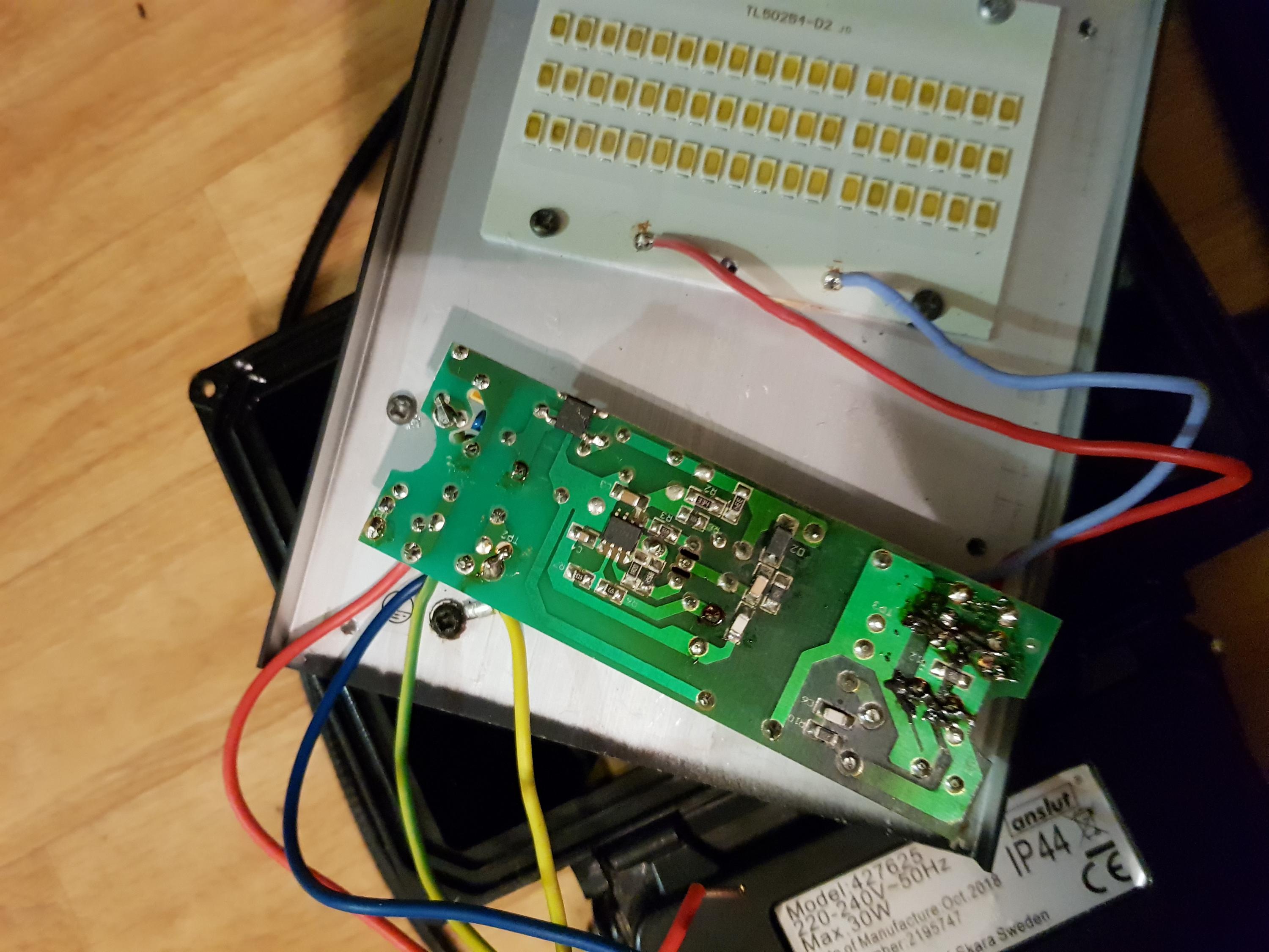

        Hi hope these are better. Are these powered by transformer or led drive?

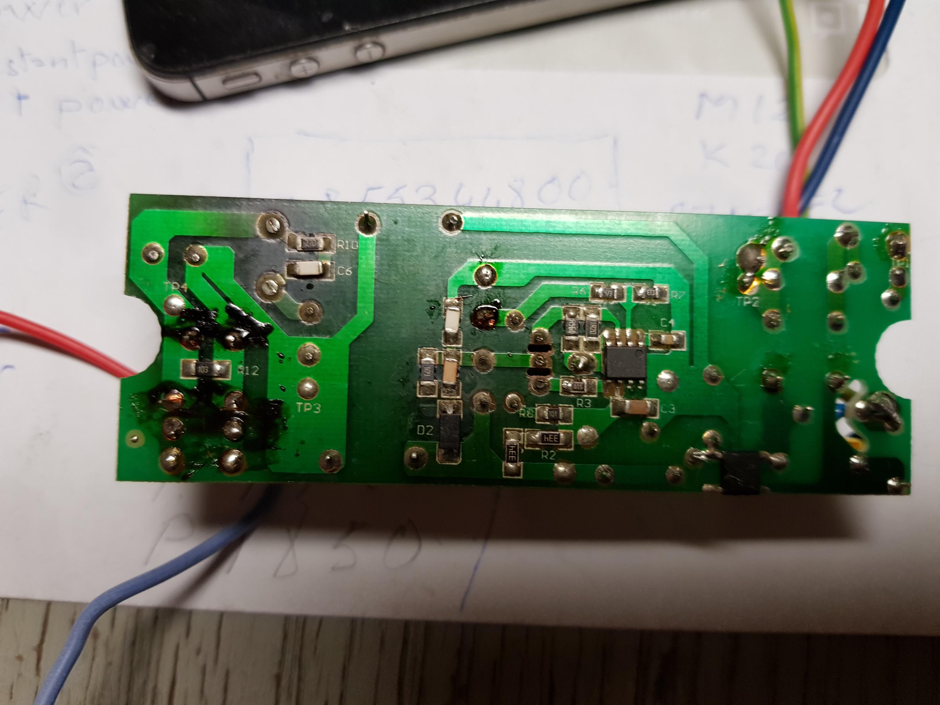

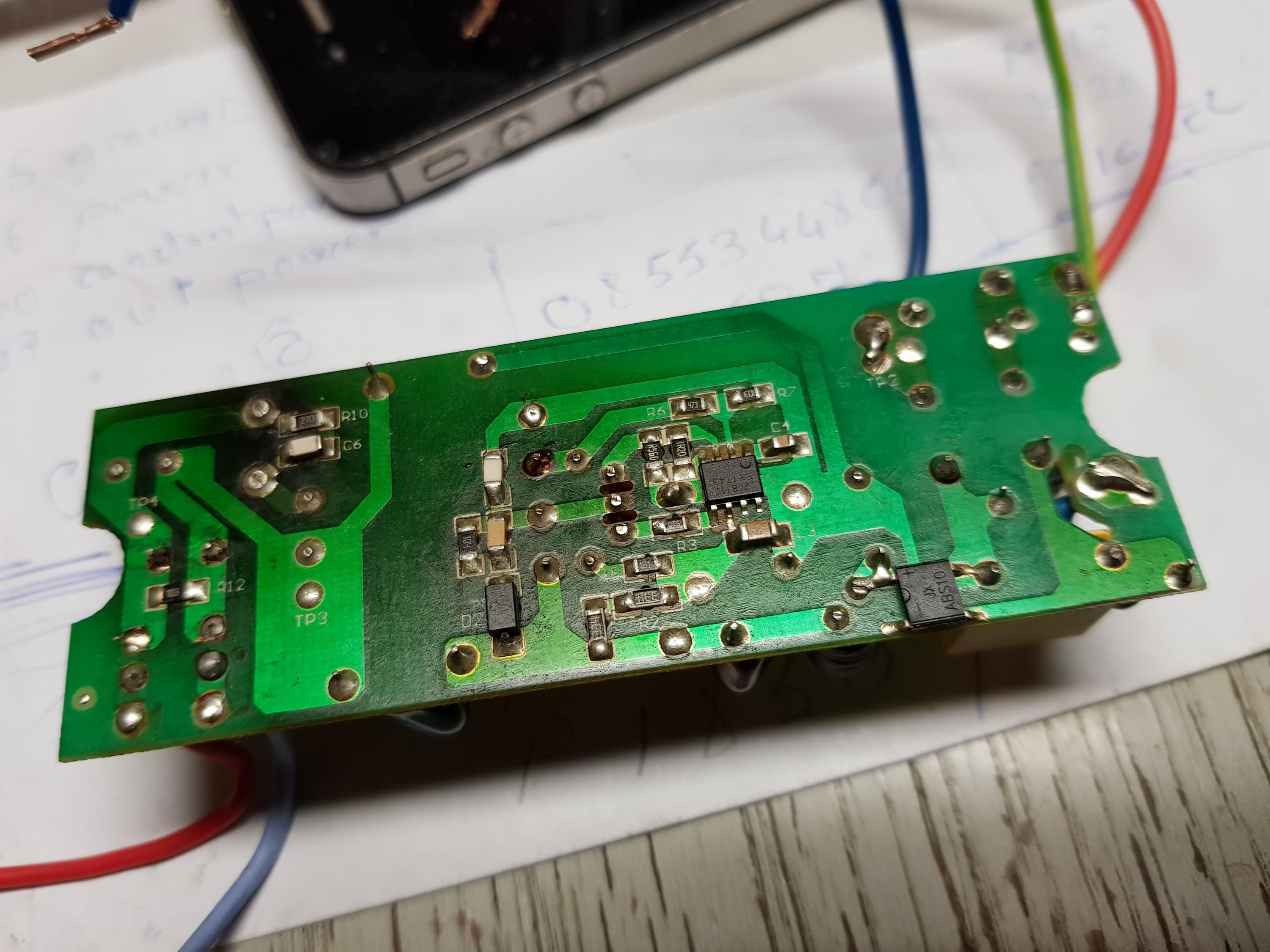

          What about the picture of the back of the circuit board

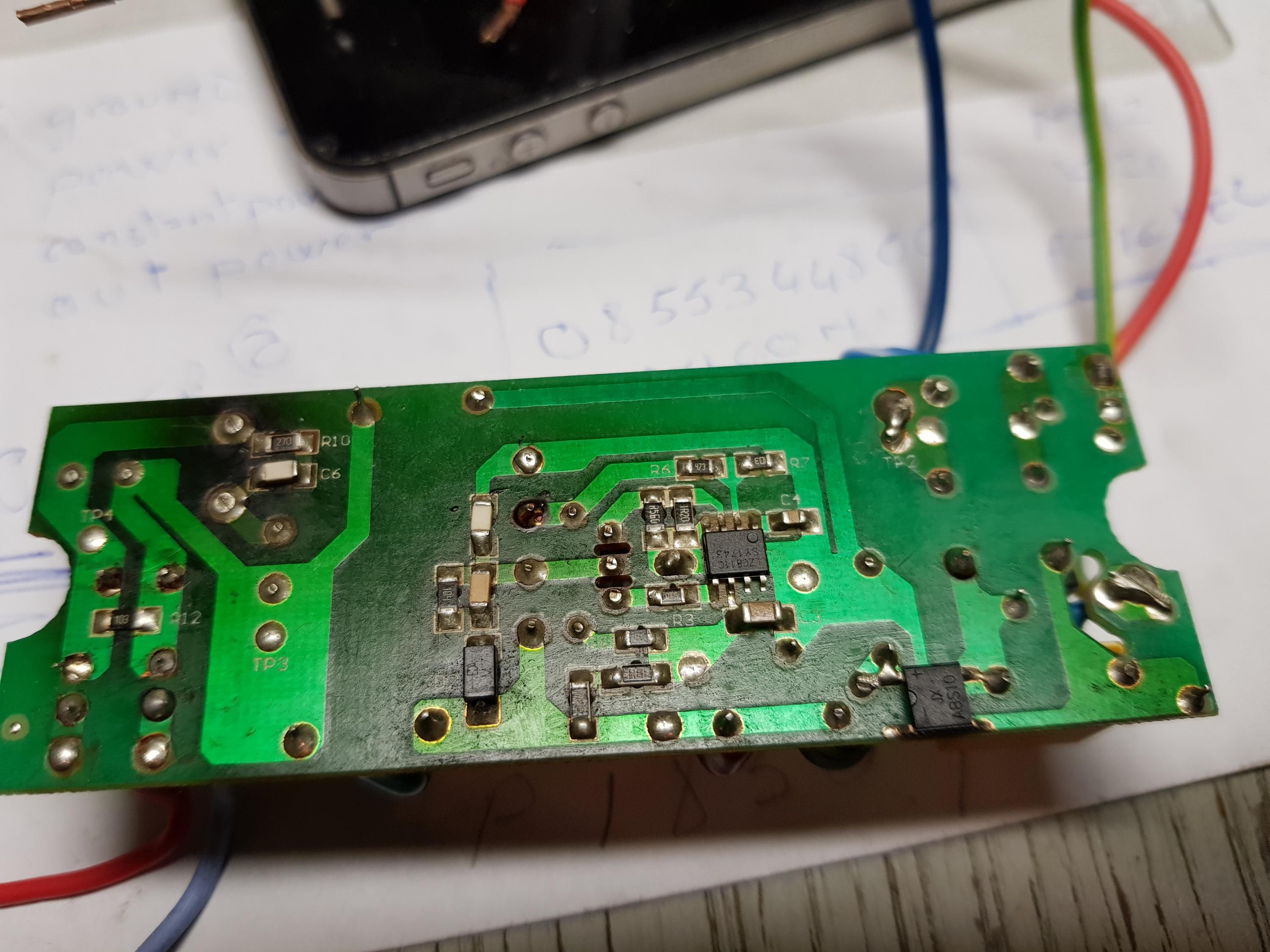

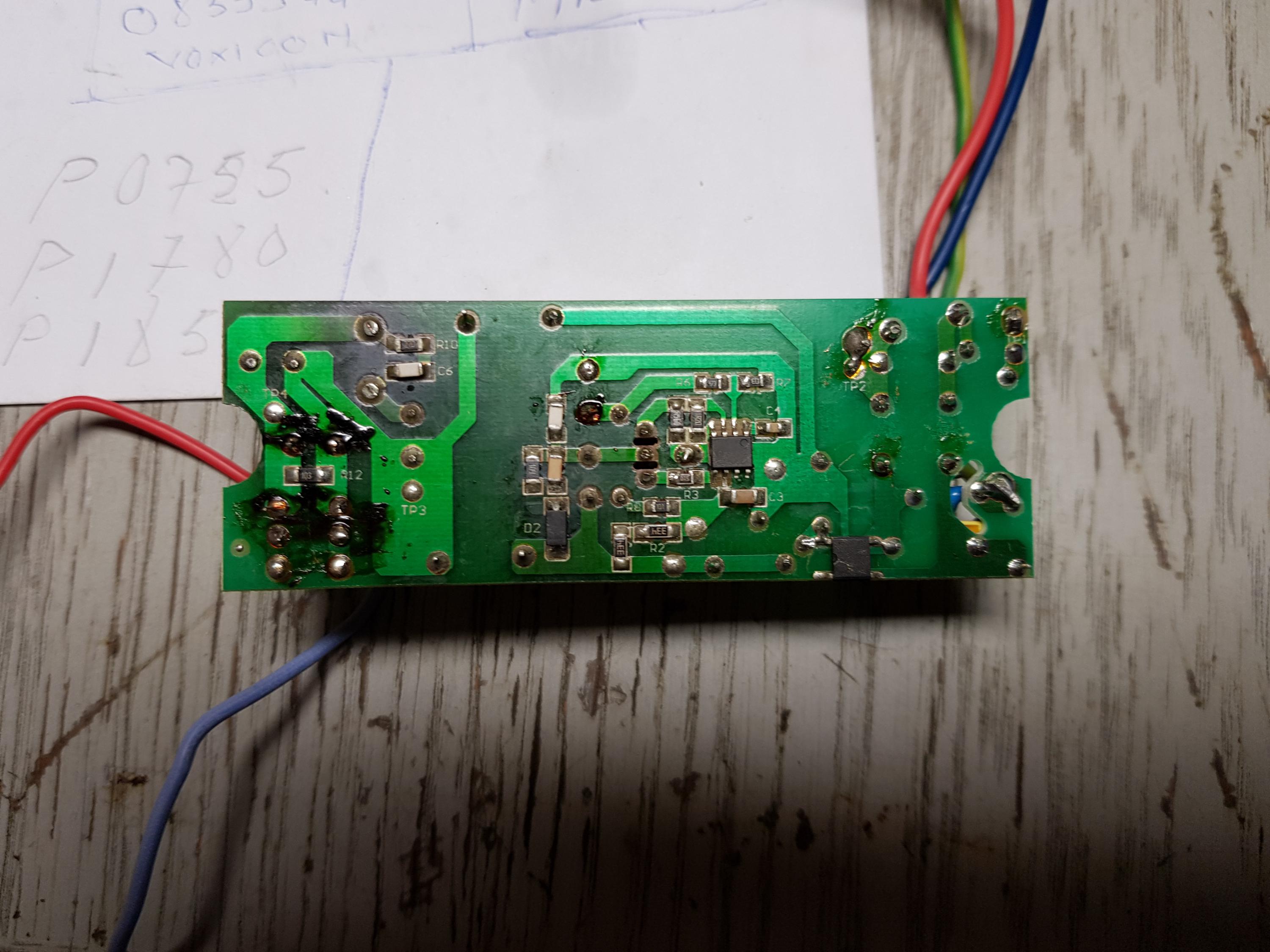

            here är det,so you see it's a bit dark around the big diode it's been really hot don't know if it burned because when I cleaned it all went away but there is trace that it got really hot there you can see the difference in the next post
            • bohaboha
              • Nov 2012
              • 973
              • sweden
              here it is cleaned

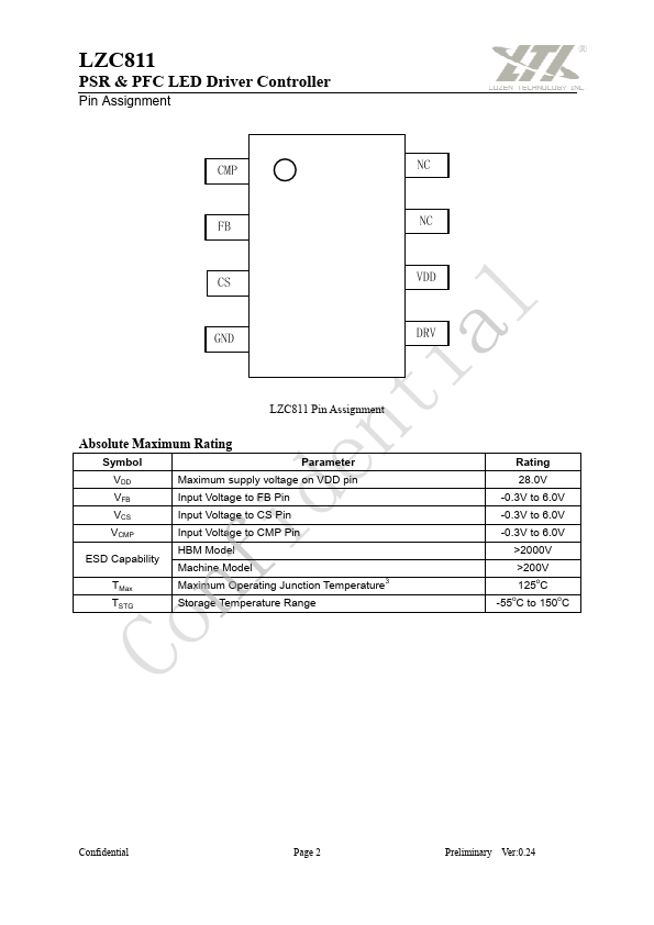

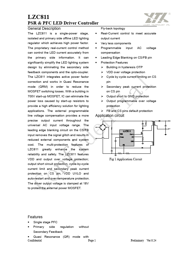

                Here is two pages of the data that I could find of the ZC811C ic chip
                This ic chip one of the pin when looking at with the print so you can read the print the pin on the most left pin look like it not a good connection to the board
                You can find this ic chip on eBay
                  https://www.ebay.com/itm/33312542232...Bk9SR7KYyd_0YA
                  thanks. let's see if I can fix them

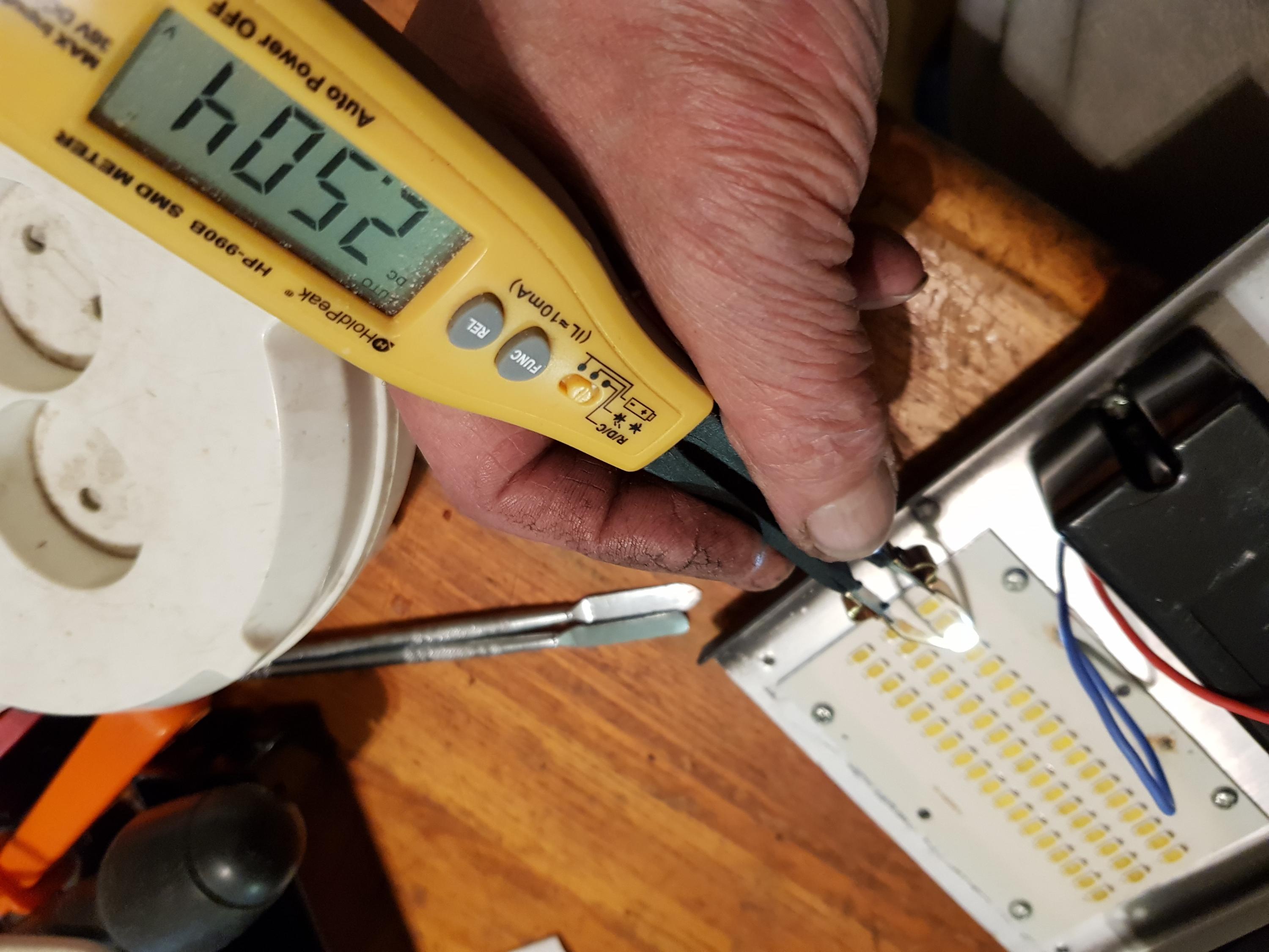

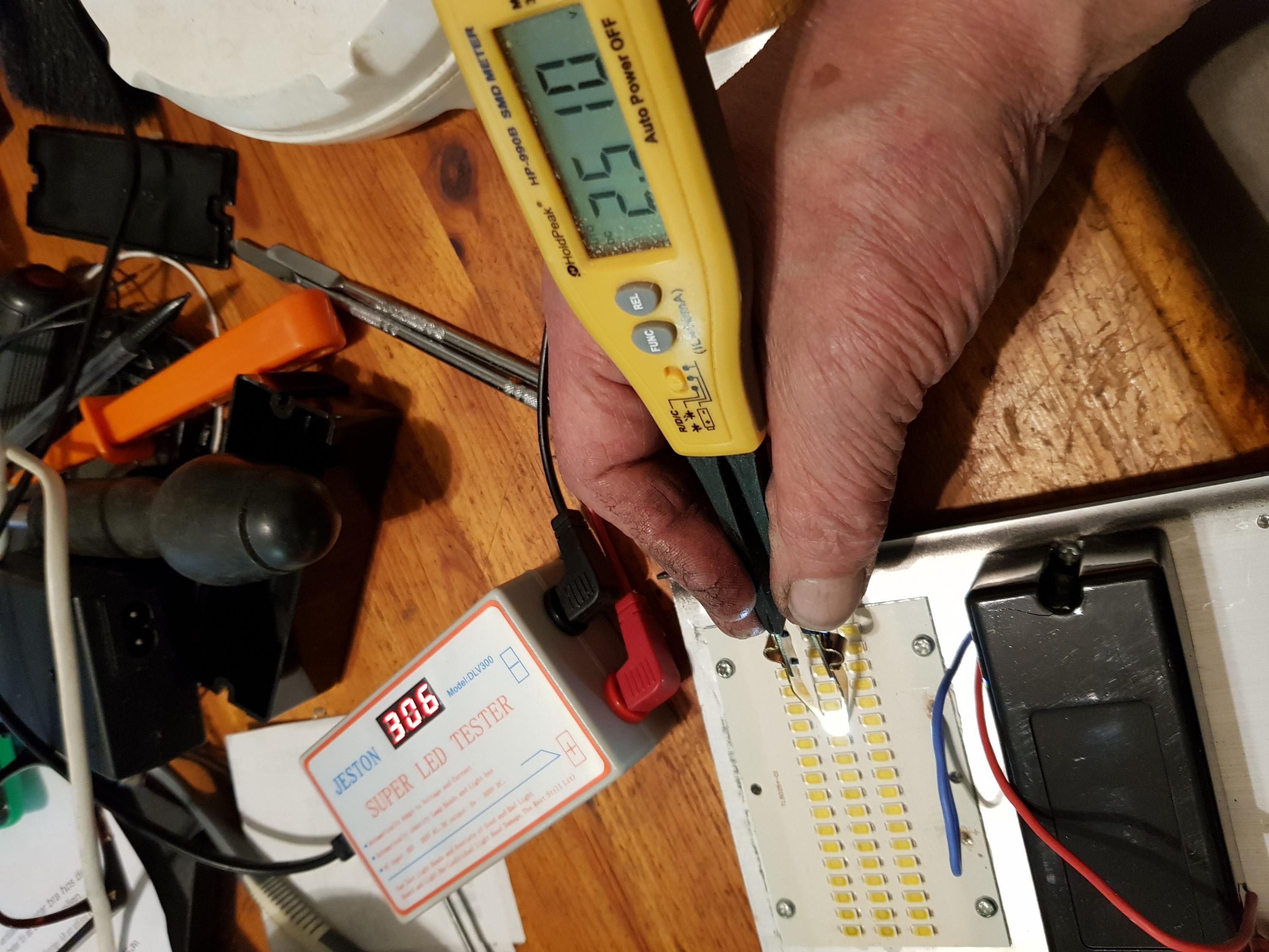

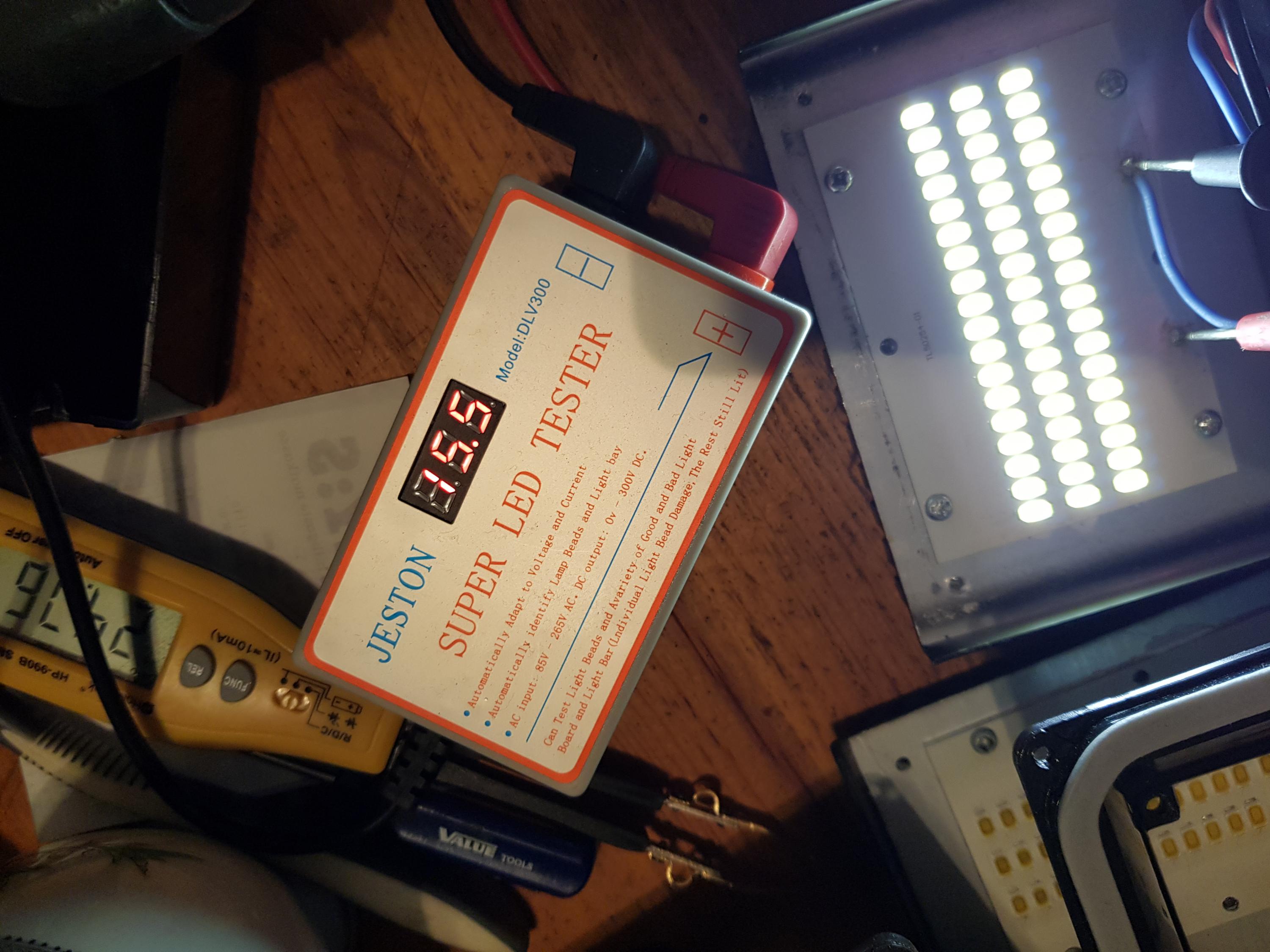

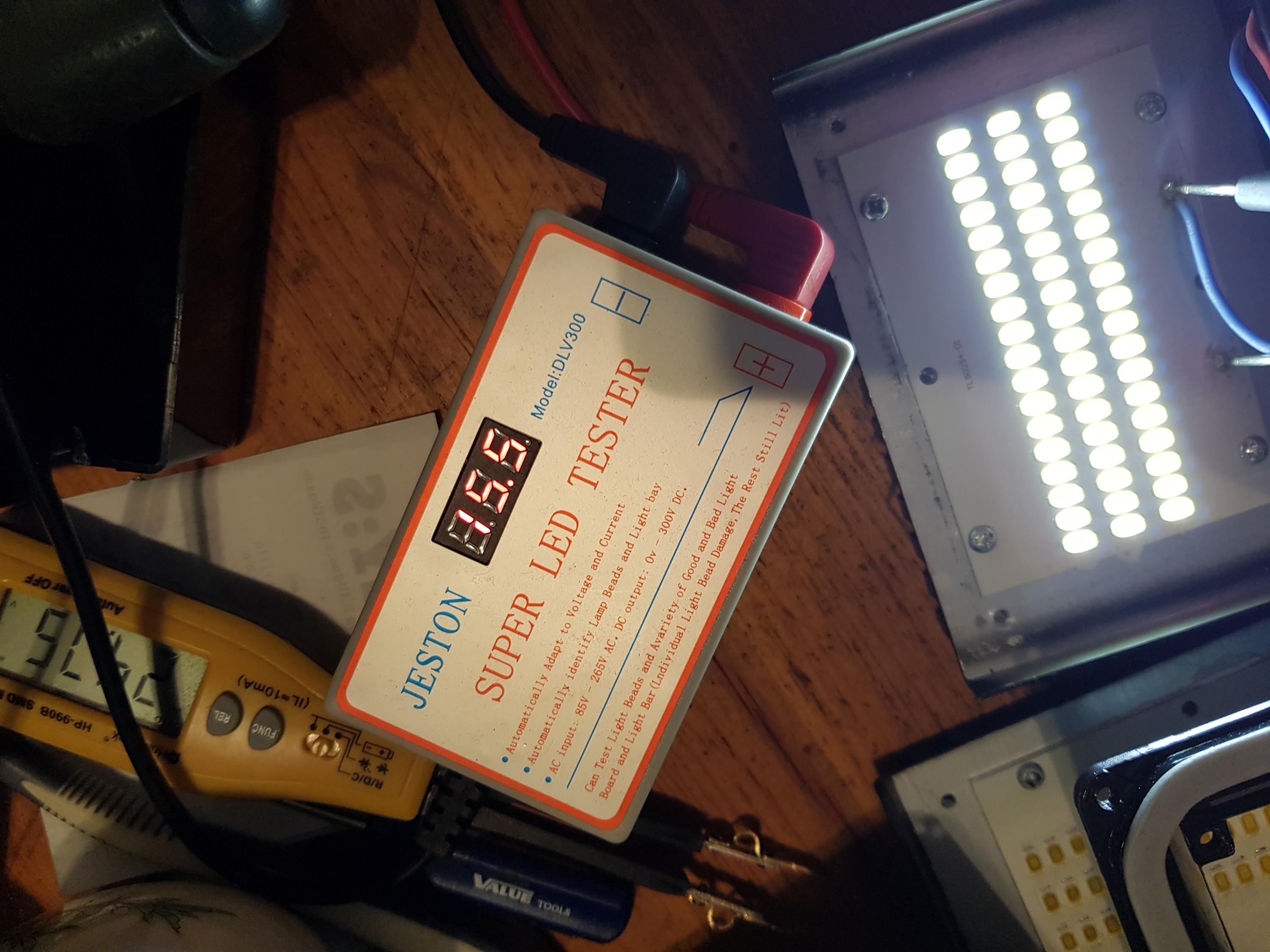

                    How can it be 2.504v for a single led lamp and 15.5v for the whole plate which has 54 led lamps
                      • 30991
                      6 in series, then the strings are in parallel
                        ok but can you explain a bit more ?and if I want to replace a broken led bulb which how much volt should it have?
                          • 30991
                          put a meter across a working led to see the voltage drop
                            Those lamps don't have sufficient cooling, look at all the dark LEDs in photo #4.
                              as you see it gives 2,5 v and there is 54 led and i get 15.5v total how can it be?
                                They lie on a cooling surface.but apparently it is not sufficient
                                  There 9 parallel strings 6 in series @ 2.5 volt LEDs = 15.5 volts power supply voltage
                                  So if the LED driver ic chip is defective or there is an issue with the switching power supply or you have LED ic chips over current or do not light at all or very dim these are going to be most of your issues unless you have bad soldering joints
