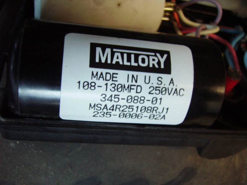

    Suitable replacment for this big fella?

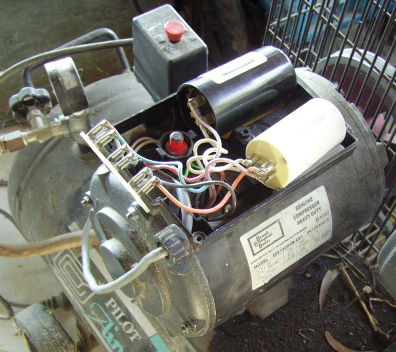

    This cap is on an AC electric motor which won't usually start. You can hear it trying to run, but it just won't turn. I have 3 questions:
    1. Is it likely that the pictured part is the problem?
    2. If it is likely to be the problem, what would be a good replacment for it (Preferably from RS components, since I get free freight with them)?
    3. Will it explode in fire?

    Re: Suitable replacment for this big fella?
    - Check if it has a start/run relay - may be stuck in run position or burned out.
    - If no relay, perhaps a centrifugal mechanism that opens the switch. Look for 2 hinged plates with some springs on one of the ends of the rotor.
    - Could be the cap.
    - If this uses a contactor (heavy duty, multi-pole relay) to start, then see if it uses heaters and check them for open.
    Can you turn the motor by hand to be sure the bearings aren't dry/seized.
    Replace with close to the same uF rating and at least match the voltage. An air conditioning or electrical supply house would probably have them in stock.

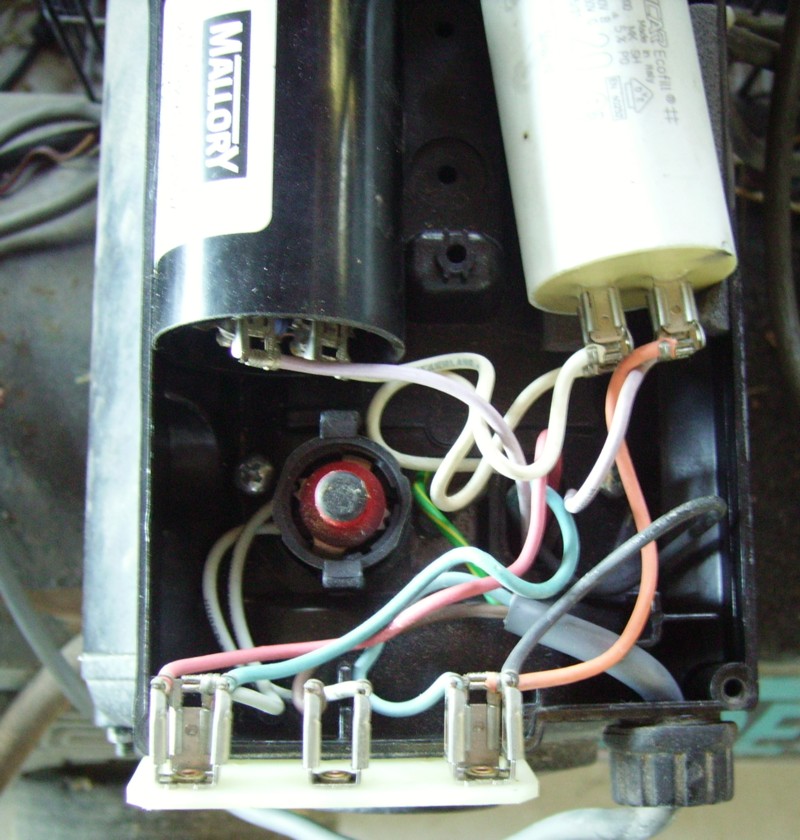

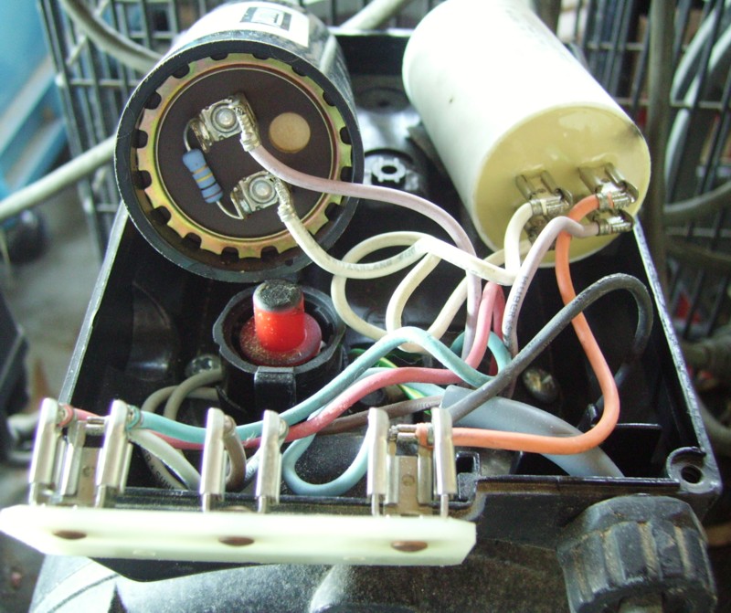

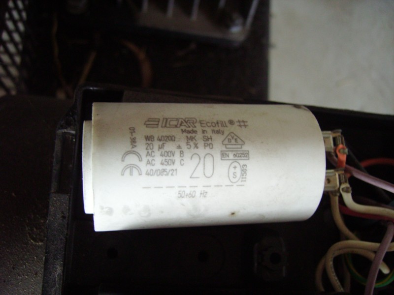

        I can't seem to find the relay anywhere. There are actually two caps. I'm guessing one's the start cap and the other's the run cap. I already found a similar replacment for the other one from RS. The motor can be turned, so the bearings shouldn't be a problem.
        Maybe I should also add that the bahavior can be a bit random. 90% of the time it doesn't spin at all. It tries for about 30 secs before the circuit breaker on it trips out. 5% of the time it turns slowly for about 30 secs before it trips the breaker and the other 5% it works fine. It's been getting progressively worse since it first started happening.
        In case it helps, here's a pic of the other cap.
        EDIT: What actually is the capacitance on the first cap? 108uF or 130uF? Or does that mean that it could be anywhere in that range? (Assuming MFD=uF)

            Second (white) cap is the start cap. First (black) is the run and is as you suspected, ranges from 108 to 130 uF.
            With 2 caps now showing, you're looking at the figure 14-27 in those first links. A cap-start, cap-run type of motor.
            You say it turns slowly... how slow?
            Can I see a pic of the whole motor, motor rating plate, and a view of the wiring between both caps and the motor?
            Not finding an external relay does indicate the possibility this uses the centrifugal switch type for start/run.

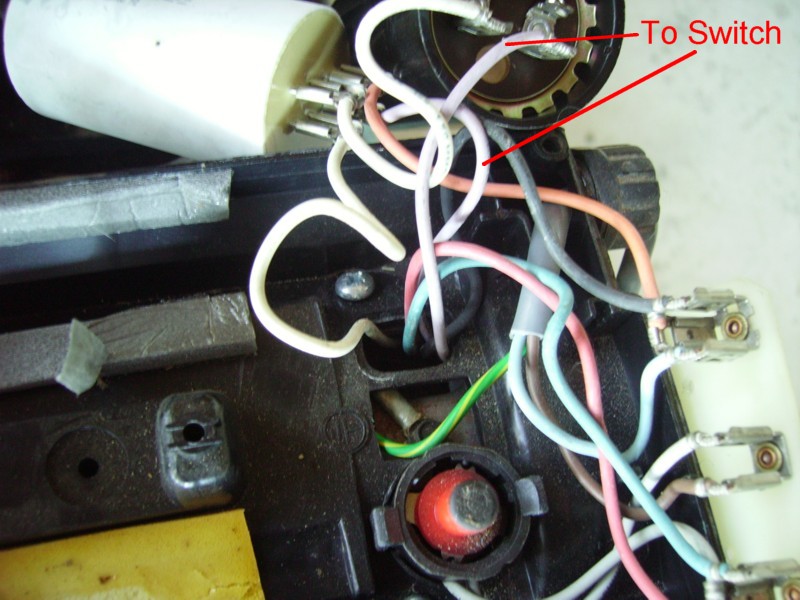

                    This one is from an air compressor. It's a bit of a birds nest of wires in there. I'll get a pic soon.

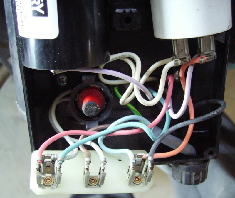

                      Here are some pictures. I pulled the back off the motor to see the switch. I can't find any evidence that it's stuck. It seems to move freely.

                        Is the centrifugal mechanism free to move also? If the switch moves, but the centrifugal mechanism is stuck, that would explain why it's not coming up to speed. Weight and spring mechanism should move in and out on the shaft.
                        Do you have a DMM that will test capacitance? Disconnect it & make sure it's discharged (measure volts across it) and check it that way. Or, use the guide PlainBill pointed to, then do so. If you are uncomfortable messing about with it that way, then buy the replacement.
                        I tracked the Icar (white) cap to this local distributors page:
                        http://www.commchem.com.au/products/capacitors/
                        They also have the start cap in a matching capacitance.

                          Sorry when I said the switch, I meant the mechanism. all parts of it seem free to move. My DMM doesn't measure capacitance. I found this for the white (run) cap http://australia.rs-online.com/web/s...duct&R=1964703. And this for the black (start) cap http://australia.rs-online.com/web/s...duct&R=0117221. would these be suitable replacments?
                          EDIT: Another option for the run cap :http://australia.rs-online.com/web/s...duct&R=3778813

                              I repeat, the symptoms do not match a bad start cap, and certainly not a bad run cap. 'Won't start' problems in single phase electric motors can be traced to only a few causes: Excessive load, open start cap, open or shorted winding, bad start switch or relay. The usual cause of an intermittent problem would be pitted contacts on the centrifugal switch, or a sticky centrifugal switch.

                                *2 on the centrifugal switch. My company has a customer who owns an 5-hp reduced frame (can't remember the frame size) 1-phase motor on a restaurant exhaust hood fan. About once or twice a year, we go on the roof to pull it and adjust that switch. We figure it gets hung up with all the chinese food grease that blows past it while the fan is running. Symptoms are the breaker trips before the heaters in the starter pop. The first time it happened, it took out the start caps.
