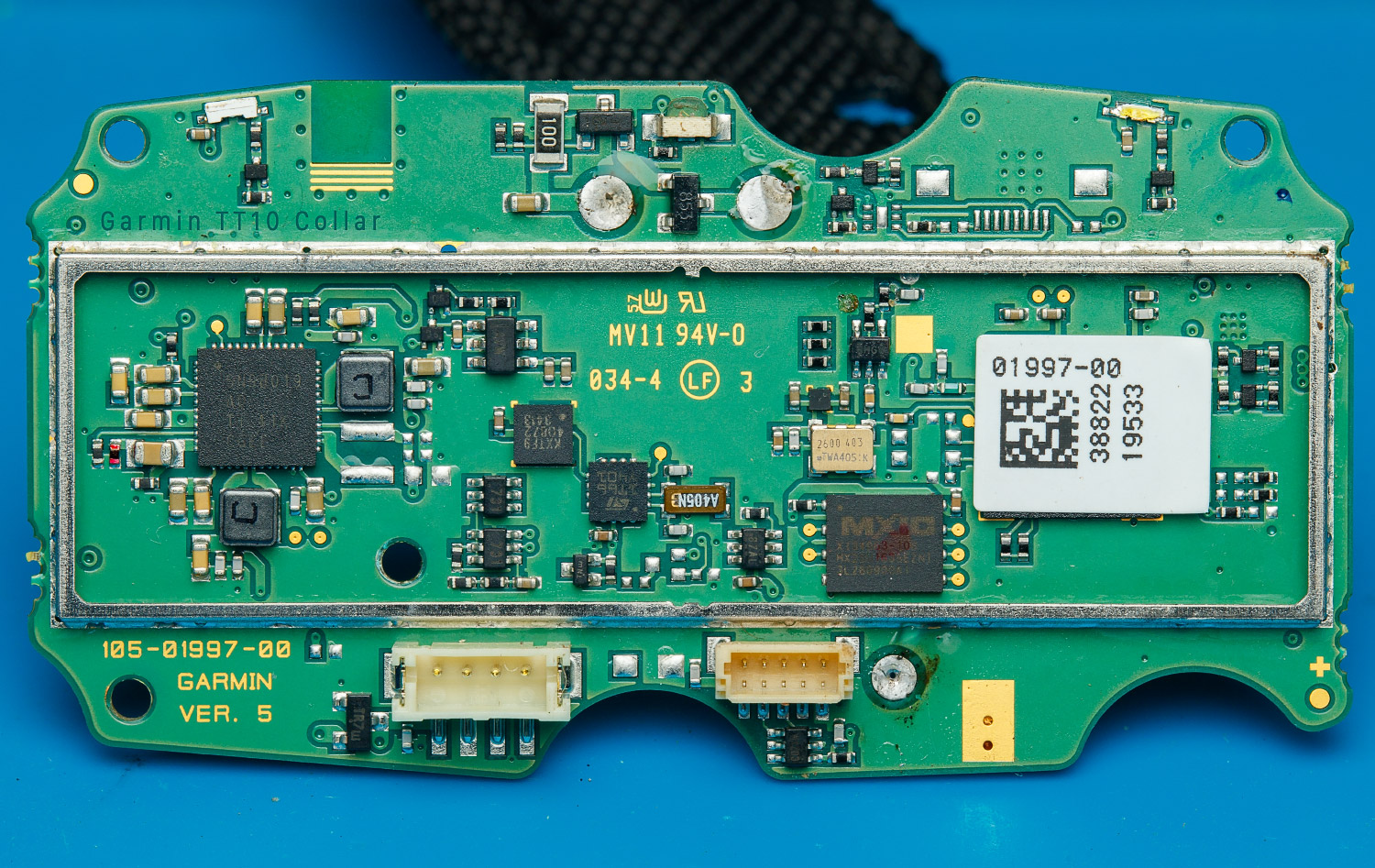

    Continuing with the garmin collars...Here is another TT10 everything working except shock and tone. I'm posting this also hoping that it may help others with these issues.
    Replaced the GPS module and collar will connect with handheld Alpha100 and able to track but the shock and tone functions are still not working.
    I found 4 components (capacitors) that are reading short to ground (marked with red marker), 1 on one side the board near the SN9B019 chip (multi-voltage power controller) and 3 more capacitors on the other side of the board.
    I see no cracks in the inductors on this board, like is seen on the other boards.
    Yet the same issue with the shock and tone functions..???????? Hmmmmm????

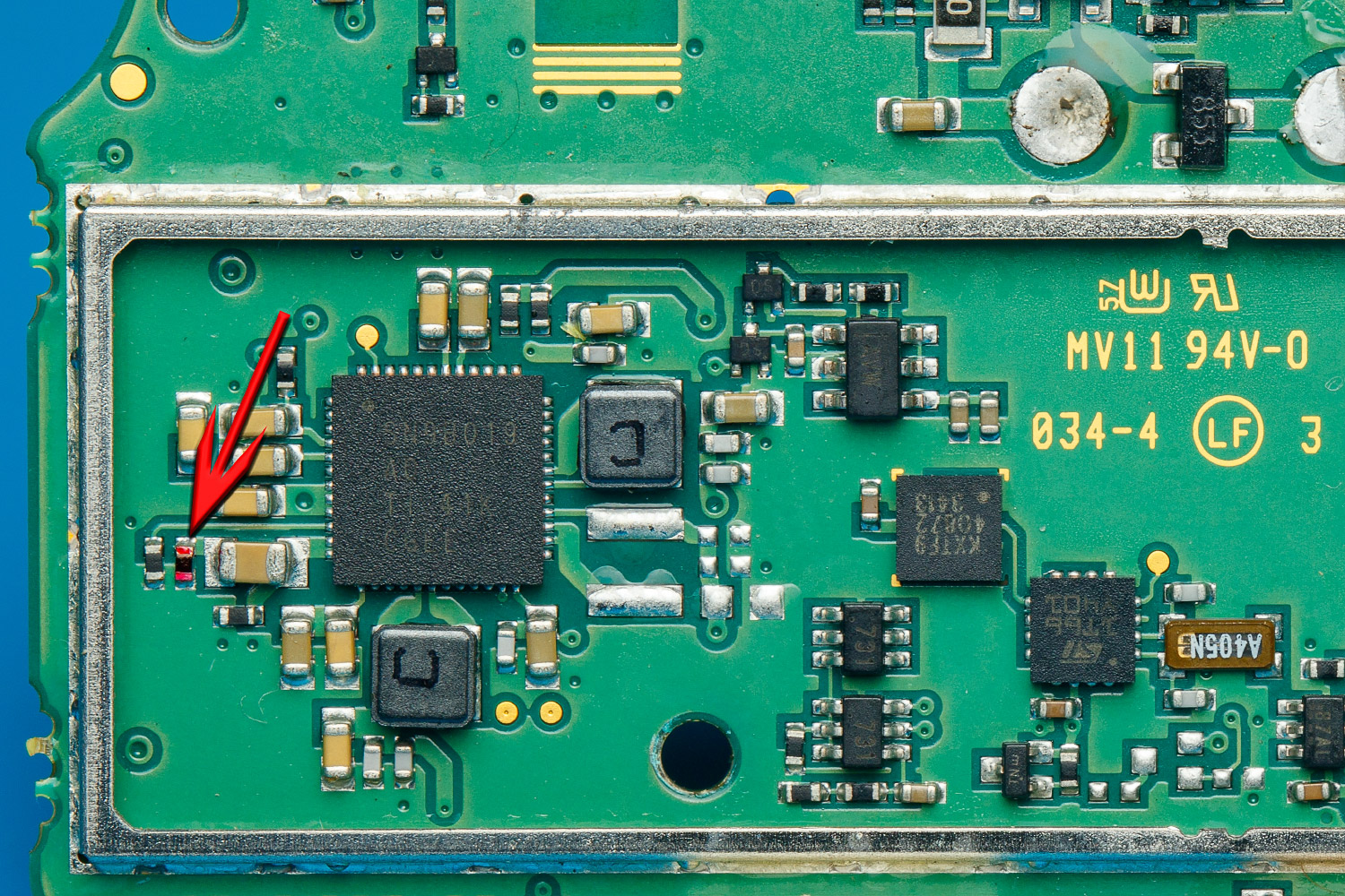

      Re: Garmin dog training collar.ID help with SMD, Please?
      Did some further trouble shooting and found that the 0402 component that the arrow is pointing to in the image below is shorted on all the units that I have tested so far.
      Replacing it with good ones from donor boards fixes the issue of the non-working tone/shock function of the collars.
      Also...some of the collars with cracked inductors work after replacing the 0402 component.
        looks like a resistor or inductor.
        meter a good one.

          • UserAlexandr
            • Sep 2022
            • 8
            • Ukraine
            The inductors are damaged. This is the hull design.
            There is not enough space between the battery and the board.
            When used and any strikes are damaged.
              Originally posted by macroman
              did some further trouble shooting and found that the 0402 component that the arrow is pointing to in the image below is shorted on all the units that i have tested so far.
              resistor 1Ω

                Re: ID help with SMD, Please?
                [QUOTE=Macroman;1162737]Continuing with the garmin collars...Here is another TT10 everything working except shock and tone. I'm posting this also hoping that it may help others with these issues.
                3 capacitors according to the scheme are in parallel with the inductors. they will be read to the ground. You don't need to be here. This part of the circuit is responsible for the emission of the radio signal.
                Update the collar firmware via WebUpdater

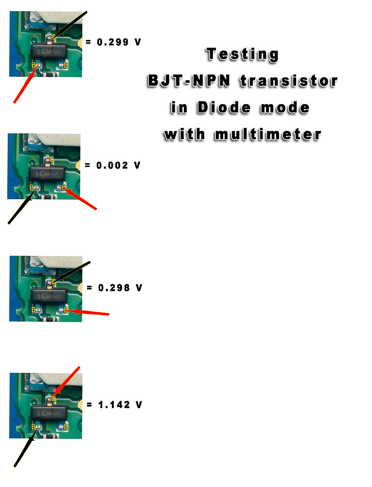

                      Did some more testing with multimeter in diode mode and found that there is a BJT-NPN transistor on the board that is not testing correctly..
                      The attached image shows the readings I recorded and the placement of the red and black leads during the testing.
                      • UserAlexandr
                        • Sep 2022
                        • 8
                        • Ukraine
                        #31
                        Have you looked at the datasheet for the transistor? Have you disconnected the transistor from the electronic board? There are no exact measurements on the electronic board in the circuit. For an accurate determination, separate the part from the electronic board. Use a device such as the ESR LCR-T4 tester on the Atmega328.
                        Is the component installed near the audio speaker? On a 3.3 Volt power circuit? If there is a beep when turned on, do not touch it. He is a worker.
                        • Macroman
                          • Feb 2022
                          • 22
                          • USA/Philippines
                          #32
                          Thanks..
                          I did remove it from the board and test out of circuit. I tested with LCR-T7 ESR meter...Readings were...
                          BJT-NPN
                          hFe=207
                          Ube=698mV
                          Ic=5.9mA
                          There is no audio, except for beep tone when turning unit on and off.
                          It has 3.7V input power
                          Data sheet:
                          https://cdn.badcaps-static.com/pdfs/...be5f171f21.pdf

                                  Thanks to the OP for starting this thread. I have replaced GPS antennas on some of these, mostly TT15. I also repaired some of the LNAs and a few boards with liquid damage. Working without schematics is a real pain.
                                  UserAlexandr seems to be very familiar with these units, I hope you will share more of your experiences with us.
                                  Almost all of them I worked on had the same coil cracked but it does not affect the functions, I guess that's why the EMF shield has a piece of neoprene on it.
                                  The 1ohm resistor referenced to previously is connected to GND so it's not a short. If the functions worked after replacing it, most likely heating up the board in that area caused something to work.
